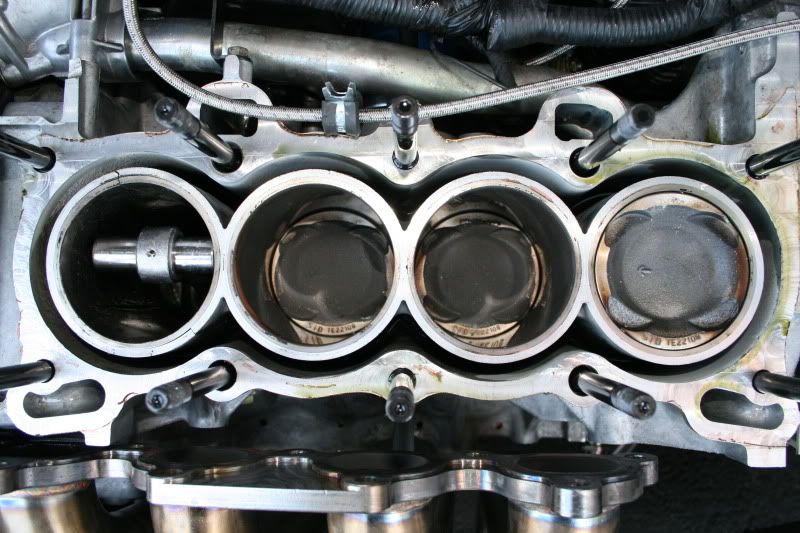

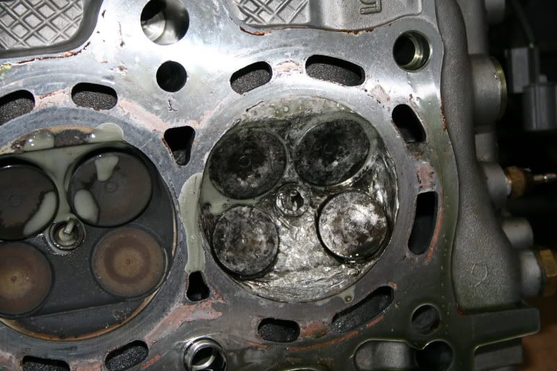

Well, bad news. The motor is done.
One of the pistons decided to leave the building. No abnormal combustion or anything like that, all cylinders and plugs are/were perfect until this pass. #4 piston just came apart at only 23-24psi at the track. The wristpin beating around in there cut grooves all down the cylinder and cracked the sleeve at all 4 contact points.
We either found the limits and pushed them too far, or it was a freak incident that 1 piston fell apart.
Here's what we found when we pulled the head:

The carbon trail on those pistons is the dictionary definition of perfect.  Looks like you had a casting defect in #4, and I'm sad to see it happened so soon.

Total on this motor was ~40-50 dyno pulls, ~100 street miles, and 12 passes at the track.
I think it was a casting/metallurgy flaw, or #4 was simply the weakest of the bunch and failed first. Either the skirt developed a crack and then it fell apart, or the pin boss area wasn't strong enough and the piston came apart there, detaching itself from the rod. We heard it rattling after the burnout right before the last pass, but I ran it anyway and shouldn't have. It would've saved a lot of damage.
I'm guessing that the high rpm was the killer. We had the rev limiter at 9600rpm. Last years build never saw over 9100rpm, and lasted forever.
We knew what we were getting into by pushing things this far, I just didn't expect it to let go this soon. But we learned a lot and everyone can benefit from it.
