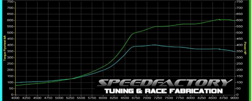

OK, so I got talked into cranking the boost a bit more on the Vitara's today.
I didn't plan on doing this until later in the summer, but we wanted to have it all tuned out at higher boost levels so that we could just turn it up at the track if we felt we were close to hitting 9's but needed a bit more.
Well, here it is:
609whp/404tq @ 30psi!
Vid of one of the pulls, not sure which one'll be up first.
SpeedFactory '09 Vitara Build - New Record 600+whp!!!
Streetfire:
This wasn't a 1 pull deal, we made 5 pulls at this boost level, all runs were over 600+whp/400+tq. She's taking it like a soldier!
We had a slight ignition misfire at torque peak on the 2nd pull w/the plugs at .014 gap, so we dropped it to .012 and no more misfires."

Sweet numbers. ;D

Id be shocked if the transmission lasts a pass on that power level. Pretty amazing stuff
Finally a vitara build with a some serious head work. Power shows it.

Awesome numbers man, thats amazing on those pistons. 609 whp is no joke

It makes me titter like a schoolgirl to see a SOHC carry torque up that high.

Yeah, His head flows 240cfm which is a shitton over stock

whoever did the headwork knows what there doing those kind of numbers out of a d head arent easy. Nor cheap alot of LABOR

240cfm out of a d head :o Thats alot of fucking air!!!!!!!!! No wonder it carrys the tq so well. Whats stock cfm on a sohc vtec head?
