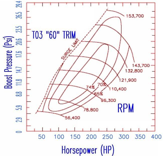

Look at the compressor map I posted, it's converted to HP and psi for easy reading. Assume I am at 18 psi probably between 200-250 hp. I should be good there.

oh shit, i didnt even see it. The image is blocked at work, well i'm kinda in the same boat again, from the elementary school compressor map on blaast's site for my turbo I should be good. I tried out one of those homemade det cans today for the first time and I have to say it is pretty cool. I'm going to try tuning some timing maps this weekend i'll post up the maps when i'm done hopefully it helps the problem.
