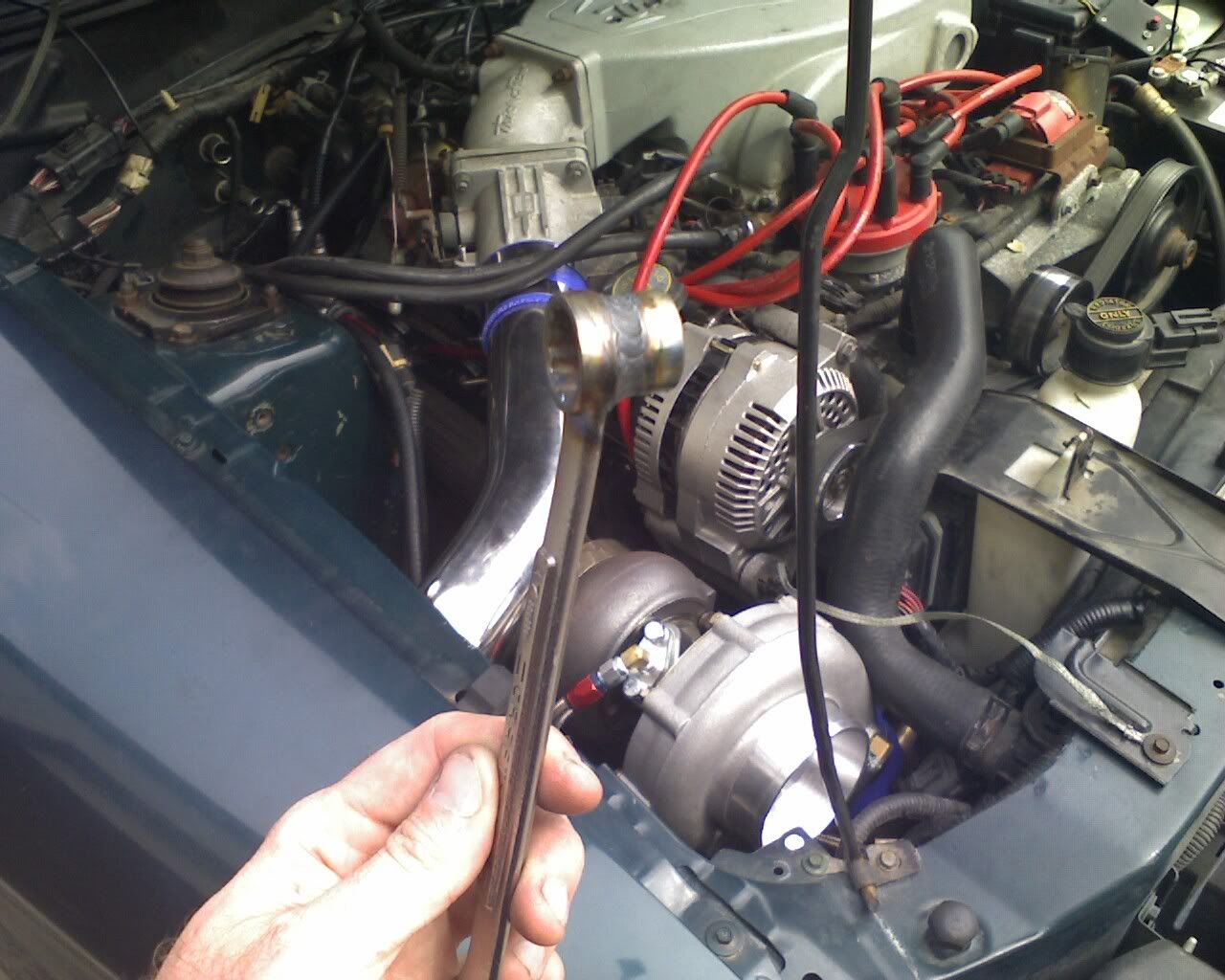

The passenger's side bank (1-3) was impossible to fit a plug socket over, much less a ratchet.  I got crafty with the sawzall and TIG:
It's actually on the too-short side, when it interfaces the plug there's a very narrow range of allowable movement before the shoulder of the wrench gets in the way... another 1/4 to 1/2" depth and it'd be perfect.  In fact, I plan to make one like that only with the socket portion rotated 10-15 degrees clockwise, so I can play the two wrenches off against each other.
FYI, this car has the GT40P (Explorer) heads which have angled plug holes, things might be a little different with other heads.  Just an idea.

gt40p heads can make for some serious headaches

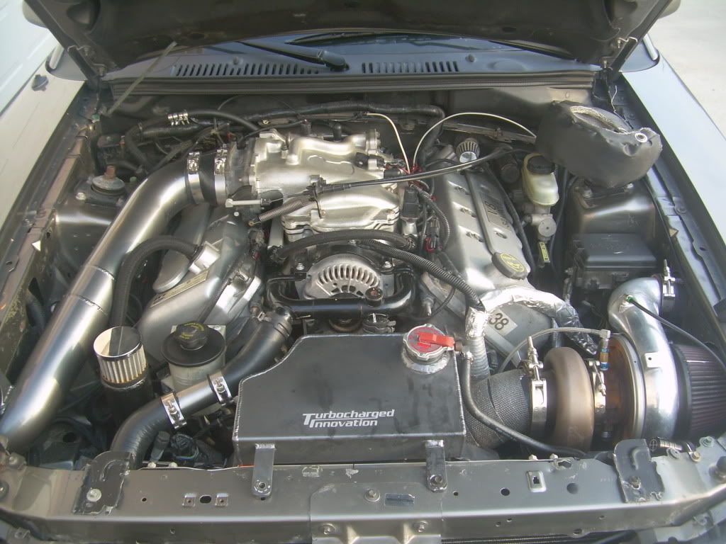

Any numbers outta the sn-95? Who's kit is that? Kinda looks like that boost brothers kit.

I did a RHMT on a 90 hatchback 5.0L It made 420hp/520ft lbs. Then spit out the ringlands. The owner built the motor himself with hyperretarded pistons and had a big lift cam so he had to "clearance" the tops of the pistons with a dremel!
i think it is joey called me last week asking if i knew anything about boost brothers cause he was tuning an sn95 with thier kit.

It's supposed to be a T67, not T70.  Dude got the whole kit for $1270 shipped to the door.  Not my choice, but meh.  CSaddict said it looked like Cracky Chan pulse welds but I've not seen the like before (looks like it's made from the mandrel bent stainless from Columbia River w/ robot welds)... fitment of the headers, crossover, and charge pipe is top notch.  If the headers/etc don't fall apart over time I'd wholeheartedly recommend calling up Boost Brothers and trying to get the kit minus turbo, gate, and BOV for cheap.
E-cam, supposed built bottom end but it's a post-69 302 block so that means money wasted, tuned to wastegate, car feels pretty good on a street tune.  The owner is in the military and had to get back to base in KY(two and a half weeks left on leave, wife + two kids demand attention), he'll be fixing a few small things and coming back for the dyno tune he was supposed to get but didn't due to time constraints.
FWIW, the setup forces mounting the MAF in a blowthrough position which isn't ideal, but works if you keep your eyes open.  It's running a 24lb Granatelli MAF which is fine for wastegate, but needs a MAF extender/MAFia for more.  After spending a couple hours researching and on the phone with Granatelli, etc, I'm of the opinion that the whole aftermarket MAF thing is horseshit.  Cobra MAF + MAFia = 700+ whp, and a $65 Lightning MAF will get you further with some rescaling.

I actually bought that same kit to put on my sn-95 with my 347. I'm gonna swap out the turbo for something a bit bigger though. The kit does not look like the usual chinese stuff the piping is thicker and everything looks well made only time will tell. I'm either gonna use a sct ba3000 meter or one of the 05 up slot style maf's. I've allready got the 80lb injectors too. Just being curious as to what the kit made as far as power.
