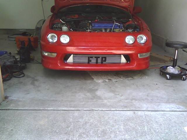

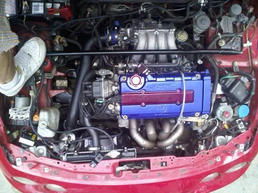

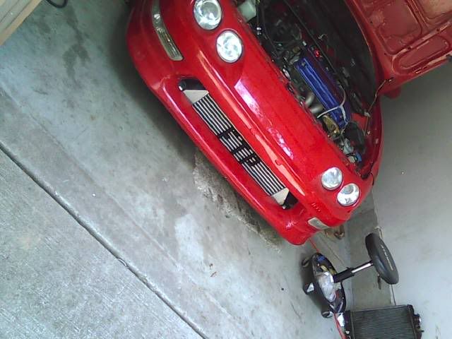

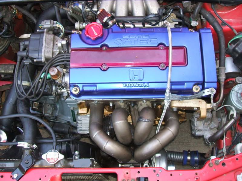

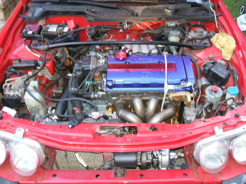

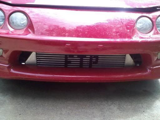

Well I started off buying my 00 GSR about 4 months ago.  I loved it what can I say I went from a Chevy Impala to a Acura Integra GSR...Can we say upgrade?  So I drove it around for a month and I wanted more out of it.  I decided I was going to build the GSR.  On my other local forum, I found a GSR that had golden eagle rods, JE Pistons 8:1, tittanium head bolts, Brian Crower springs, retainers, stage 2 turbo cams.  These are all BC.  The only thing stock inside of the motor is the valves.  The motor had less than 12K miles so I bought it.  The motor was not boosted, so I figured it was ready for the boost it was built for.  I have a Ebay knock off RFL vavle, HKS 40 MM Wastegate, 2.5" turbo pipping, solid intercooler, MSD 998cc injectors, AEM Wideband, Boost & Oil Pressure Gauge, and Hondata s300(save your hate please).  Here are some pictures it is ready for the tune, I am just waiting on my chipping kit which is going to be shipped out Monday.  Any comments are welcome hate and love appreciated.

well played sir, the fluxcore, crush bent IC pipe, fluxcore on the mani and the baller feed line holder is sick
car must haul with a good tune

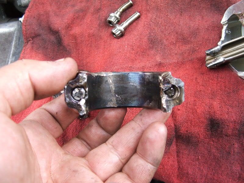

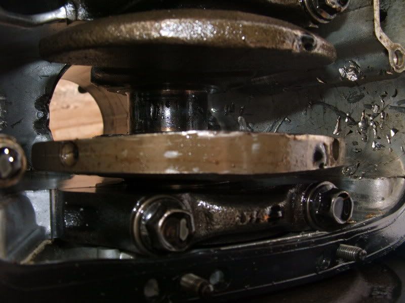

This is what happens when you buy an engine someone else built. Built LS VTEC that came in a non-op CRX with a complete turbo setup, During breakin it blew up N/A 800 miles later. Rod Bearing ate shit and rod end came loose, and the crank shot the rod through the block.

There's the problem, left of center. The retard didn't notch the LS block correctly lol. :noel: Last time I bought a shortblock from some mung guys (ugly asians), it had 3 spun mains and 2 spun rods. HOW THE FUCK.
