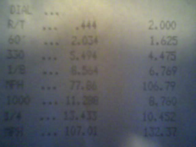

Please excuse the shitty picture, my camera is MIA.
That makes 7 10 second passes this year. 10.9, 10.7, 10.6, 10.6, 10.6, 10.54, 10.452.
New best in everything BUT my trap speed. It was a nasty humid day, with rain on and off.

Thanks guys. Im surprised the car went any better with shitty conditions (on off rain/heat/humidity).
Car has not been retuned. Only things ive changed since last tune are TB spacer, lsd, and an inline fuel pump.
And now the car is on straight 116. Seems to like the octane even without retuning.

Whats the fastest people have ran on these pistons? Its refreshing to see a car actually putting the power to the track for once.

9's are not too far off
.453 is pretty far off from 9's.  Typically you are looking at an increase of 50-100hp to get that half a second.  9's vs 10s in these FWD cars is a pretty big step.

Sadly D-series are D-series.  They make 400-450whp fairly easily now.  500whp+ is the issue.  Small bore, poor flowing head, not great cams, ect ect ect keep the engines from getting in that 500whp/9second world.  It can be done and he could do it.  My point is 10.5 vs 9.99 is a big difference and going for a 9 second pass will require a good bit of more power and a good amount of luck.

If he launches harder he could run a 10.3 or so, but I agree a 9 would take 50-60 more whp and good driving.

I don't want people to take my comments as being negative.  His car is kick ass and is doing it while spending half what most other people do to get the same results.  I'm just trying to set some realistic expectations that most people don't get.  9s vs 10s is mph and mph=overcoming air resistance.  The easiest way to do that is make more power.  Making more power = breaking more shit.  I'd say his drive train is due to explode.  The other thing he can do is making 600whp and spin his tires off the line.  His times for his weight/power will be garbage, but his drive train will survive.  Sadly, his engine won't make 600whp for more than a few passes.  So he's stuck either blowing the engine or blowing his drive train to pieces.  If he feels like getting technical and anal, he should work on aerodynamics.  It's a thankless modification in a lot of ways because you end up spending a lot for a little, but your car tends to survive a lot longer because you really do reduce a lot of the stress on the car.
If the goal is a 9 second pass, tune for 500-525whp and get smaller slicks than you need.  Hopefully with the 100hp and slightly worse traction you can make a few passes without exploding.
