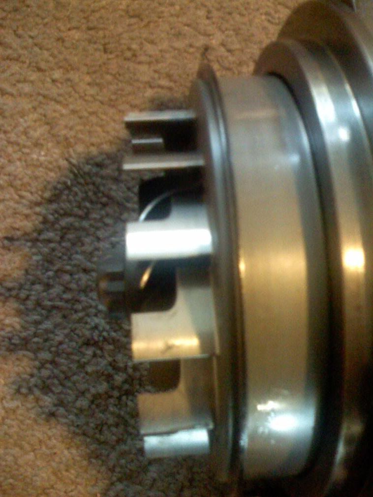

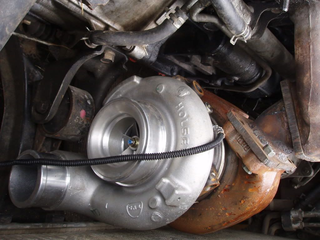

Now the interesting part, VGT turbo, Holset HE351VE from a 6.7 Cummins.
Housing variable from something very small, 4-6cm^-25cm^2
The stock actuator on the turbo is an electrically controlled actuator normally controlled by the ECM.  Unfortunately I haven't figured out what kind of signal the ECM sends to the unit to position it. My experimental solution is a 14b wastegate actuator on the VGT rack arm. I didn't think it would work worth a shit, but so far its working pretty damn well.

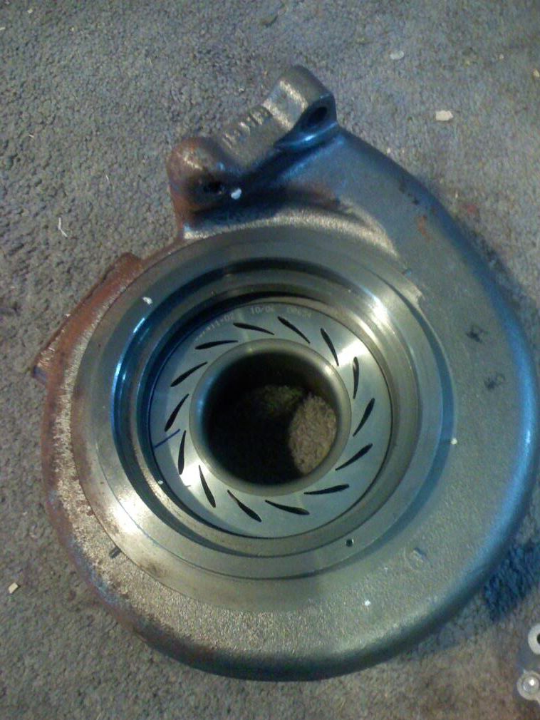

I'll start with turbo pictures since its out of the ordinary.

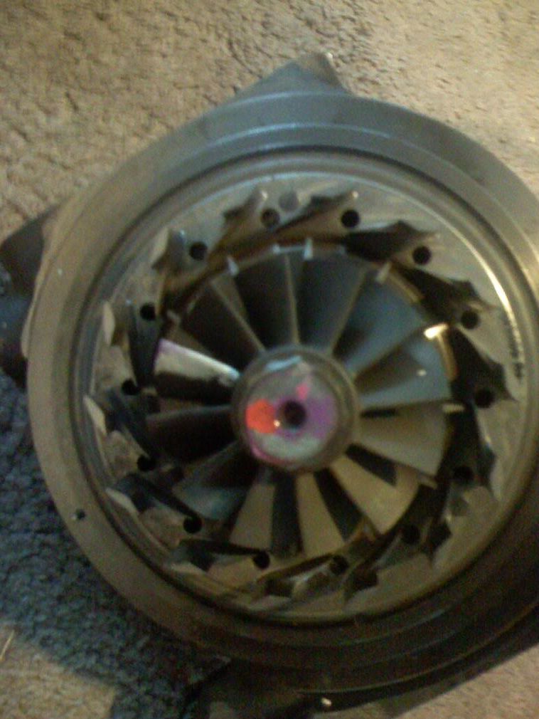

VGT closed
VGT open

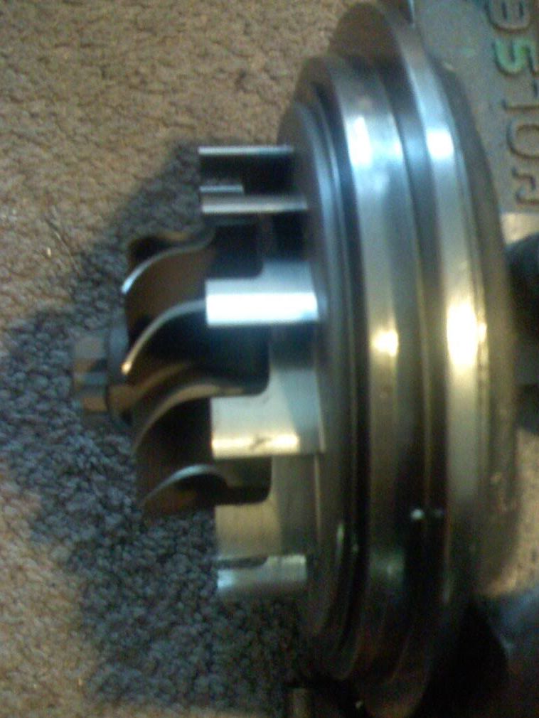

Turbine wheel and VGT vanes.

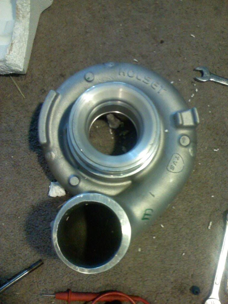

Compressor cover

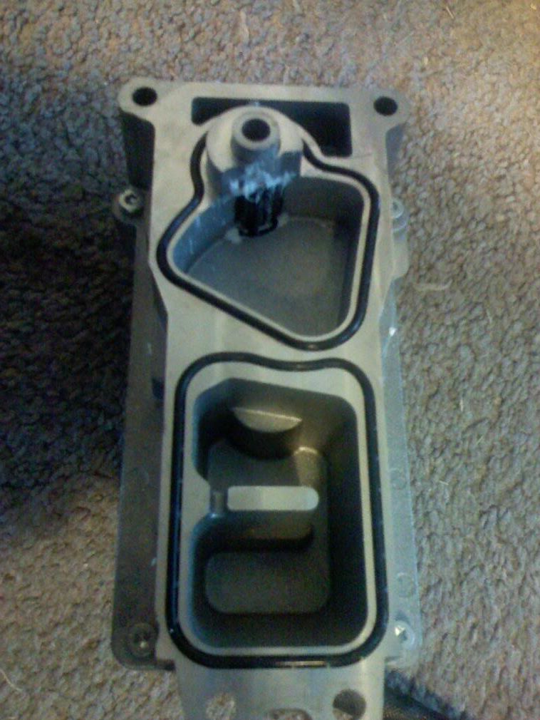

VGT actuator
Actuator internals

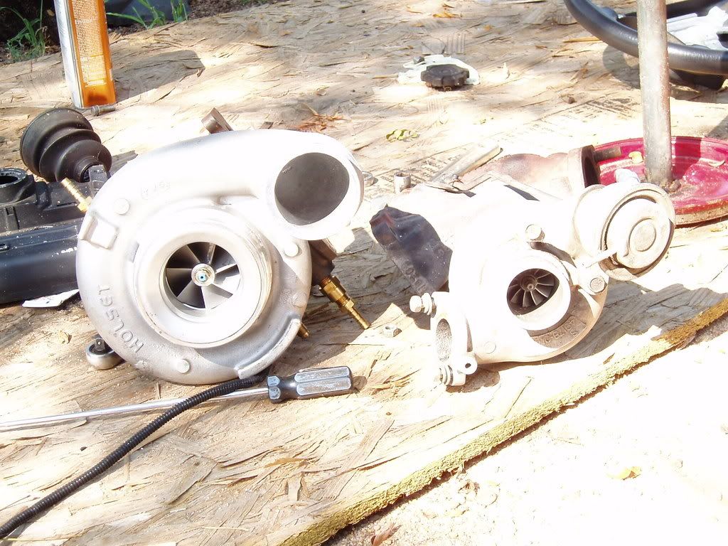

Compared to a stock 90-94 Eclipse 5spd 14b turbo also what the actuator I used came off of.

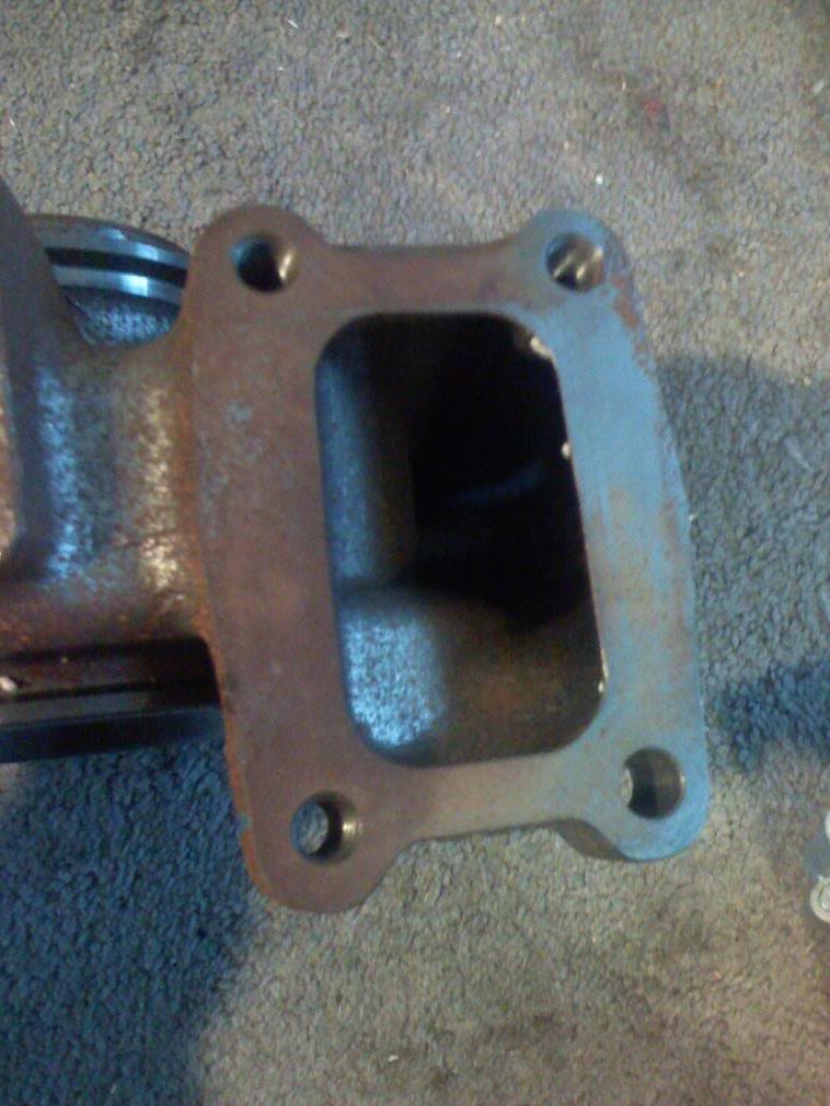

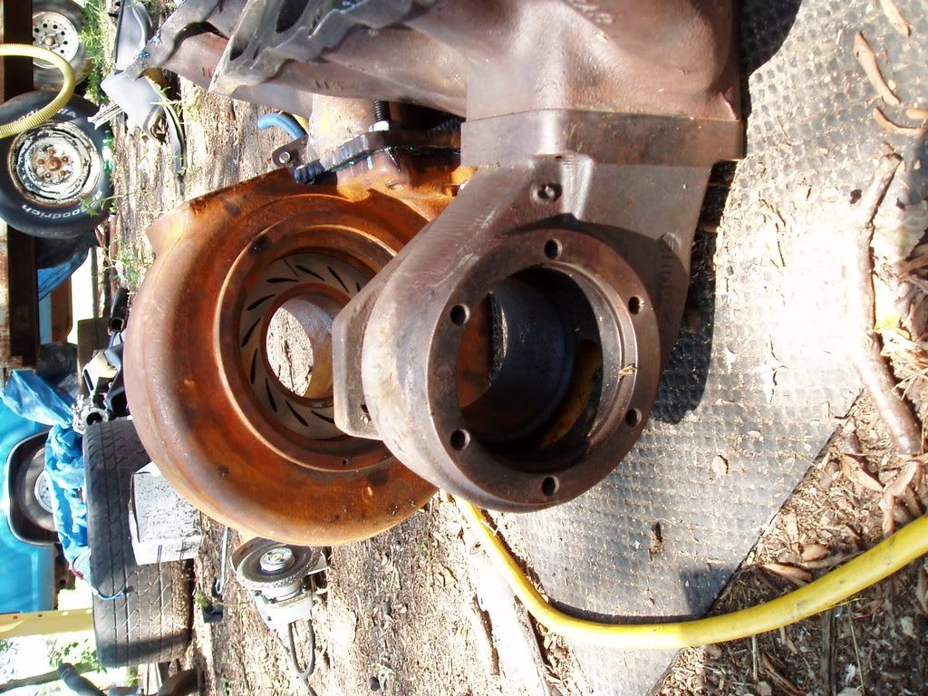

Exhaust housing compared to a BEP housing for an HX40 and my ghetto adapter.

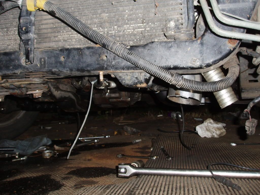

Fitment with the stock radiator is very tight slightly better than it looks the rad isn't bolted on the top and is sitting back.  Fabricated solid front motor mount out of something similar to nylon or delrin to help wheelhop and prevent contact with the radiator.

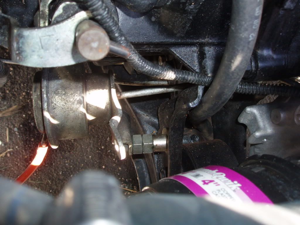

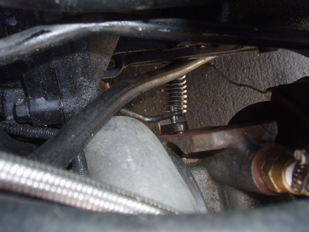

How the wastegate actuator is attached to the turbo.  It passes through the front motor mount due to packaging.   It is from the stock 1g 5spd turbo, and is a ~9-10psi actuator.

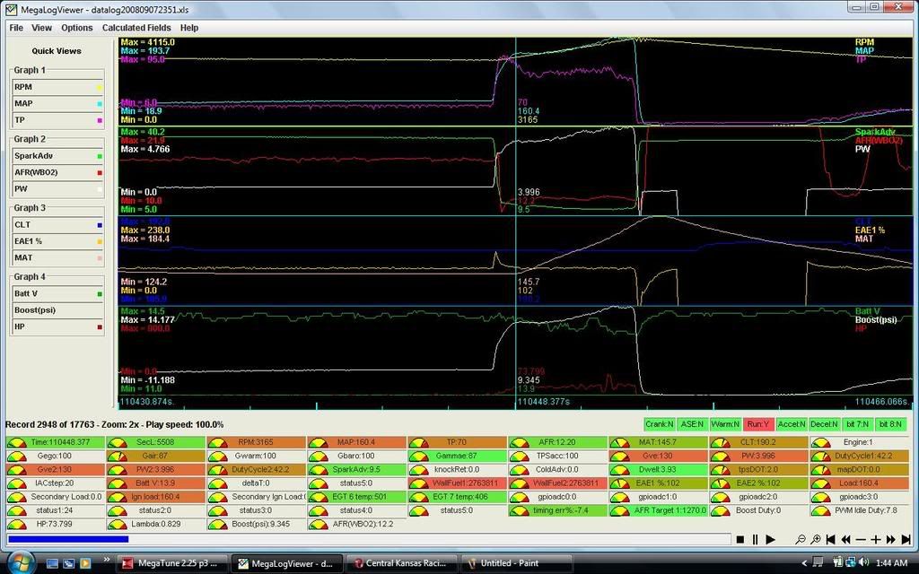

Initial results.
The actuator holds the VGT closed until 6-7 psi, then spool slows down.  Its weird, driving normally you can't really hear much exhaust note wise the only thing you hear is the turbine wheel whistling, keep in mind this is through 8" of exhaust.  Once it hits 6-7 lbs, the note changes totally, the rack is open fully by ~10-11 lbs I beleive.  It sounds sort of like an electric cutout opening, but not as loud. I think even though it has a huge hotside the vanes still help quiet it down, but make it whistle more.  Go under and overpass and it sounds like a jet flying by.
Here is a log from ~70mph cruise in 5th gear showing the transient response.  70kpa, to 9psi in about .95 seconds  at ~3000-3100rpm.
It spools a good 1000-1200 rpm faster than the small 8 blade HX40 in the .55A/R bullseye housing I had on the car before.  Even with the VGT open fully which is somewhere far above 1A/R.  Over 3500rpm or so the boost keeps climbing,  by 4400 rpm it reaches 24lbs and climbing rapidly. I'm really glad I included the external gate.
This is before connecting the external gate to hold boost down.

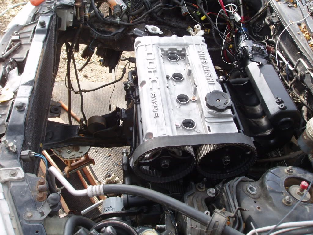

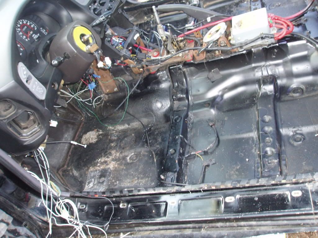

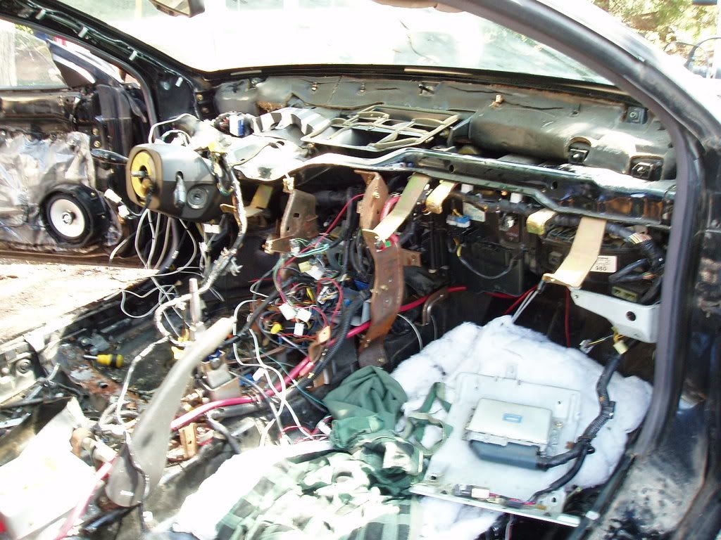

Some more pictures of all the work I did this summer. Correcting a lot of stuff that has been messed up since I got the car.  It was pretty extensive.
Many of the parts installed too.

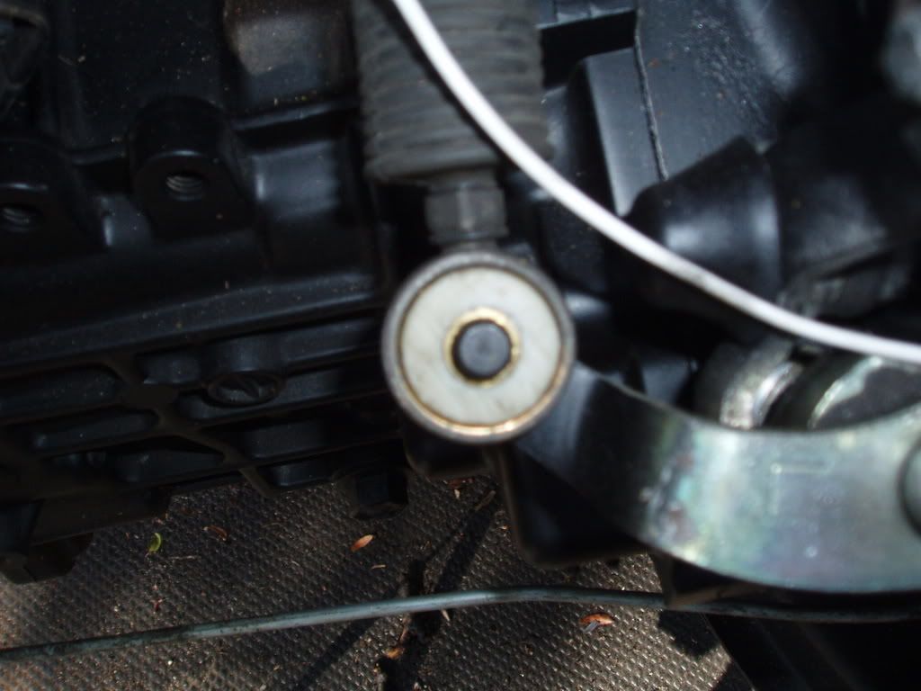

Homemade teflon shif bushings.

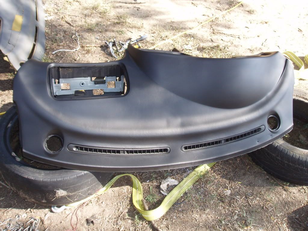

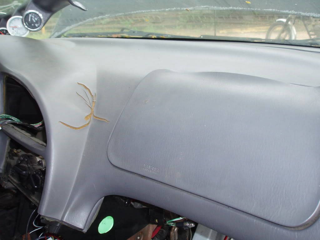

Old dash.  Last owner got pissed and punched it I guess.

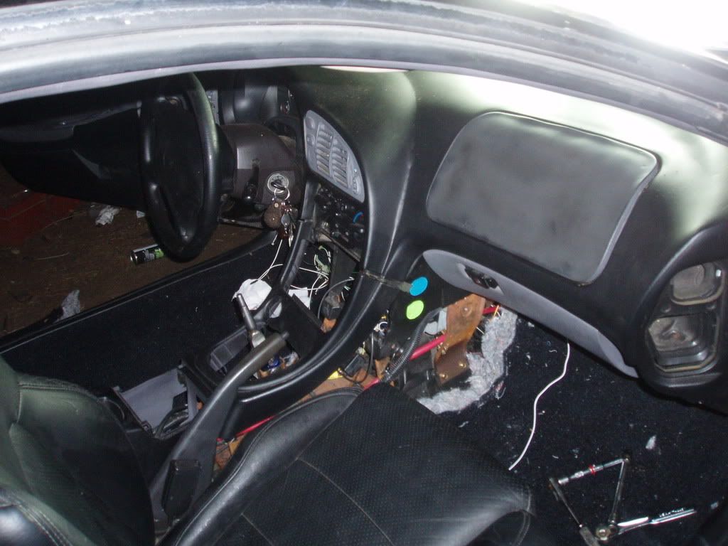

The mess under the dash and carpet.

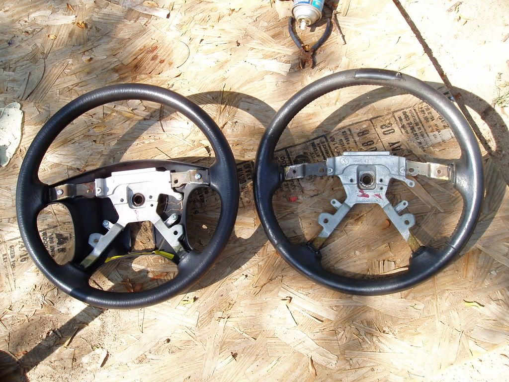

New and old steering wheel

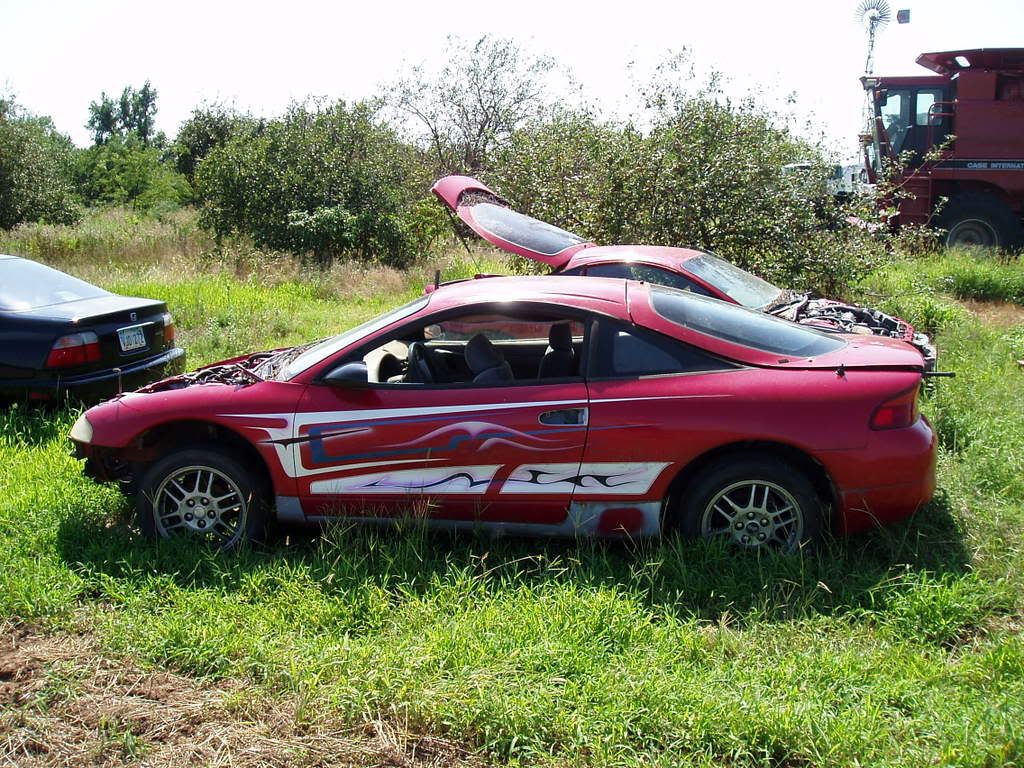

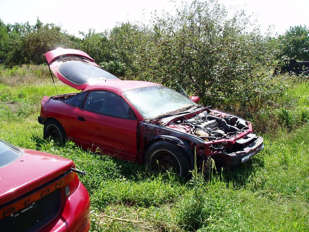

Couple of free parts cars. Damn ricers, luckily they weren't turbo cars

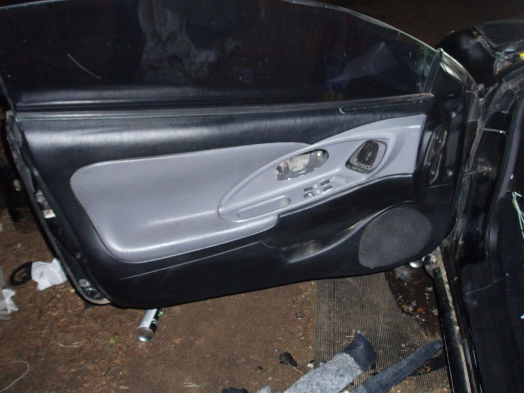

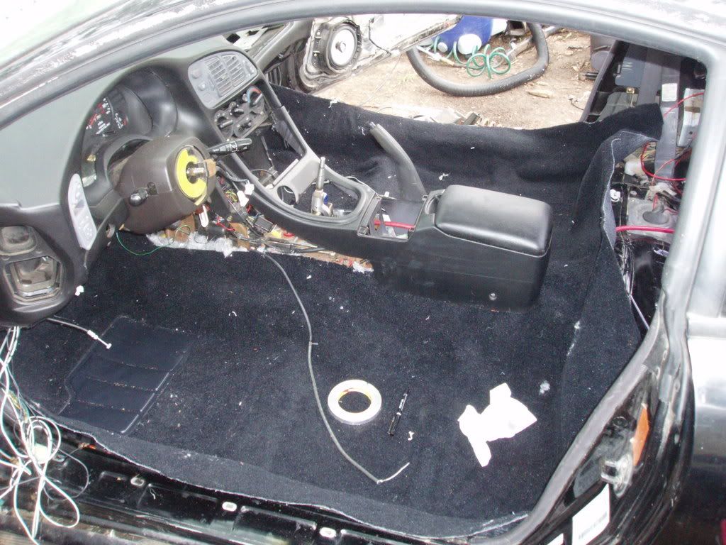

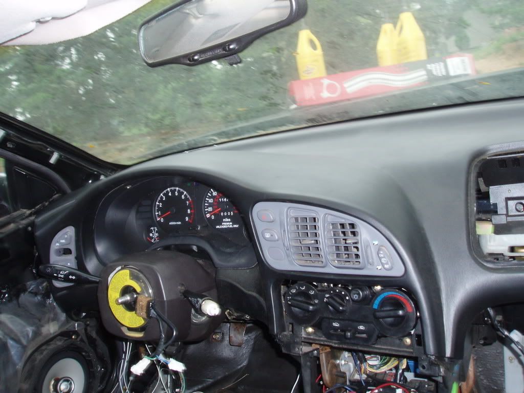

I painted/dyed the interior panels, got tired of the grey. New carpet
Had to repaint airbag cover because the humidity made it turn out funny.

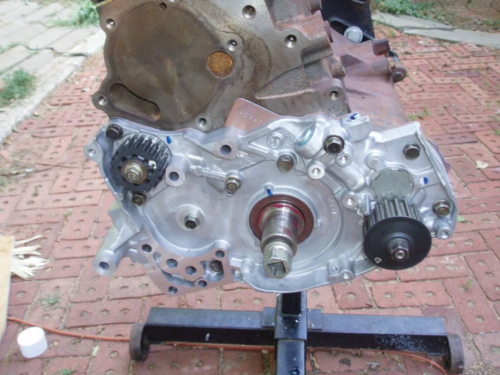

More of the parts I changed.

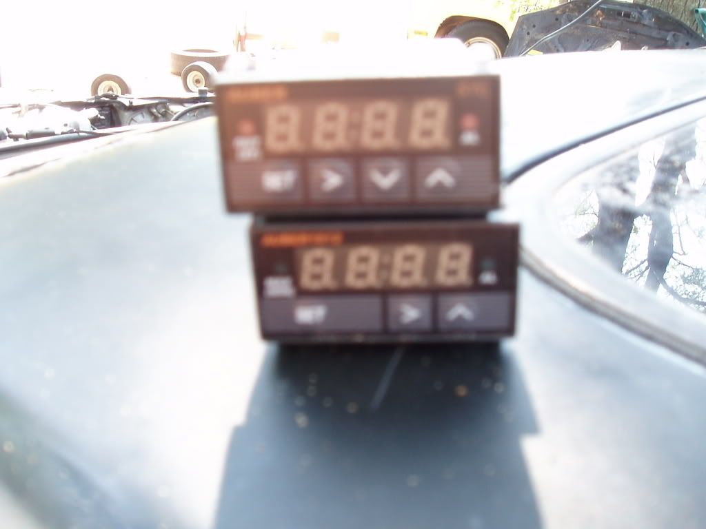

Digital EGT and water temp gauges.  They work pretty well mount easily and are cheap. Peak hold, and compatible with all sorts of sensor types.   If anyone is interested www.auberins.com

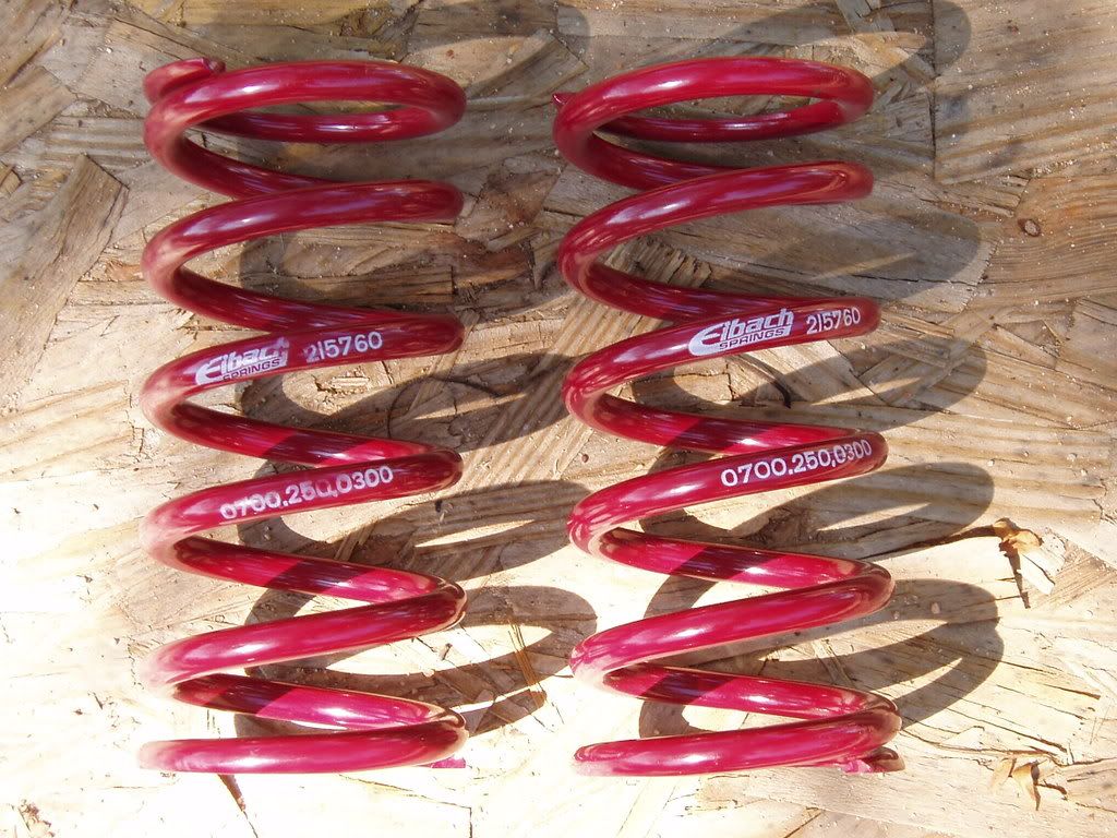

Warranty replacements for a broken rear coilover spring.

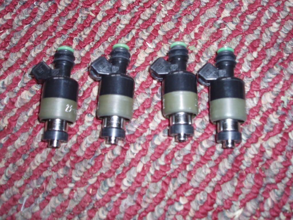

Delphi 1000cc injectors

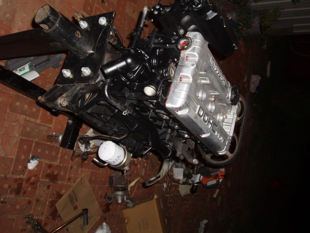

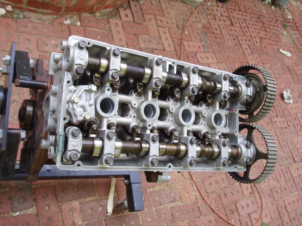

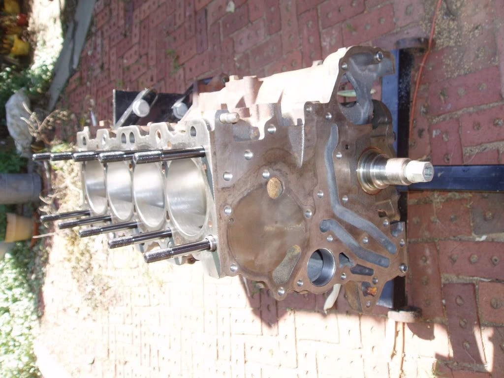

Unfinished motor back from the machine shop.
New front cover/oil pump

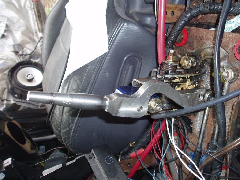

Short shifter

Actually that isn't an HMT shifter. I'm not sure what brand it is.  Got it with another DSM that I had.  Its just had the top cut off, which I hate the nice heavy momo(another freebie from another DSM) shift knob doesn't like to stay on no matter how hard its tightened. It is MUCH shorter than stock, mainly from the added throw below the pivot.

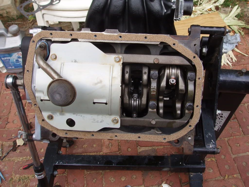

hmm i've never seen a DSM 2.4L block with the large allen plugs in the deck surface.  Is this normal on the 2.4L from the Galant?  Is it a DOHC or SOHC block?
cool shit

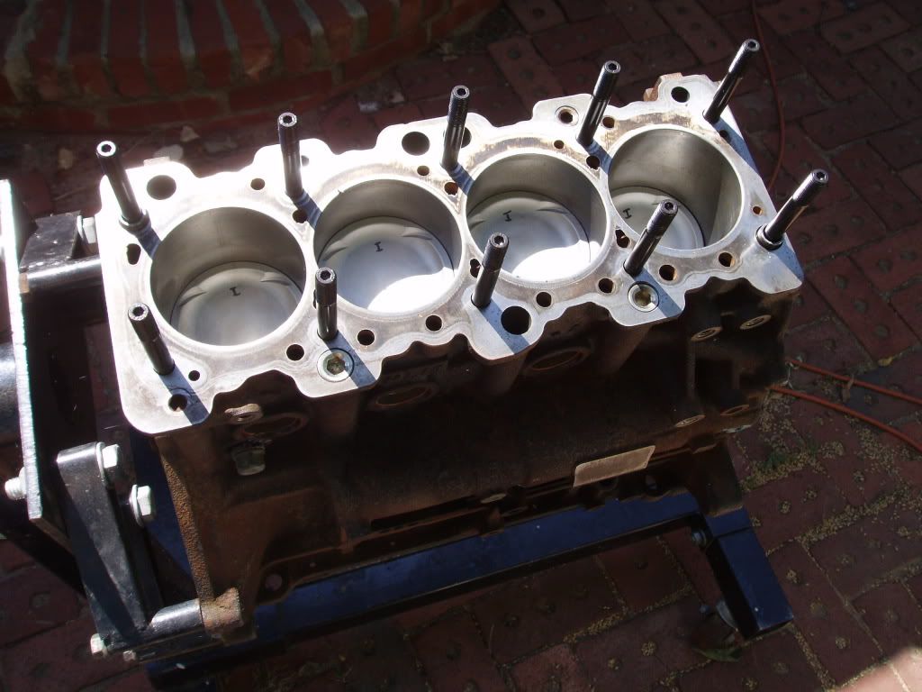

Those plugs for sealing off some oil drainback holes that are in a 4g64 block that originally came witha  SOHC head.  They don't match up with the DOHC 4g63 head.  If you get a DOHC engine they arent required as the hole is missing or in a different location.  Its been a while so I can't remember the specific engines that dont need it.
Found a picture from another guys engine that shows why they need plugged. Plug toward the top left of cyl #2.

« Reply #22 on: July 16, 2009, 09:54:11 PM »
Finally had time to start on it. Engine is out. Planning on taking it up to the machine shop monday or tuesday.

Aero  do you happen to know if a h1c 18cm housing will fit on a Hx-35 with the 20somthing cm housing?
Aero
  • Posts: 627
    • Turbotalk.org
Re: 1995 Eagle Talon TSI AWD Holset HE351VE VGT Build thread. (No 56K)
« Reply #25 on: July 17, 2009, 02:09:49 PM »
I know the bullseye housings for the H1c and Hx35 are the same. So unless its some really odd H1c then it should work.
What did the Hx35 come off of? Thats an unusually large housing for them, usually the big ones were from the older H1c's at least on the dodge trucks thats the case.

Aero, ive read your thread here and the stuff on dsmtuners.org (please shoot me, so many idiots there...)
What is your honest opinion on how well VTG in the holset 351's can control boost?  I mean assuming you have full electronic control over the actuator, which is not really that much of a hurdle, do you think that controlling boost pressures in the 25-35psi range with less than 3psi spike or drop is feasible?  This question is very relevant to my interests as I am purchasing a turbo for the colt soon, stock block/head 4g63 6bolt, probably run of the mill BC 272's etc etc.
Aero
  • Posts: 627
    • Turbotalk.org
« Reply #28 on: July 22, 2009, 11:05:35 AM »
l
IMO NOT possible.  With the VGT open as far as it will physically go(which happens anytime over ~8-10psi with the wastegate actuator moving it) I hit 24psi by ~4400 rpm at WOT.  The boost curve looks like a parabola at that point climbing at an exponential rate.
Just think of it like a turbo with a fixed 25cm housing(which is the limit of how far it will open), several guys on here run an H1c with a 18 or 21cm housing and they require a wastegate it just spools slower.
Since you will have a 2l it should occur at slightly higher RPM but even if it happened at ~5100 you still have a LOT of powerband left. You will need the external wastegate too.  There is just too much exhaust energy relative to the diesel engine they came off of.
« Reply #29 on: July 22, 2009, 11:42:52 AM »
l
Thank you thats exactly what I wanted to know.
