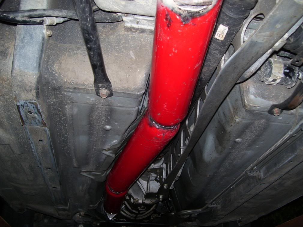

exhaust pics wish i had some of them in the car, but the fabricator took some before dropping it back on the ground. waiting for him to email me. it hugs the floor nice and tight.
Shot of the quality of the welds
remounted shift box. Much nicer and cleaner look. way more service friendly.
