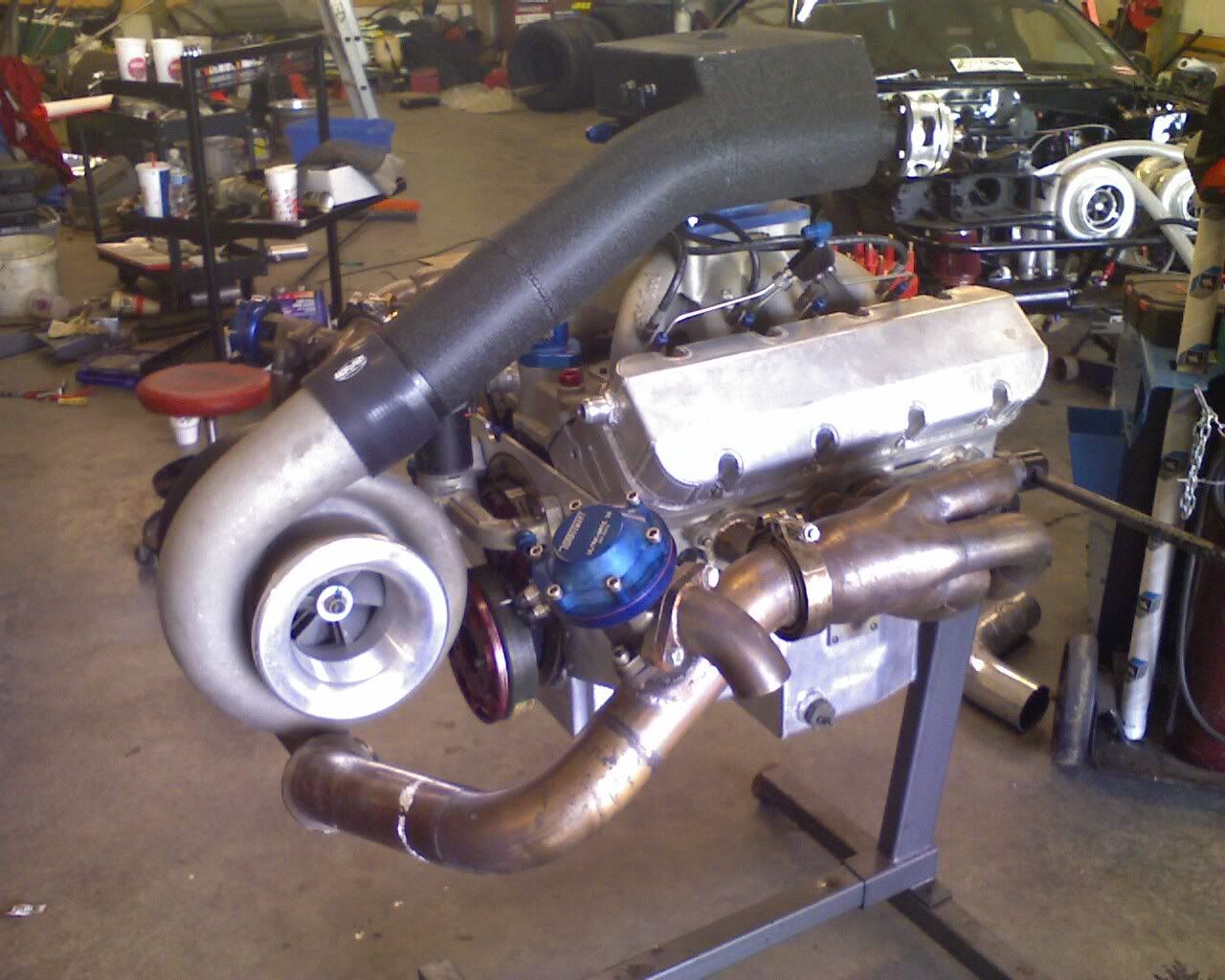

Here's a 2200 whp small block with a Ron's Flying Toilet mechanical alcohol injection setup and a mechanical advance distributor.  Sadly, this engine was only built to last a couple years of abuse because as you can see the tuner didn't use EGTs.

« Reply #20 on: September 09, 2009, 12:09:23 AM »
What an incompetent fuck hole.  They should have went with J.Davis     :yes:
That is so cool. It'd feel so awesome to get to work on something like that.
Re: Ignition timing vs EGT's
« Reply #21 on: September 09, 2009, 12:16:30 AM »
They also should have let Full-Rice make the manifolds.  As you can plainly see, those are not merge collector manifolds.  The fucking fools.

« Reply #22 on: September 09, 2009, 12:21:41 AM »
And the runners are not even close to equal length  >:(  everyone knows how absolutely critical that is.
