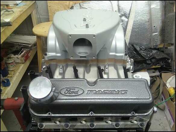

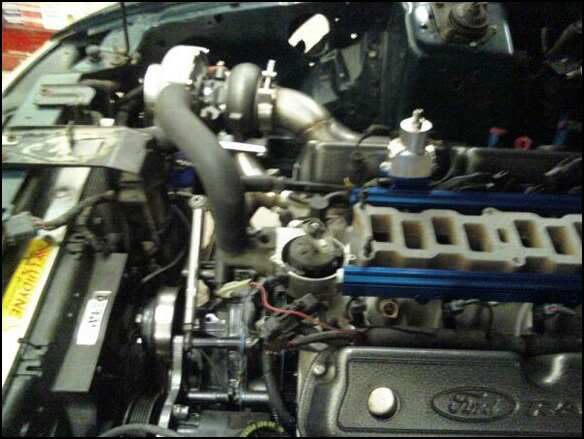

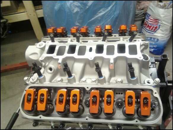

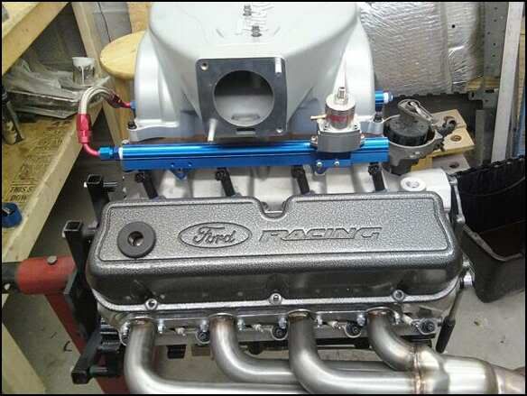

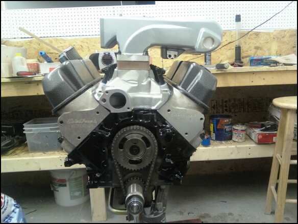

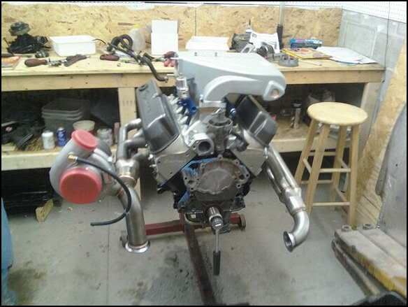

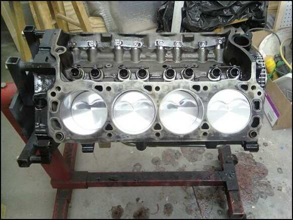

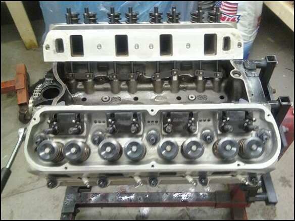

Added turbonetics 76mm turbo, bigger throttle body and a little more boost.  555 hp and 579 torque thru the aod.
turb342.wmv
Forged pistons,eagle stroker crank and rods, comp link bar solid roller lifters, custom turbo cam
dur @ .050 int 237   ex 243
gross lift int .625      ex .609
lobe separation 114
Victor jr heads, arp studs, fel pro gaskets, k-motion springs
Harland sharp rockers, trick flow lower, 80lb injectors,
Boost brothers turbo kit with their t-67 turbo. Gonna get upgraded to a mp t-76

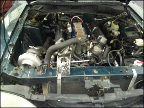

Engine is in, Built lentech aod is in, Got most of the efi harness in, Most of the turbo kit on.
I'll throw up some nice high quality cell phone camera pics.

Out here they have a decent reputation. No worse than any other trans company. I've seen and broken almost everything out there. Anything specific to watch out for with the lentech?
