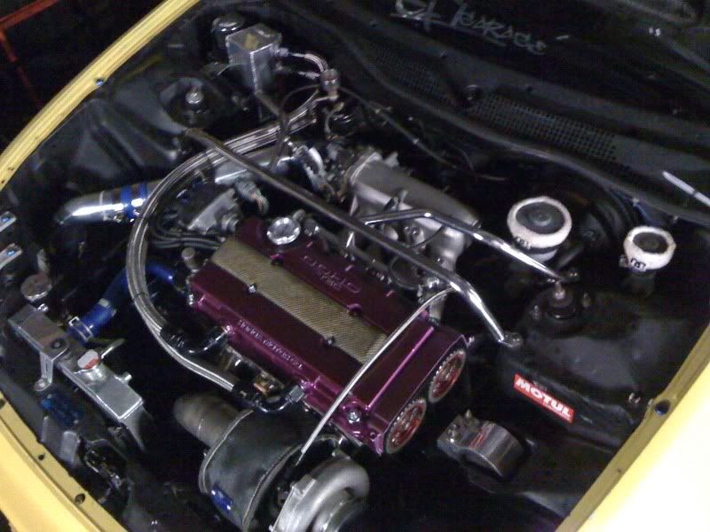

By the way I was right too... Not some overly complicateted and totally left field ignition issue... The inlet to the fuel rail was hollow on the end... and it had a fuel dampener with the correct crush washer with the cutouts for the fuel to flow around (like this):
What the fitting DIDNT have was a pair of holes drilled perpendicular to the inlet barb that is located inside the banjo (the one  in the barb that feeds the rail that the banjo goes over) drilled a hole in that fucker and took the revlimiter off of it to see whnat happened to AFs. They dove into the 9s at 9 PSI all the way out to 9k at 9PSI.

401/298 18psi bone stock LS bottom end/Gsr head, because of the 5psi spring we couldn't make any more power/get the boost turned up above 18psi.  401 is plenty of fun though, the car is fixed obviously, thanks Spiker, Josh, Marcus, Leed, everyone that has been there for multiple dyno sessions for hours upon end racking their brains with me.  Really, I appreciate every bit of it.
And thank you very much LeeD for the amazing tune, the car starts, idles and drives partial throttle like a stock car, it just happens to get really rowdy when its to the wood.
