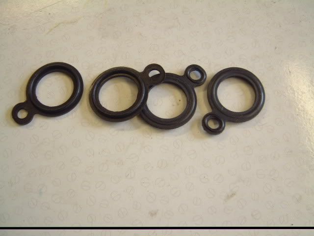

look like this except not with the extra bung hole

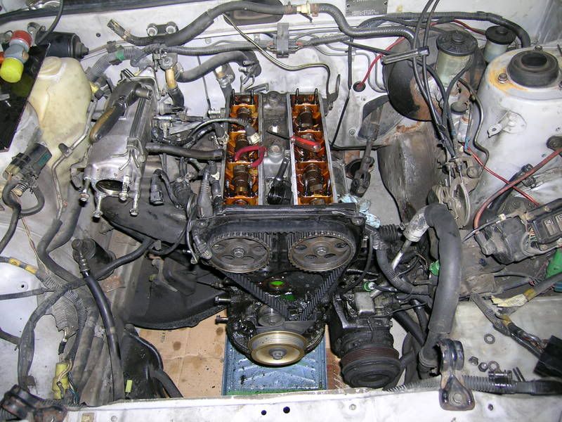

« Reply #8 on: October 18, 2009, 08:46:39 PM »
4a plugs go straight into the head. Check the 17mm allen plugs that are visible in the top of the head, if your sure its not the VC gasket.

« Reply #9 on: October 18, 2009, 09:12:39 PM »
this is what im leaning towards. but i was looking at those huge things, and thinking how could those be leaking.
ill check them.
sorry but this is the only pic i had of the swine flu, leaky, infected area.
