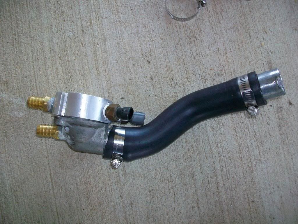

Have any you fellas even ran a temp probe into the water neck (outlet hose side)  of a vehicle to see what the temperature of the coolant was doing?  I have, it was to see how far off a temp gauge was on a car.  I did not see this oscillation , that your theory infers, of outlet temperatures.  In fact it was quite steady.  It climbed until the fans came on, then dropped until they shut off.
According to service manual data, the cooling fan switch is closed(fan on) above 199 degrees F.  So, I was wrong about the lower temp fan switch as I thought that Honduhs had a switch point almost as high as older GM vehicles at ~235 degrees F.
Re: Cooling Issues
« Reply #160 on: October 31, 2009, 02:33:22 PM »
Yeap. Two before the thermostat.(thermostat between spacer and water outlet)

I have mine mounted in the place of the bleeder valve on the water neck.
That is nowhere near the thermostat.
Still you should be able to see a trend. Do you see temperature swings in the > 30° F range while the coolant in the block sees a relatively stable temperature?  Also, think about the location of the ECT and temperature sending unit.  They happen to both be in very close proximity to the water neck, aka the inlet for cooled coolant.  Why have I never seen these temp swings while datalogging while tuning?
Thermal transfer takes time, and when the engine is steadily putting out heat it's hard to get it to drop a full 30 degrees, also who says it's a 30 degree drop when the thermostat just wants to see some amount of drop?.  All the same, I have and do see temp drops when thermostats open on a number of different cars.  Despite the fact that Honda ECTs aren't a "fast response" type sensor.
