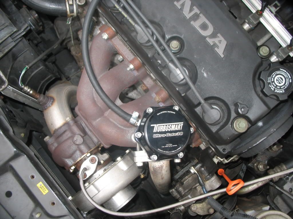

Turbo, manifold and wastegate.  I need to figure out what to do for a filter.  There is no space at all

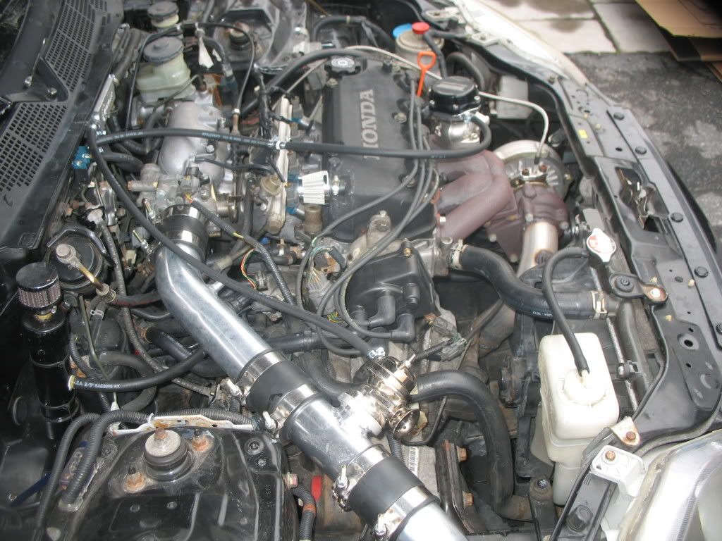

Side View...Looks like a cluster fuck...I have to clean up the engine bay sometime soon.

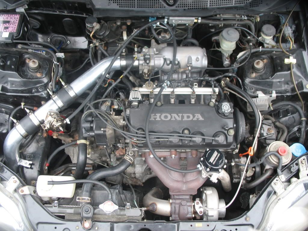

Money Shot ;D
It's all done for the most part.  Now all I need to do is get it tuned and clean up my install.

yeah nice setup.... but your engine bay is FUCKED you need to de O0 that
Yeah it's all  O0'ed up.  I have to re route the vacuum lines and get some new ground wires.  Engine bay needs a good scrubbing too...

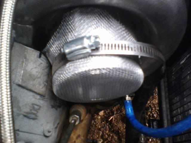

Here's a pic of mine, but ideally you want to pick up ambient air not the same hot ass air that just went thru you intercooler and in as in my case the radiator and the condensor.
