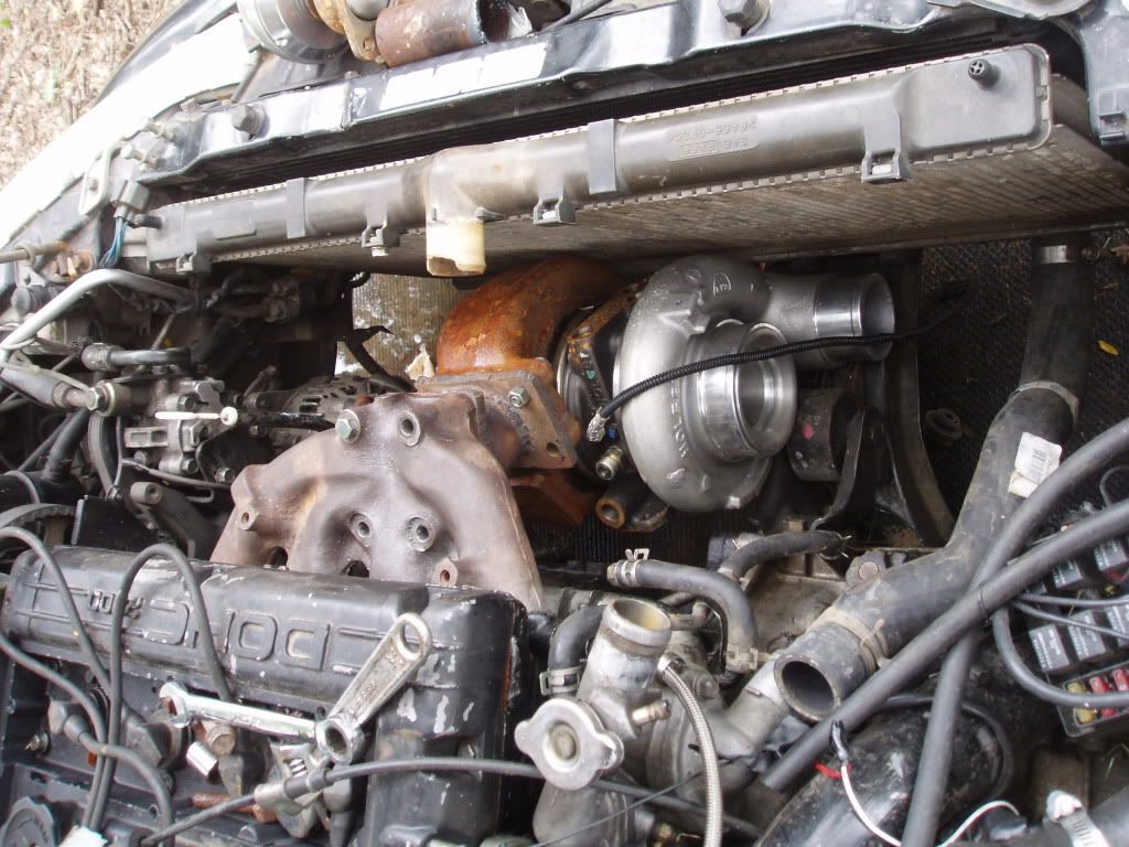

Decided to put this up' its already in my build thread, but it feels like it belongs here too.

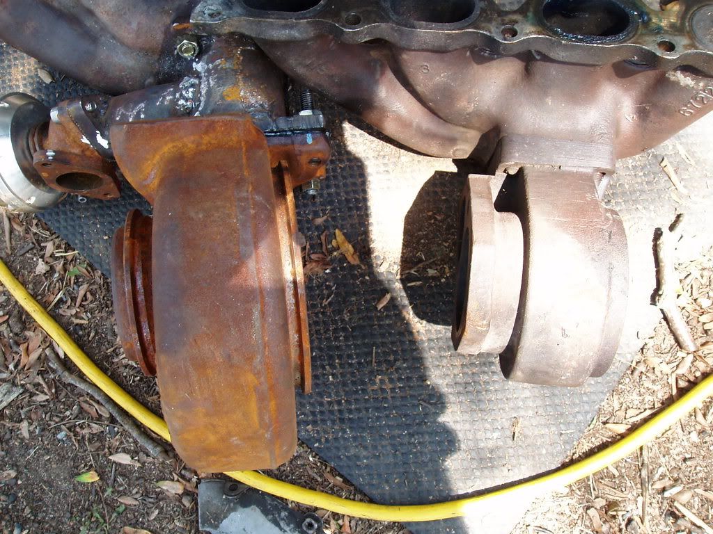

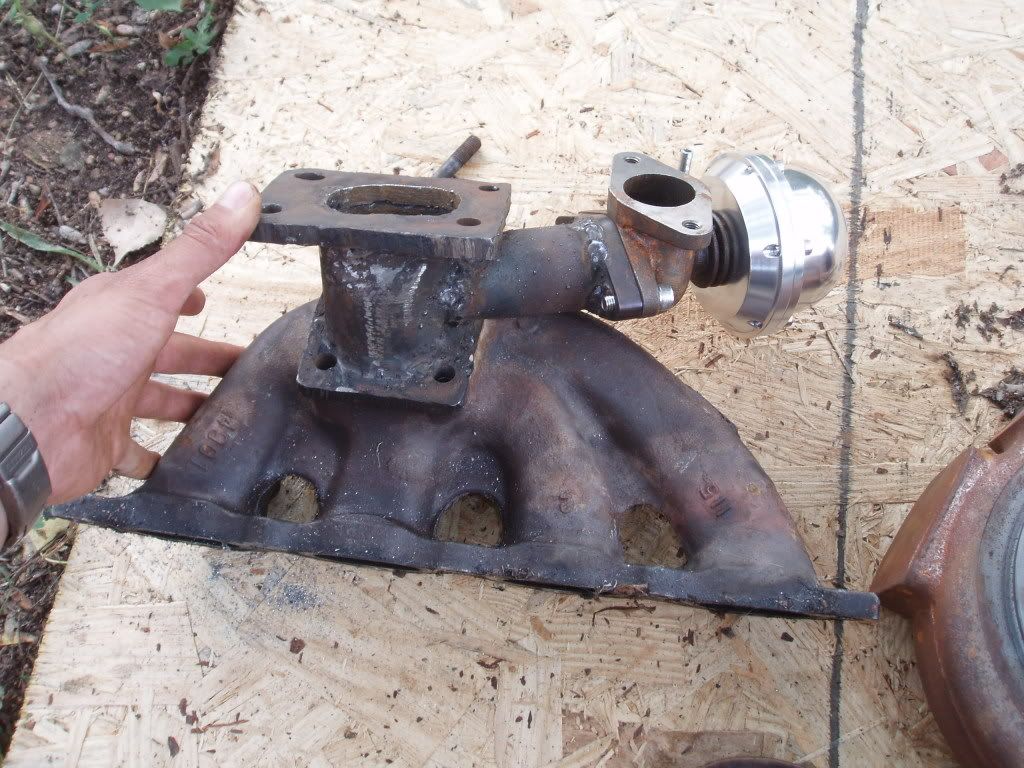

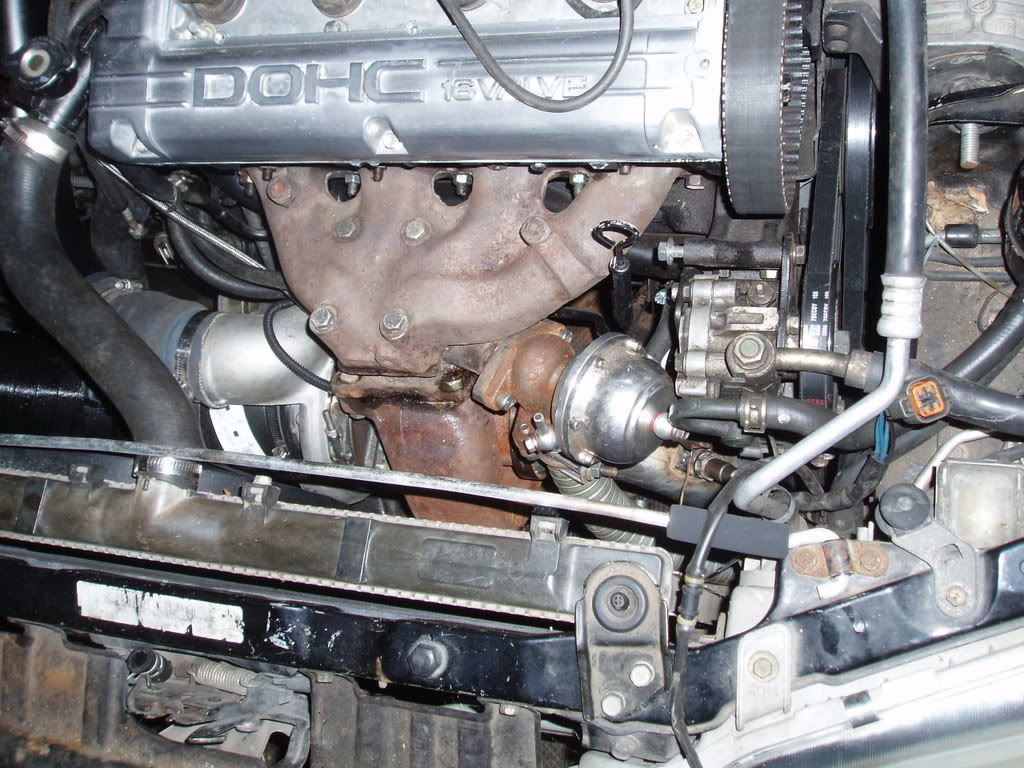

Its ugly, but it does what I wanted it to. And that is 3 things.  Move the turbo down and forward, give a place to mount the external gate, and adapt from a mitsu flange, to a non standard holset pattern.
Its made 100% from stuff out of the farm junk pile and welded using my dad's rHMT style stick welder.   :yes:
A big ass alternator on our service truck with two switches, one to remove the battery from the charging circuit, and one momentary switch mounted on the stinger that removes the regulator from the circuit for max voltage.
And in progress/test fitting before finishing welding and adding the WG tube.
Finished and ready to run.

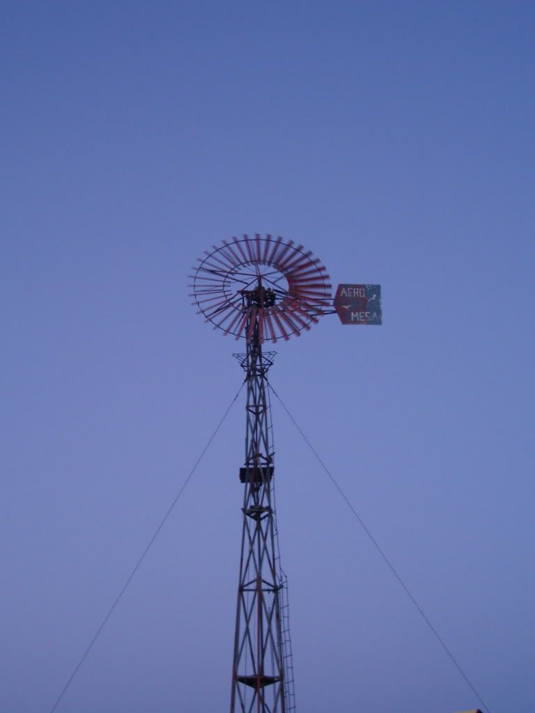

Built a water pumping windmill himself, using a welded rear differential to convert to the pump stroke at the top of the tower.

the flex pipe for the wastegate is pur sexiness.

love the rhmt water pump wind mill
It works so well I don't know why more people don't use it.

I've gotta find the picture of when it was knocked over by o tornado when I was a couple years old.  It broke off and layed over, so he ended up cutting the tower off where it broke and moving it to where it is located now.   Oh yeah, the first well for the windmill he dug himself.  Using sand bucket, a pulley system, and the rope around an extra rim attatched to the wheel on his beetle.  Put it up on blocks and run in fwd or reverse to raise and lower the bucket in the hole.

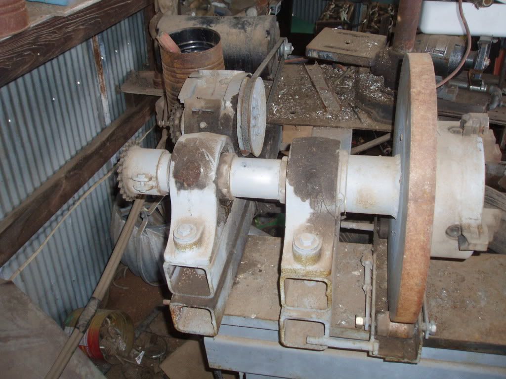

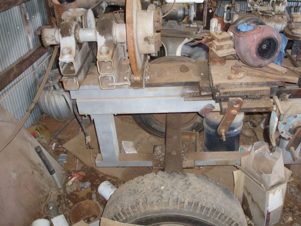

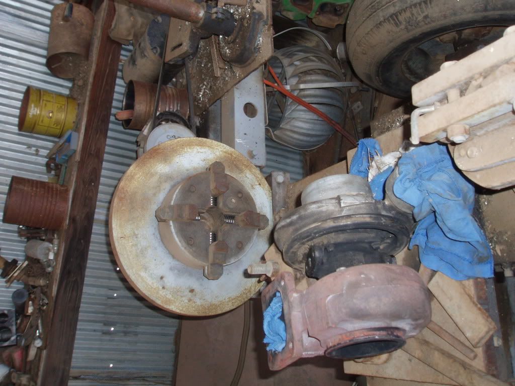

Then there is the homemade on a trailer lathe so its portable.  Speeds controlled with a motorcycle gearbox, powered by a 12v dc motor.

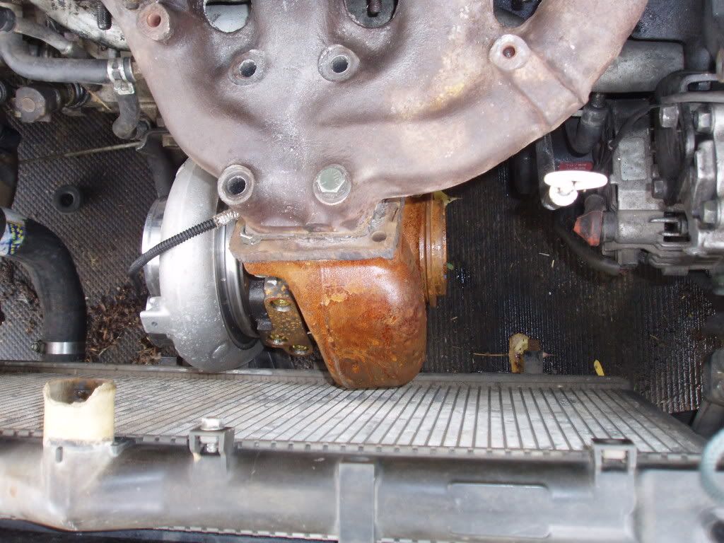

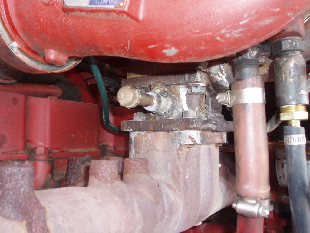

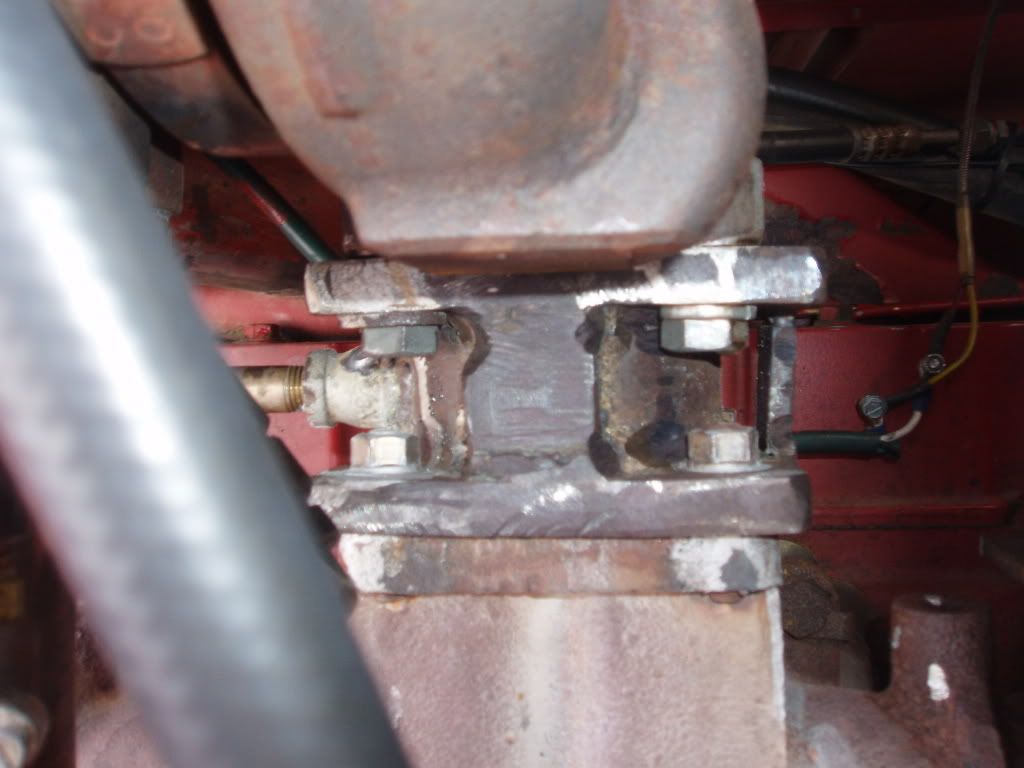

The adapter he fabbed to mount the HE551V VGT on the 8.3 cummins powered combine.
His homemade lathe on a trailer, its too bad it hasn't been used in years and would need some work.

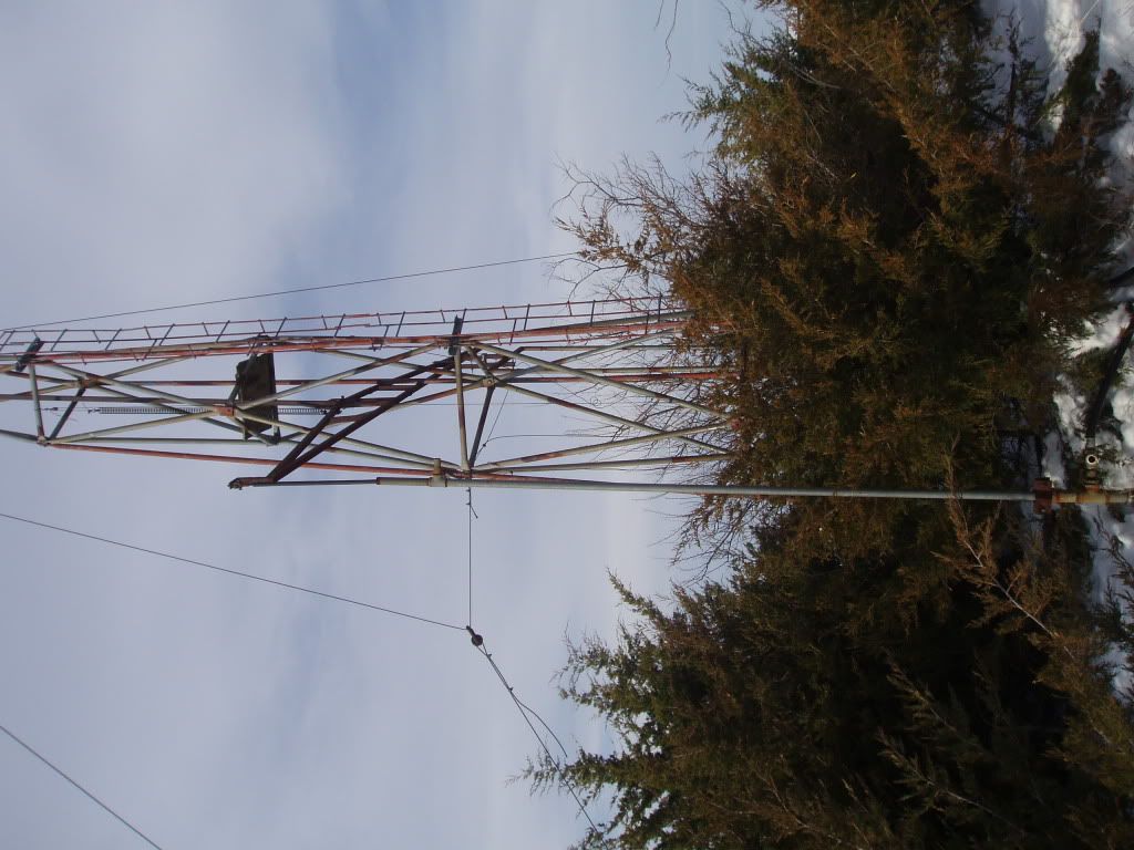

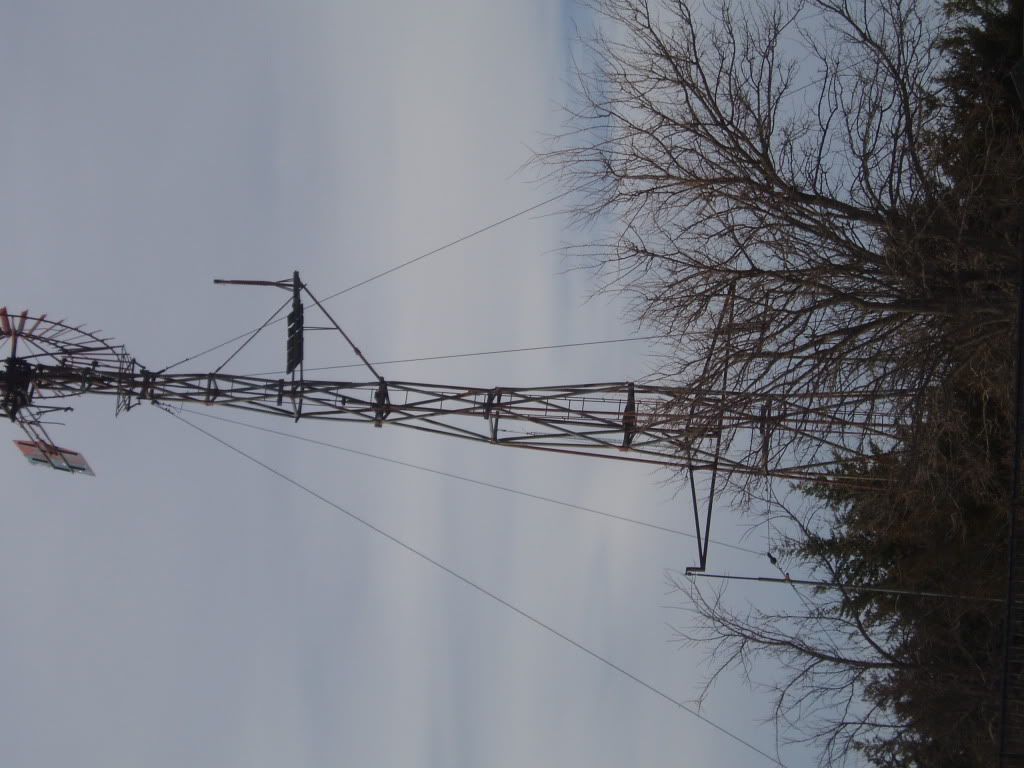

A couple more of the windmill. Has the arm thing here to extend the stroke length and offset it so the well isn't directly over the well. Makes it much easier to pull the sand point out etc.  It needs work too, hasn't pumped water in a while.  :-\

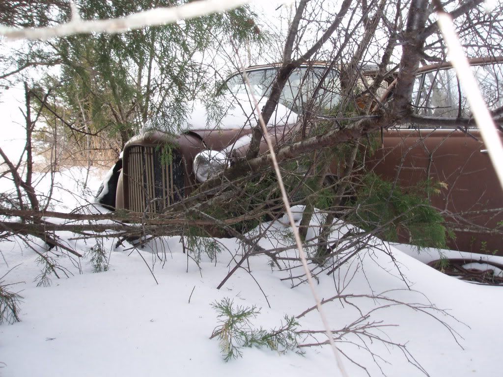

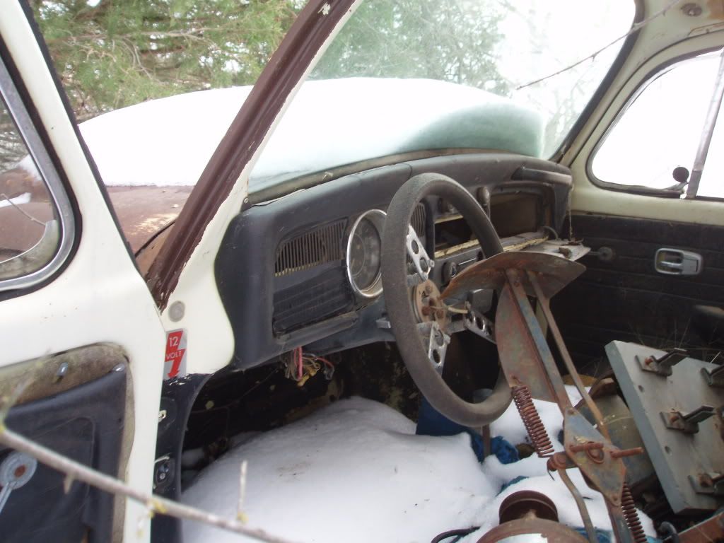

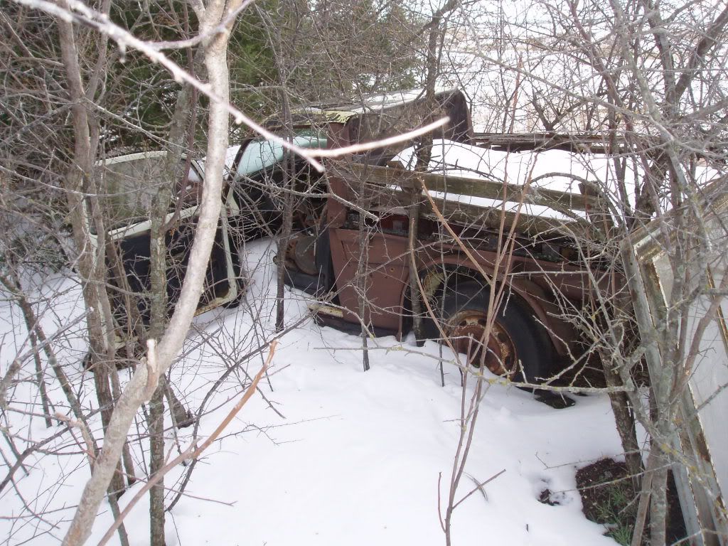

VW beetle he turned into a truck like 30 years ago.

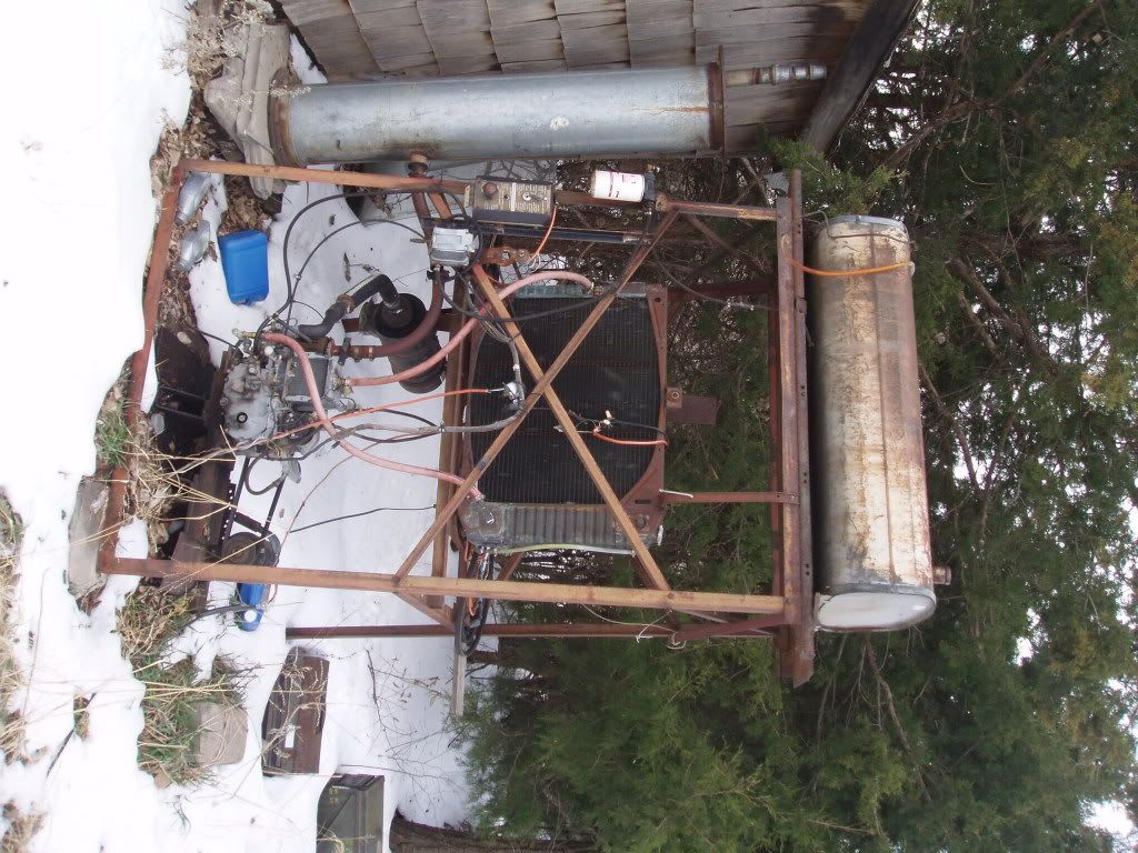

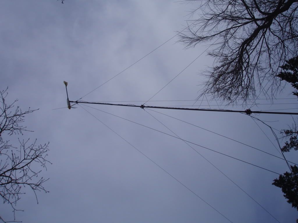

The wind generator partially powering our home.
Backup diesel generator.

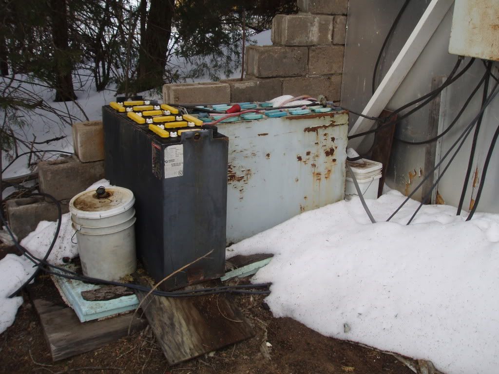

The batteries, two 24volt forklift batteries.

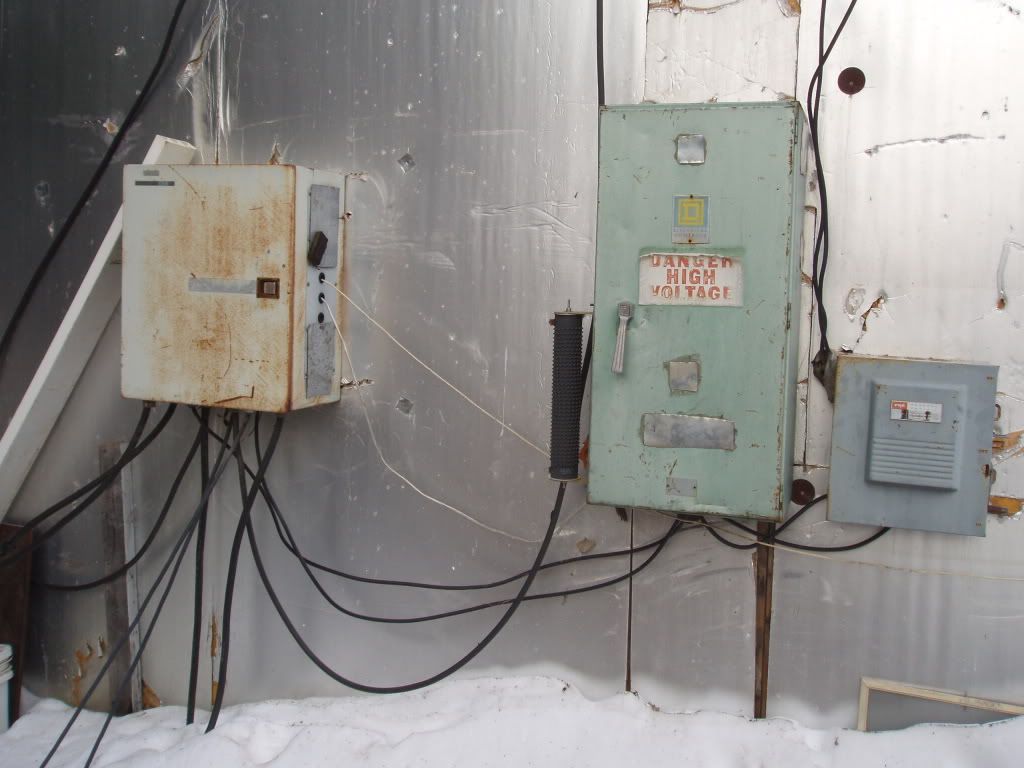

Electrical distribution, and the high voltage is a lie.  :P

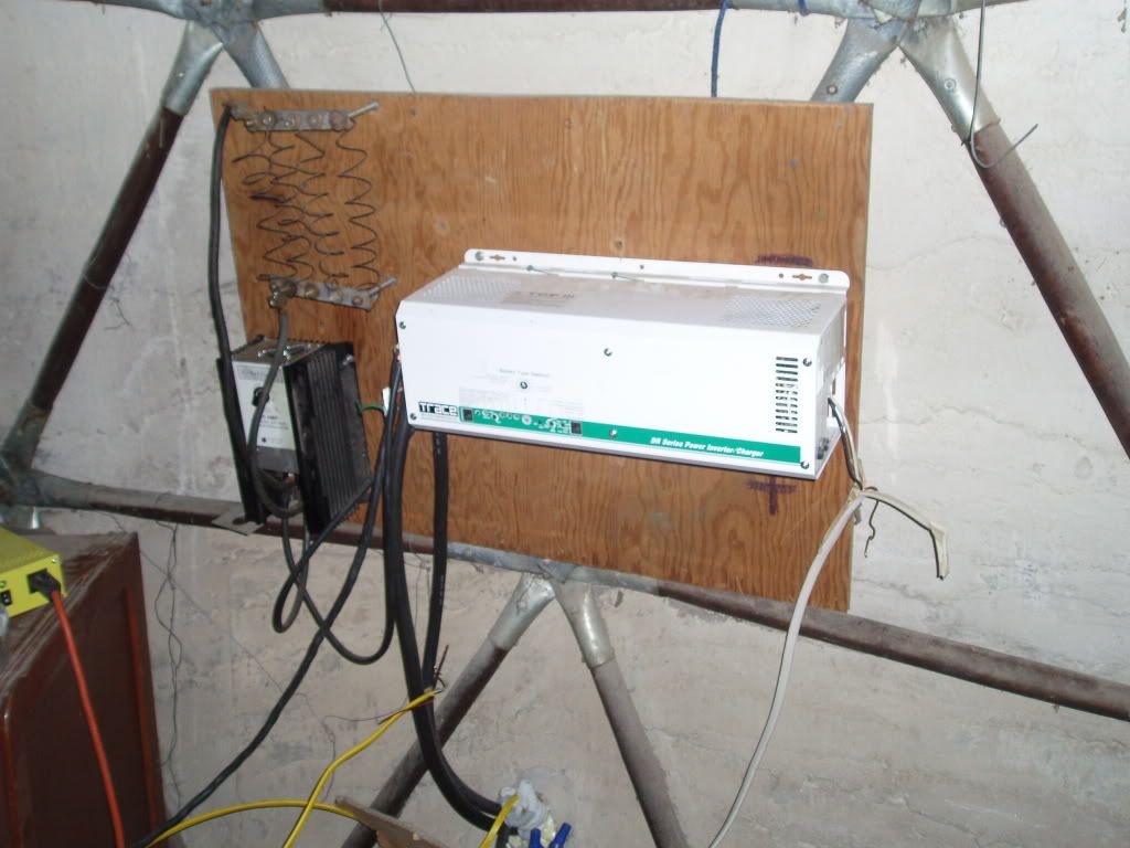

The 3600 watt Trace inverter converting the 24v to 110 for home use. Only thing we don't have there is air conditioning.

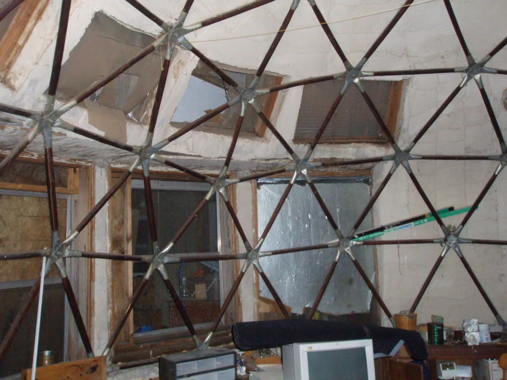

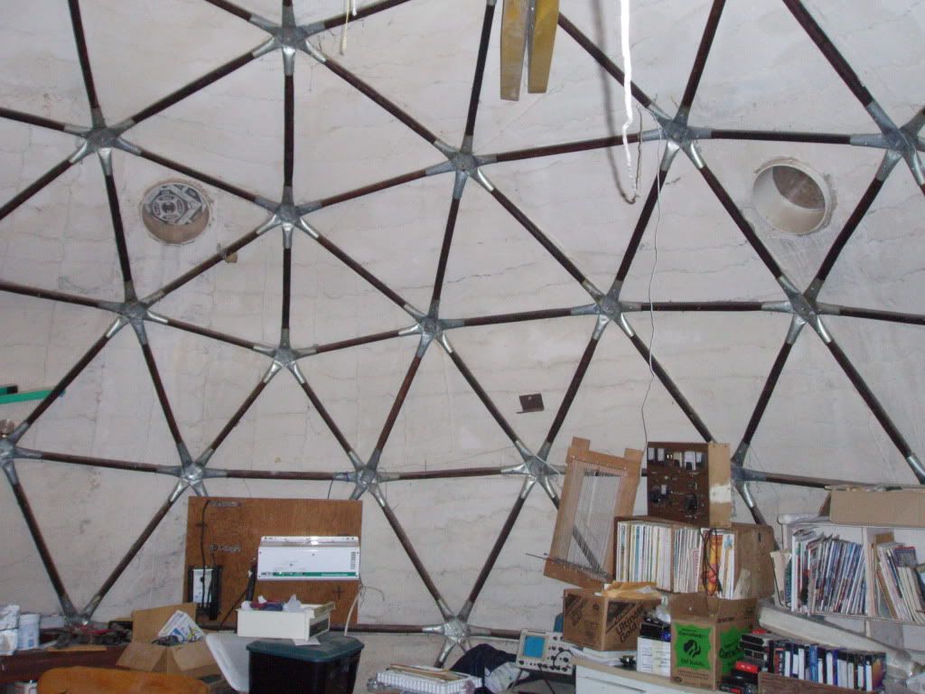

The concrete dome he built by hand, mixing and carrying all the concrete by hand, using water from the well he drilled on his own. lol
Lived in it until I was 5 or so, then my mom started building the rest of our house. Its been added onto in sections over the last 20 years lol.

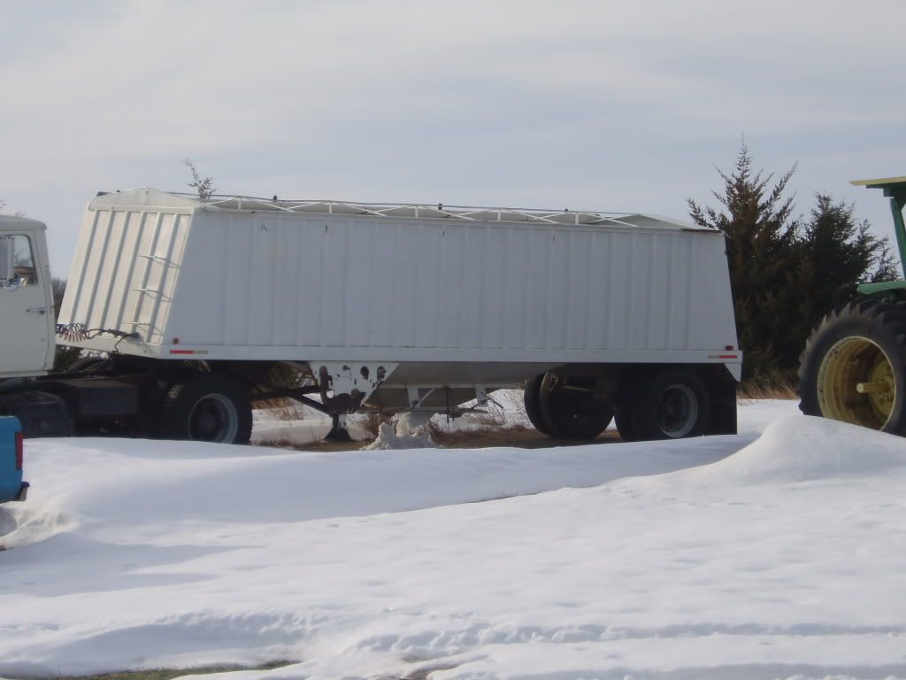

The grain trailer my dad and I built.

The vw truck/bug thing hasn't been driven in probably 20 years.  The lathe and windmill haven't been used in a few years either.  He has too many things going on anymore to do a whole lot to that stuff unfortunately.   Takes care of all the dirt roads in the township, him and my mom take care of a good size cemetery, then there is the lucal custom harvesting business that takes several months out of the year.Maintaining all the equipment too.

Its pretty cool that the windmill will lay completely over with the use of a tractor.
Thanks guys.  I'm gonna have to climb the thing and take some pictures of the windmill up top.  To go from the wheel to the up down stroke its the rear dif out of a truck, welded and an arm welded on the hub flange for the up down.
The reason it doesn't work anymore is the weld on the arm broke and we haven't had the motivation to lay it down and reweld and fix it.
