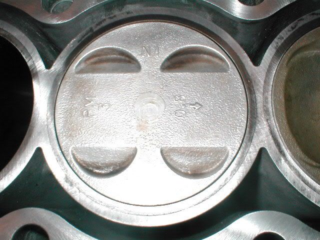

« Reply #23 on: March 26, 2009, 02:28:56 AM »
before
after
only used a small brass scrub brush
