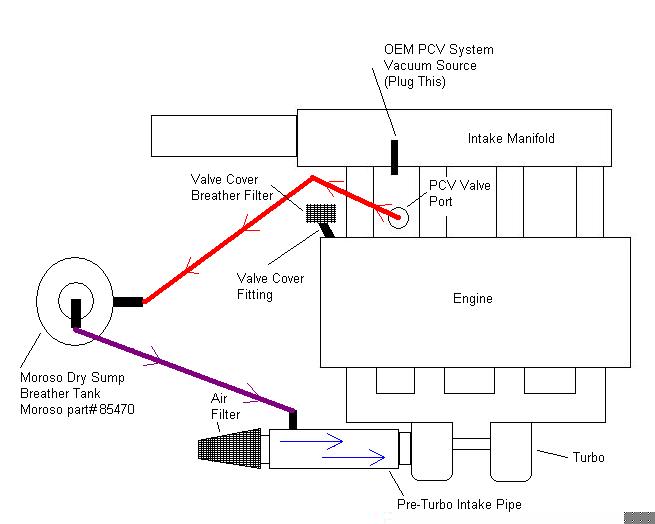

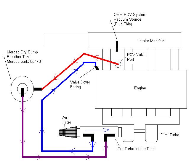

I have no oil in my catch can, only water and gas (well, smell like it)... I know the blow by has a lot of water into it, but... I don't know.
I use the turbo inlet as a vacuum into the catch can and the catch can is hooked to the modded PCV valve.
Now that I look at the drawing, it's more an hybrid between these 2 types

In fact, the blow by goes into the catch can. I use a vacuum to get it out of motor, but many people said that you don't need vacuum and it will go in the catch can anyway.
In the pics, the PCV valve is replaced by a L fitting or a modded PCV valve.
This is how I did it. http://www.realhomemadeturbo.com/forum/index.php?topic=5043.msg75161#msg75161
BTW, I never noticed you posted a question about the setup!
There are 2 hoses in the setup. One from the modded PCV to the catch can and one from the catch can to the turbo inlet.

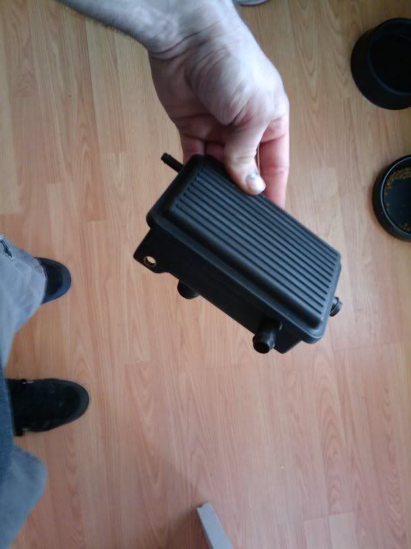

oil vapor seperator from a GM quad4:
$2 at the JY.
