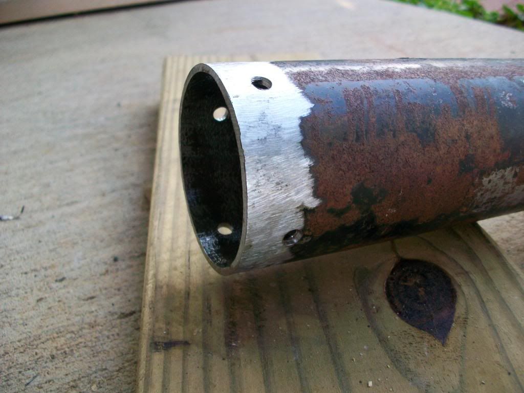

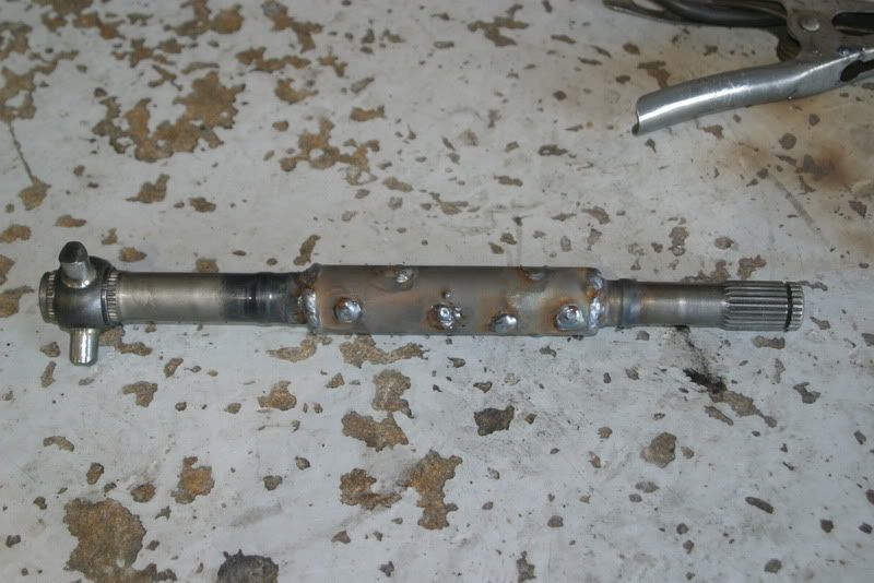

Love the axle shaft,  I've been rocking a butt welded drive shaft for 3 years now :)

I wonder what the runout on these half-shafts are...?
Re: The only worthy HT thread of 2009
« Reply #7 on: December 02, 2009, 11:26:58 AM »
so i guess all the weight from the weld n shit wouldn't matter?  I would think it has to be balanced fairly well for it not to destroy the tranny or bearings or some shit.
anyone want to educate me on why that's cool?
« Reply #8 on: December 02, 2009, 11:30:04 AM »
I think it would still handle well... again with a 3 psi wastegate spring.  That swap is way lighter than the cast block 1.8 that came out of it.

« Reply #16 on: December 02, 2009, 06:54:37 PM »
I assumed that those extra weld spots on the shaft are to balance it. If not, I don't know what the hell they're for.

« Reply #18 on: December 02, 2009, 07:00:23 PM »
Drill through and fill with the welder.  It's extra structural support.
« Reply #19 on: December 02, 2009, 07:03:45 PM »
Plug welds.
The engineer in you is showing...
 ;D
« Reply #20 on: December 02, 2009, 07:06:35 PM »
Plug welds.
 ;D

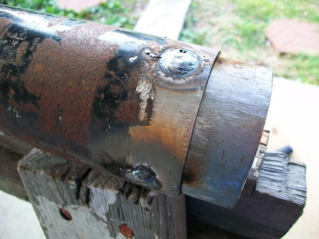

Like this...
after being ground down, I highly doubt they'll affect the balance much.

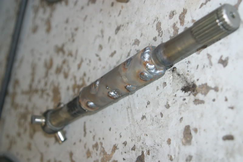

I wouldn't be too worried about the wieght as much as I would be any misalignment and or warping from welding.
Either is a pretty non issue I would think at the relatively slow speeds that an axle sees.
Probably will only see about 2000 RPM and with the small radius about the axis of rotatoin, I don't see it being that big of a deal.
I could be, and probably am, wrong though.
« Reply #22 on: December 02, 2009, 07:14:58 PM »
Some of the guys at the local driveshaft shop (Asheville Powertrain) can hand weld a driveshaft and they know by looking at and handling it if it needs balancing or not.  Pretty crazy.

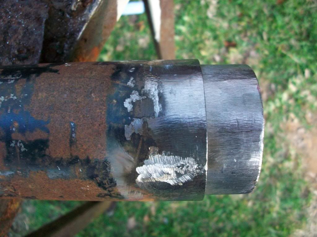

I'm aware of what plug welds are (no I didn't learn it in college), didn't look like he had a shaft all the way through the sleeve to justify plug welds all along the length. He's also got a bunch of extra weld on top there, unnecessary for plug welds.

I wouldn't worry about the weight balance on those half-shafts, I'd be more concerned about their true. A bowed shaft is going to wipe out bearings. I don't think they weigh enough, spin fast enough, or have a large enough radius for the ounce (or w/e) that they out of balance to impact service life of the attached components.
Well, it depends how you do it. If the pipe he used was a very snug fit, and he slid if over the axle for several times the diameter of the axle, then the two axles should be very close to parallel. Making several small tach welds before welding will help prevent it from warping when welding. Like when I did my driveshaft, I did a tiny tach, then turned 180* and did another tiny tach, then 90*, tach, 180, tach. So then it's got four tiny tach welds at 90* apart. Then did 4 more between those. Ground them down some,  THEN I welded the entire thing out. Keeps it from warping when welding it out.
