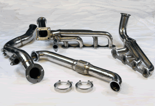

I know the quallity of ebay turbo manifolds especially the honda ones but I wanna do a turbo build on my fox body and looking for some imput on wether or not to wast money on these. I dont wanna spend the money on some long tube headers to run for one year so im looking to go boosted by this summer. Trying to get the car on the road for as cheap as possible and am debating buying these manifolds shitty stainless but v-banded with dp If there held up for 2 yrs i'd be happy. Thought about flipping the shortys and  O0in something together. but for the price should i say fuck it buy them and rock it tell it shits or is it not worth wasting the money... Looking for some input thanks

Support the turbo and I bet they will hold up for a good while.
The wastegate though I bet will off on the first bump you hit.  Especially that one next to the turbo flange,  sticks out far enough that it looks like the weight of the gate alone might rip it off.
But shit,  I bet if you add the cost of the flanges and a couple cut-off disks to cut them free it's still cheaper than buy the flanges separate.

I'm really curious if anyone has ever tried cutting & rewelding an entire CDM manifold. Some of the steel I've seen isn't half bad, so I'm wondering if it's just the welds that suck ass or maybe just the stresses from warpage.
Re: Ebay turbo manifolds
« Reply #10 on: December 04, 2009, 05:51:59 PM »
It's the welding plus the fact it's china steel. Once the metal is fatigued from poor welding theres nothing you can do to fix it. Plus the collectors are made of cheap thin stamped steel. and the wastegate is supposed to hold to that. right.

post results..... my chin chow meow manifold last me 2 years without fail, it was reinforced thou. it never cracked, the engine went first.

Reinforce it, and make sure you got flex pipes and it will last a while im sure. But if you dangle a giant turbo off of it, ya it will break if its as is.

My CDM shit broke in a month, gate broke off
good luck welding up that 50ga chinaman steel

make sure to brace the wastegate and it should work.
