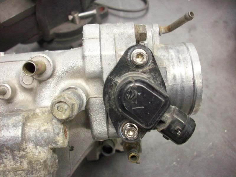

Well here is my little update.

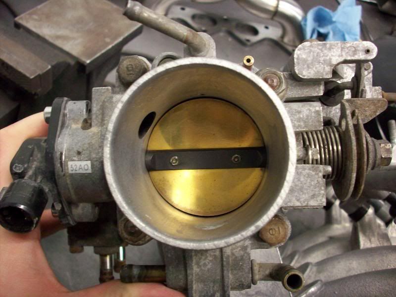

Obd 0 d16a6 intake manifold that i clean up the ports on and polished the throttle plate. I cleaned it and assembled with my 680cc injectors.
TPS removed from old IM and added with SS hardware.

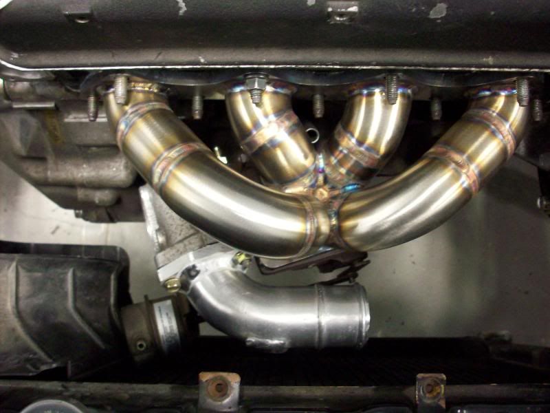

Here is the turbo outlet that i welded up. I made the 3 bolt flange and used an outlet tube of a 1g dsm smic. (btw hardest thing i ever welded as it was 3/8 plate to 16g with no room to spare for the bolts)

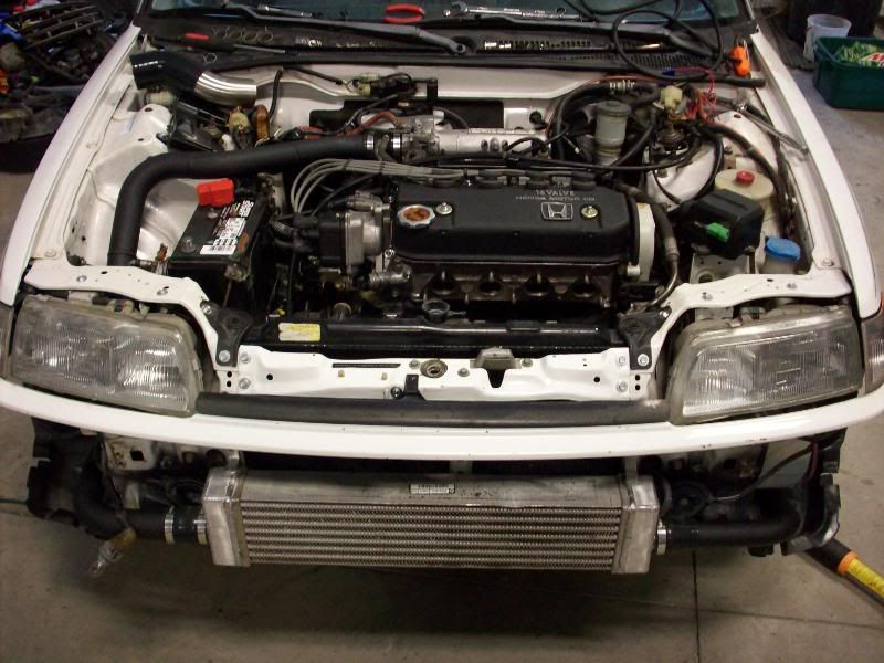

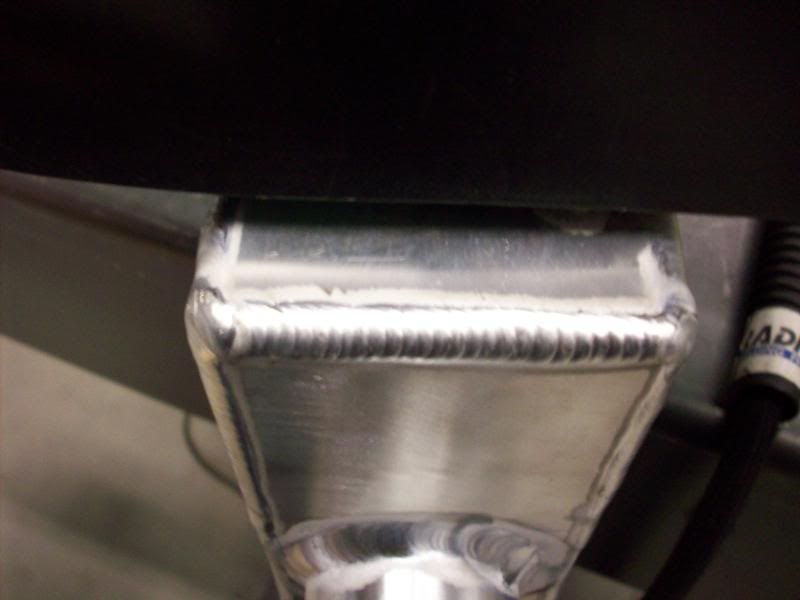

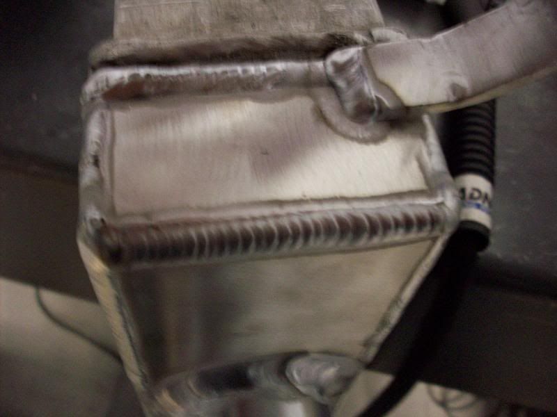

here is the srt4 intercooler core i made new end tanks for. It has 2" outlets and mounts to the radiator support. still fits the oem power steering cooler.
Here is a little shot of the welds.

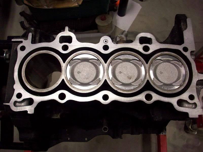

As far as i got on the engine before i screwed up a oil control ring. I'm retarded.

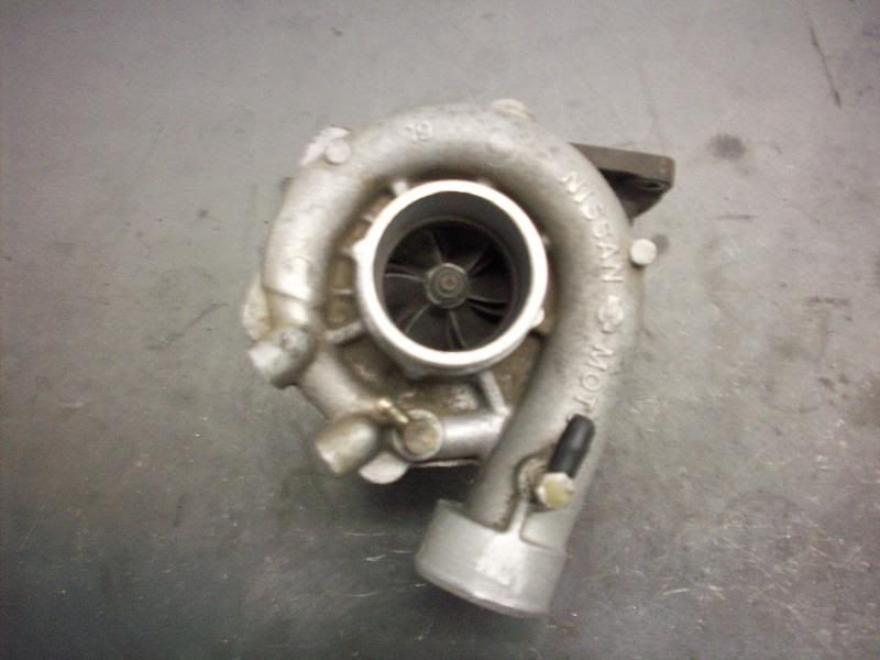

Well not much of an update on the car itself but i did find my turbo i will be running on the "summer" turbo kit.  My long search is over for the little guy.
Stock 300zx T3 60 trim, stg1 turbine .63 a/r housing.
I'm still unsure if i'm going to run the .48 a/r or the .63 a/r hot side. Goal here is for a nice fat powerband with a 7000-7200 rpm redline.
Before this goes on the car i will rebuild it and get it all cleaned up. Also i will get a wet center housing to add some longevity.

well i forgot my camera so no pictures. But i got the bottom end assembled and now i just need to get the acc. bolted up and it is ready to drop in.
All in all it went together fine, even though i was quite nervous.

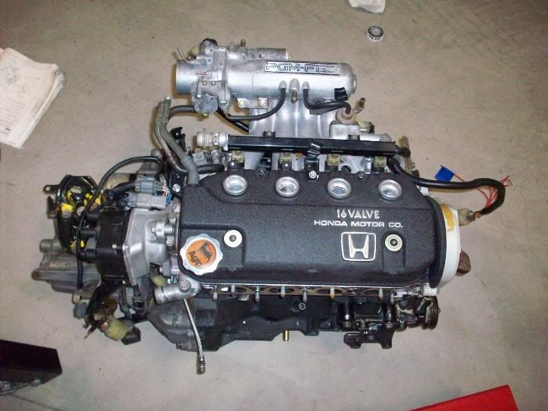

UPDATE:

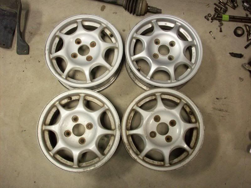

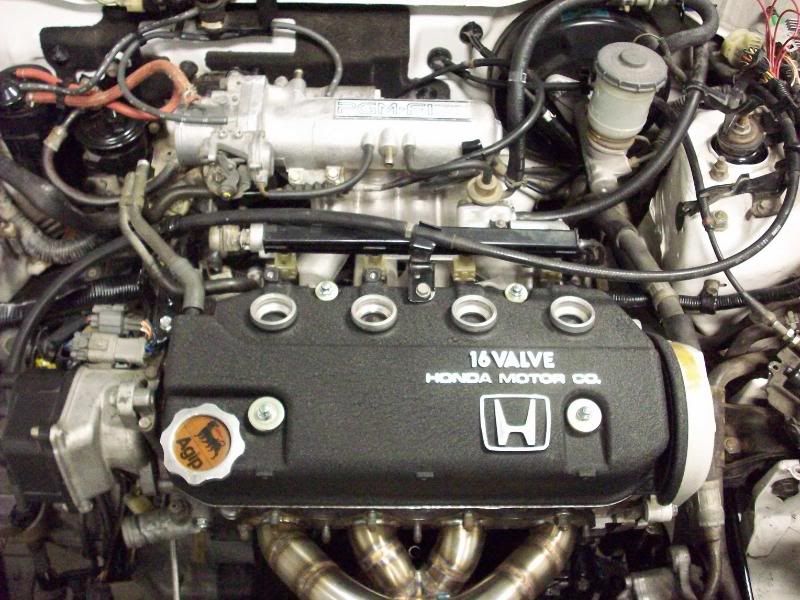

Ok so i finally got around to working on my car. Here is some progress shots. Now i just need to finish my dp and get the car on the ground. then it's time to start it and tune.
engine:
Engine in car:
freshly powder coated vc:
Vx wheels before powder coating:
I will have another update later this week.
