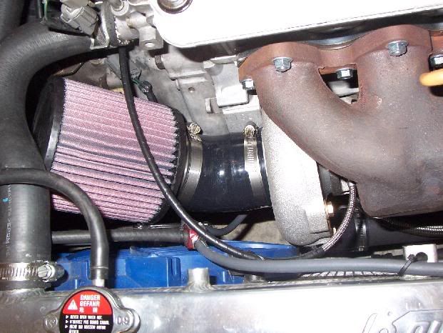

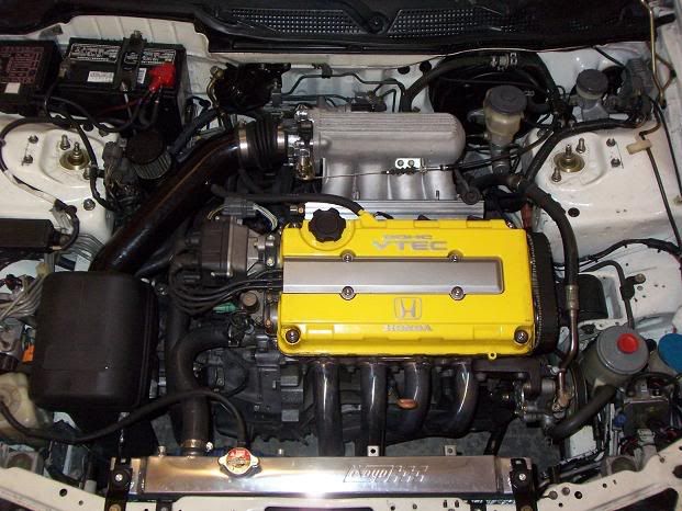

money shot

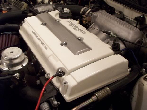

NH0 valvecover

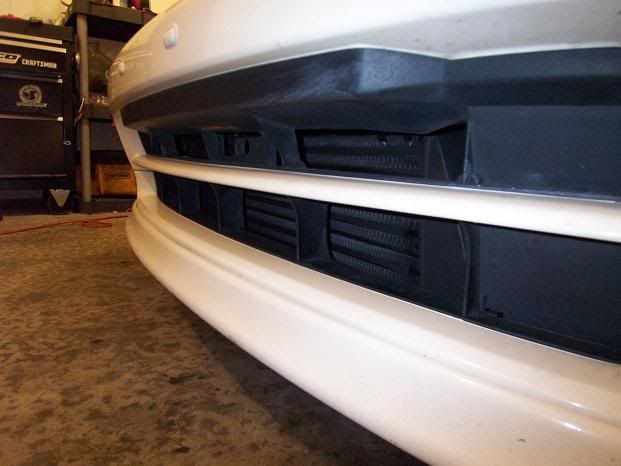

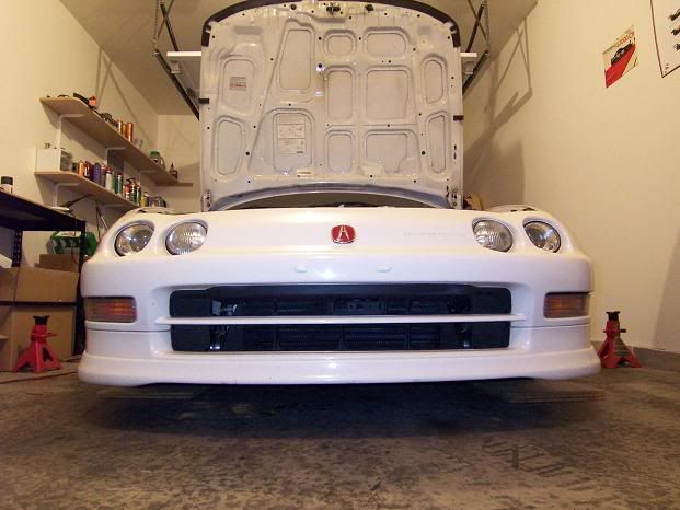

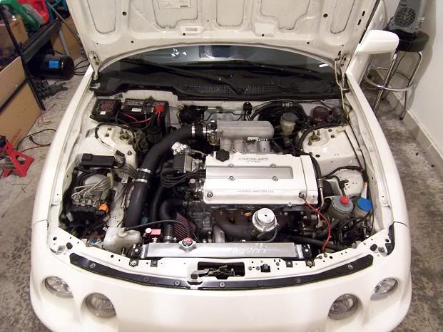

INTERCOOLER?!?!

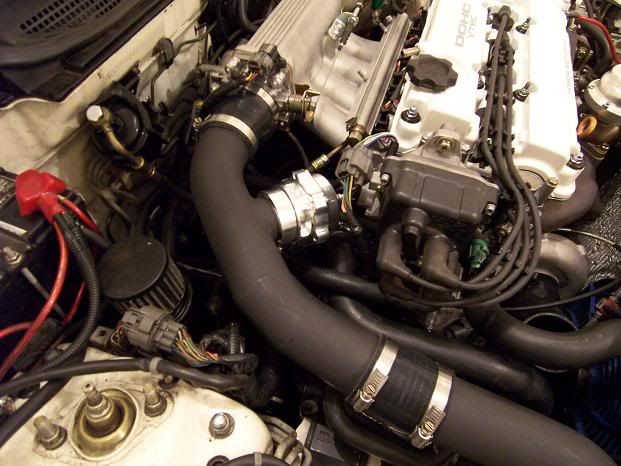

its there....

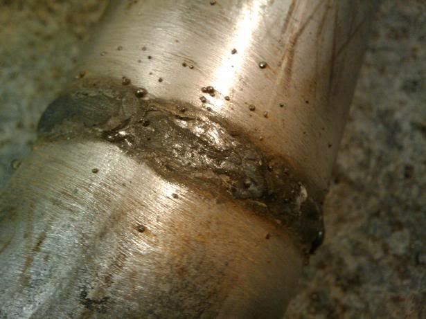

yep RHMT shit there... bitch is strait ziptied to a vent 8)

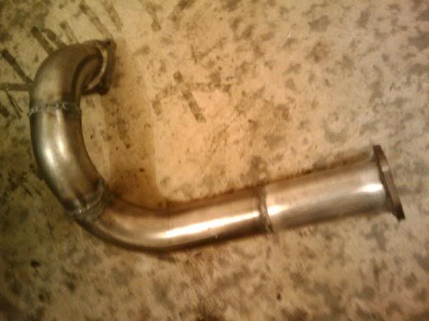

i welded up everything on this bitch. grinded smooth the upper charge pipes, but downpipe shit is still  sexy...

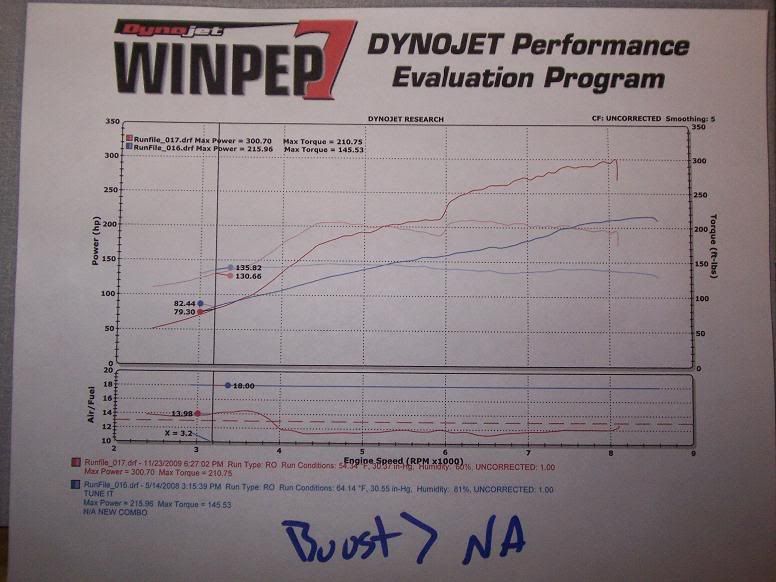

the 2.0l NA motor vs the 1.8l turbo motor

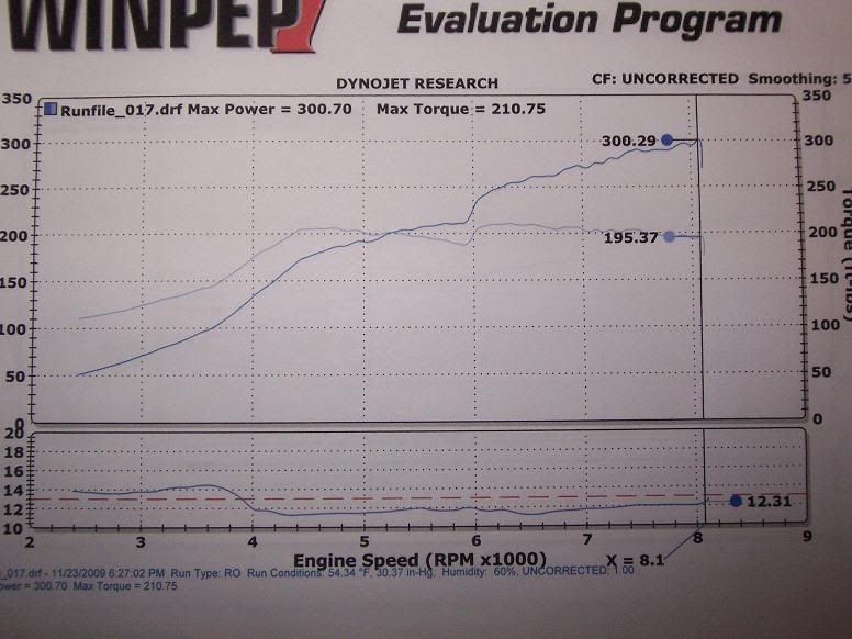

single boosted run on the 1.8l... 300.7whp & 210.7ft tq @ ~10psi on 92oct
not done yet! E85 and maybe a built motor to come :o

thats one clean build minus the weld on exhaust. Your teg makes me wanna sell my toyota to buy a teg. Keep us updated bro

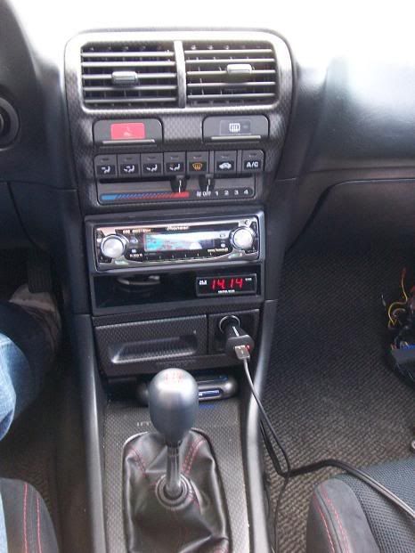

« Reply #12 on: December 23, 2009, 08:01:22 AM »
Really like the build but.... cmon
Ebay rice fake c/f vents?
Re: turbohf's newest turbo car...
« Reply #13 on: December 23, 2009, 10:29:10 AM »
thats all OEM 01 ITR shit...
also on the center shit, cluster, and my car has the JDM window swtiches with the shit on it too...
tru its carbon flux shit... but its OEM ITR shit, and i dont care to change it...
« Reply #14 on: December 23, 2009, 10:56:08 AM »

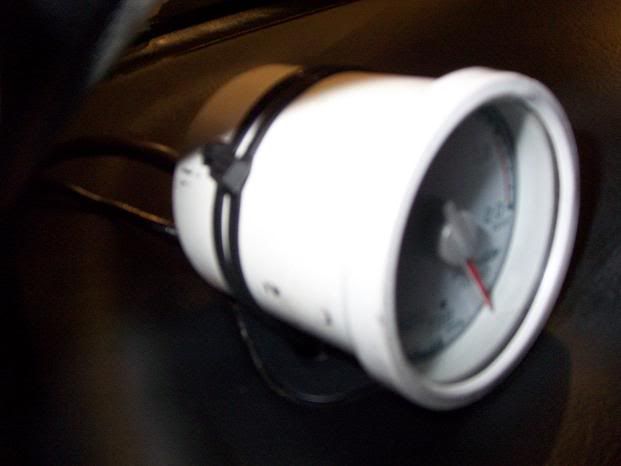

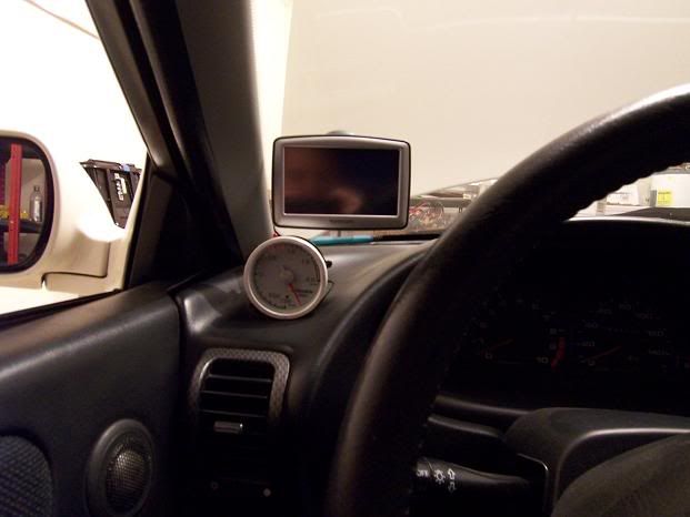

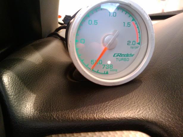

looks familiar :)
btw there is a burnt out LED in there, which is like $7 retail, but for $25 shipped for a baller boost gauge you can't bitch.
« Reply #15 on: December 23, 2009, 02:56:49 PM »
noticed it was kinda dark, but i dont like light... very vampire like lol. looks like honda dash/switch lights will fit it, but im lazy and dont care.
works great, thanks!

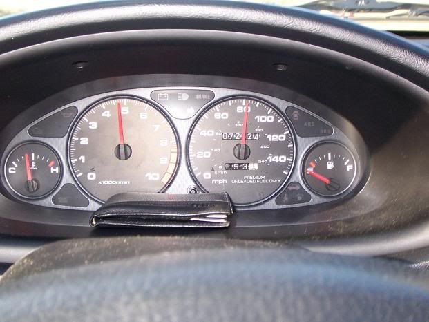

actually when that pic was taken the gas gauge didnt even work. just used my mileage and the gas light. now it works, but its off by a little still, so i can still pin it out like that before the light comes on :noel:
