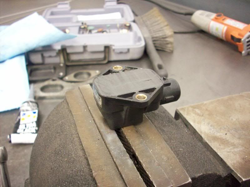

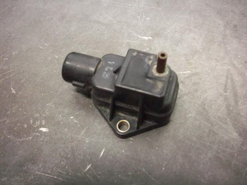

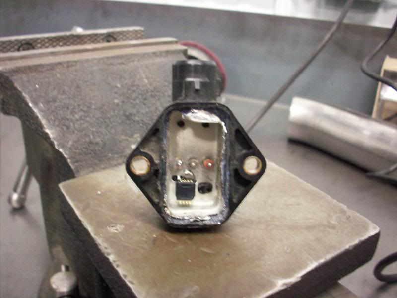

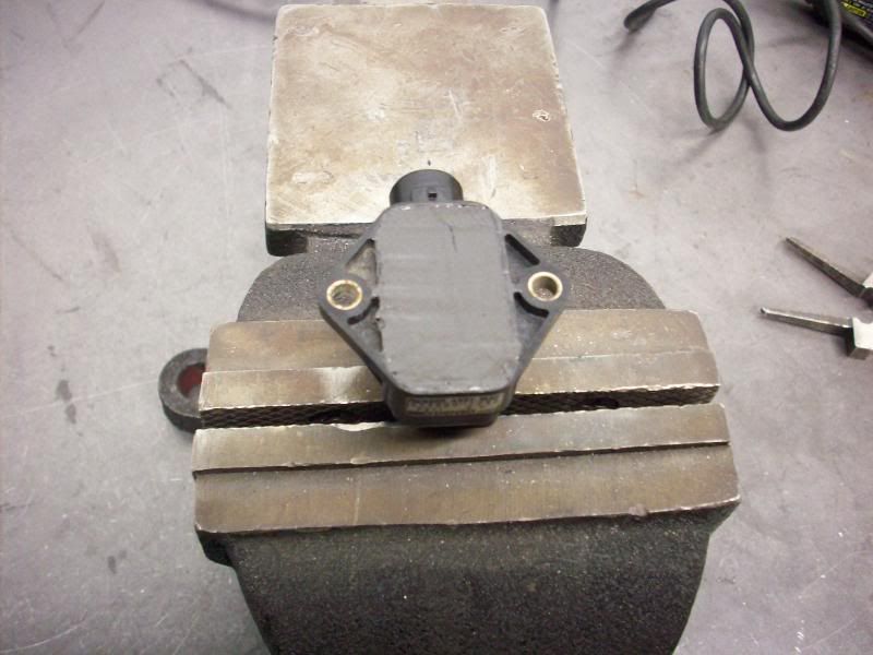

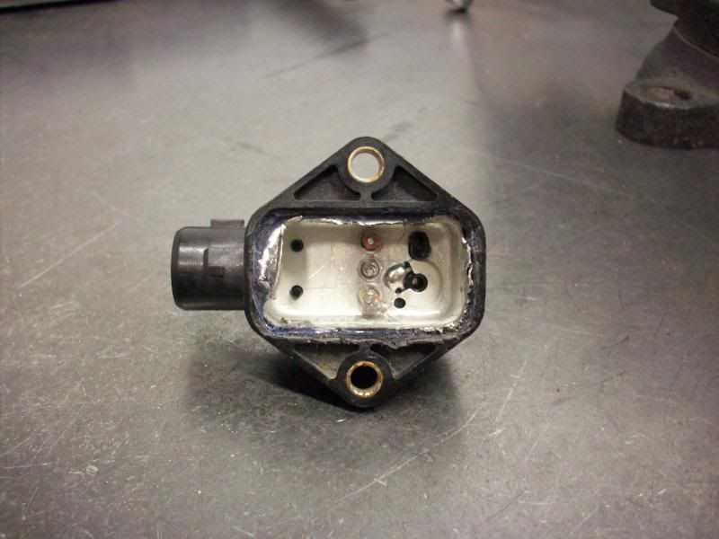

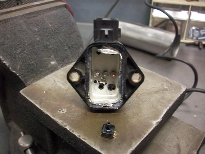

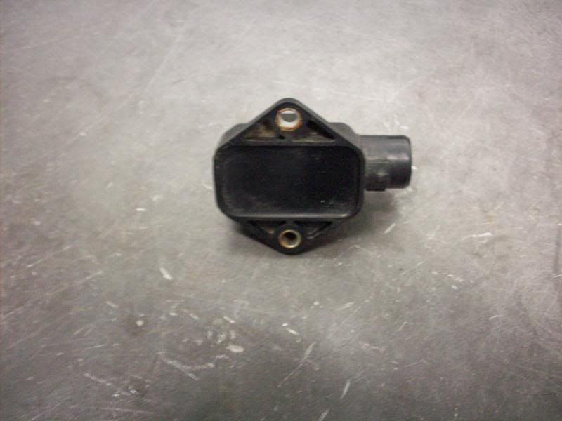

Well i started working on the map sensor finally. All in all it wasn't that bad, took about 20-30 min. Next one i could do in about 10 min but i was flying blind here and didn't want to ruin the case.
Here is the top of the case, where you need to remove the sealant and cut open the metel case inside.
Here is the bottom of the case. This is left alone.
This is after i cut open the case and gutted everything out of it. (everything gets removed minus the 3 posts in the center)
Here is the gutted case with the new 3bar map sensor next to it.
And here you can see the map sensor in place. there is an oring that seals the sensor nipple. It fits perfectly in the hole.
Now i will take the map sensor to the local tv repair place to have some wire soldered onto the leads. As i'm uncapable and do not have a good enough soldering gun/iron to do this.
I will update when i finish it up.

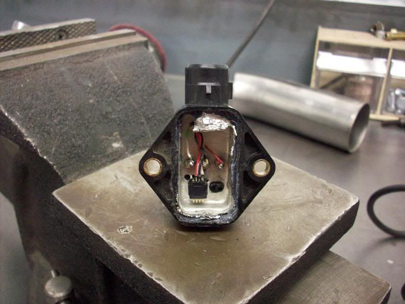

Well i just got this finished up and i think it turned out pretty nice.
well the tv repair guy soldered it up nice.
Here i filled it up with black rtv.
Thanks guys for the help.  :noel:
