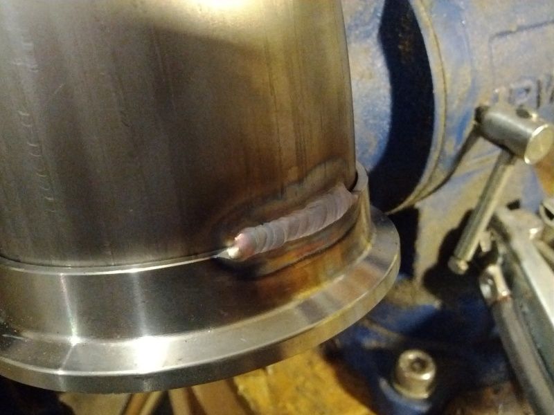

1st ss weld

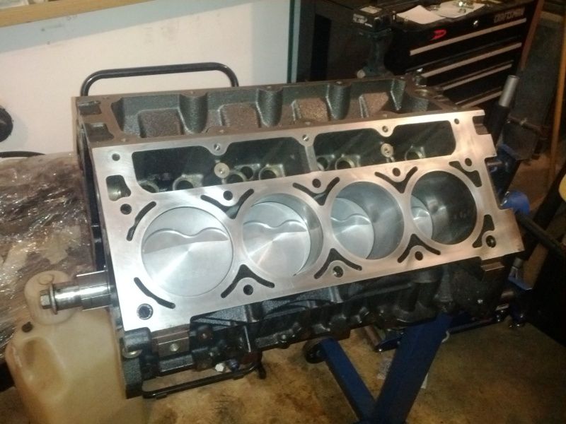

getting started on the motor stuff
wiseco 10-1 pistons and compstar 6.125 rods
