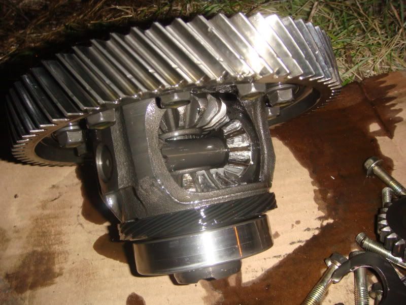

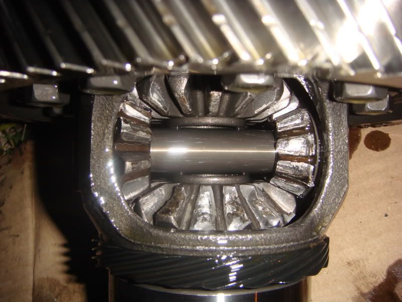

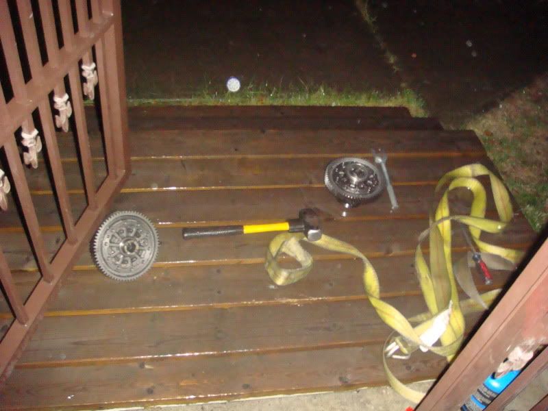

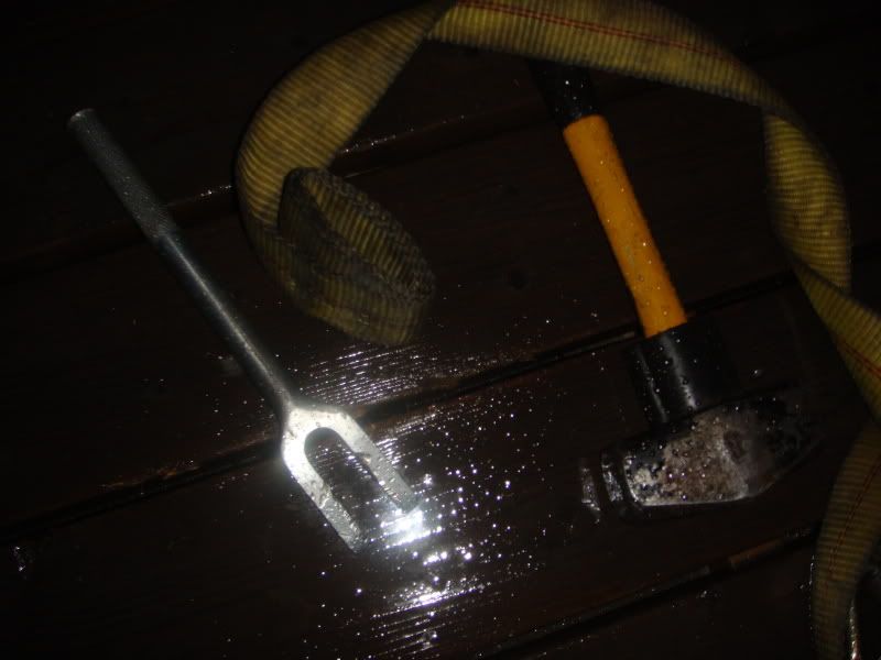

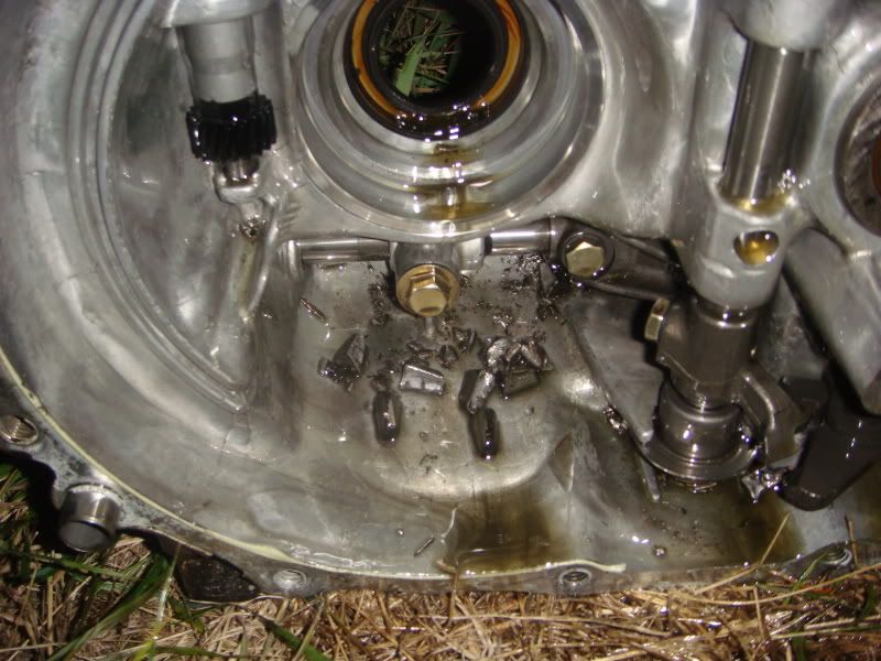

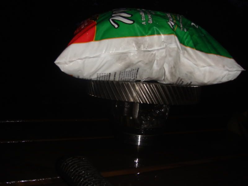

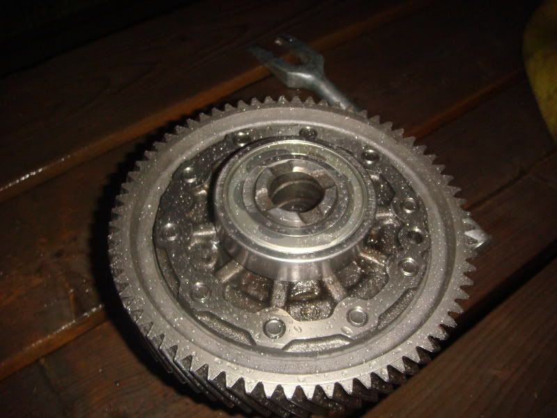

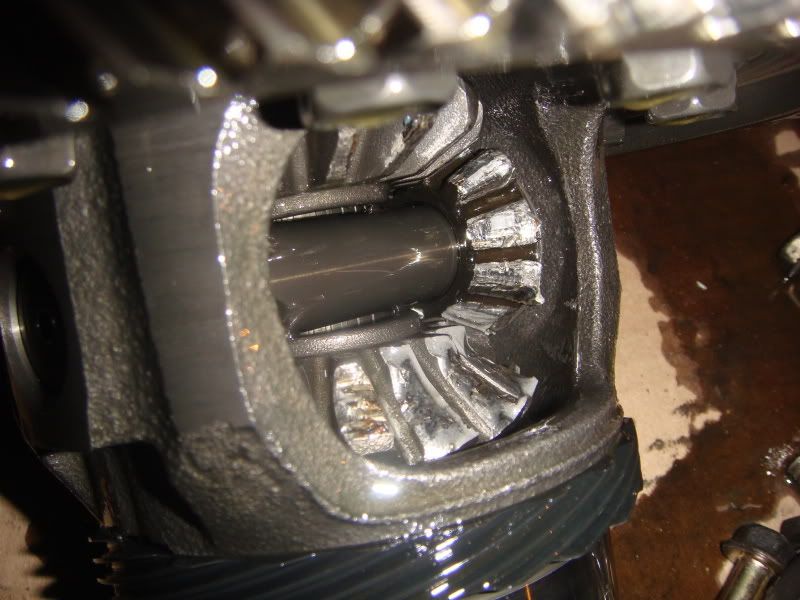

Pics of the second diff blow up (stock)

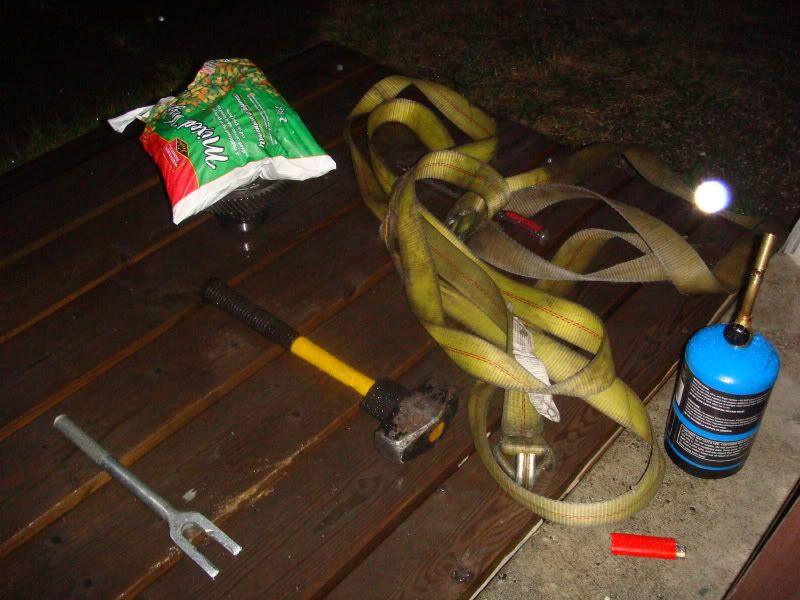

here was my solution....pull one of the better bearing off one of the other diffs :D
a little heat here and there with some household tools, bearing swap bammo...
after a hot water wash, some shavings came out of this bearing too, but at least it is smooth and doesn't have any crunch to it!

a regular 3 jaw puller would have gotten those bearings off.  you just have to fenagle it to get the jaw of the puller behind the bearing.  I usually use a large hammer and 2 screwdrivers to get enough space then let the tool do the work
Re: Trevor's Canadian D Build saga now post pinks all out *updates 8/17/09*
« Reply #155 on: October 18, 2009, 02:38:33 AM »
wow the spider gears stripped but never broke off the diff pin that's new to me.
« Reply #156 on: October 18, 2009, 11:09:04 AM »
not me
« Reply #157 on: October 18, 2009, 02:26:50 PM »
i only smashed the spyder gears aswell.
B-series tranny tho

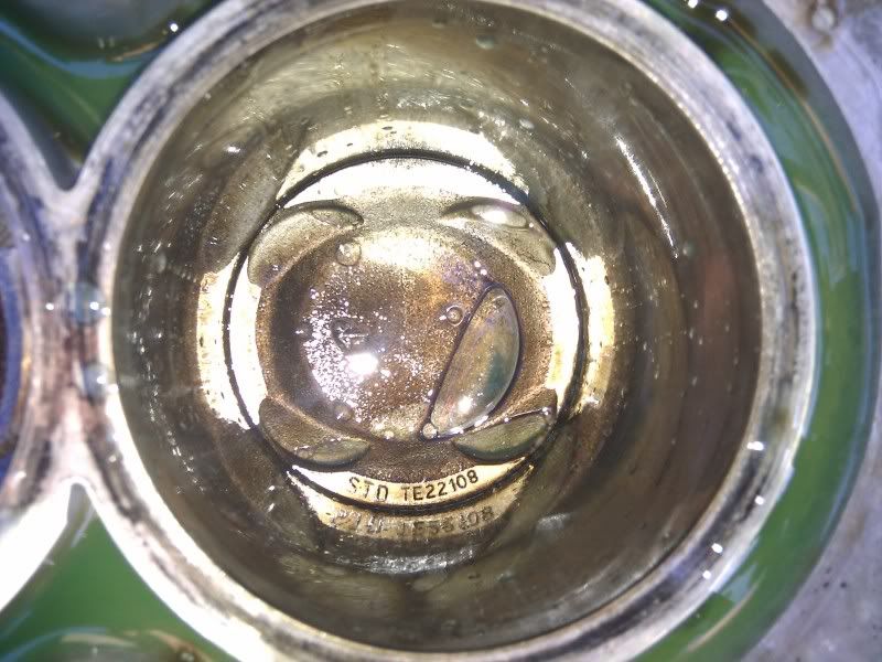

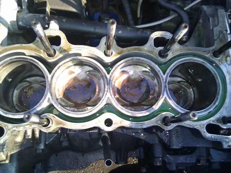

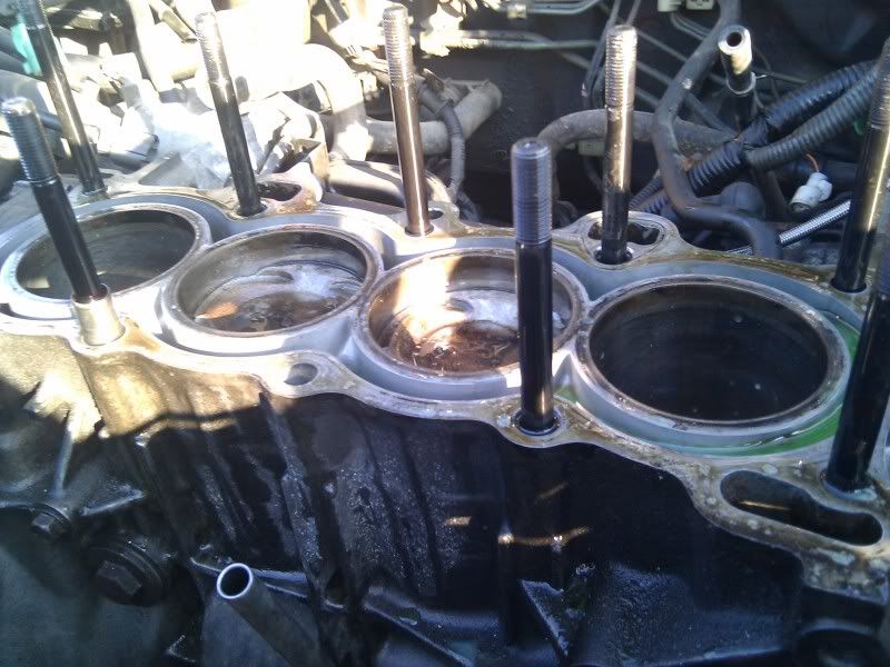

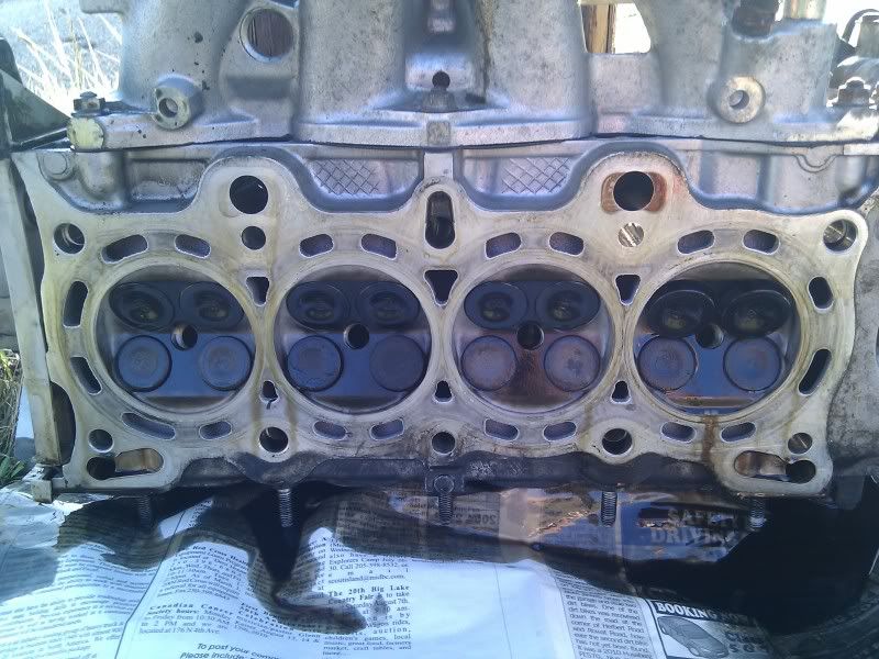

So its been a long time since i updated my build thread.  But here we go..... Blakie the super honda is currently blown up. but it seems like an easy repair.
I came down with Levi Sewell and Passenger Dave for the dyno days with my own car.  After watching levi's car on the dyno Sewel and i jumped in my car for a bunch of really good solid street pulls in the dirty back roads of Lynden WA.
The car started smoking on decel on the last couple pulls and then all the time till there was a big stumble and the car died, right on Hwy 539.
So after a couple months, i finally had time and money to look into what i thought was a 'blown turbo'.
Pulling the turbo reveiled a perfect turbo, as it was received from dvst8r.  Did a compression test and saw what i was afraid of.  40/45/145/50 psi.
Now with a shot of oil in each hole, I get 135/135/155/135 psi.
Fingers are crossed for just rings.  But even if its a set of pistons and a ball hone, no big  deal.  Pics when they are available.
Re: Trevor's Canadian D Build saga now post pinks all out *updates 7/28/10*

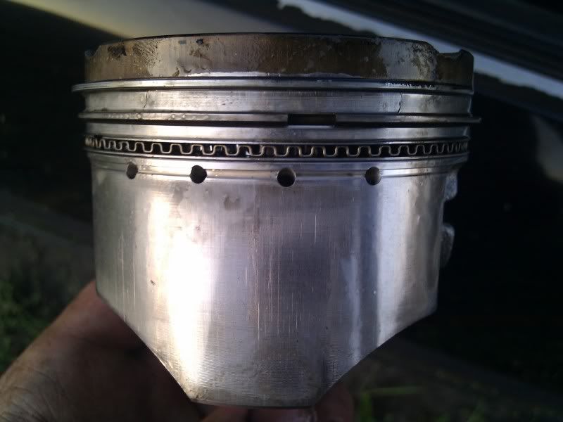

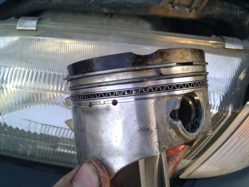

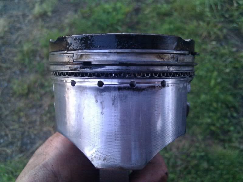

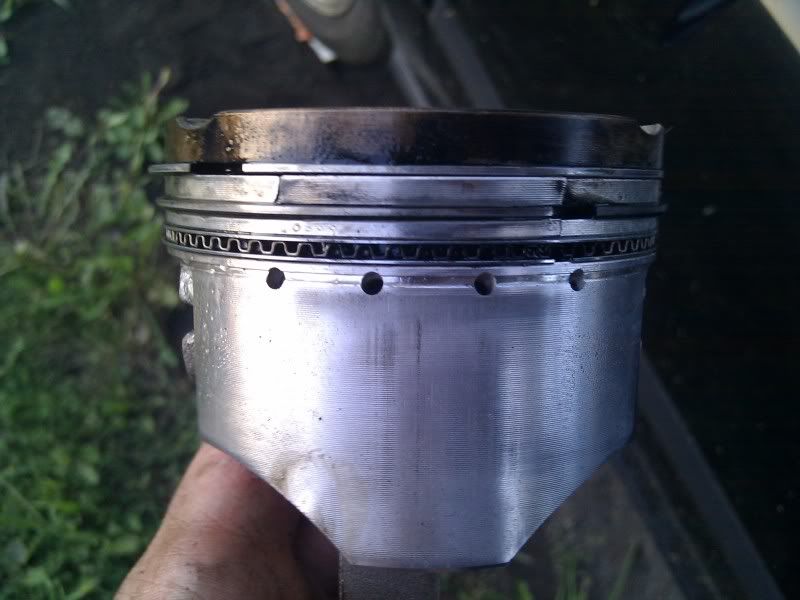

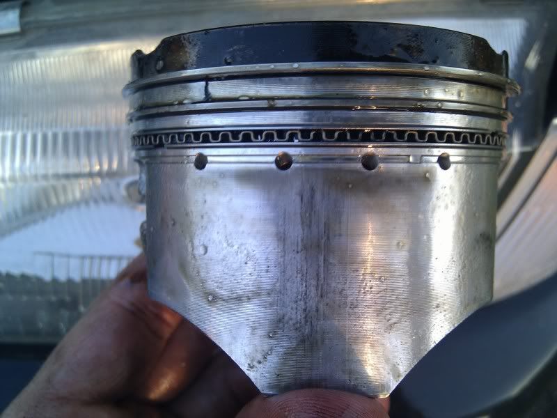

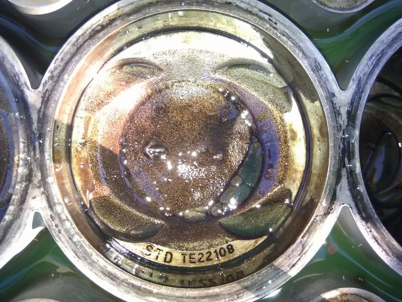

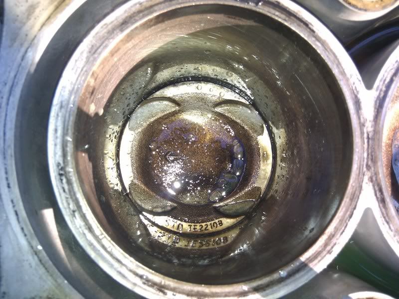

In with pics for baldnog's top of piston diagnosis
#4
#3
#2
#1
NSFW ...

Any ideas why it blew? Were you purposely trying to just make high numbers on it or just beat the piss out of it, or do you just have bad luck it seems with this build.
« Reply #164 on: August 11, 2010, 11:37:18 AM »
Where is JD, and his piston diagnoses?
It appears that an HX-35 @ 24lbs on FJ long rods on 94 pump = ring land crusher.
« Reply #165 on: August 11, 2010, 11:42:03 AM »

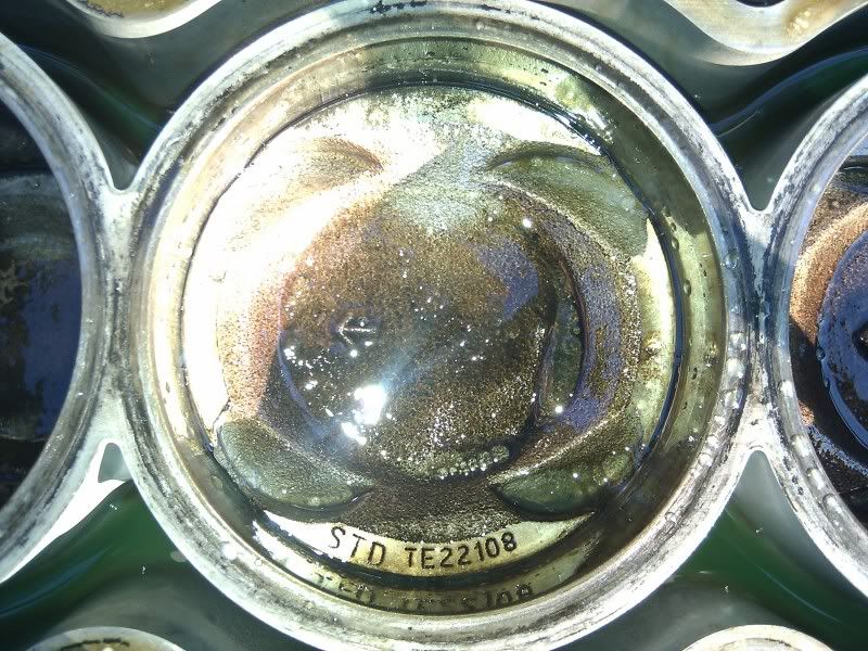

STD = standard bore = sloppy cock pistons?
SOHCKLR657
  • Posts: 420
« Reply #166 on: August 12, 2010, 12:53:55 PM »
Anyone notice how there all cracking in the same spots, close to the valve reliefs. :noel:
Confirmed: D-Series + HX35@25psi + Pump Gas = Sad Vitaras

I'm wondering if this was due to us hitting the boost cut repeatedly. We smacked it pretty hard about 10 times. I have logs from all of the runs, afr was good and theres nothing it in for timing(literally nothing, so little i'm suprised it even fired).  The only other thing i can think of is that the gas in it was old and smelt bad. Trevor said it was like 6-8 months old, and we put some fresh stuff in it.
I've had one other engine pop on me while tuning, but it was a bone stock b16 that was boosted for like 6 years and was on 28lbs.  It popped after it smacked the boost cut repeatedly. We put another bone stock b16 in it, it has about 40 passes on it,   and never had another problem.
Even though theres a boost cut, it still can still boost past the cut for a split second.
This makes me  :-[
trevor72
  • Posts: 467
  • trevwhore
« Reply #170 on: August 13, 2010, 06:39:09 PM »
Nope they were air tight :P  I don't know what the actual ptw was but it was nothing crazy.  The block had 180,000 original km (112,000miles) and barely any ridge at the top of the bore and even then it cleaned up with a ballhone..
Sewell's right it could have been partly older fuel, but what was left in the tank from before if i remember right should have been c16, but maybe not, maybe it was 91 since that's usually what i put in it when i just daily it.  Also does WA even sell 94? I know it got premium in Lynden, but i think it was 92.  Looking back this was dumb of me. I should have just put the race gas in from the get go and figured out something street-able later.
Boost cut probably didn't help i guess.
