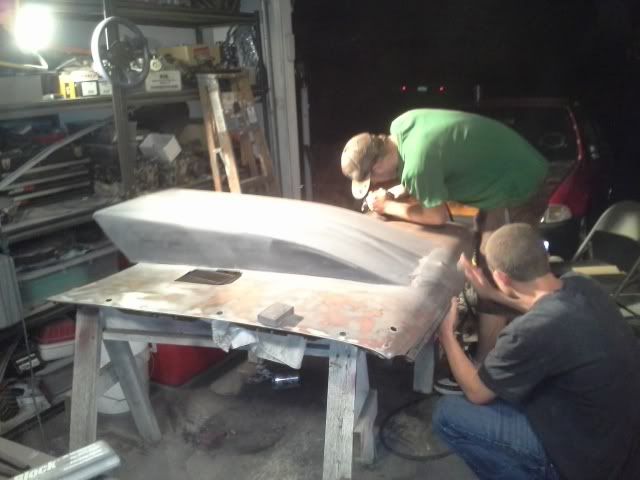

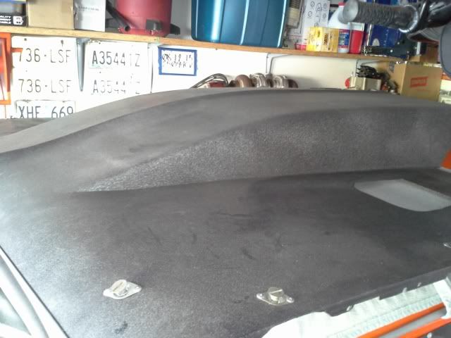

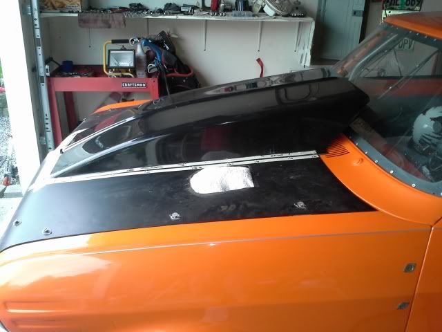

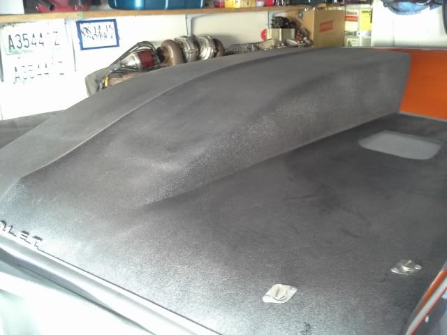

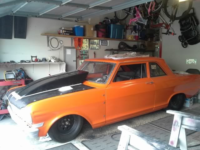

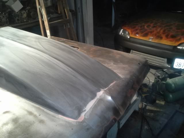

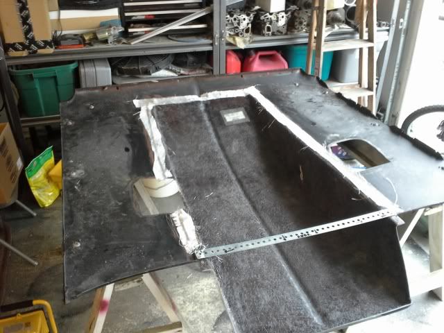

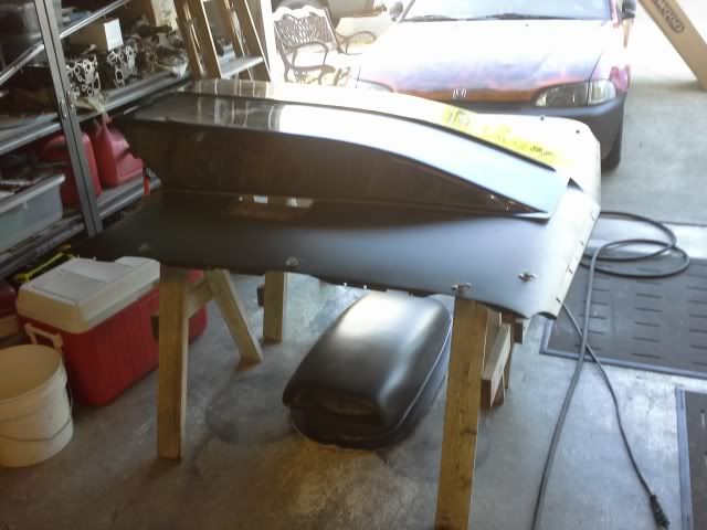

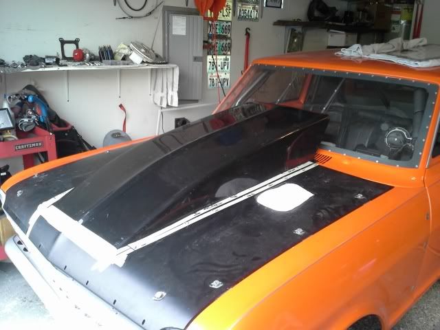

well i guess ill add the fab of the 7.5 in cowl to the steel hood...
mock up
and more...
time to cut and start molding the glass... shit was smooth to work with..

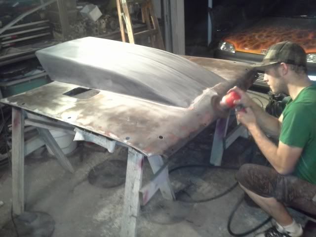

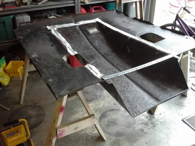

all i did was a good tight fit, then rivet the cowl through the hood and used straight resin sandwiched between the two flange and hood under the hood for the first step.then i applied some mesh the next day to it..
theni let it set up for a day or so.. then some touch up and blending,sanding and glaze bondo..
and all primed and ready to wet sand and paint...
well more to come when parts arrive on mon. finish the motor and break the bitch in ....
Re: Jacer's 63' Nova Twin build.. Update..added some hood pics ..check it
« Reply #211 on: September 13, 2013, 05:32:37 PM »
Looks good.
If you would have knocked that high spot on the ridge in the front down and blended it would be perfect IMO.
that was the factory line so i had to work with it..in person it looks ok...

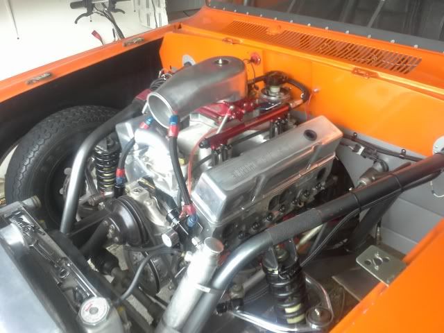

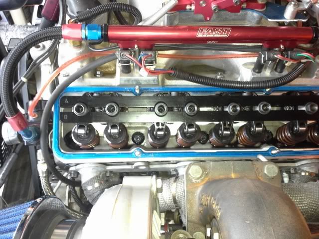

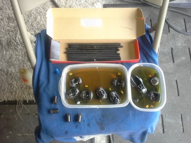

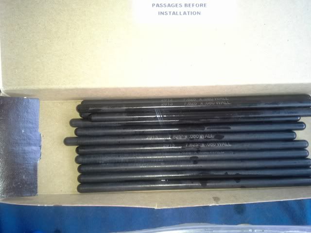

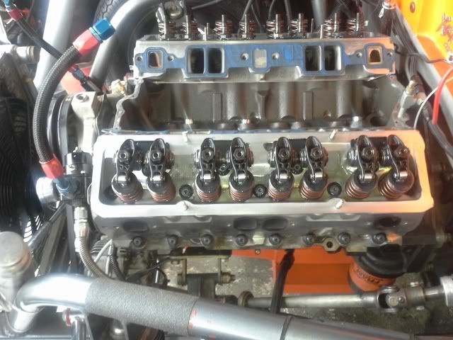

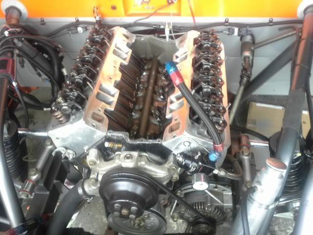

pushrods came in so i started to put it all together...
the new roller rockers.. 1.6 in 1.52 exh comp ultra magnums
all installed and looking good.. the roller tip is centered all the way through the lift. all good..
intake installed and all sealed up, dizzy stabbed and phased...
back to work i goooo
should have the motor all ready to fire by weds. then off to bremerton..

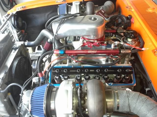

Please tell me you do not run with those filters at the track.
Re: Jacer's 63' Nova Twin build.. Update..Parts showed...
« Reply #222 on: September 28, 2013, 08:59:46 PM »
Take a look at those and then think to yourself, would these Briggs and Stratton mower air cleaners feed 1000hp?
