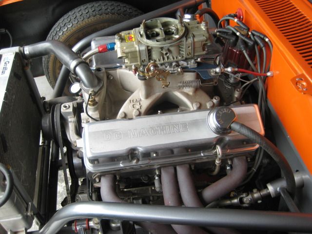

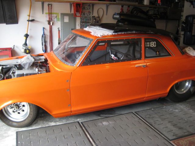

finally got her here to start the twin build i have planned... will be updating along the way...
some of the specs..
383 stroker sb chev..
10.5 to 1
afr heads
team g mani,950 carb
turbo 400, manual shift 4200 stall  (just found out...) 2/13/13
ford nine out back... 31 spline,4.88 fd,32x17.5 et streets
yada yada... will make a proper build sheet when i start the project..
she fits~~
moved it to my little shop at the palace..
from dads much bigger shop...
ill get er done...
for now thats all... will be starting soon... :?:

spiker, with the layout twins will be much easier to do imo.. there really is not much room,because of the front tie in's..if you werent so far away from me or not , come by sometime.. (in south hill) would love some input/suggestions..havent ordered shit yet.. need to plan it out efficiently.
and also it will look wicked mean.. and sorry the stall is 5200 (typo)
dvstr8r... will prolly add some triangulations (spelling?) to the cage... right now its a 14 point.. might put it back to street form..

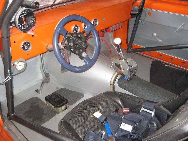

Re: Just a tease of the upcoming twin build... 63 nova
« Reply #21 on: June 16, 2012, 10:41:34 AM »
Unless you are planning on going 8.49 or quicker the cage as is will probably do fine (not enough pics of the cage to say for sure).
I was just adding ridiculousness on top of spikers post.
The other reason twins are a good idea (aside from packaging reasons) is they do lite earlier and spool quicker. The downside is obviously cost of two chargers, and the maintenance of two chargers.
Will you be staying with the current engine and just adding boost?

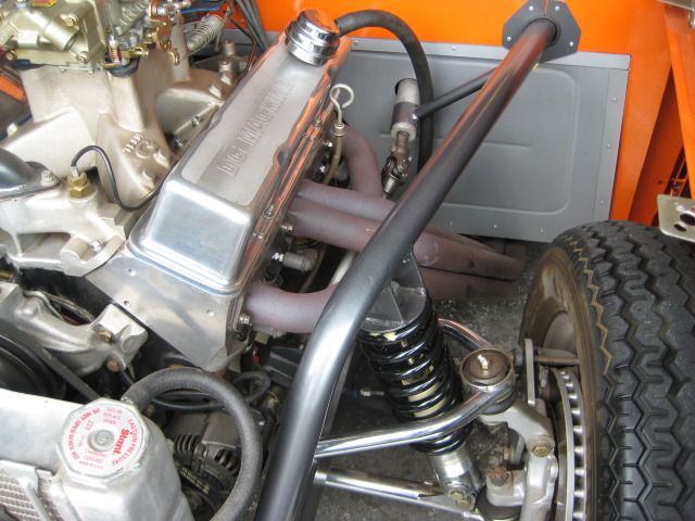

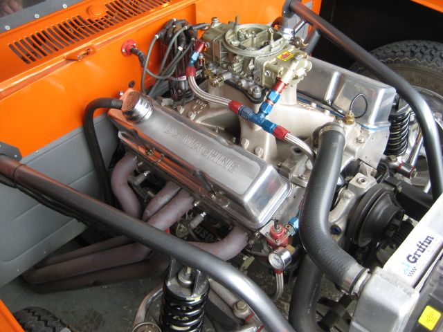

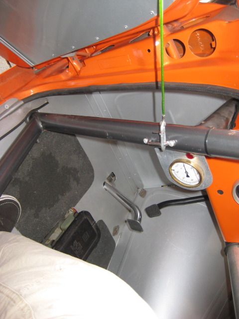

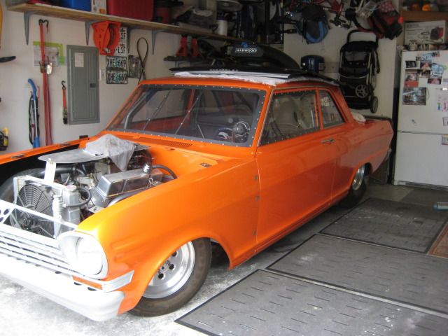

yeah the engine will basically stay the same.. might go efi though.. dont know yet.. motor is strong so i wont be going thru it until it shits the bed..will take some pics of the cage and what not soon.,..

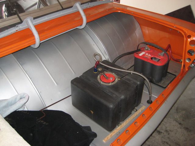

JACER63
  • Posts: 167916
  • well shit..
« Reply #23 on: June 16, 2012, 06:05:22 PM »

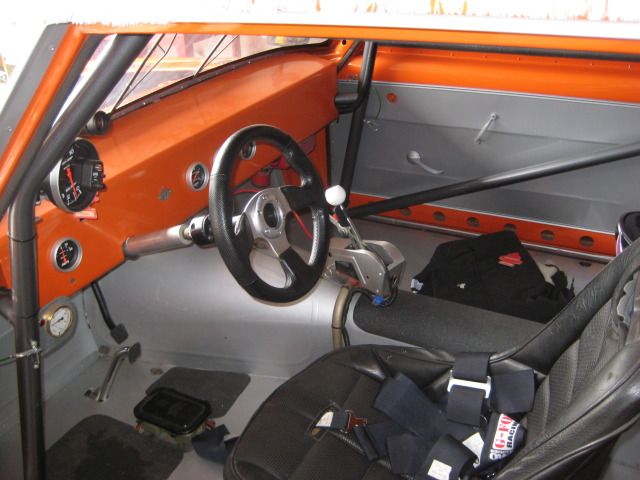

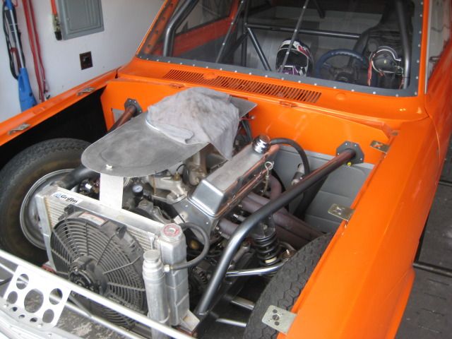

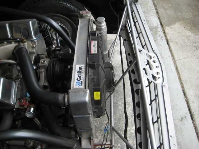

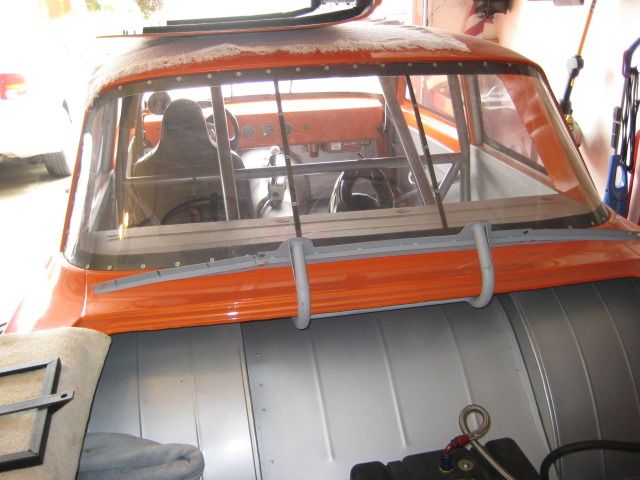

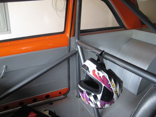

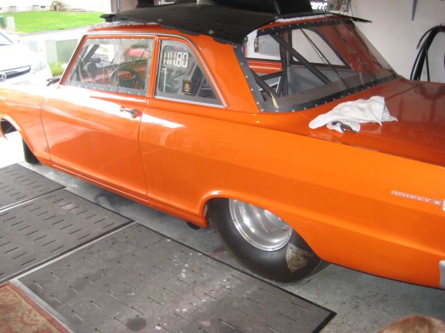

heres some more pics...
« Reply #24 on: June 16, 2012, 08:44:38 PM »
Other then a window net, that should get an NHRA sticker for 8.50.
I would say either a single S480, or a pair of GT35R's or if you want to do budget a pair of HE351cw's.
