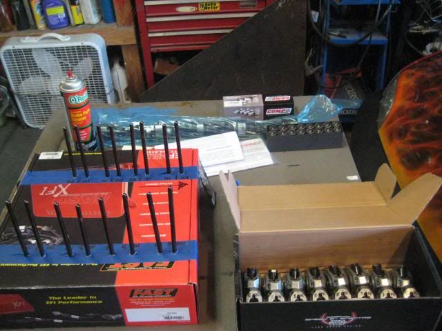

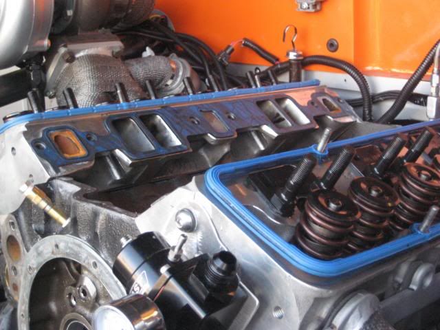

so previously stated needed a cam swap ... went with the comp cams  .507 284 in/.525 306 113 lsa.  needed to remove inner valve springs for break in steps.. use air to seat valves..
worked like fucking a slutty stripper in vegas...
all in order and proper holes..
then i just repeat process for reinstalling springs...
broke the bitch in 2500 rpm for 29 mins with occassional burps to splash oil; on cam yada yada

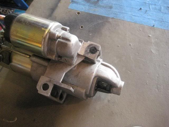

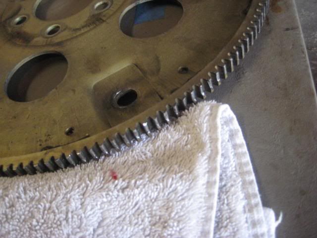

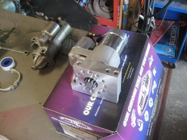

then starter took a shit .. and ate flywheel up.. as stated.. starter cracked the shoulder leaving it to move a tad and ate the fuck out of the flexplate.. and it would not disengage.. trouble
flexplate damage... it was old and been through 3 starters..
and new starter..

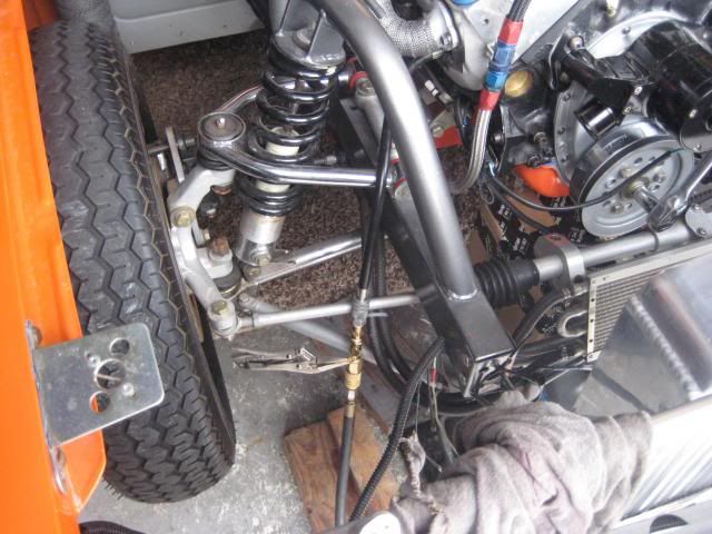

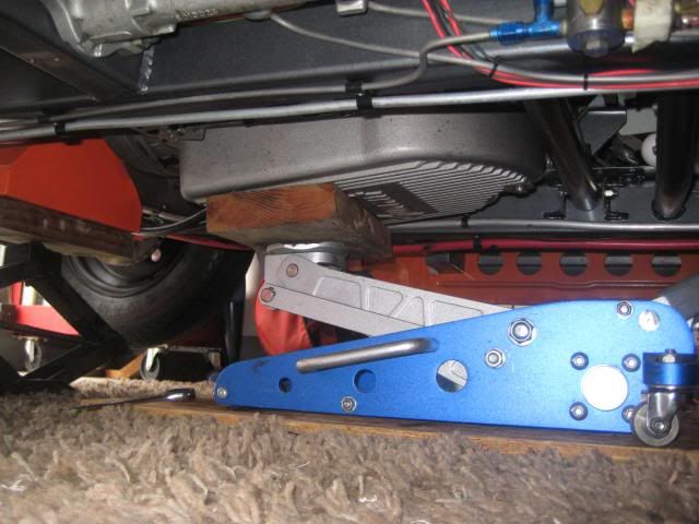

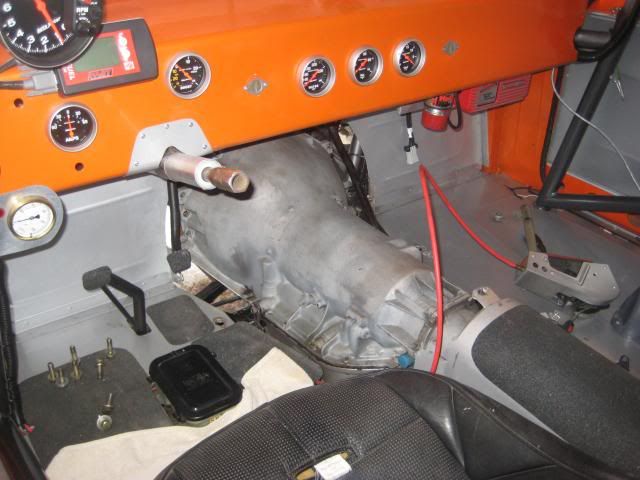

this how to remove flexplatre with tranny still in car.. move the tranny back 2in and viola...

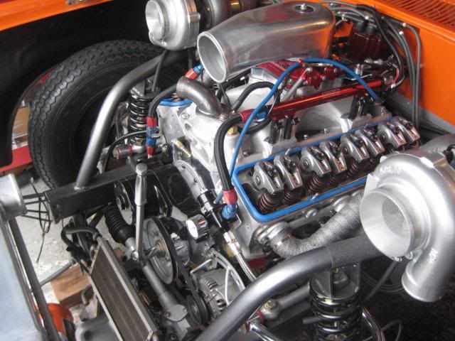

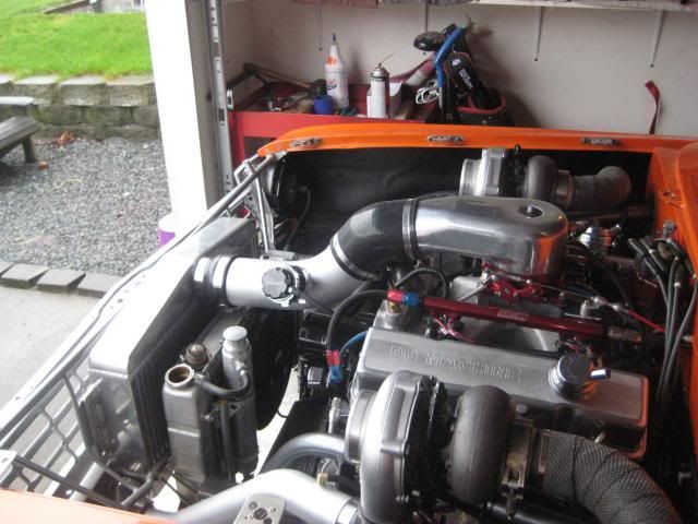

now here's the final engine setup..
now i will try and putt this bitch around the block this sun. sat is shot i have a family deal..errr
need to dial it in and hope shits good before i trailer it 90 miles to lynnhood.. may need help on the tune?...
