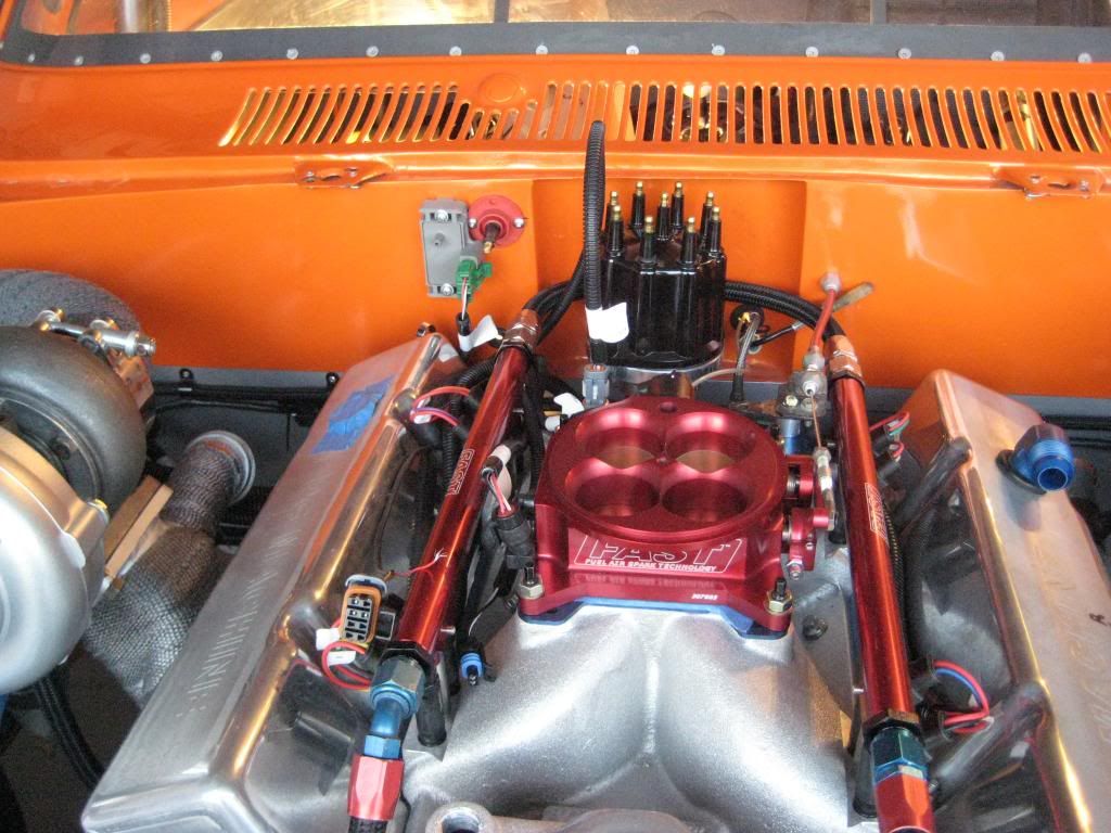

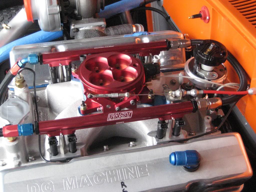

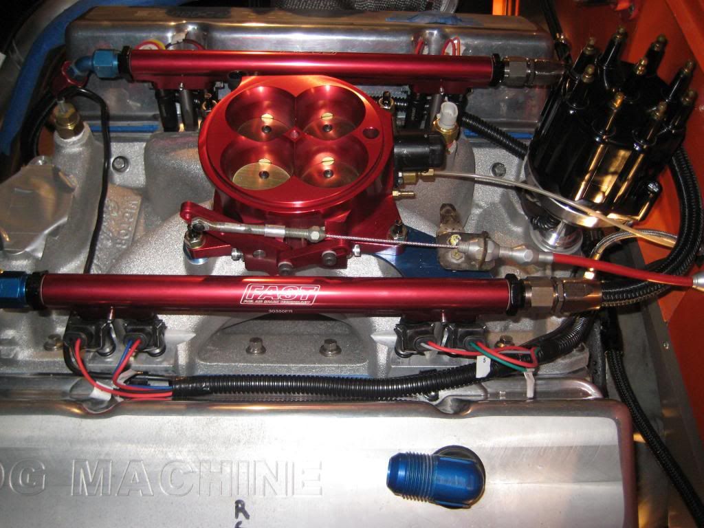

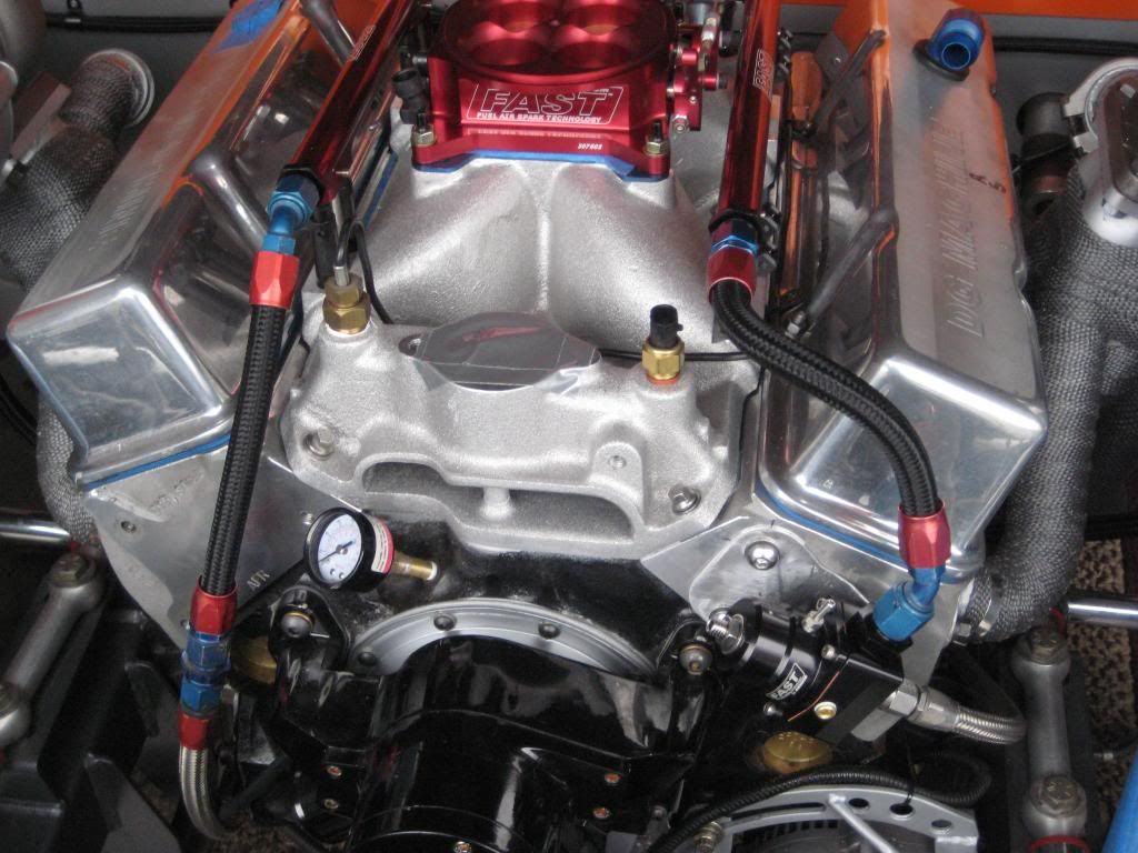

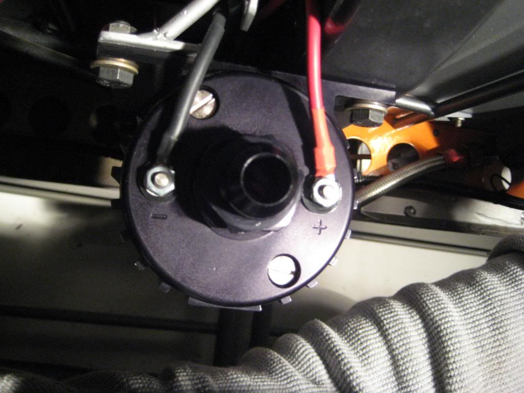

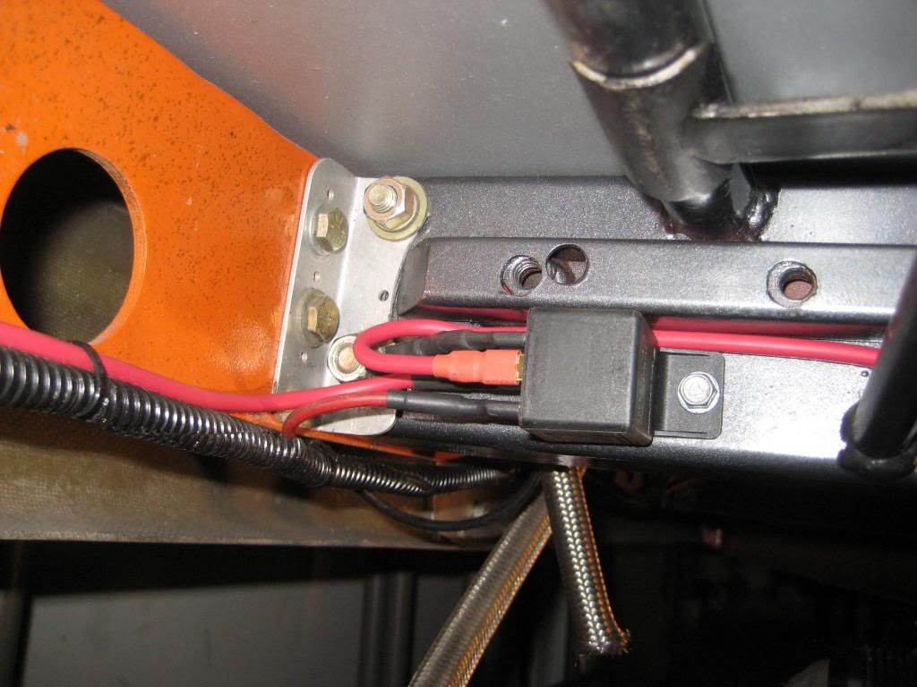

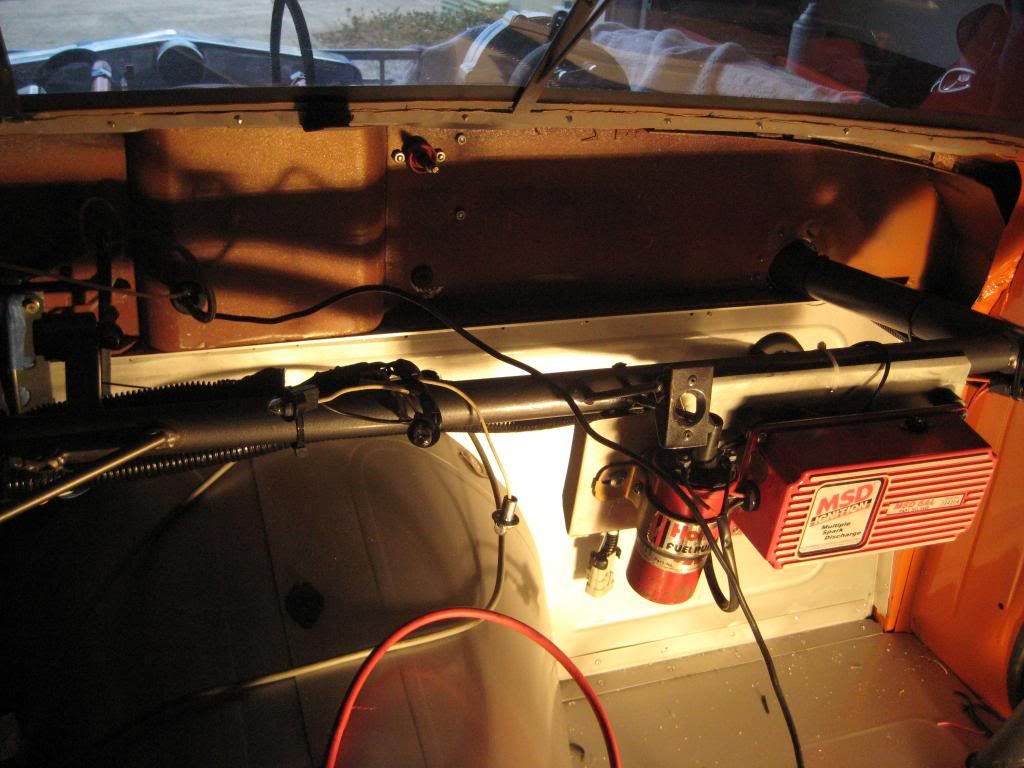

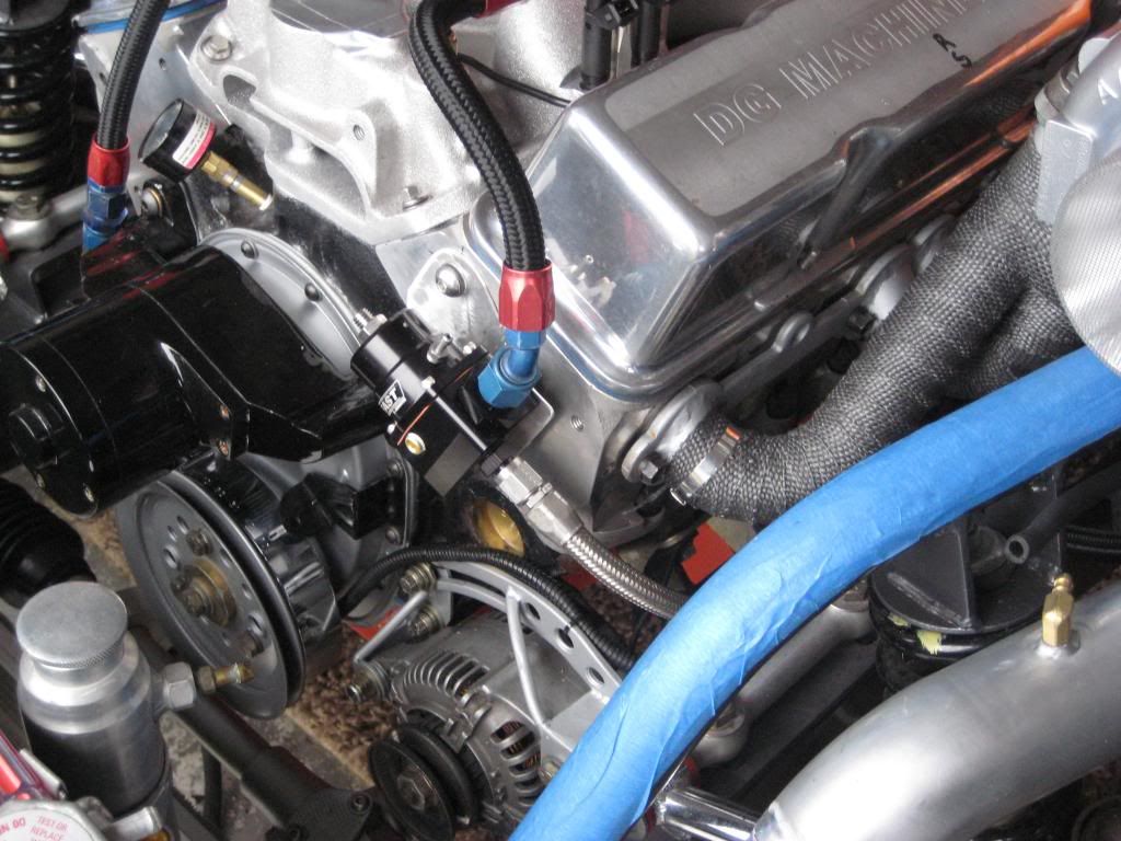

well got some more work done today.. actually it took several days to complete.. started out  with the front of the fuel system.. after all yours guys input i decided to run the loop.. saves on fittings and hoses to boot. hers the front fuel ....

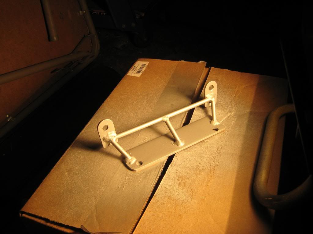

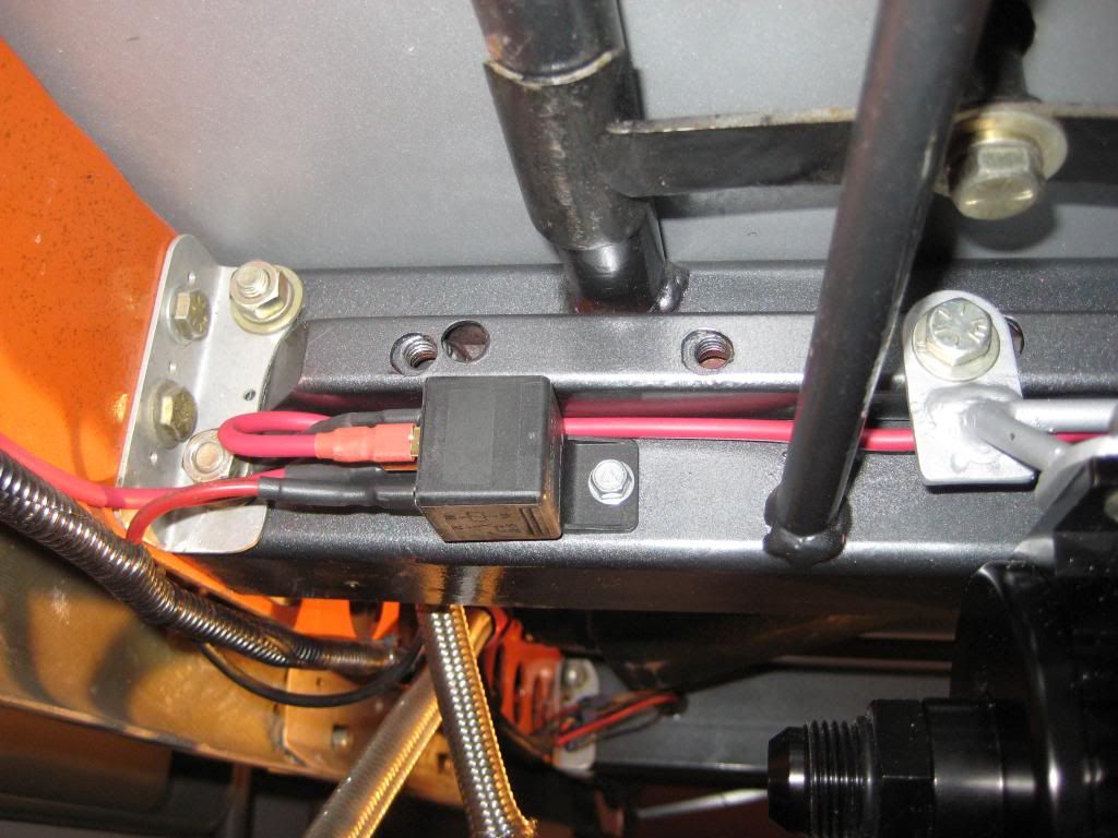

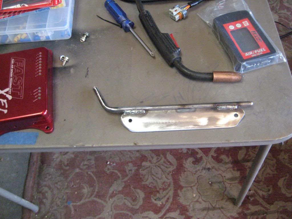

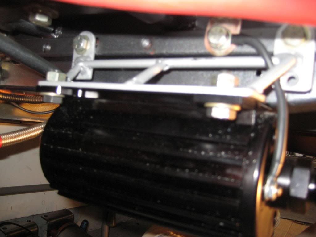

then i tackled the pump mount ... needed to build a half bracket..fuck (50-60 times)  back and forth  under car to check shit..
and then install...
and wired the relay and such...

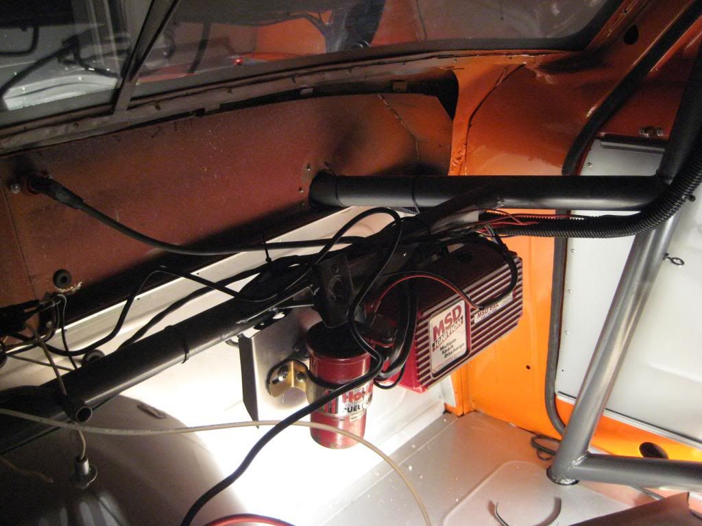

then checked fitment of full harness...  fuel injector main mocked up
full harness....

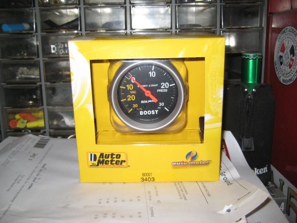

got some small arts i needed today..
boost gauge.. 2 5/8

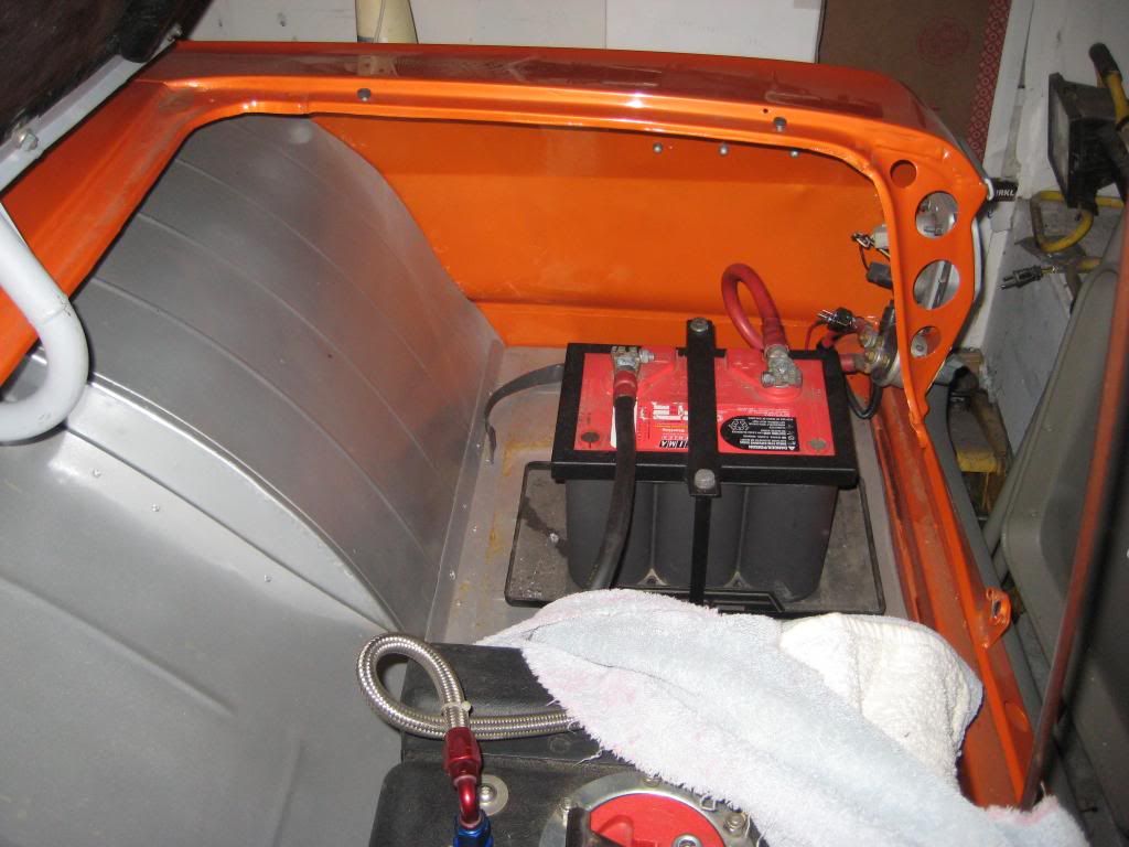

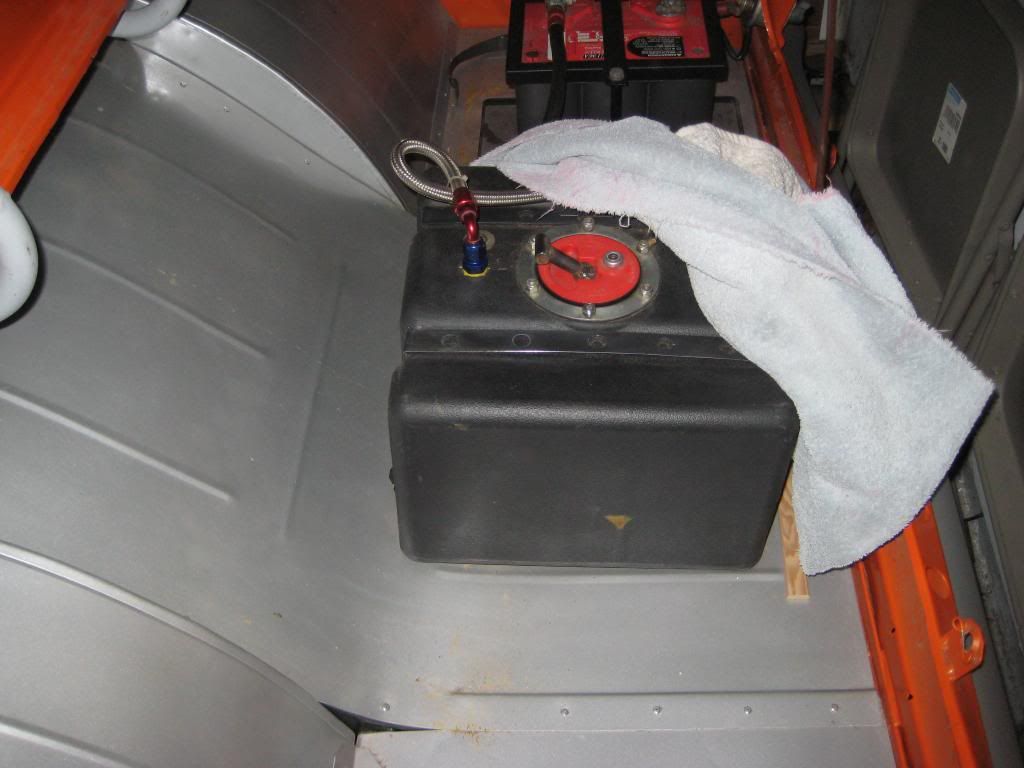

and a shot of the trunk and fuel cell.. last pic has the 30 amp breaker for the pump..

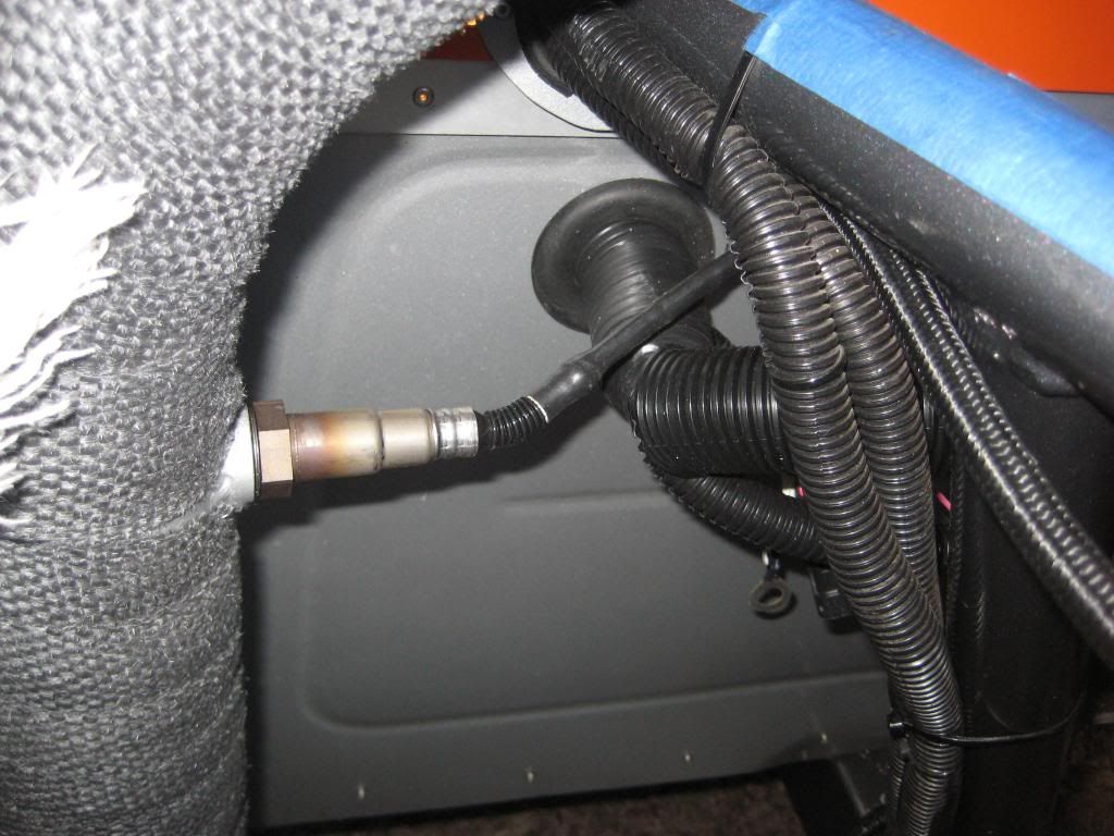

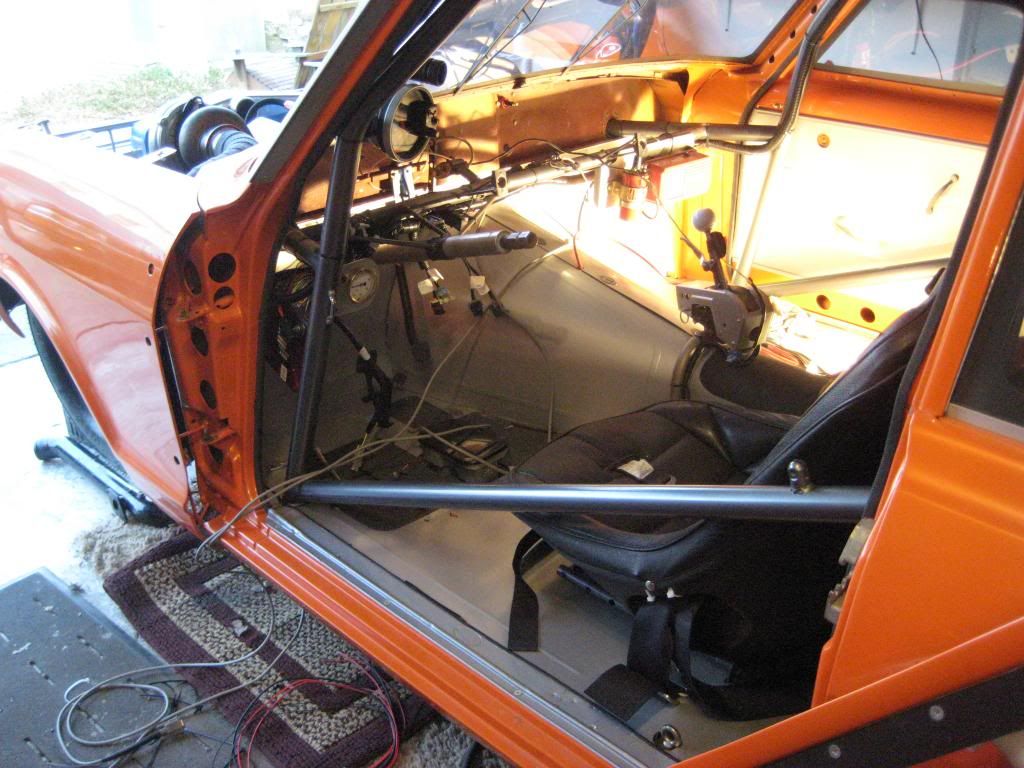

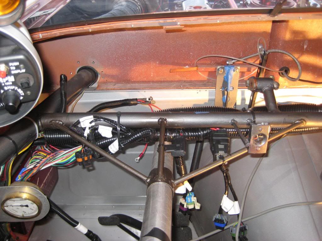

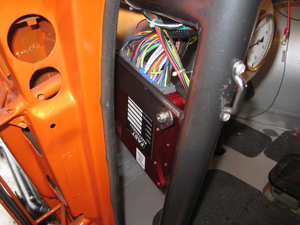

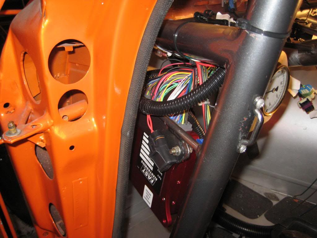

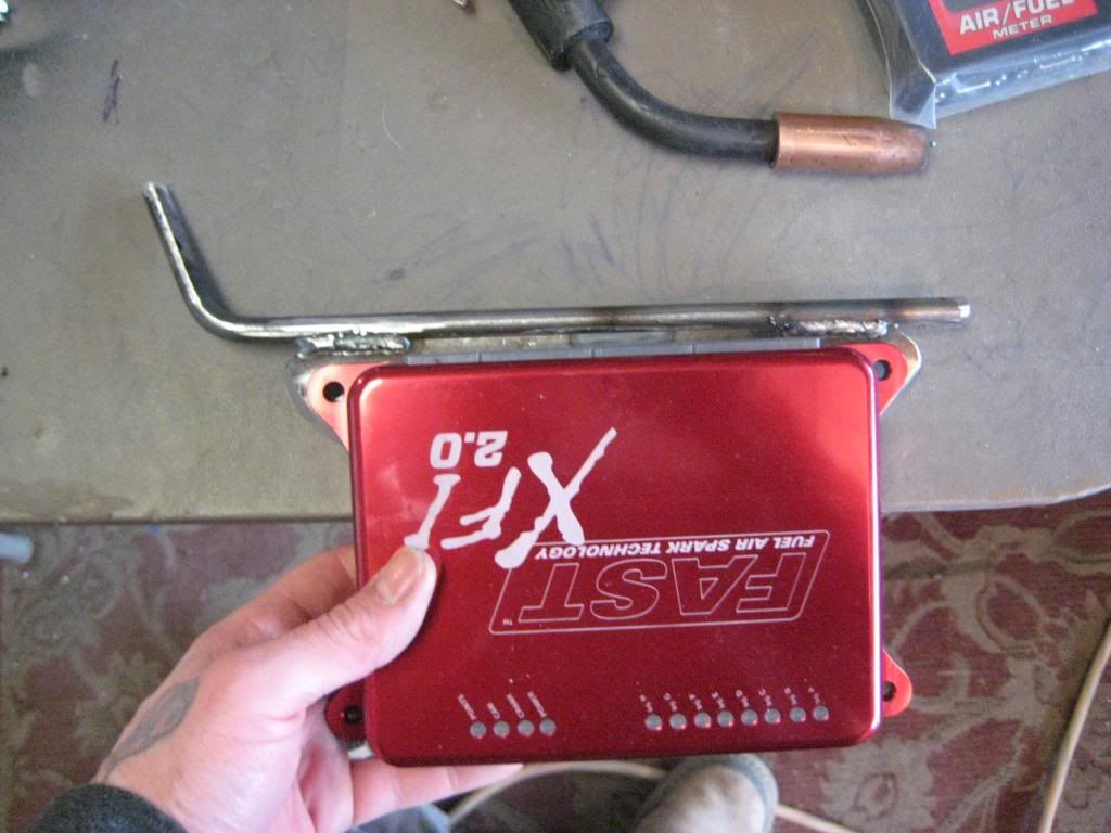

well started the main harness work.. last sun night. 4 straight days of work is coming together..
ecu mount..
welded and painted ..
mounted up and tight
well fuck it works for a good relay mount too...

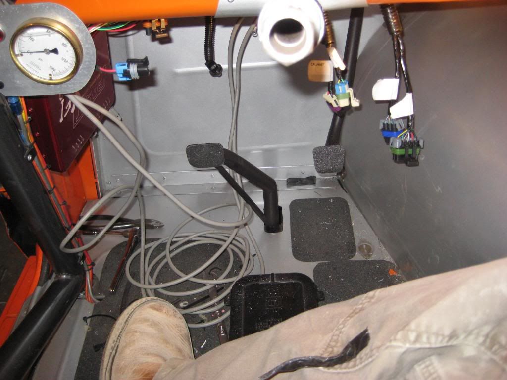

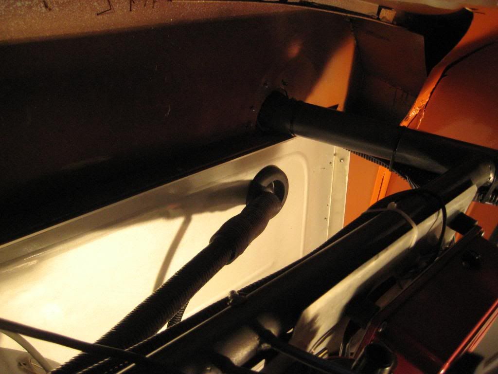

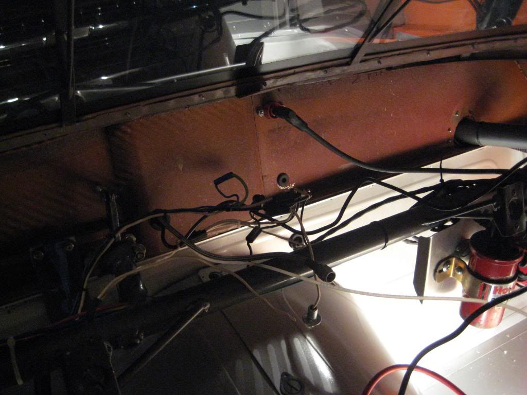

then started running the harness...
some tools .. shit everywhere
mounted the MAP.. gm style 5 bar

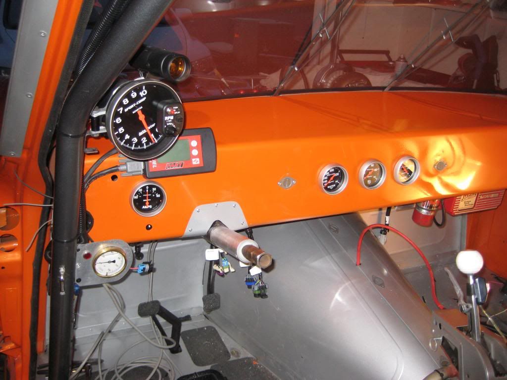

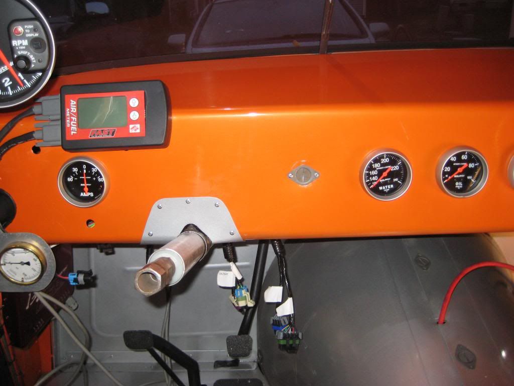

and finally some progress.. w/b gauge and boost gauge install..next
have more pics of other shit but for now....
well there be more to button up before the weekend comes.. wont have time till mon. to do more work on it.. then very soon this will be readt to fire..

ok fucking photobucket was being a whore.  here ssome more pics
wb and dash mockup for shits
