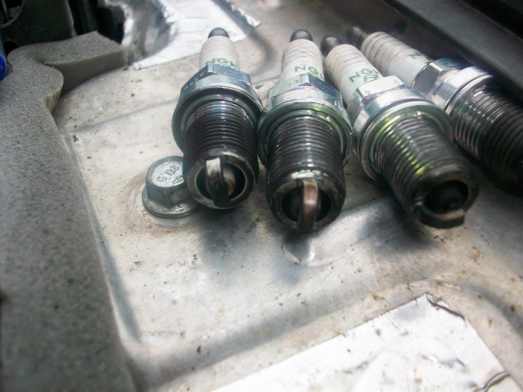

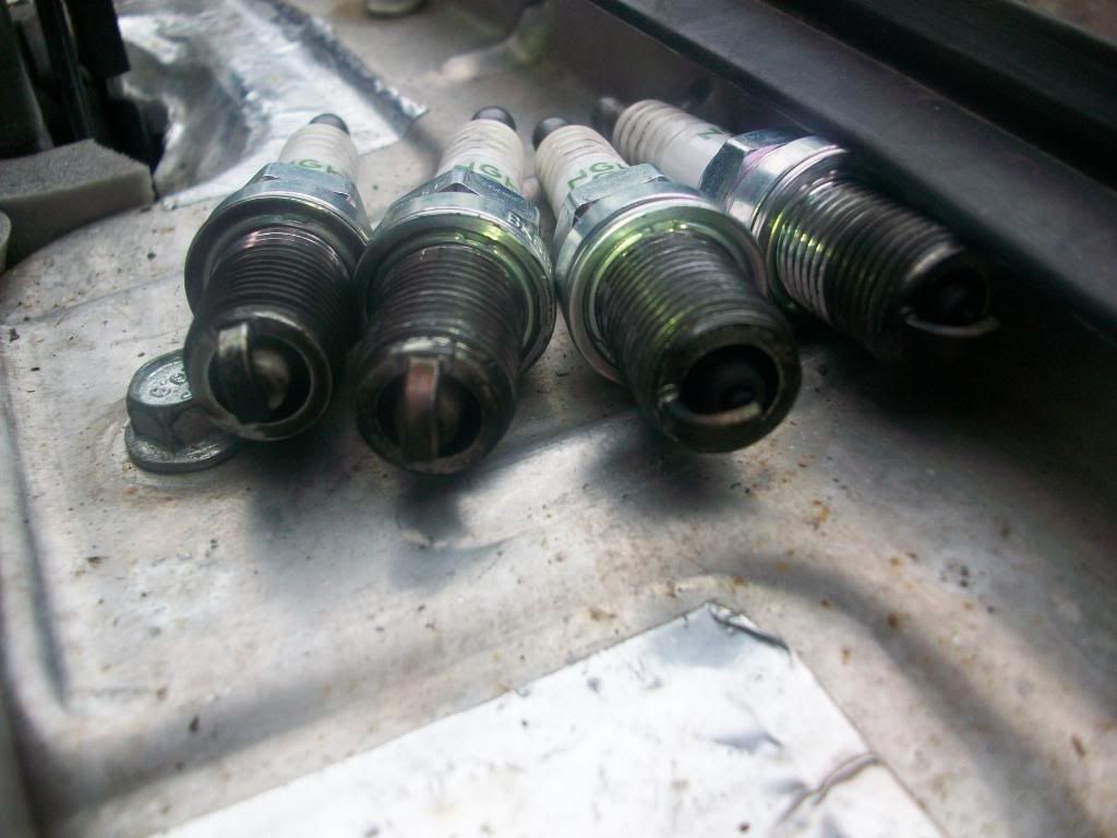

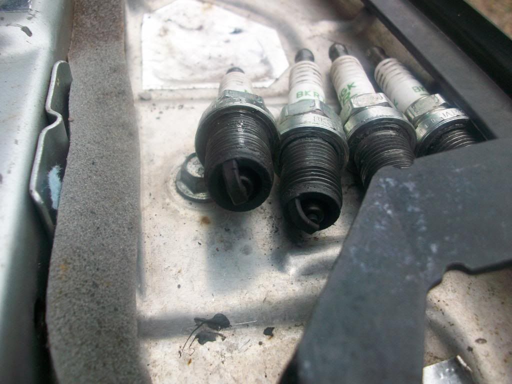

« Reply #125 on: January 05, 2010, 01:27:45 AM »
left to right is 4, 3, 2, 1. Sorry for shitty pics but camera sucks.
Took these pics then did a compression test. Cold engine, 1/2 dead battery.
I looked down the spark plug holes and all the pistons look "normal", but cylinder 4 I could see oil on top of the piston, and saw this on cylinder four.
Then put 4 new plugs in it and cranked it up. It ran on all four with new plugs. After 5 seconds it was smoking, after 15 seconds it was pouring smoke, after 30 seconds of running it started to clear up, after 45 seconds of idling it almost stopped smoking at idle. Revd it and it poured smoke. Ran it maybe 1.5 minutes and killed it, pulled the plugs. Order is again left to right, 4, 3, 2, 1.
What's wrong? All four new plugs were wet with oil when I pulled them, you could wipe your finger on them and get oil on your finger. Plug 4 was the worst, but all 4 were wet.  :-\
« Last Edit: January 05, 2010, 01:29:49 AM by patsmx5 »

Valve stem seals. The oil is giving a compression bump in cyl 4, but it's good otherwise. Looks like you got lucky.
it could be lots of things but for simplicity's sake, you could be overfull on oil. I have seen this lots in unbaffled oil pans that get lots of windage.
