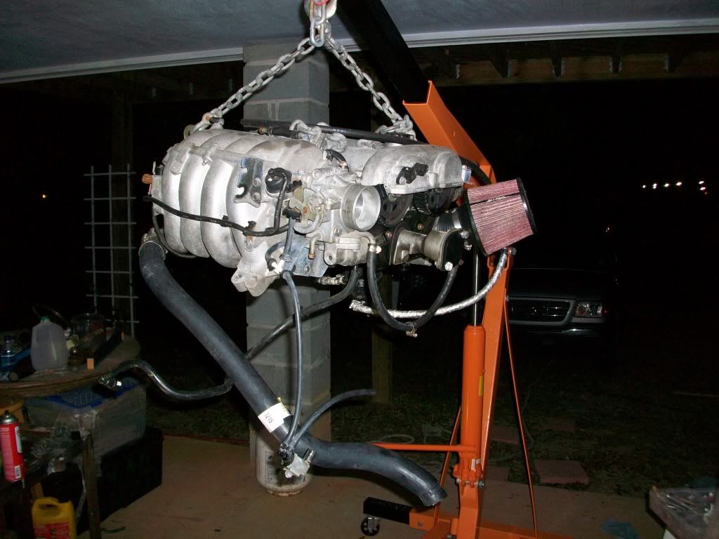

Got a new pilot bearing and TOB installed, then set the shortblock in, got it bolted in. Then added some accesories and stuff and then used the lift to lower the head/intake manifold/turbo manifold/turbo onto the shortblock all in one shot. Got it about 1/2" above the shortblock then put 4 head bolts in to get everything alligned, then lowered it down. Got it torqued down now to 60 ft*lbs, the top end of spec. Tomorrow I'll finish it up hopefully.

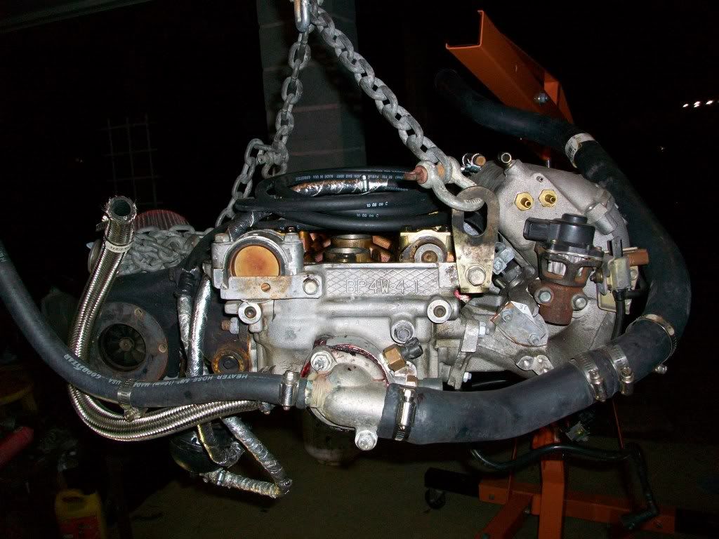

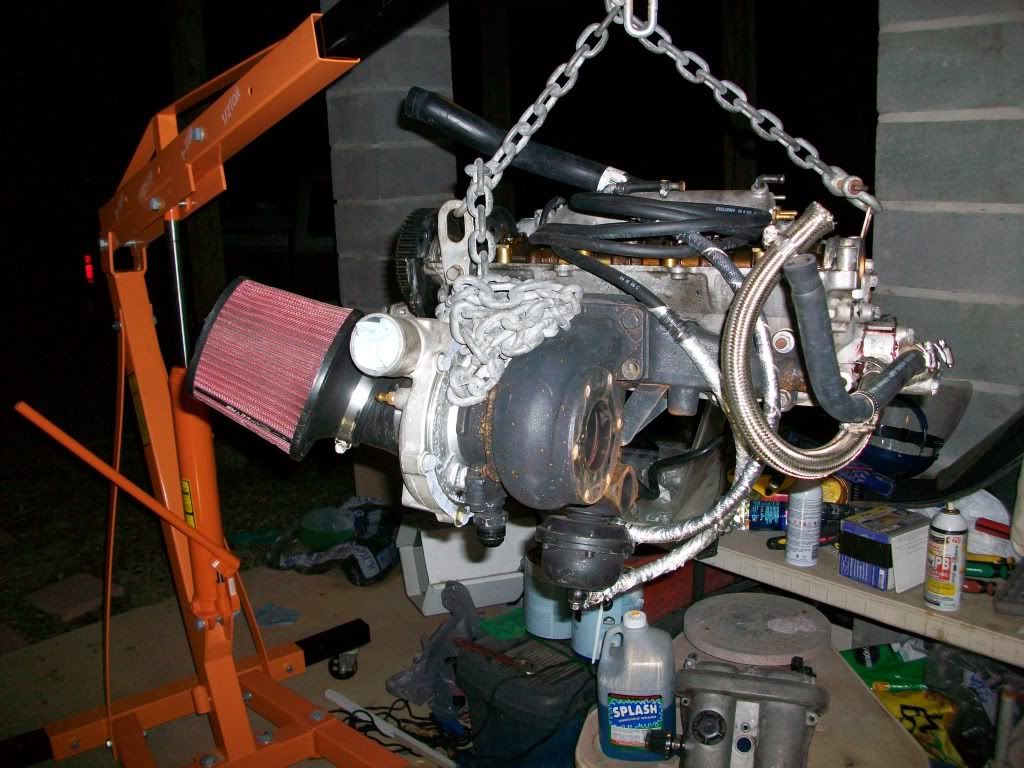

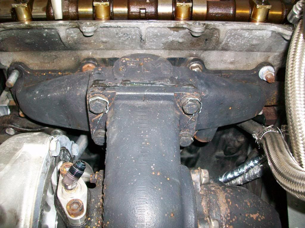

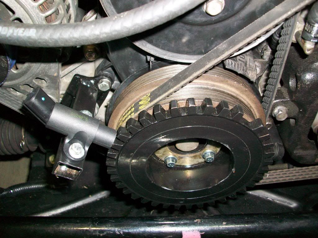

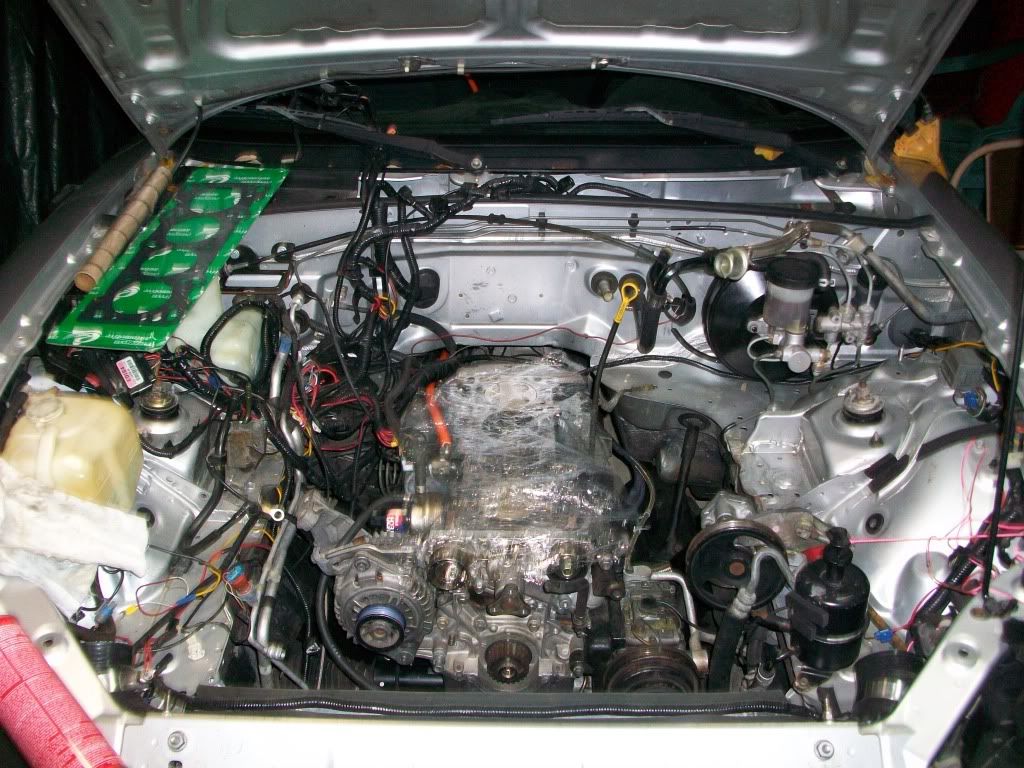

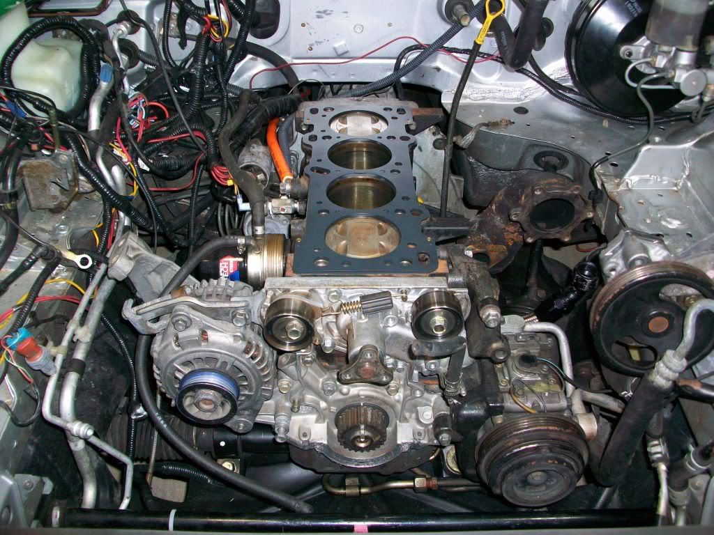

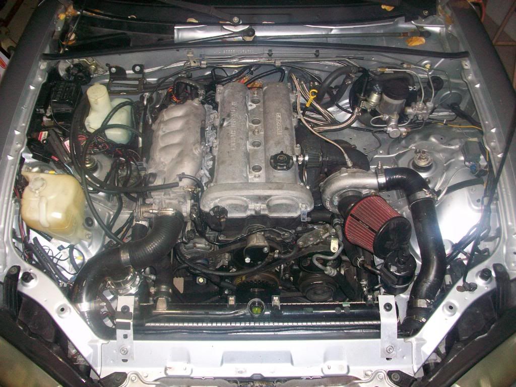

I forgot to take a pic with the head on, but here's a few pics up to getting ready to put the head on.
And the head's already on now, turbo oil drain hooked up. Just gotta hook up the downpipe bolts and wastegate bolts, which are a pain in the ass. Then all the hard stuff is done. Then it's just simple shit. Also gotta redo the crank position sensor bracket I made as the new trigger wheel is in a different location, but that shouldn't be too hard to modify.
New head gasket is 1mm thick vs. stock of .8mm. With the head work, 9:1 pistons, and 1mm headgasket, new compression ratio is 8.4:1  :noel:

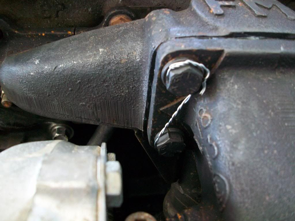

« Reply #95 on: December 29, 2009, 12:35:45 AM »

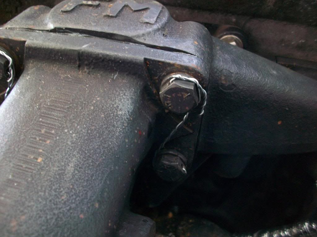

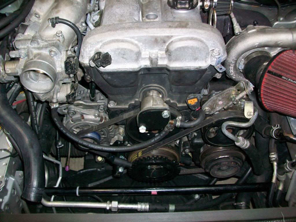

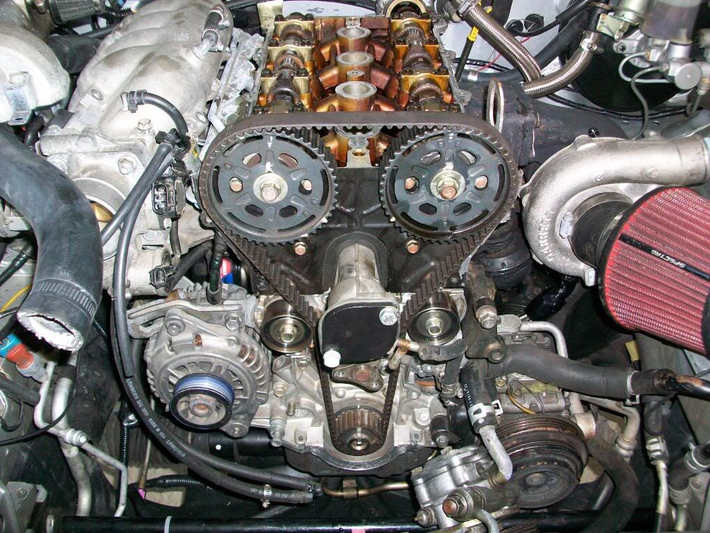

Went to lowes and in the hardware section, found some 22 gauge steel wire used for hanging pictures and whatnot.
Got everything put together, anitfreeze is in with cap off. Needs oil and then hook up battery and crank it up. Waiting on permatex stuff to setup overnight before I add oil and run it. Hopefully it cranks tomorrow.  :mexi:

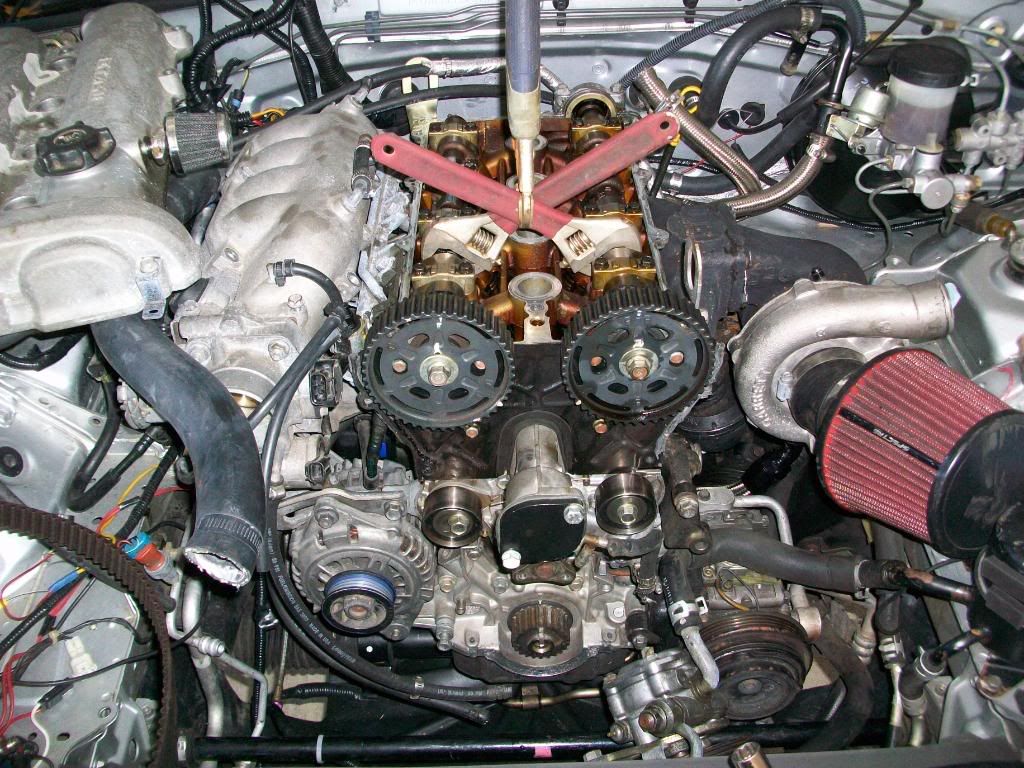

« Reply #98 on: December 29, 2009, 03:48:47 AM »
THe DIY cam holder trick has been officially stolen, and if anyone asks me, I invented it.   :noel:
