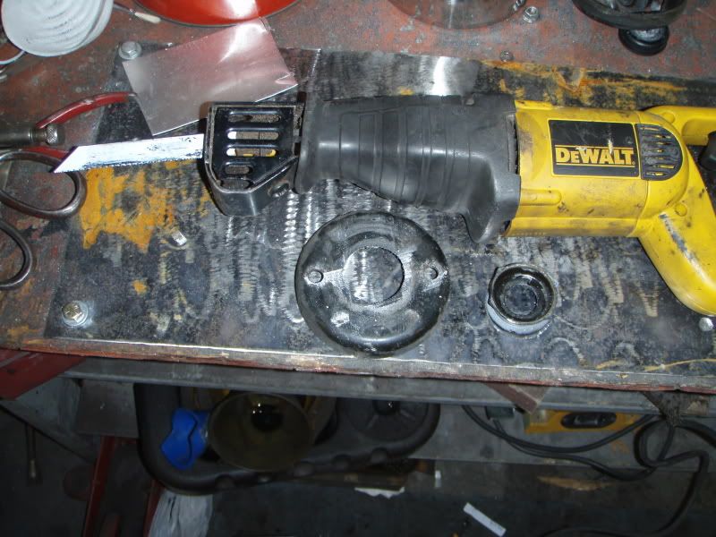

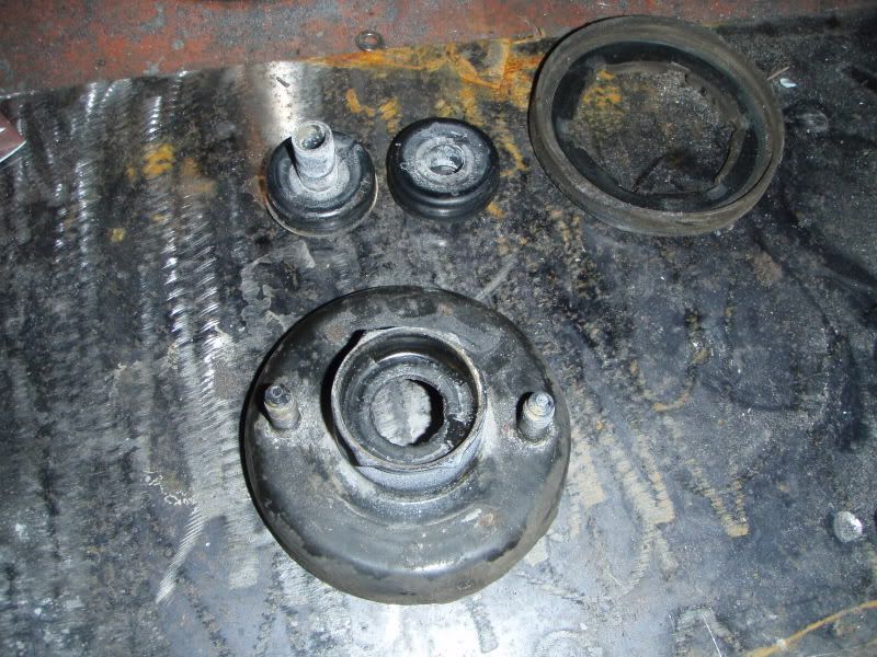

Pretty basic mod. Enjoy...

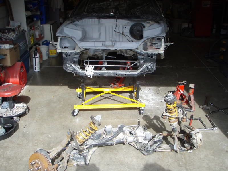

Riding around like a toolshed with bouncy suspension is not cool. The car I am building will be running  Koni's and coilovers (GC"s) poly...ect..  Primary use will be autocross and track events

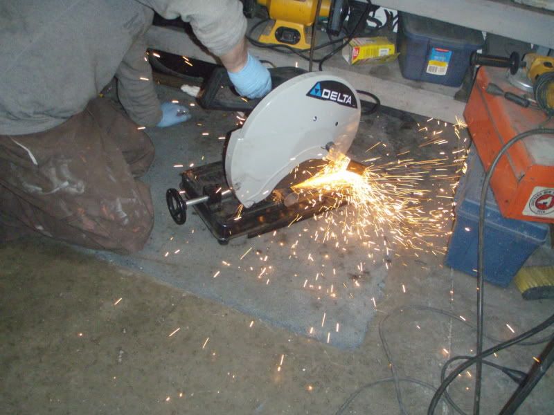

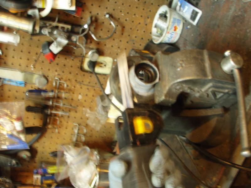

Cutting 1" piece of pipe

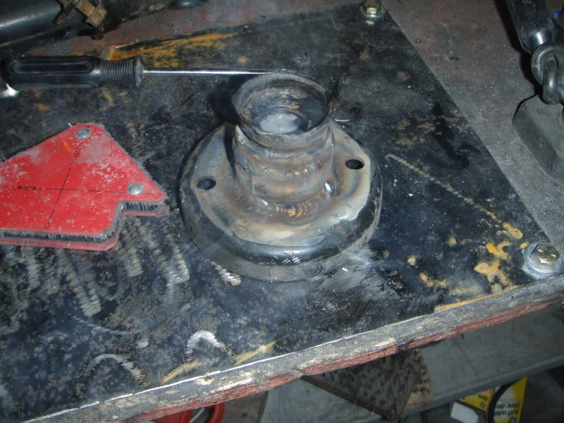

Welded, ready for finishing

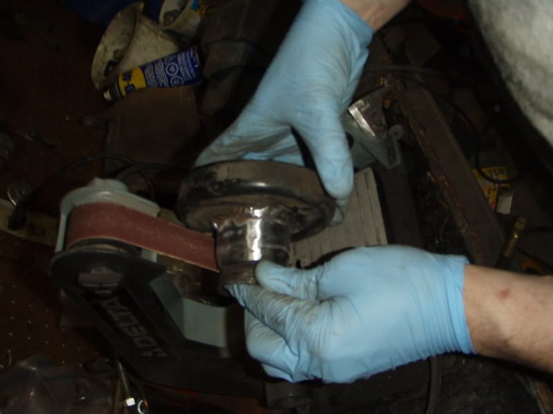

Belt sanding (gotta make it pretty for Powdercoating)

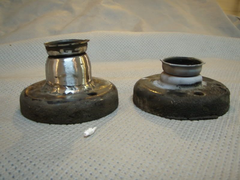

Comparison of stock vs extended

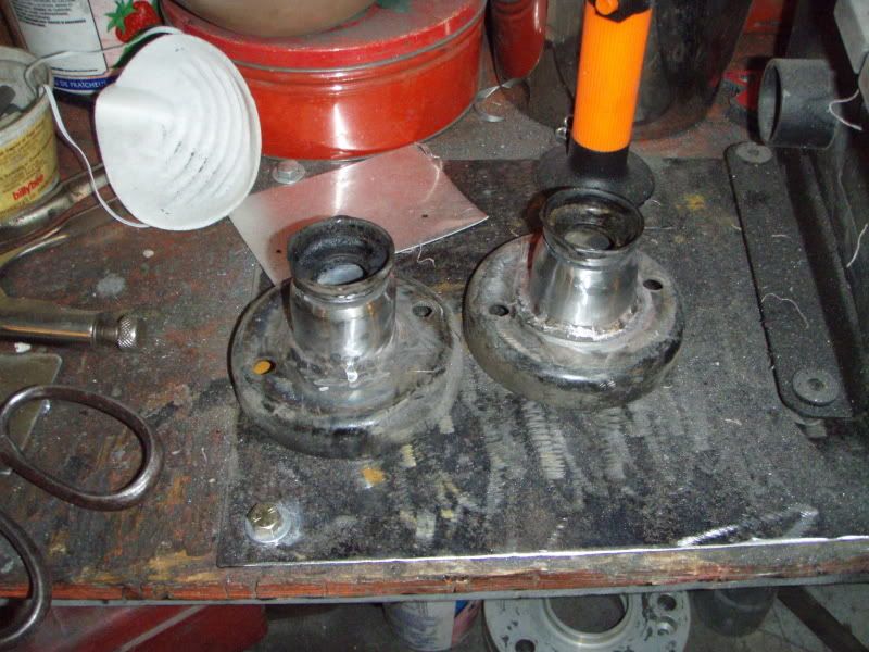

2 done , 2 to go
Next up rear suspension limiters

« Reply #6 on: April 13, 2009, 03:07:40 PM »
It's actually sitting on the hood of my corvair which slopes. They are dead  level... I know..I used a level :)
