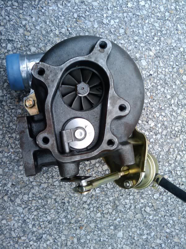

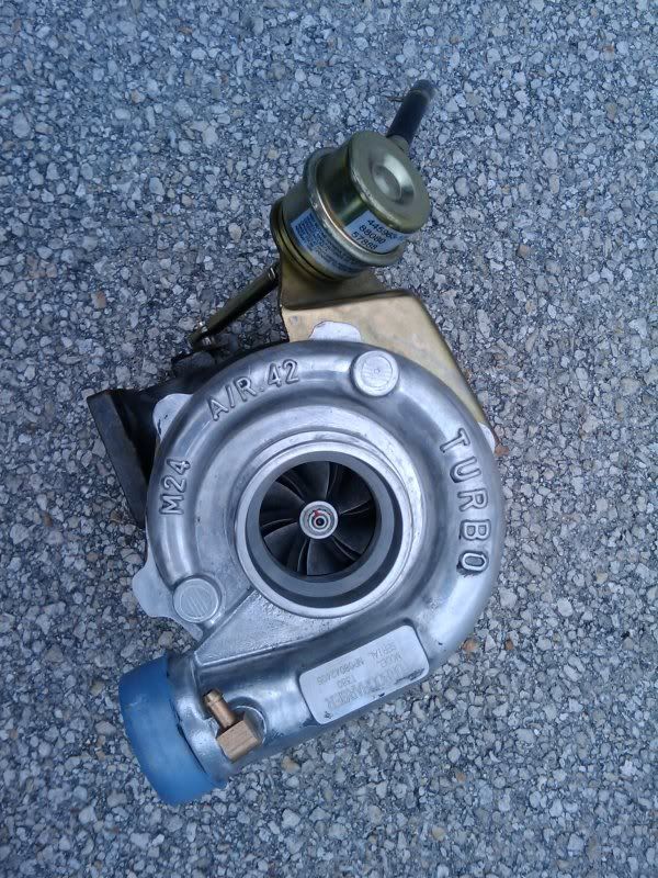

I picked up the turbo. I'm taking a risk on a cdm piece. I kept checking my local craigslist, but all the turbos were too big or too much for what I wanted. They call it a t380.

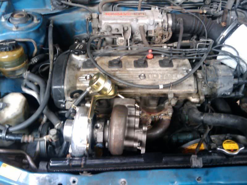

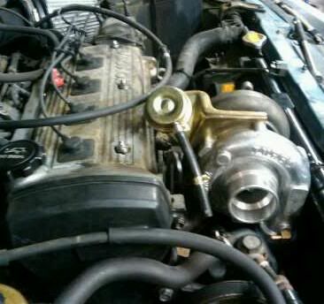

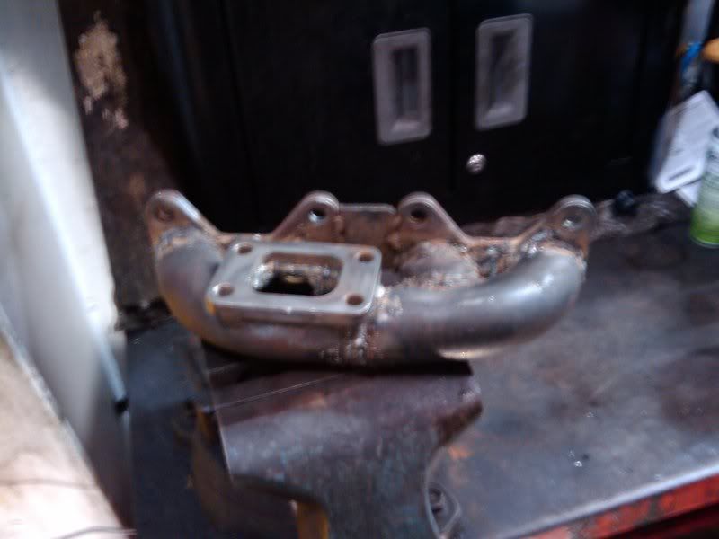

Fluxcored mani is done. I picked up a stock manifold from u pull, hacked off the flange and used piping from an old set of headers from my monte before I went turbo with it.
Test fit. I will probably go with a civic half radiator. If not, I will put some kind of shielding on this radiator.
Another angle

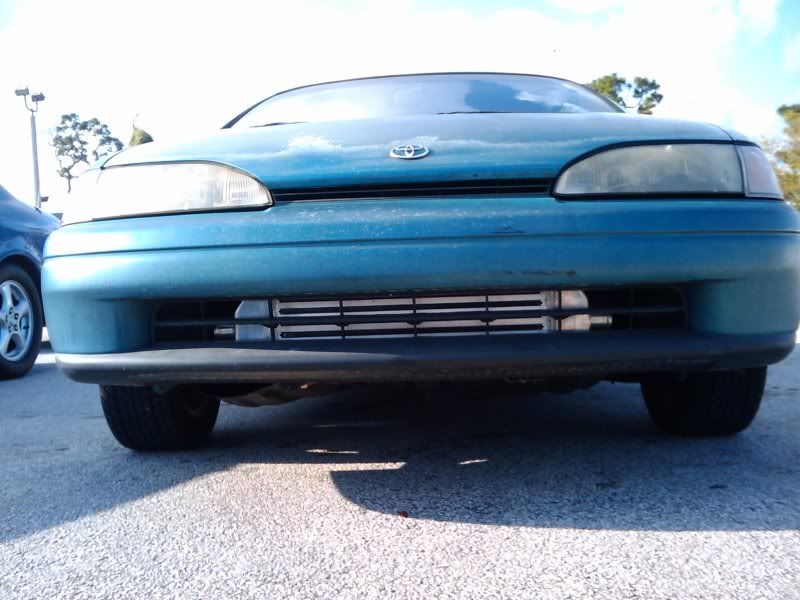

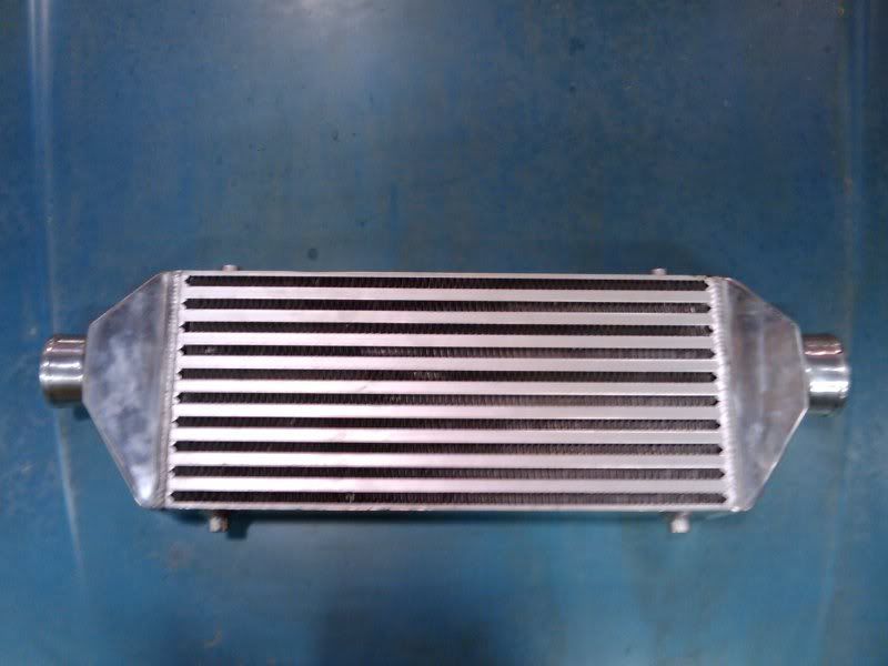

Intercooler.
Intercooler installed

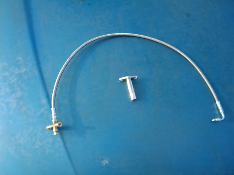

oil feed and drain flange

Great work, ive always wanted to see how one of these would handle mods. Although i am a little concerned about your manifold holding up to heat and weight on it. Did you brace it at all?

I think the manifold will be fine, its pretty close to the head.
I am planning to brace it when it's ready to be bolted in for the last time.
