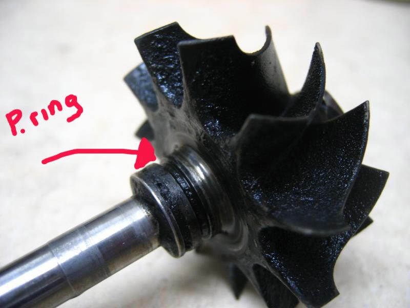

I agree with this.  Same thing hapened to me my turbo was leaking out of the hot side but had no shaft play, 500 miles later it has all kinds of play.  the oil is leaking out of your turbine when its spinning but only pores out of the center section wen it stops moving.  Get it!
theres no seals on the hot side just the shaft piston ring.
It looks like this
It looks like this
thanks bro
i replaced that as well...
