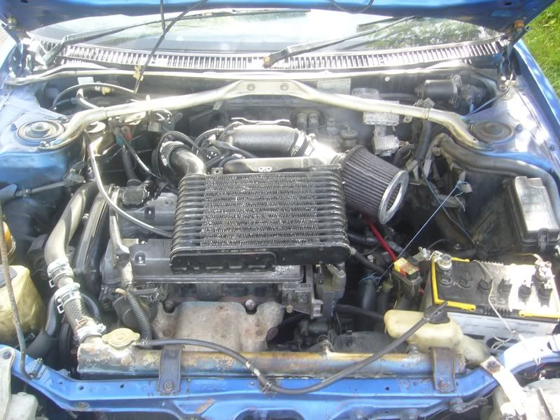

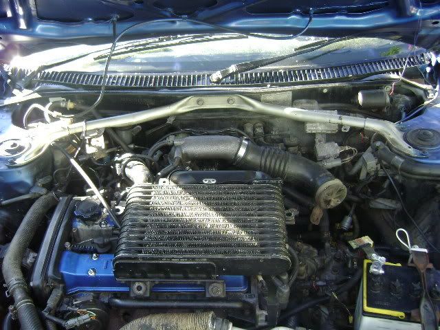

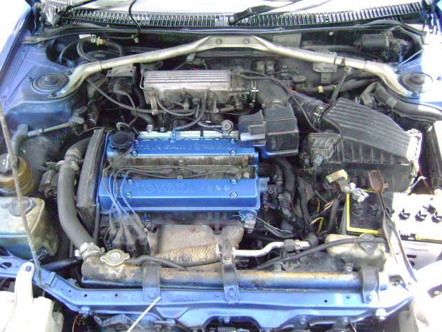

Intro :- I'm a student , i'm broke, and i wanna make my car faster

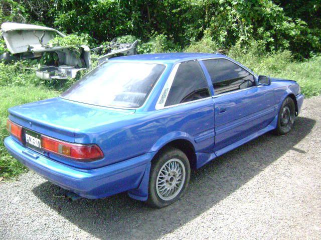

The car . 1989 toyota levin with a mongrel 4agze in it. Started off like this with a redtop high comp 4age
4age with sc12 s/c at 9 psi, 10:6:1 c/r, tmic no hood scoop.
Blew the head gasket the same day took it home from my friends home due to a busted radiator. Rebuilt with forged oem 4agze 8:9:1 pistons and semimetal gasket.
Cut the hood with a grinder to make a scoop and took the car to the track on dec 6th Run a 18.0 with a massive boost leak, only had 3psi , and all season tires. That was the last sraw with the s/c. took it off as soon as i got home and started turbo conversion.

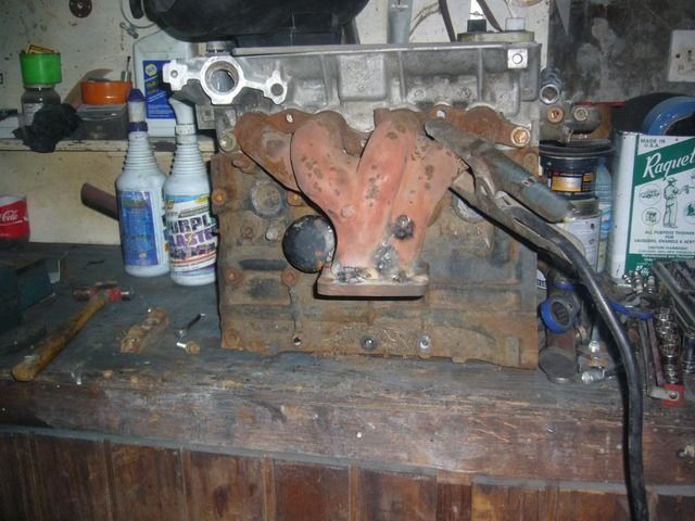

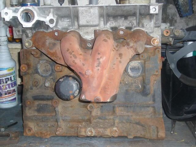

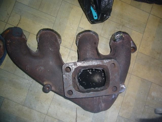

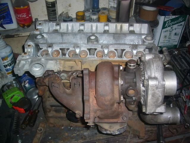

1st manifold attempt
turbo hit oil filter and mount when mounted in car so i scrapped it and went to work on this

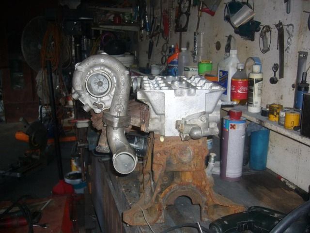

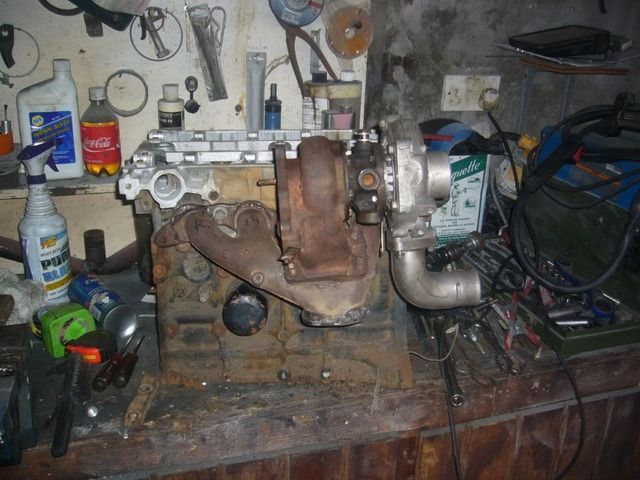

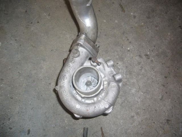

free t28
manifold on prop block and head
still need to port manifold run oil lines and piping.

Badass build.  Lookin forward to more progress.   :D

fucking yes to that manifold.

That turbo mani is sex..........

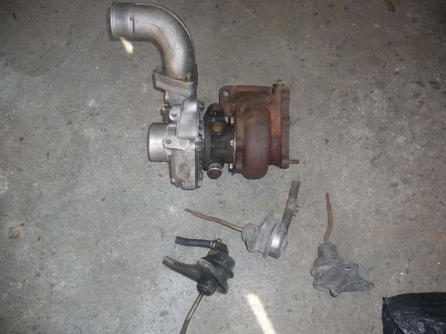

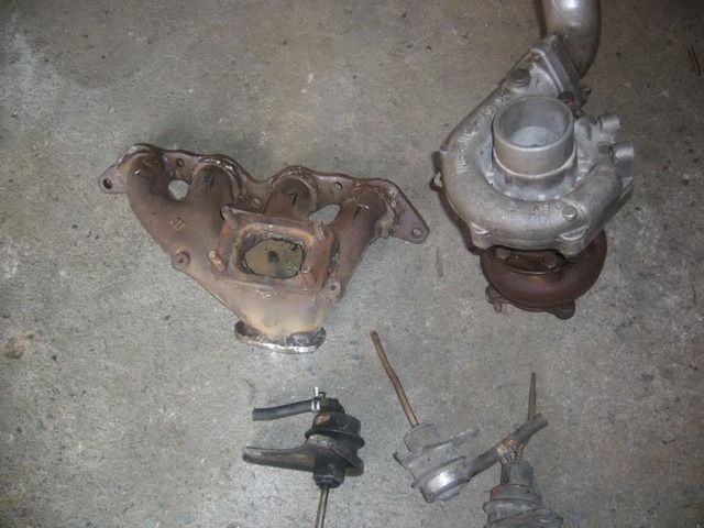

pics of the wastegates im tryna make work. Dont know wtf they came from.
« Last Edit: January 25, 2010, 09:00:12 PM by evo_lucian »

ct9 actuators suck, they do 8 psi but they crap themselves prety easy, dsm ones have worked pretty good for me
evo_lucian
  • Posts: 669
Re: There is low budget and then there is this
« Reply #19 on: January 25, 2010, 11:27:56 PM »
Which is the ct9 wastegate in the pic ? Dsm wastegate is out of the question because i live in caribbean. No dsm's around. I intend on making one of the wastegates work  :evil:

that is the fuckin coolest manifold ever!! :mexi:

BTW get a chonged out WG for $45 and weld the flange where the original outlet was for the header.

Thats the plan. waiting on a friend to upgrade to a tial so i can snatch his 38mm cdm wastegate.

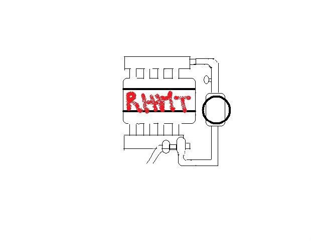

home sick from school, bored so i made a drawing of how the turbo set up will look when im completed. square with black circle is small intercooler with fan on top mounted on gearbox.. The rest is simple
