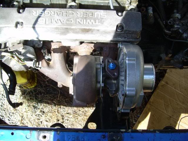

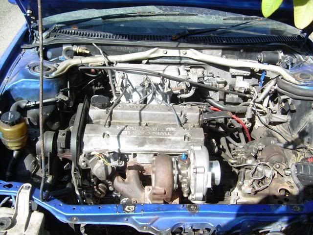

Ok a bit or an update. scraped the t28 in favor of a t3/t04e , The t28 was missing a plate that goes under the turbine wheel , I was told that running the turbo without this plate will lead to premature seal ware so a friend gave me a brand new t3/t04e for free. Compressor cover says .50 ar and turbine says .63 ar
More to come

Not much of an update, but i finished intercooler mock up just need to weld abv to hot side of piping and finish oil lines and still waiting on a wastegate , I start work next week so hopefully i will be able to get one after pay day.
Got a question for the more knowledgeable members , i was showing a guy some pics of the manifold and he pointed this out to me:
" wont the exhaust gas have a whole heap a turbulence wen it flows downward according to the shapes & direction flow of the logs / runners, bucks up on a plate (assumin that the regular exit to the manifold is blocked off) & then has to flow upwards to the turbo?"
Now my question is how does a turbulent exhaust gas flow affect a motor ? Boost spikes, slow spool ? I really dont give a fuck because im gonna use the manifold either way.

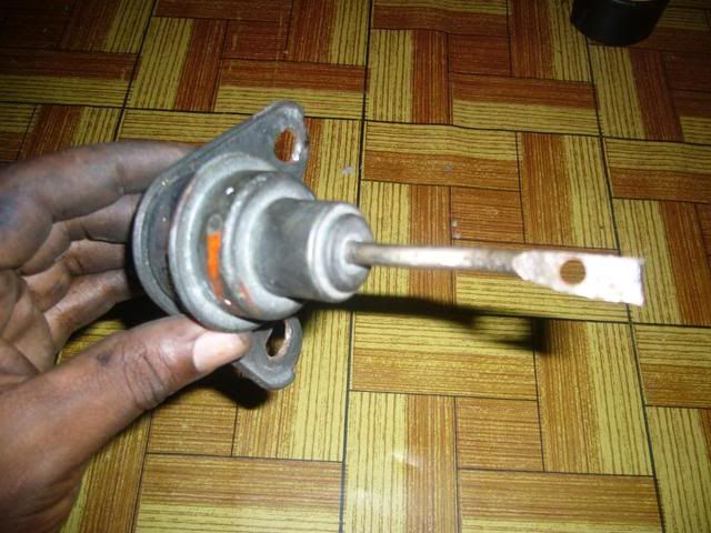

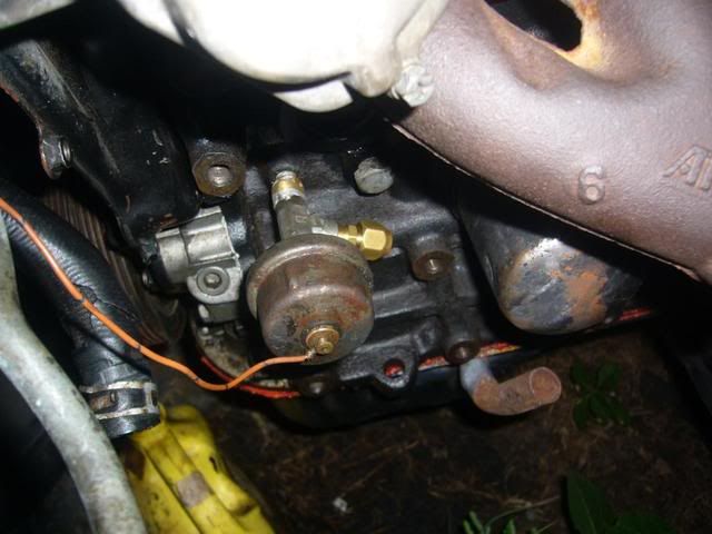

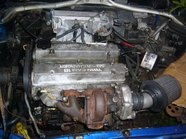

Ok a bit of an update. Progress has been really slow, due to me not having much spare time and money to complete this build. Decided to revert to the t28 i originally planned on using because I figured the t3/t4 would be nice for the power i am looking to make but i dont have the external wastegate yet and i wanted to start off with something a lil smaller for my initial build.
I still needed an internal wastegate for the t28, the stock one was no good because it would hit the radiator fan shroud, so i had to modify another to fit. I had a couple laying around so we went to work on it and came out with this.
The t28 was missing a "dust shield/heatshield/plate gasket thingy" couldnt get it anywhere so i improvised.
Cut up a 7afe piston ring and used it as a gasket/spacer thingy.
Still needed a tee for my oil lines, one night i was helping some friends work on a v8 powered supra and asked if he had any tee's. He gave me a brass tee but the threads didnt wanna mesh with the threads on my block. Took it to my workplace and sorta bevelled the tip but it still didnt wanna mesh so i just cut the tip off an oil pressure sender and brazed it to the tip of the tee. came out pretty good. Added some solder for good measure.
Almost done. Just need to finish oil drain and harness tomorrow and it willl be ready to boost.
Will get some pics of my copper oil feed etc tomorrow.
« Last Edit: July 31, 2010, 11:30:24 PM by evo_lucian »
