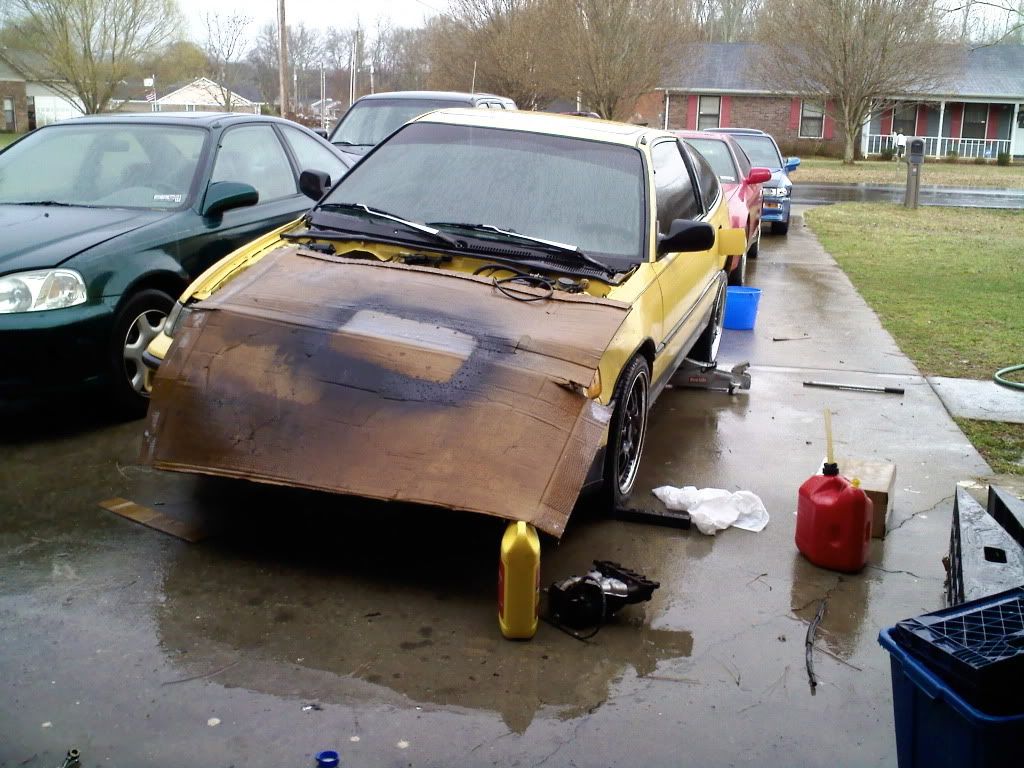

Got the LS-VTEC together.
Tried starting engine, firing order was off, corrected that and it started fine.
Drove down the street, started part throttle/part RPM a few times, then opened it up.
Got to the end of the road, turned around and started coming back, noticed the temp was about 3/4 of the way up, halfway between "normal" and "hot."  Turned the car off.  Wouldn't start back up but that was due to a ground problem.
Jumped it, drove it home, was dark and late at night, parked it and went home.
This morning went back to it, went to put in fresh oil.  Noticed on the back of the block there was oil everywhere.  Assumed it was maybe the oil filter hadn't sealed completely, however when I took it off it was very fucking tight so I doubt this is the problem..  Drained the oil, and only got a quart back.  Changed filter and put fresh oil in.
Started the car with the radiator cap off as I assumed there was still air in the cooling system and was going to bleed it out.  Within 10 seconds, the radiator started overflowing.  It seemed like it was overflowing straight oil.
The little bit of headgasket that was sticking out the cam side seemed to have a little bit of oil seeping out.
At this point, I was assuming the headgasket was bad, which is strange since it's a brand new cometic headgasket between a resurfaced head and block, torqued down to 85lbs with ARP head studs (that's what their info sheet said).
Started taking the head off and there was also coolant in the head.
Got the head off, the headgasket seemed covered in oil/coolant, which may have been from removing the head but it seemed like a little too much for it to just be from that.
The block had a small crack in the outer cylinder wall, which may have been there before but I don't remember seeing it, and think the shop would have mentioned it.
Any ideas what happened and/or what is wrong?
"Burn" marks seem fine?  Don't see anything that looks weird in the cylinders.
The crack in cylinder 3.  You can see the imprint all around the block/head from the headgasket, so I'm assuming it sealed just fine, however I have no idea why coolant/oil are mixing.
At this point, I'm completely broke and still not working due to not having transportation.  Possible to reuse the block?  Possible to cheaply fix the block so it lasts at least a few months?  Possible for anyone to sell me a cheap, good, bare LS block?
