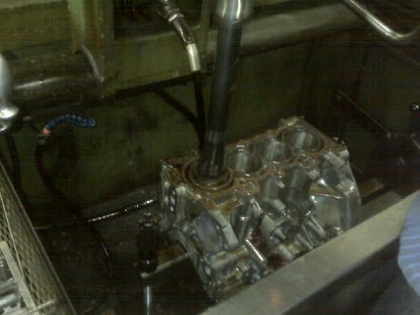

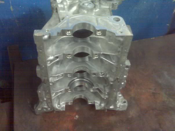

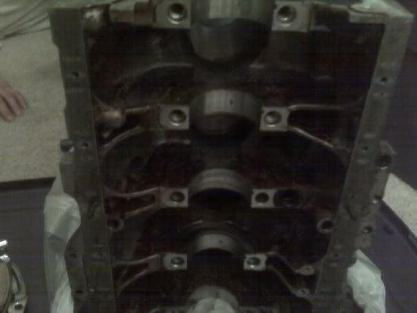

all the machine work is being done by my friend at his work
Before
After
Caleb at work
and now

bad news from the machine shop, after block was honed the pistons were under spec so they need to be sent out to be coated and the pins need to be upgraded to handle more boost.... so new plans ....all out race car now i need to get a big turbo. The car is going to be painted olive drab i also have some 16'' black rota slip knockoffs im gunna rock

the pistons were suppossed to be .020 over which would have been all fine and dandy but... before honing the block i checked the pistons and they are only .002 over stock bore.  :o and all the cylinders were tappered .002 and one cyl was out of round about .0025. no good. but the only other d block we have arould is a z6 that had been laying in the rain and basically junk. so we honed it to see what we could do and it turned out that they cleaned up ..0055 over what the pistons are....but the pistons recamended ptw is .004 so we are going to send the pistons out for coating and gain .001 so we should only be .0005 over spec. but for engines running high boost ( 30 psi +++) the piston manufacturers usually say to have a little more clearance. so the pistons will be sent out to coat asap and we'll see where that gets us. Have any of you had any problems with the wrist pins breaking???

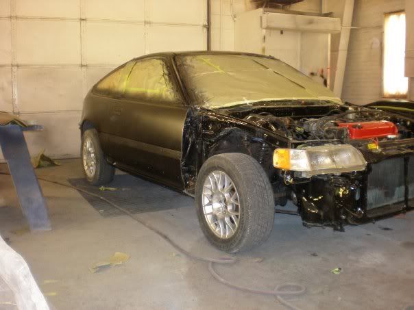

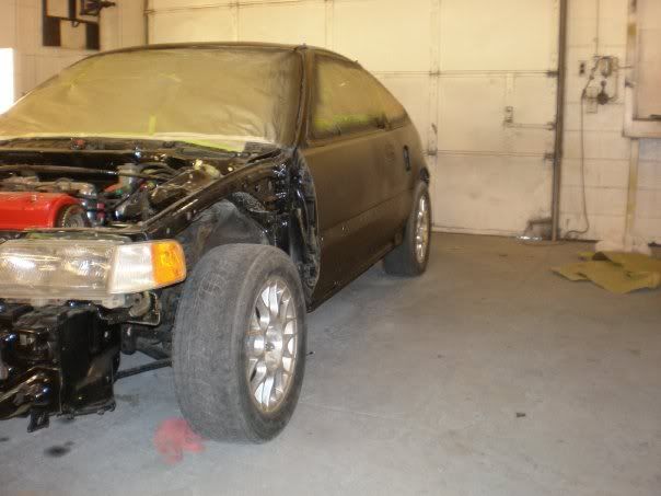

sorry i kinda or made that sound bad. when i bought the pistons the were susposed to be .20 over but the order was over the phone  so they wont take them back now. so caleb is doing what he can to make them work give him a break his mom is hotter than shit
heres some more pics of the slut as it sits now in black primer
