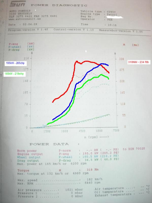

So I was at the dyno a couple of days ago, and I'm having mixed feelings about the result. I know I didnt get enough time to play with cam gear and timing, but I'm just trying to find the biggest bottleneck before I head back and spend another fortune on the dyno. Its a vitara d16z6, log mani, a t3 .48a/r hotside and a full 2.5" exhaust, so I know I will have backpressure. I need the powerband, so I want to keep the exhaust housing, if possible. The torque is great from the turbo spools right before 4000 rpm until 6000 rpm, when it falls on its face. Turning up the boost from 15 psi to 18 psi didnt do shit in the upper rpm's. The turbo has a t04e 46 trim cold side, so I dont think thats the problem.
I have seen graphs where the .48 ar hot side holds torque up to almost 7000 rpm's, so I was kind of dissappointed. I dont find much info about whats the effect of going with a bigger bore tb and a ported/aftermarket IM, and I dont want to go searching and creating traffic on rick p's site  >:( So I'm hoping someone could explain a little...
Here's my dyno (oldschool printer, lol)

What kind of power did your car make? Was it 210? or 330? That dyno graph looks all wacked out to me
Yeah, its kind of a mess, lol
Here's some mspaint action
On my last setup, with basically the same stuff except from a 50 trim t3 and less boost carried torque almost to 7K. This one falls on its face @6K. 15 psi or 18 psi from 6K and up didnt make any difference :( I've seen dyno's with that same small exhaust side carry torque close to 7K in the 20 psi range, so I was hoping to achieve something similar. I cant afford a cam, valvetrain, IM and TB now, so I'm just trying to figure out whats the worst part inb my setup.

IMO its still a mess. Apparently the dyno op thought he could accurately guess crank power (chp, bhp). That's one reason I hate dealing with foreigners on cars, they ALWAYS are either doing a slopy convertion to crank HP, or using the term brake HP (BHP) on graphs from a chassis dyno that reads wheel HP (WHP). As well as using PS/KW/NM/MonkeyAss units for numbers.
I could care less if you do that amongst yourselves, but IMO when you come to a forum in which 99.8% of the people use a particular method, you should have your ugly shit ironed out before hand to match.
As mentioned earlier, its not the housing so much as the stock fuel-sipper NA SOHC parts you're using. Maybe you should be like other people with a stock-D setup: either be happy with it, spend a shitload on parts (to the point of NOT being cost-effective), or use a giant turbo with lots of lag with a 4" pipe sticking through your hood.

Meh, I'm pretty happy about how it pulls, and I have no idea (and dont care) what the numbers mean compared to other dyno graphs. What happens at the circuit matters. Its just the torque graph that bugs me a bit because I can feel it dying off when doing a pull. I dont feel that spending a little $ for a better IM/TB and getting a retune from someone who has experience with small displacement turbo sohc's and doesnt think they suck from the start isnt cost effective, if I can get the torque to hold a bit better.
I appreciate any input though, and maybe your right that its just how it will be without spending a shitload of money, but I'll give it another shot and see whats happening. Its the first car I've turbo'd, so I'm having fun anyway :)
