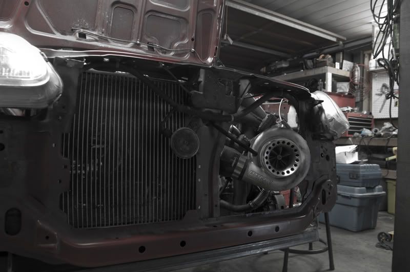

little update on this
i ditched the water to air, went air to air.
turned the boost up to 25psi and went a little easier on the tune.
got some 24.5's and started breaking axles and taking out trannys with broken axles.  (nightmare) haha chris m u told me so
so far no internal transmission failures, but lots of broken axle stubs in the LSD...
im preloading like a jew. but not in the good way.
made the manifold a true front mount
the car made 499.7whp on C16/25psi and put down some pretty OK numbers.  best 60ft is 1.61, i was shooting for a 1.5 but started breaking shit pretty regularly...
