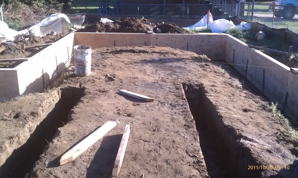

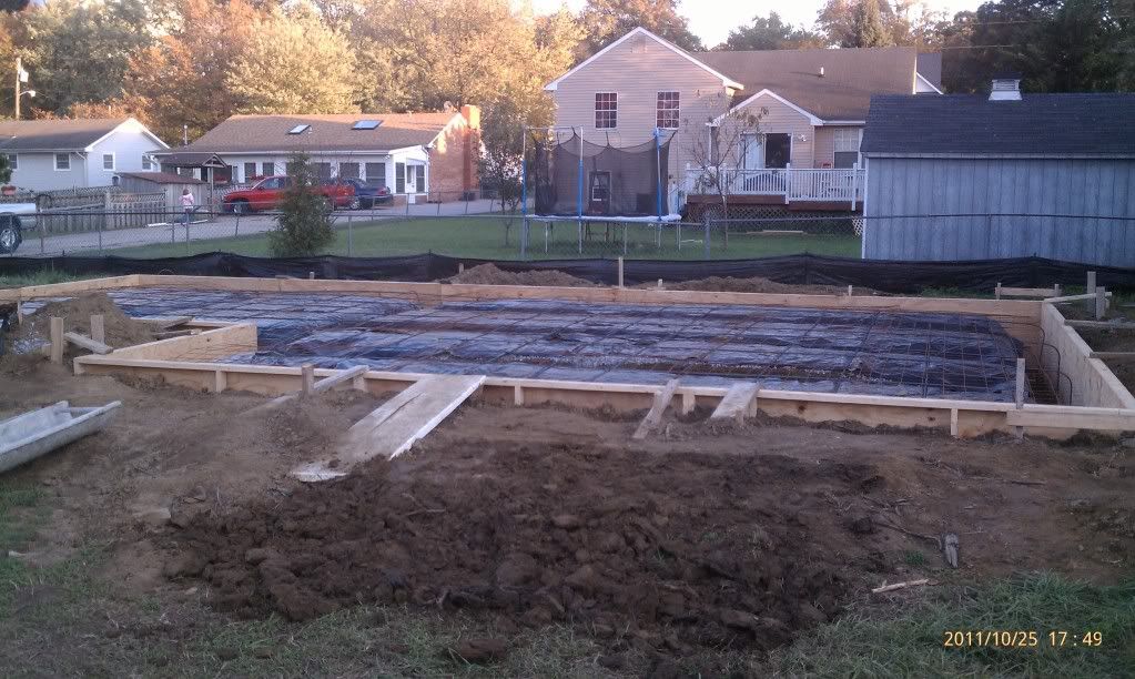

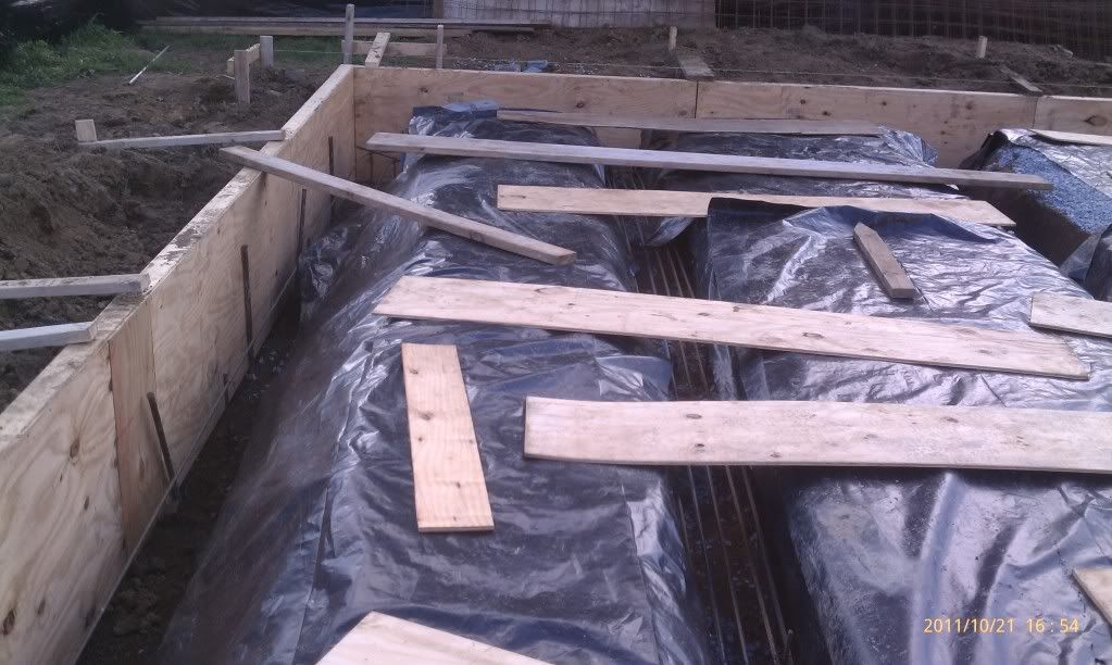

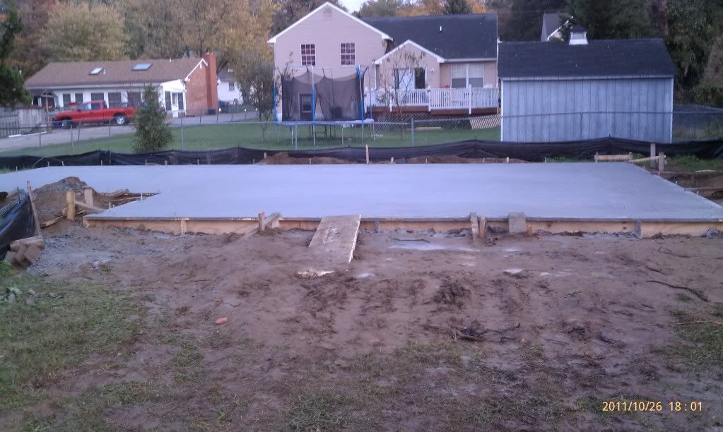

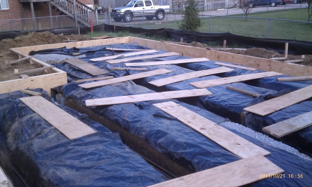

Repost + updates:

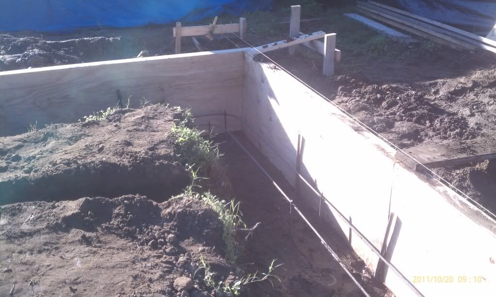

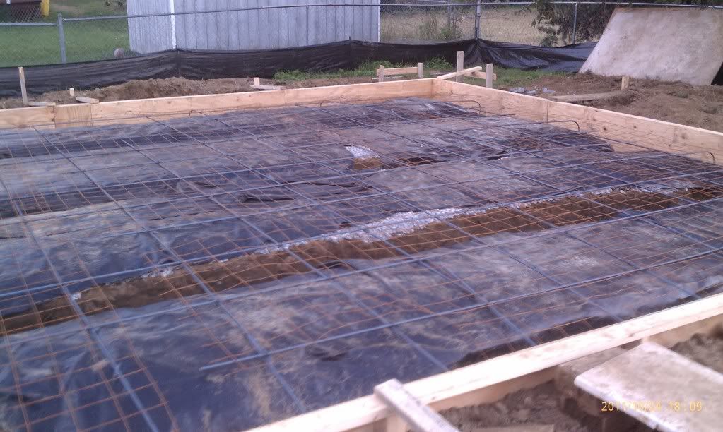

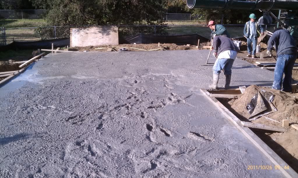

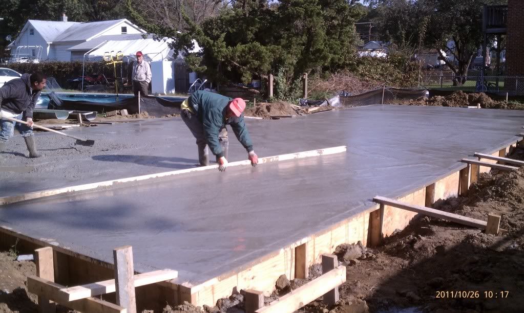

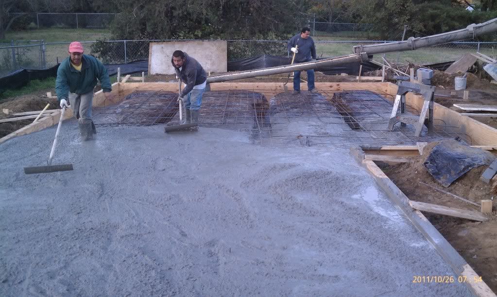

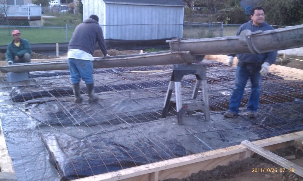

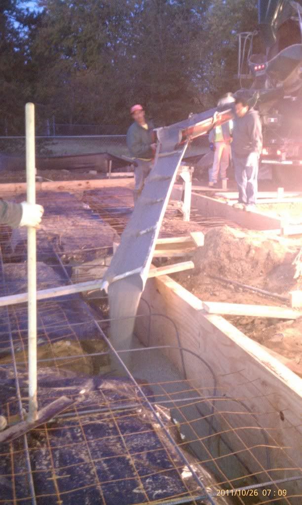

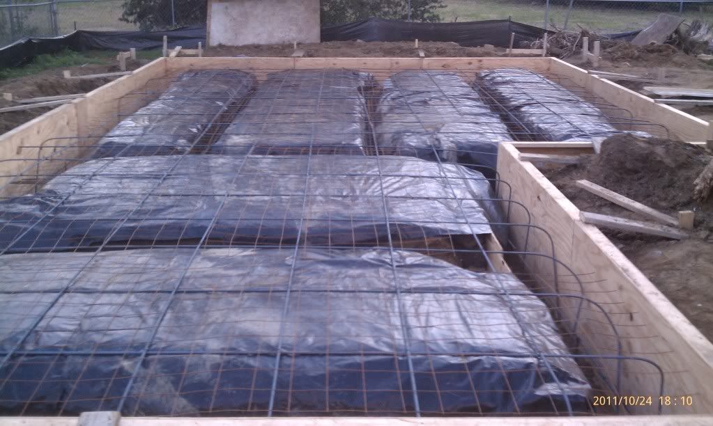

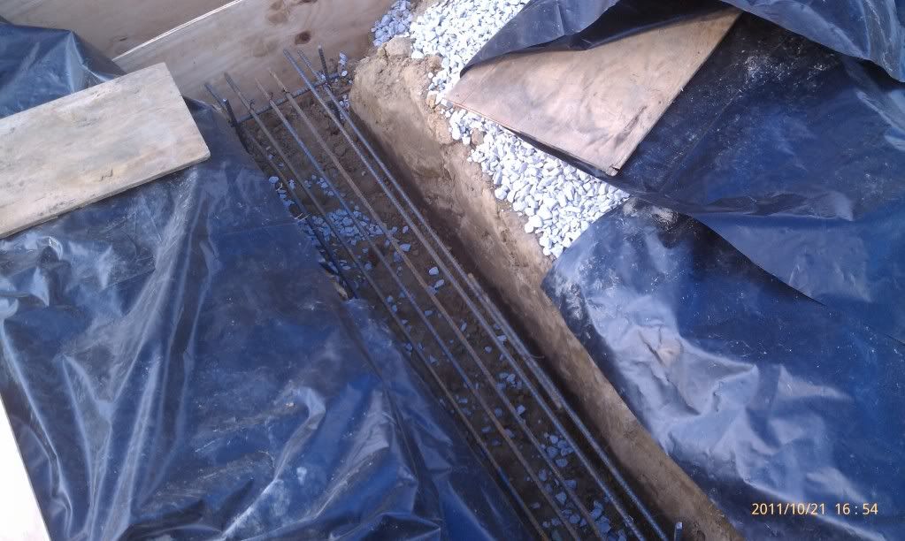

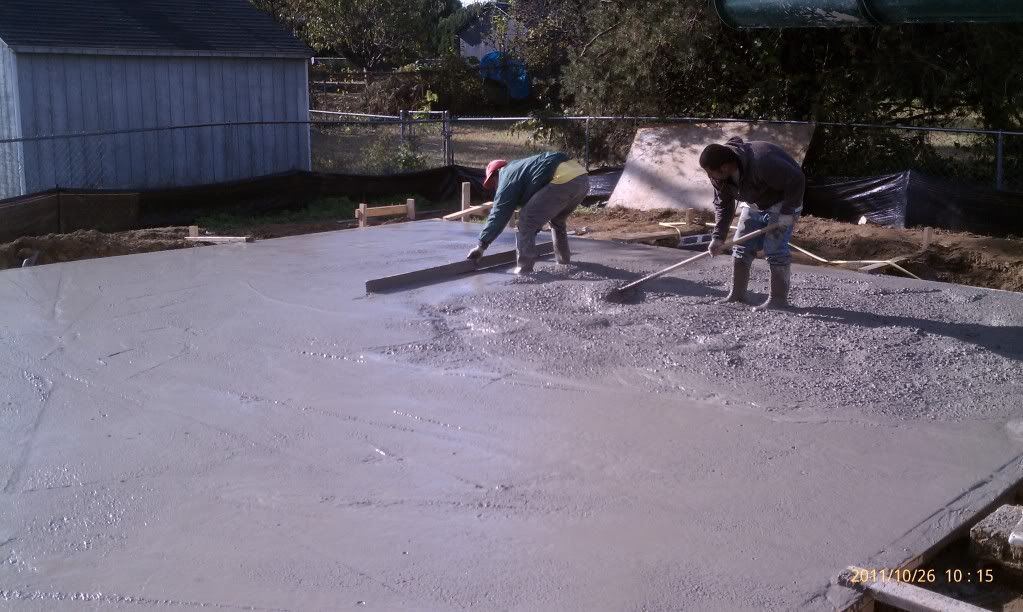

So I'm building a garage, just got the slab poured today.  Here is a shitload of pictures.

« Reply #4 on: October 26, 2011, 08:11:23 PM »
FUCK YEAH! Looks good.
Re: Building a garage!
« Reply #5 on: October 26, 2011, 08:31:21 PM »
No floor drains?
I get pissed daily that my shop doesn't have floor drains

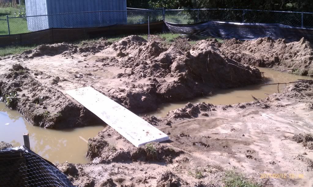

Is it just me or does it look really wet outside in the pics? Hope that concrete cures with no problems. Other than that, looks like a sweet project. How tall is the building going to be? And what kind of lift are you looking at?

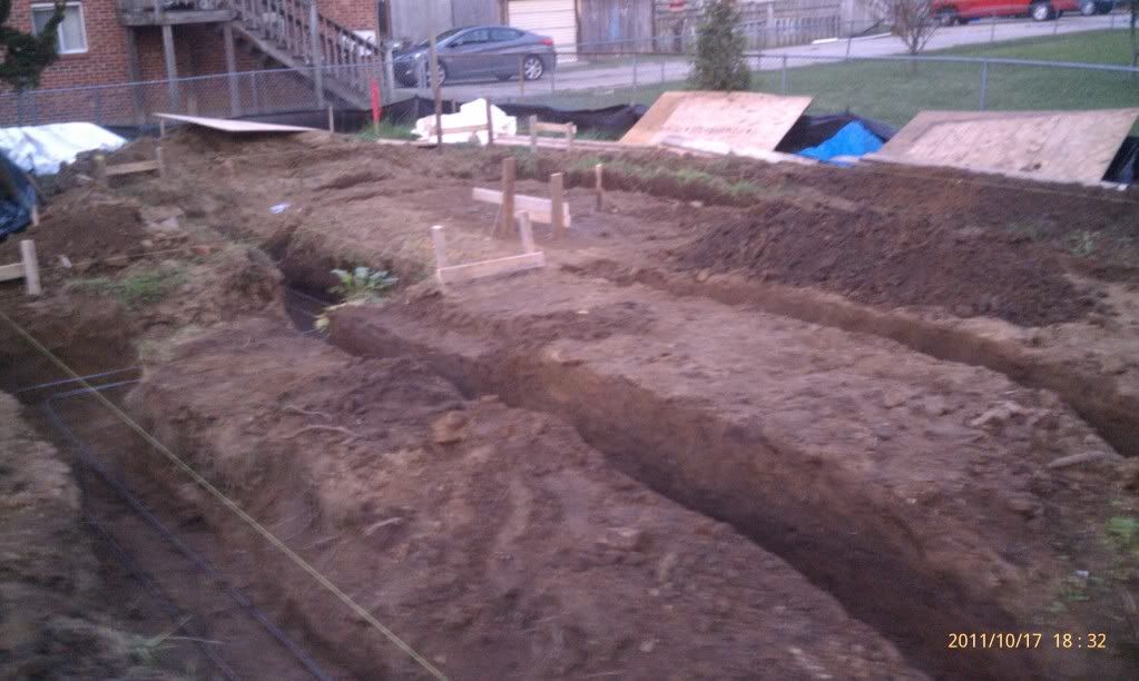

i'm curious about the slab as well.  looks like it's gonna be sweet.  fucking deep ass footers too, damn

All said and done the concrete was about 15.5k.   7k raw materials (40 yards concrete + rebar, wire mesh)  6k labor (excavation, forms, backfill,  rebar mesh gravel...) and about 2.5k contractor fee/profit whatever.
For one thing the building reqts out here in anne arundel county, md, are excessive to say the least.  require atleast 30" deep by 18" wide footers, and the grade beams, with 4+ inch slab.  Plus I got rebar + wire mesh + the fiber reinforced concrete.  should be strong enough to park a tank... or so the concrete truck driver thought...

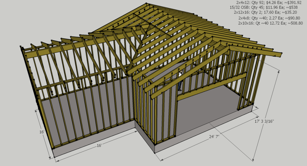

I added up some numbers for the wood framing, seems pretty cheap.  Things like shingles and siding might surprise me though.
I'll try and get some shots of the texture this weekend.  Winter sucks, barely get to see daylight anymore.  Some areas are pretty smooth, others are somewhat textured.  It'll probably be about 40 degrees daily once its cured for a month.  Too cold for that epoxy finish to dry?

I know it is waaaaaay too late for this now, but why didn't you run PEX tubing just in case you decide to do radiant heating later?

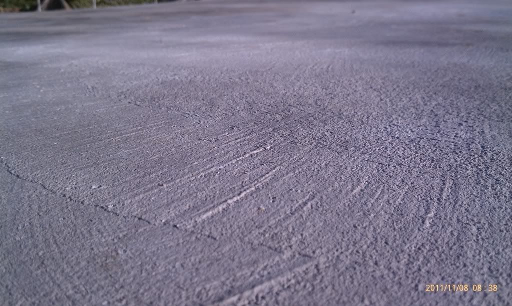

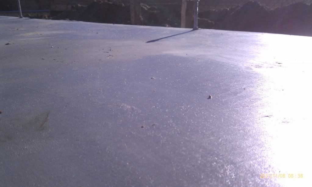

Here's the roughest area,
And the smoothest area,
I'm thinking powerwash it and paint it next weekend, weather permitting.  Was like 65+ temps out today.
Steve, you think I need to sand it or do anything else?  How much paint for 832 sq feet?  I'd guess 4 gallons... plus the clear.
« Reply #21 on: November 16, 2011, 01:31:28 AM »
Based on your pictures, I think 3 "kits" (6 gallons total) (each "kit" is a gallon of the color, and a gallon of hardener= 2 gals/1 KIT) will cover it. You might be able to spread 2 kits to work, but when you run out of product and the floor isn't covered, you're fucked. If you're gonna use the Sherwin product I do, call your local store and make sure they stock it. Most don't, and it'll take them a day to get it in.
Your roughest areas aren't terrible, and neither are your smoothest. I'd say the product will stick to both, but I would go the extra mile and run a concrete floor grinder over the whole thing to level everything nice. I rent these by the day for $70-$100.
After that, use the hose or a powerwasher (better) to blast all the dust off the concrete. I sqweegy (sp?) the excess water off to help it dry quicker, but you may not need to be in that much of a rush. either way, make sure it's dry.
After it's dry, you have your product, and the flakes (if you're going to use them)....I buy more H&C Deco flakes (from Sherwin) than I know I'm going to use, because again, shit sucks balls if you run out and your product is drying/mixed. I like to use larger amounts of flake than what you would see on the "Johnny Homeowner" kits, cause more flakes looks kinda like granite. Anyhow, for a standard 2 car garage I'll usually order 14 bottles:
