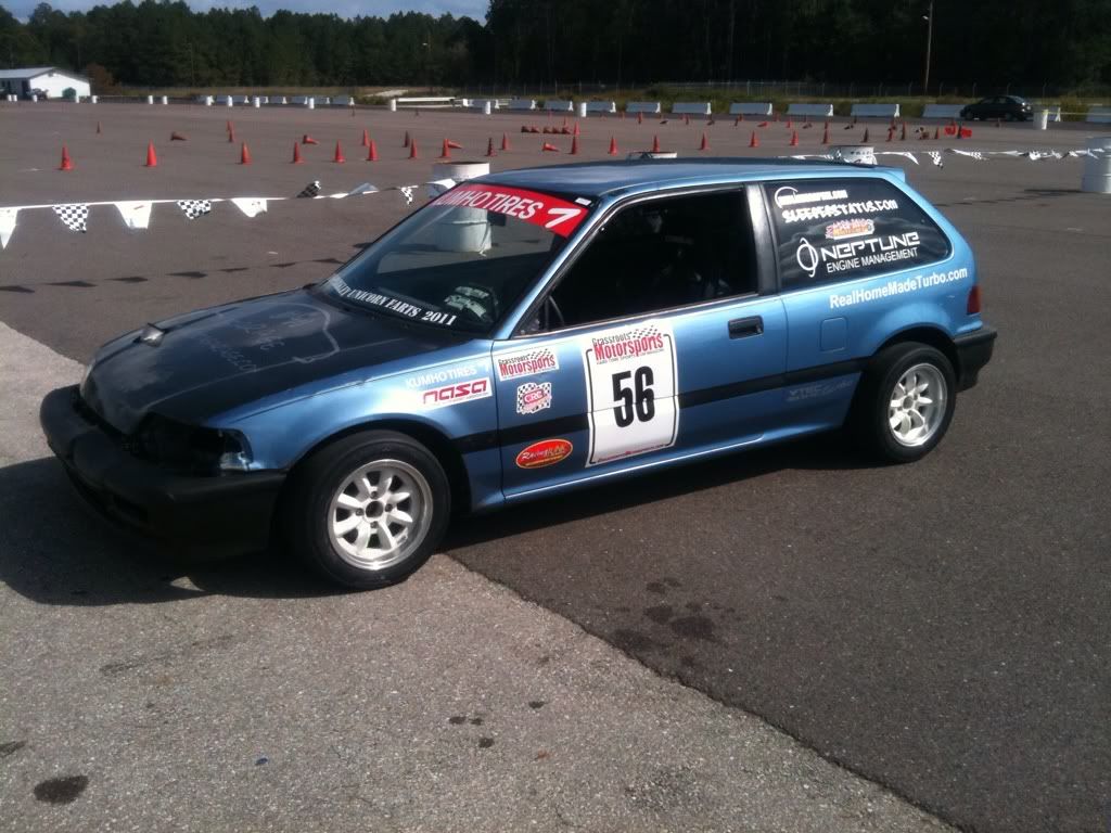

This is mine at the GRM $2011 challenge

your tires > my tires.
Re: Lower Ball Joints
« Reply #29 on: December 08, 2011, 06:09:24 PM »
Those are Lowerit's tires. The plan was for me to borrow his auto-x tires and him borrow my drag slicks.
