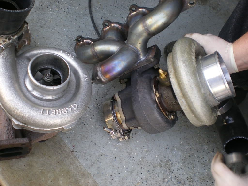

The stock obd0 4into1 constructing header.

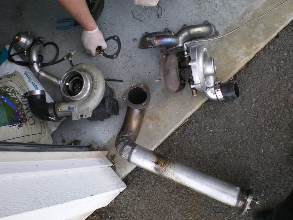

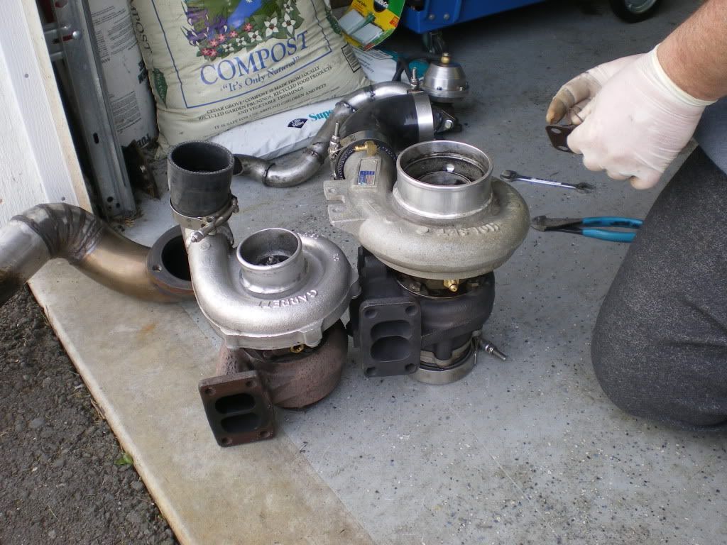

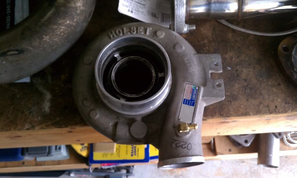

Old turbo and old downpipe with the new turbo next to it.
A little side by side action

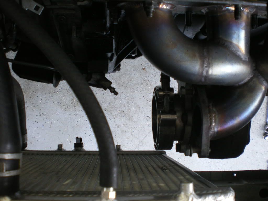

All mounted up and ready to bolt it up for some mock up action.

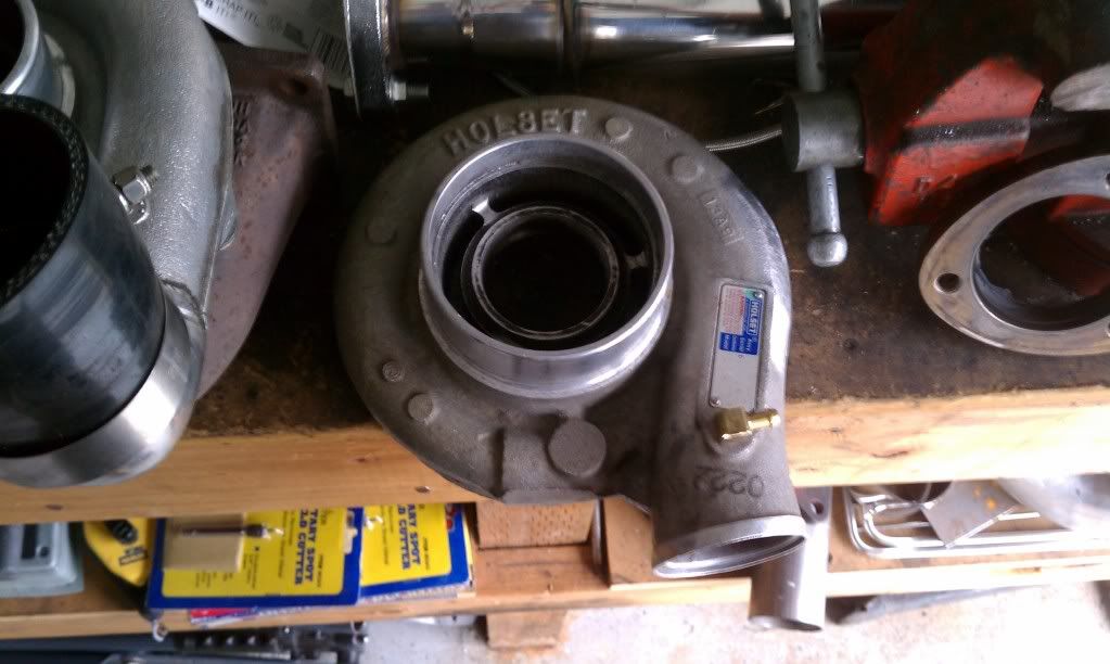

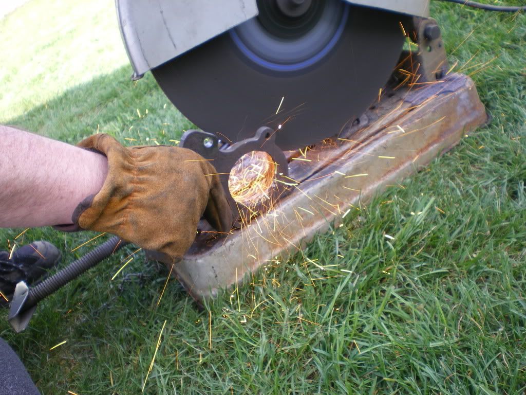

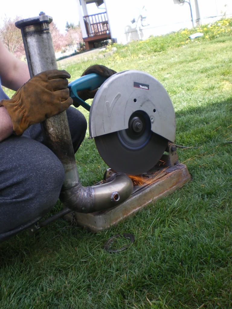

So it wouldn't fit with the compressor housing on because I have to cut the wastegate tabs off the turbo due to it hitting the power steering pump bracket. So I just left the exhaust housing mounted to the splog and pulled the rest of the turbo off. Also looks like I need to cut the vband off because with it on it would have ran it my slave pretty bad I thing.
So off to the chop saw!

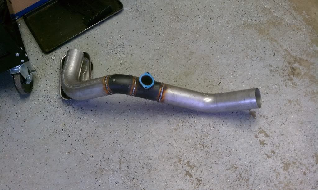

Same goes for the old downpipe, cut the flange off and thten went to fit it up and see how close I was.
What do u know, fucker fits perfect!

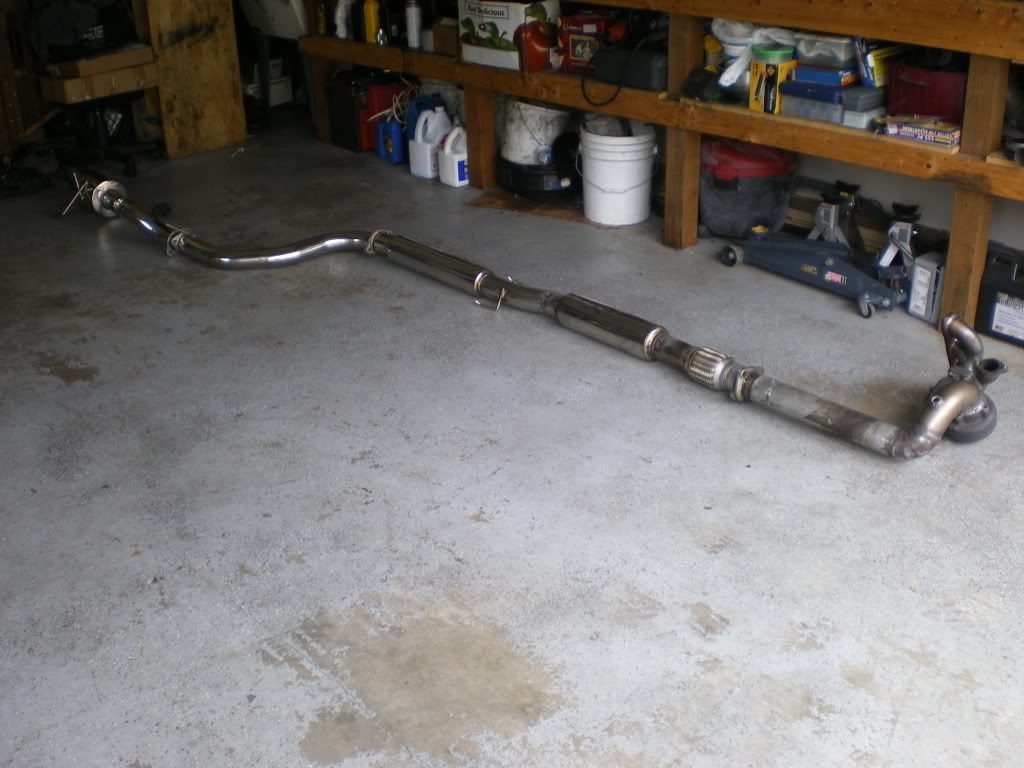

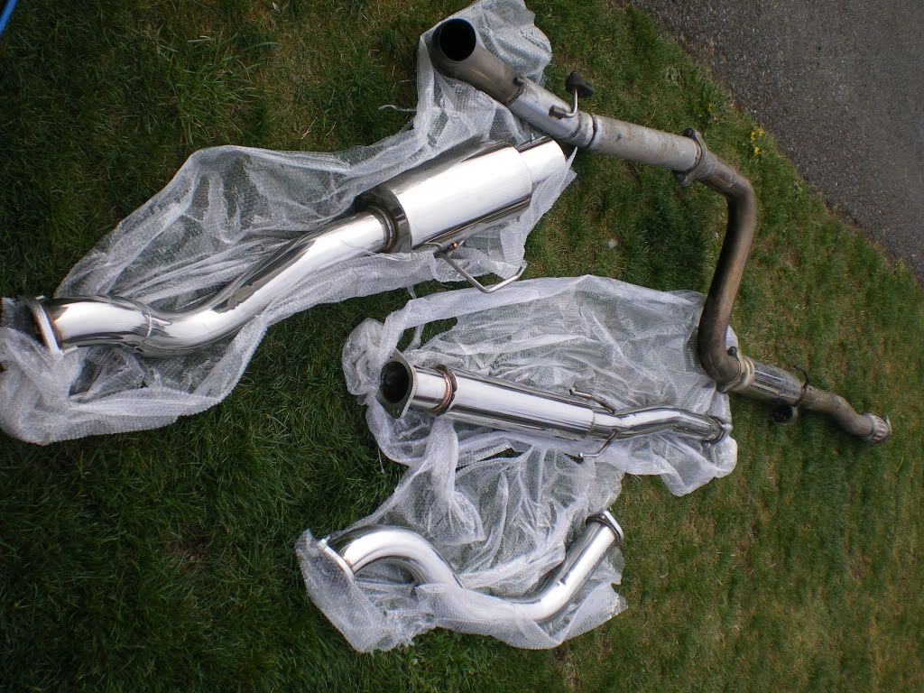

So I ordered up some China 3" exhaust for 115 shipped. Not to bad but man this shit is pretty thin. Gona cut the end off and add a resonator from my old crx exhaust to try and quiet it down as much as I can. Probably end up adding a magnaflow muffler later and getting rid of the cheap China n1 muffler. Looks to ricey for me.
Over all the exhaust fit ok, now I need to bend a few heat shields here and there, but better than mocking up from scratch. So I will say that this pipe smells very bad when up cut and when u weld it. I have no idea why, but maybe its something to do with that Chinaman oils or something. Anyways it all welded up and here is the final shot. Now its time to do the cold side charge pipe. Probably knock that out tomorrow.

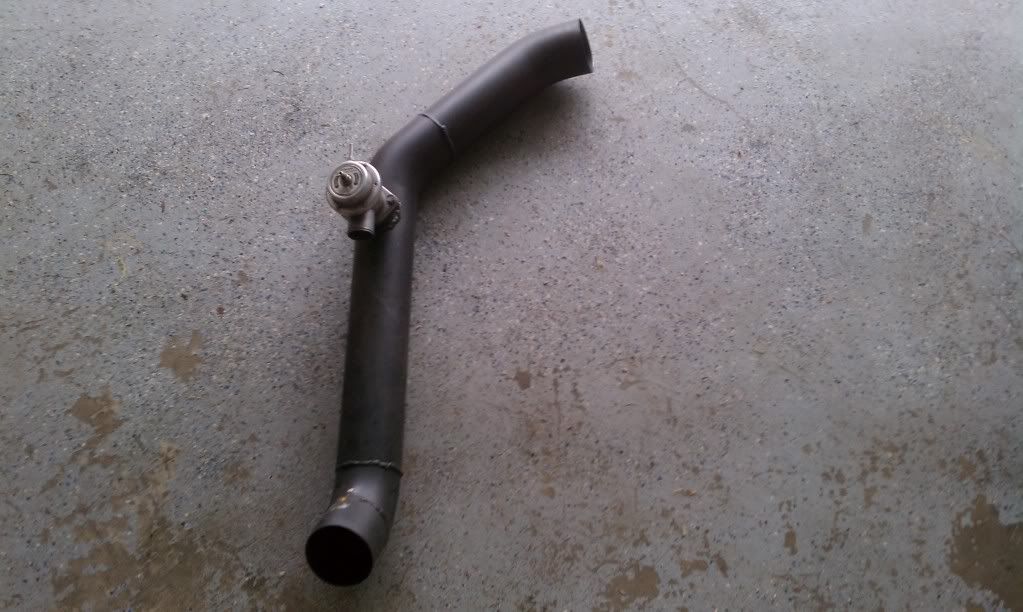

Also got the cold side charge pipe knocked out.
Old crx charge pipe
New one

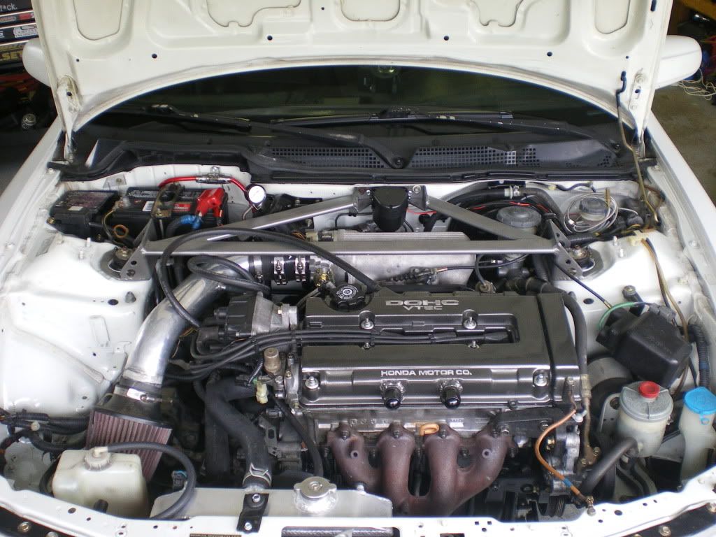

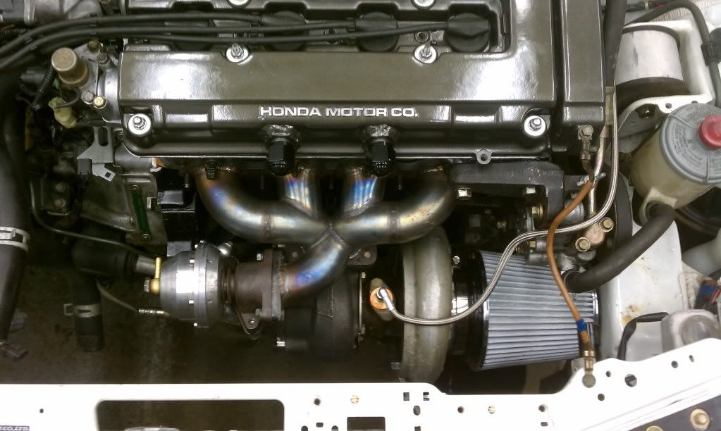

Well nigs, its boosted, kinda....... Need to fix oil return, and feed, best to try and squeeze a air filter in there somehow, paint up charge pipes, fix exhaust leaks, put my pusher radiator fan on, this is a worthless post without pictures, so FUCK YOU!

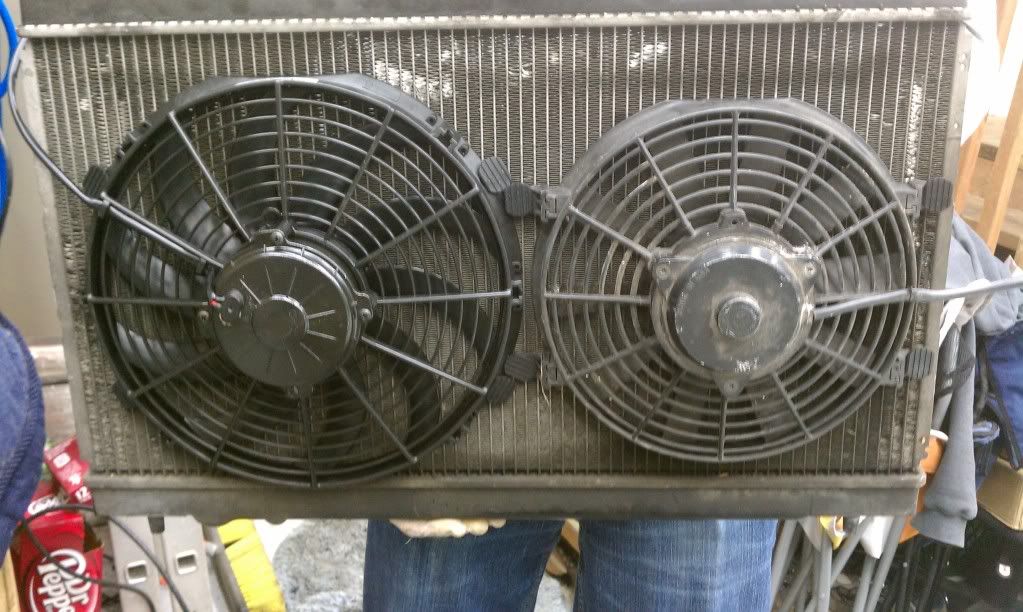

Well I'm gonna be using a pusher fan. Found a new curved blade 13" pusher spal fan for $115 shipped. Says I need to use a 40amp relay, and it moves something like 1700cfm. Sounds like it should do the job.

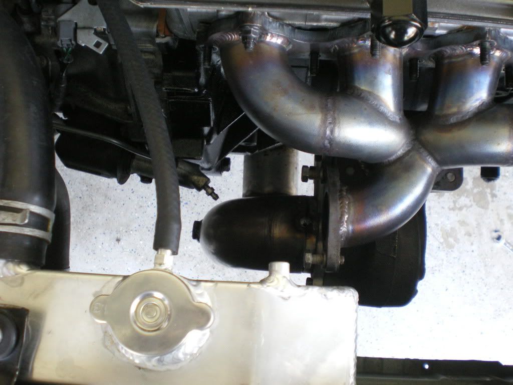

Well, got in my new spal 12" pusher fan. Unfortunately it won't fit on my half core and still fit in my car. The new motor that is on this thing is massive. So I checked to see if my stock full sized radiator will fit. It does but just barely. The compressor housing is about 1/8" away. So I moved my radiator mount back over to where it probably was. Also had to trim my power steering lines so I could get a filter on my turbo. Otherwise I would have to get a short body filter, and I wasn't about to spend more money on it.
So Sunday I'm putting the rad in and I have to wire up my fans with relays and fuses. So I'm running a 12and a 10" pusher fan on a full sized radiator. So I don't think I should have any cooling problems at all.

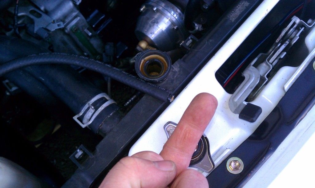

Got the fans rocking, put the overflow line on and the fucker broke off. So look like tomorrow I'm going to the auto parts store to get a new radiator.
That's shitty... tap it for npt?
Why get a new rad? That port sees ZERO pressure, and maybe the slightest amount of vacuum (when rad cools and sucks in overflow). A bit of JB weld and a softer hose will fix it til you get a better rad. I'd do that and order an ebay special.
