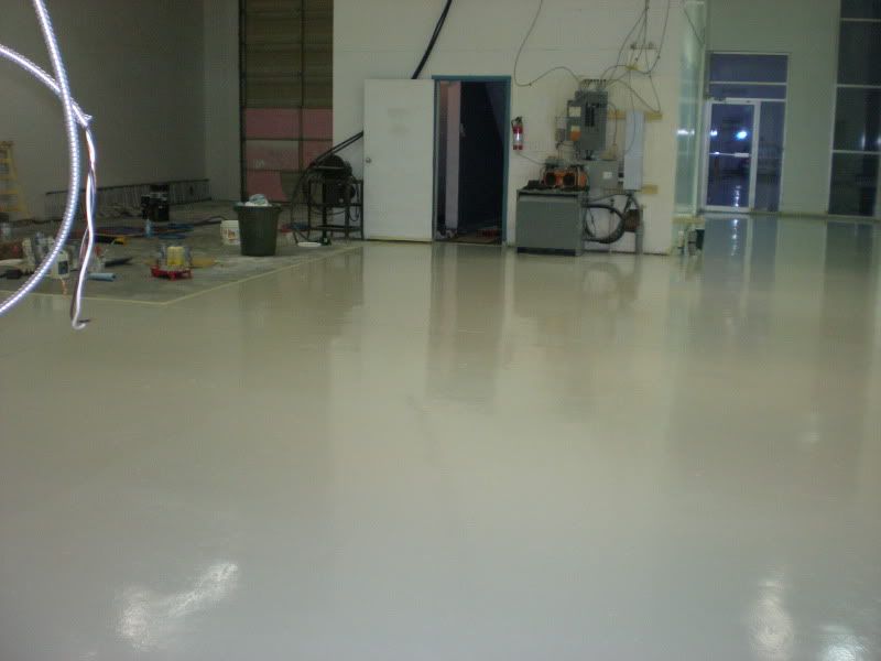

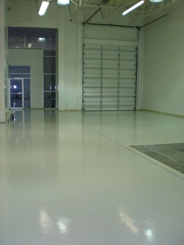

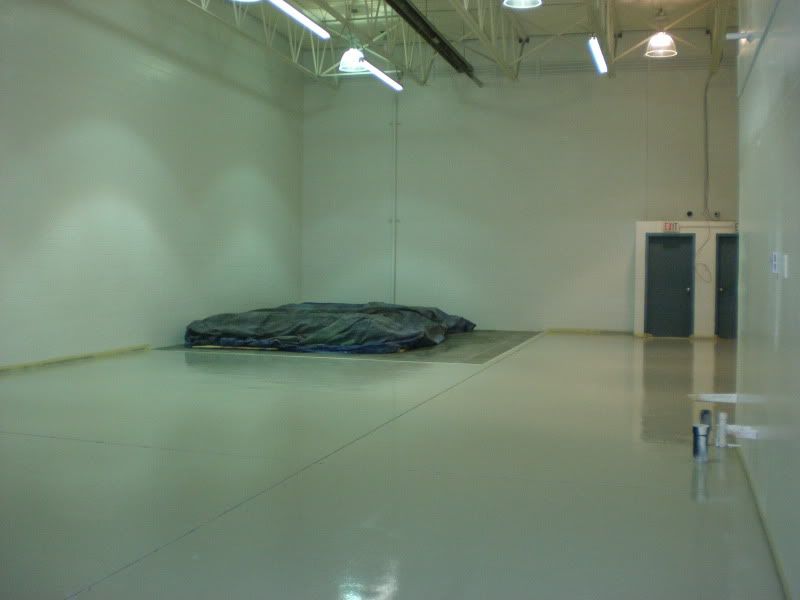

DO NOT put the sand in, that stuff sucks so bad. Catches dirt, makes the floor impossible to clean, nothing slides on the surface... Avoid it like the plague if you want you floor to look good next year and beyond.
I've done a couple epoxy jobs. I'd do stain for my next building for sure, epoxy kind of sucks but its half the price (or less) of stain.
If you have any oil on the floor you need to get an emulsifier on it and soak it all out. Once your floor is clean of contaminants use the acid to prep the surface. Two times is probably sufficient. Then rinse it 2-3 times. Crank the heat to 90*, get some fans and let it dry for a couple days minimum before applying. You can check to see if the you have moisture in the concrete by keeping the heat jacked, and putting a plastic sheet on the floor and taping it to the floor. If you get condensation in there the floor isn't actually dry or ready.
Here are a couple pics from my shop before I moved in:
This is like painting a car, the prep work determines the quality of job.

« Reply #219 on: May 22, 2013, 08:26:05 PM »
We rented that concrete sander for the office to knock down all the high spots. We could do that over there as well I guess. So sand the floors instead of acid or sand them then acid? And no on the sprinkled sand crap .. ?
I looked at stains as well, but our floors are in shit condition and it wont hide anything.

« Reply #220 on: May 23, 2013, 09:53:04 AM »
i get the non skid idea behind the sand, but you will end up sanding the floor and doing it again cause you will hate it.
