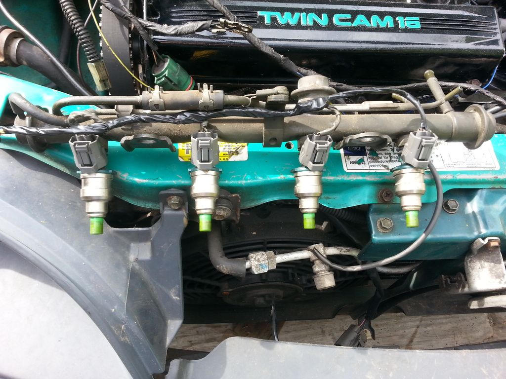

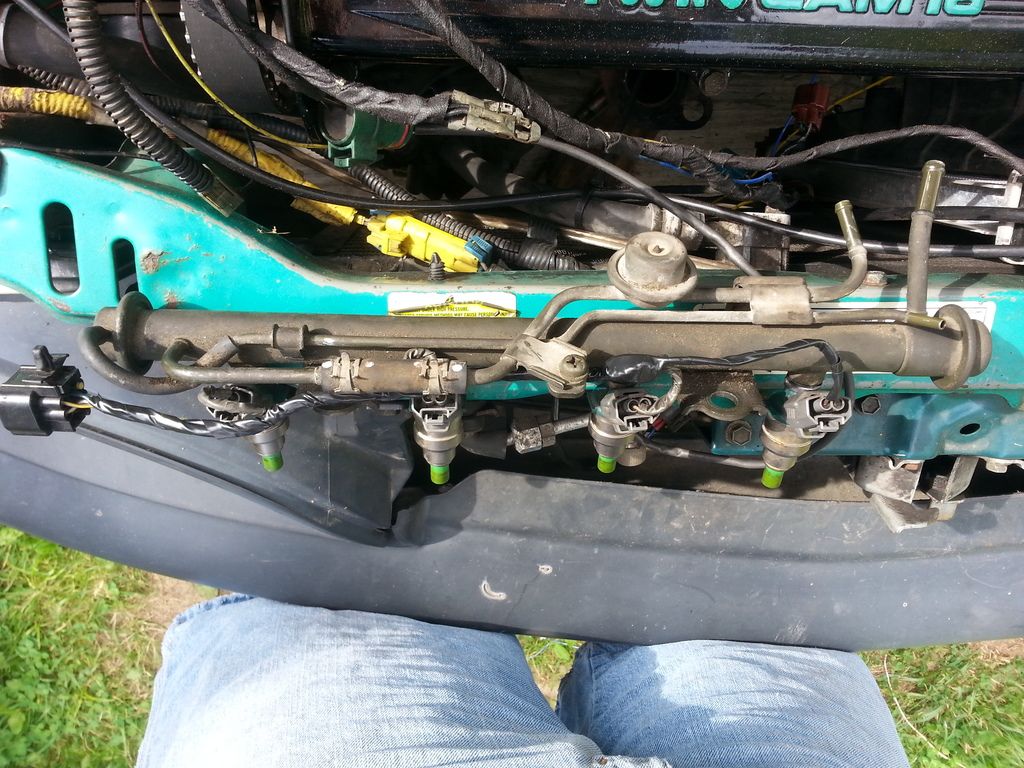

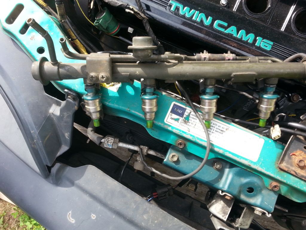

so fuck the 3 cyl, I opted for a 4 cyl out of a suzuki swift gti.  threw away the maf related shit, and have it running on a microsquirt for fuel and spark.  this is the way It should have went the first time.
fyi, I'm just gonna do a generic copy and paste over here from my build thread.
so I am swapping a g13b from an 89 gti into my 95
fully rebuilt, arp rod bolts, arp head studs, .5mm overbore flat top pistons.  bd10 profile cams
g16 oil pump
after 2 months of working on it in my spare time, a friend came over and the motor is finally in!
have made a little more progress on the car, microsquirt can only drive one low impedence injector, or 4 high impedence injectors per channel.  stock gti injectors are low impedence, so I would have to run resistors, or swap to high impedence injectors.  I opted for the latter, selecting a set from a 97 suzuki esteem.  I used the harness from a 2000 esteem, modifying the injector clips so that it would have a single disconnect to ease in possible future troubleshooting.  the injector pintle caps I wasn't a fan of, so I removed the pintle caps from the stock gti injectors, and used them with the new injectors.
anyway, on with the pics

I'd have gone with newer plastic Denso's such as those from a Miata or EV14's from a Nissan, but those will work okay too.
I take it you plan to boost this bitch too?
jeremy_nash
  • Posts: 129
Re: 1995 geo metro build log NSFW
« Reply #57 on: July 11, 2015, 05:03:17 PM »
the esteem injectors fit in my pocket though, I didn't see any other injectors at pull-a-part that looked like they would've worked.  they are from a g16, so same engine series, so I knew they would work.  I do have some td03's off a turbo volvo that was a twin turbo.  I am afraid they may be to small for my 1.3 liter. I am pretty sure it will "run out of air" before 8000rpm  I can't find any maps for the turbo, anybody have any experience with them?  they are td03's from a 2000ish twin turbo 2.8 inline 6 volvo s80
