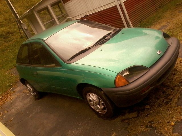

1995 geo metro
busted ass 1 liter 3 cyl motor

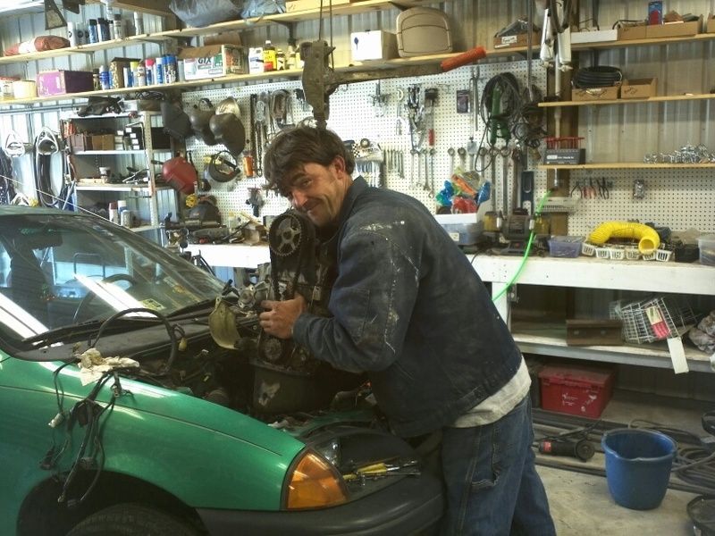

Me and a friend pulling the old motor
me
friend

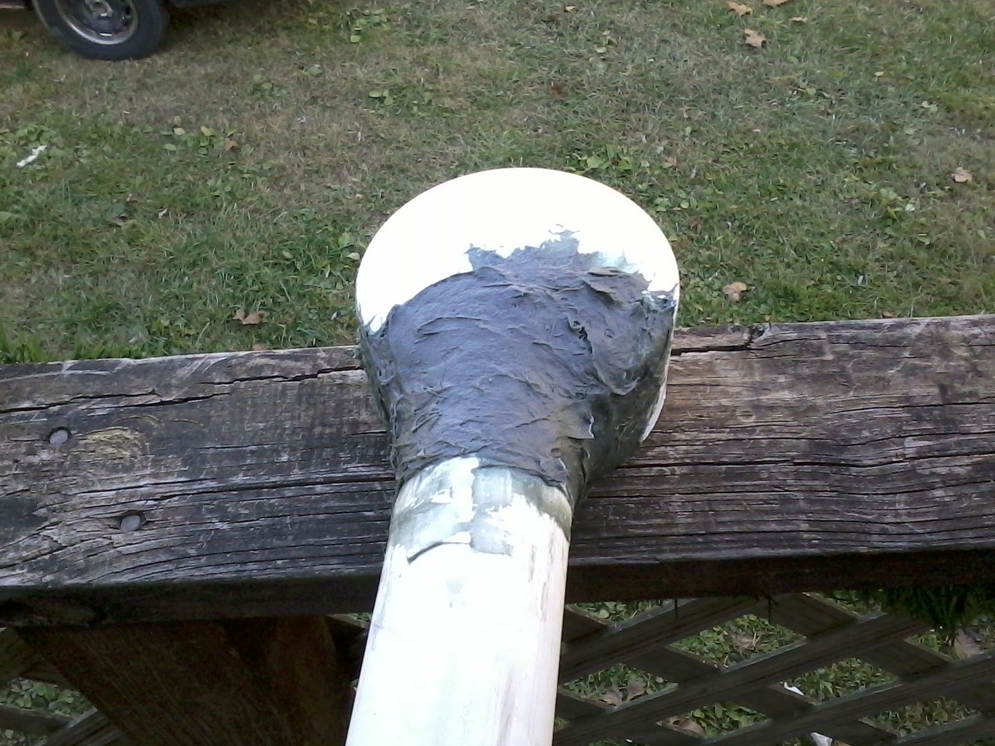

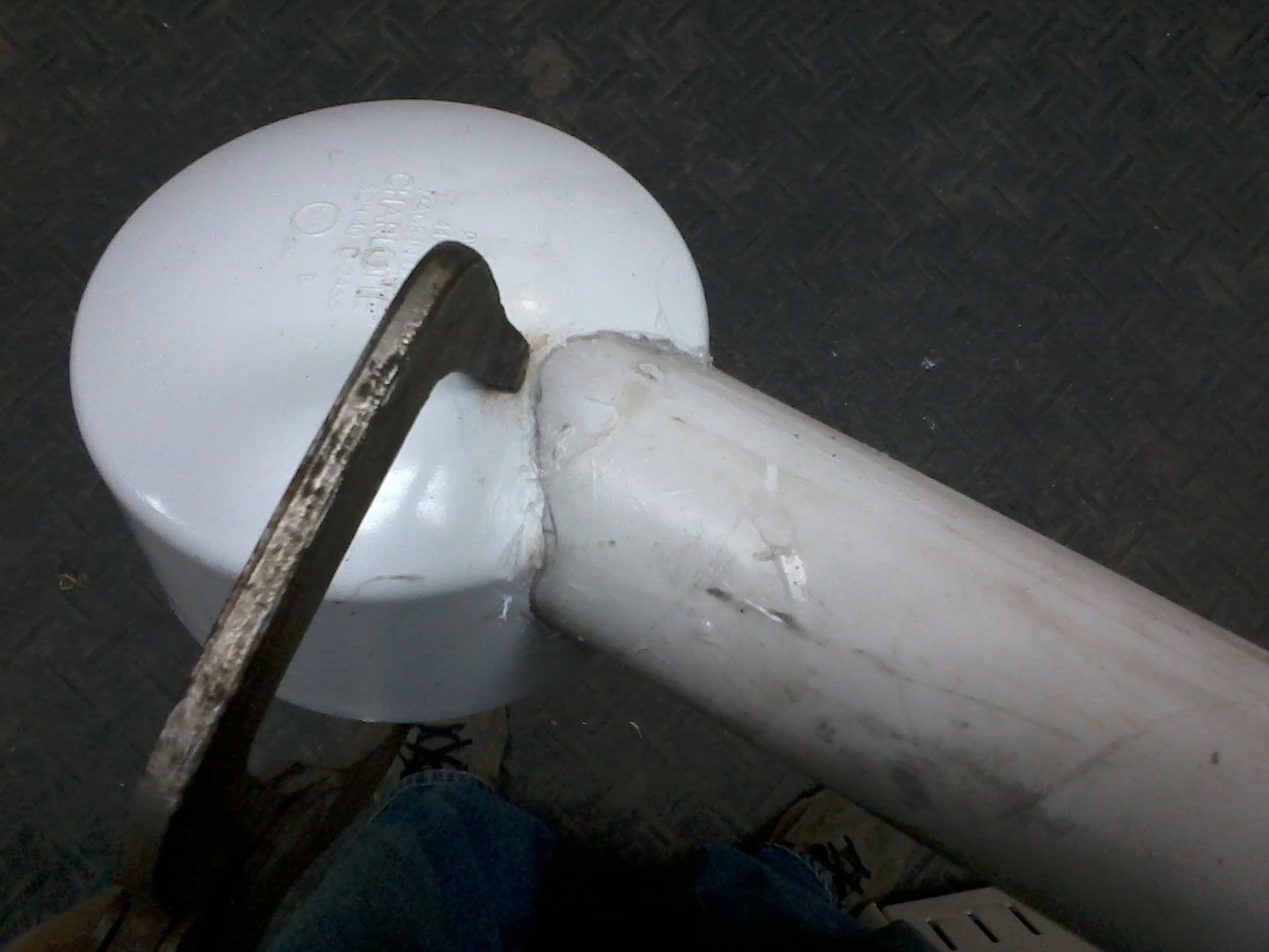

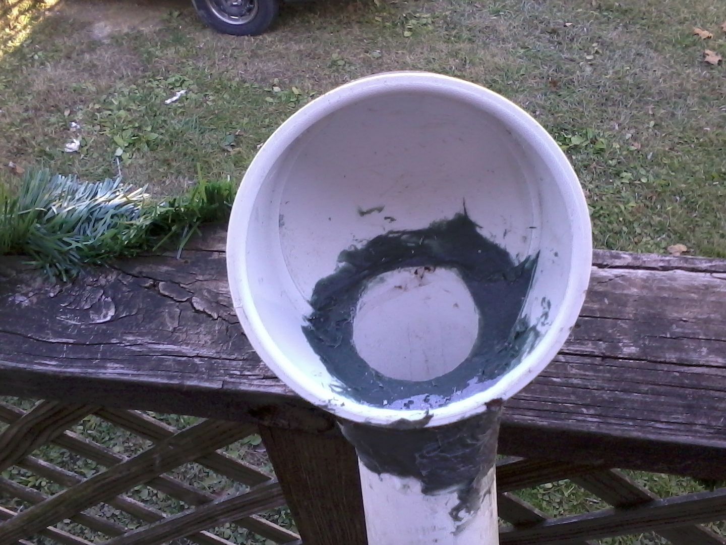

TBI hat  4"pvc cap with 2.5"od inlet pvc glued, then fiberglassed for strength

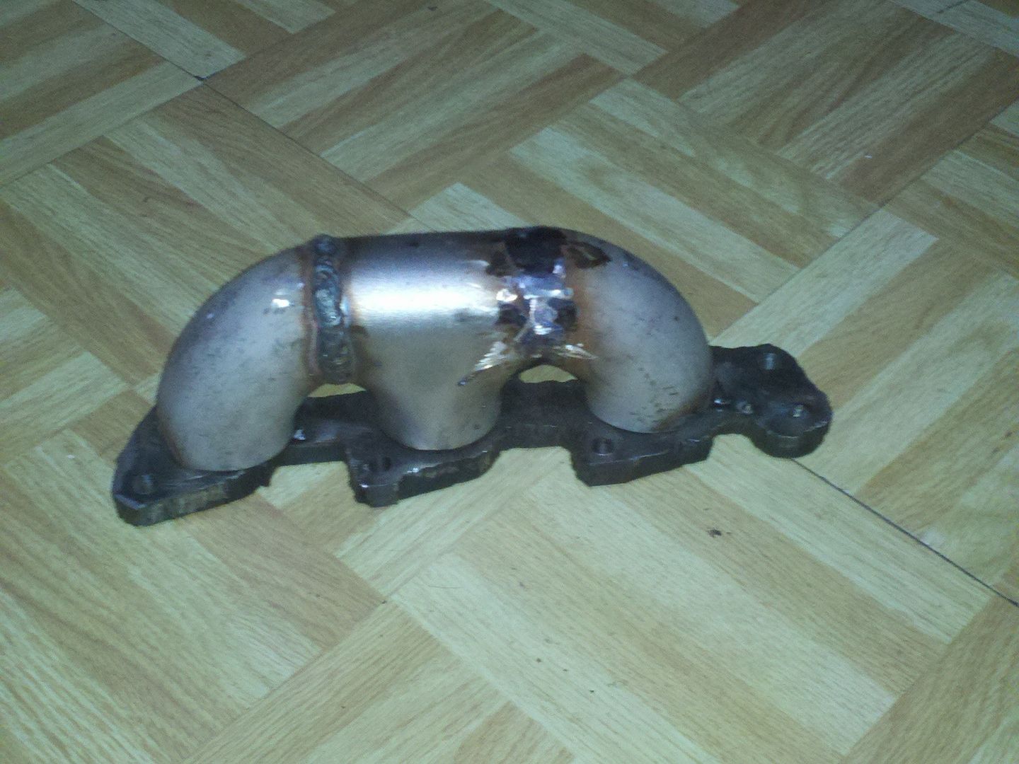

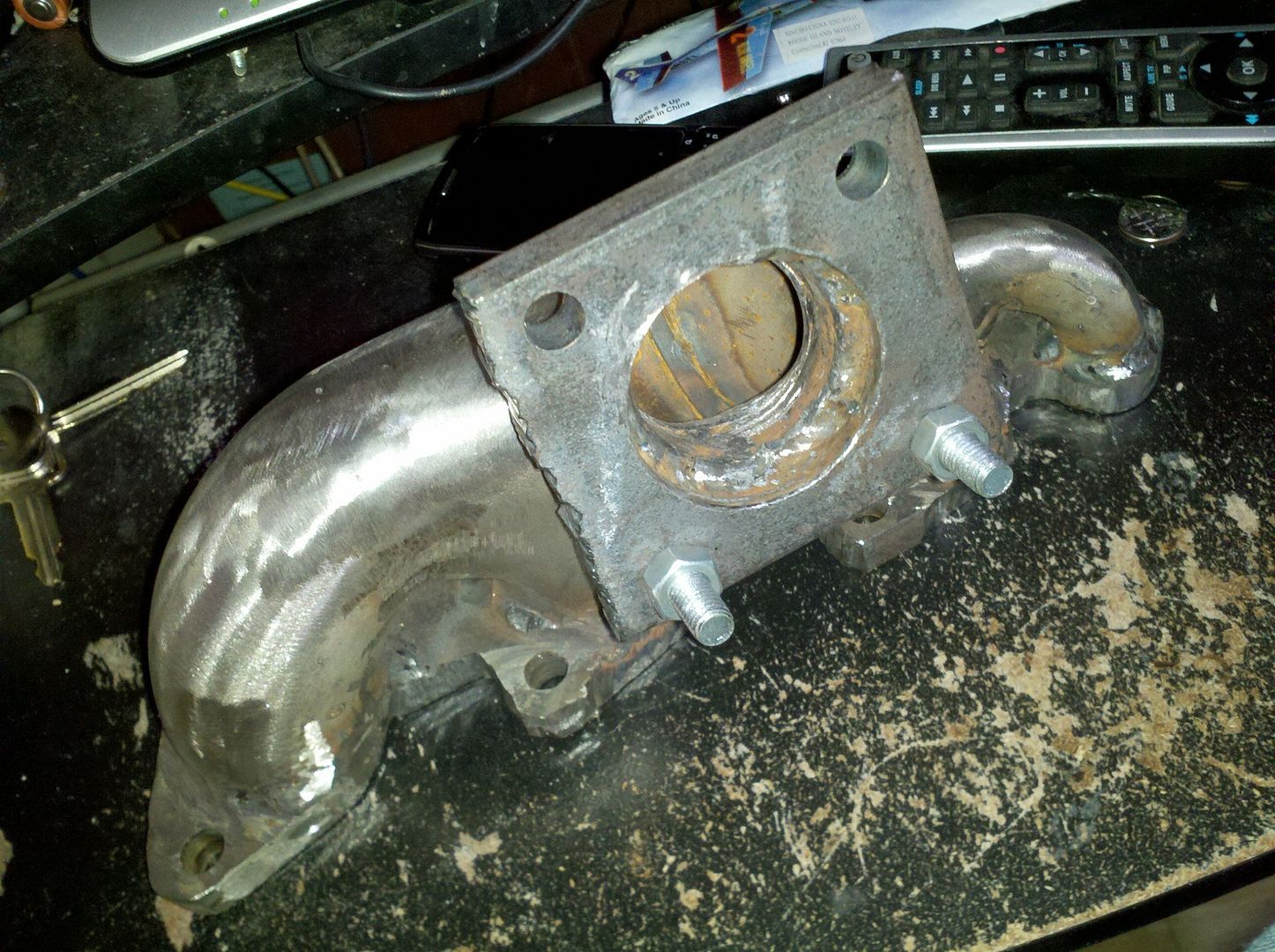

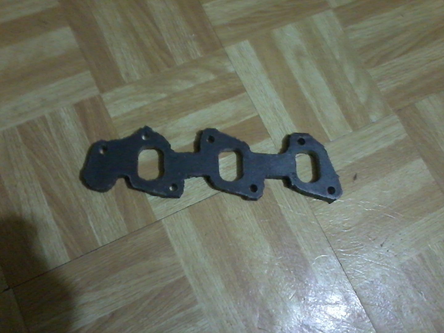

got the head flange cut out finally.  rough cut with oxy/acetylene, then hit the ports with manual milling machine at work.

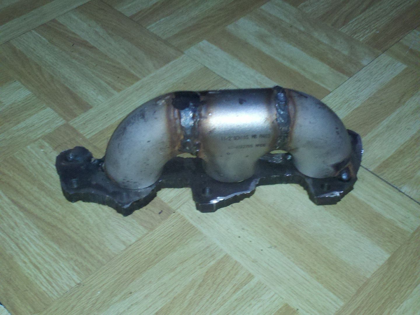

ready to bolt on!

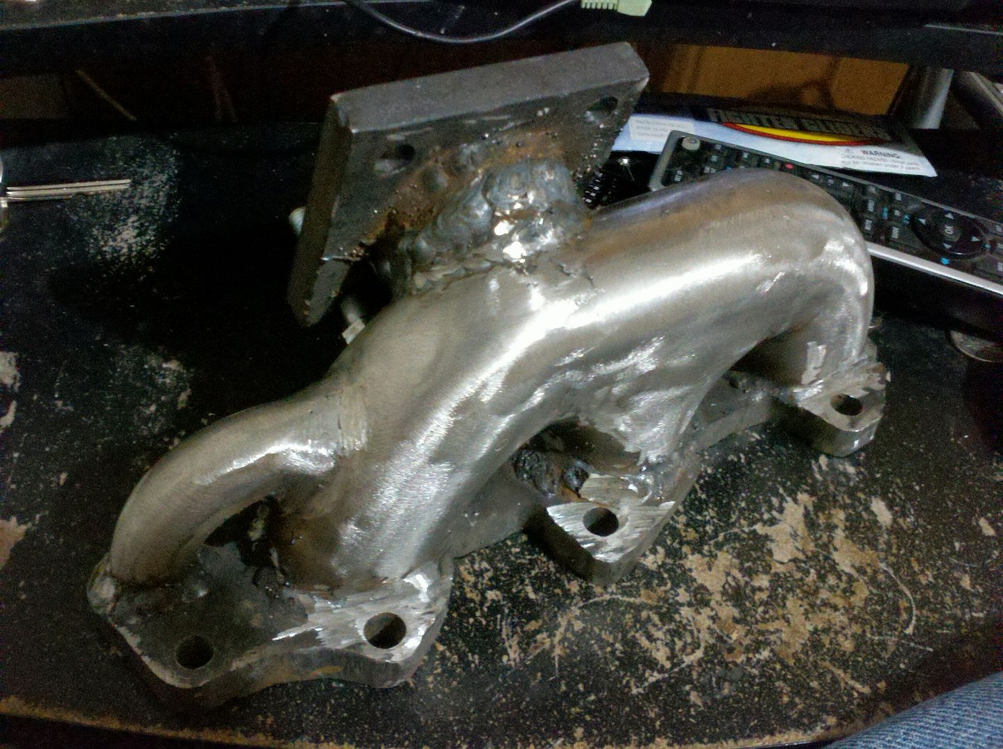

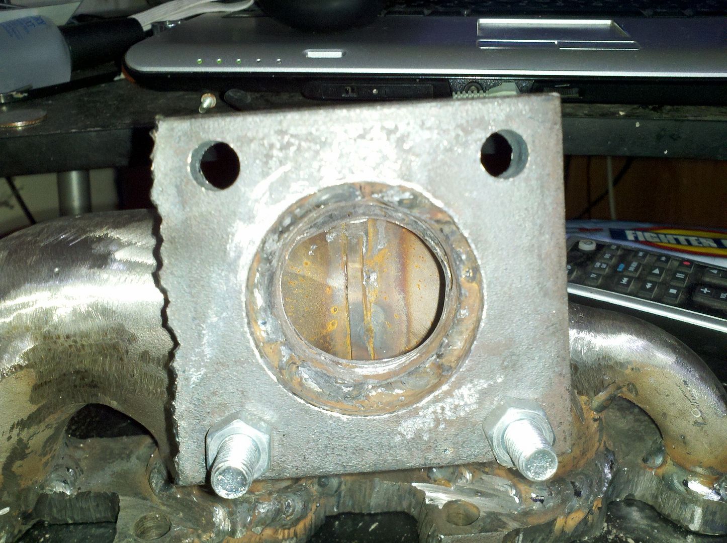

« Reply #20 on: January 15, 2012, 11:47:39 PM »

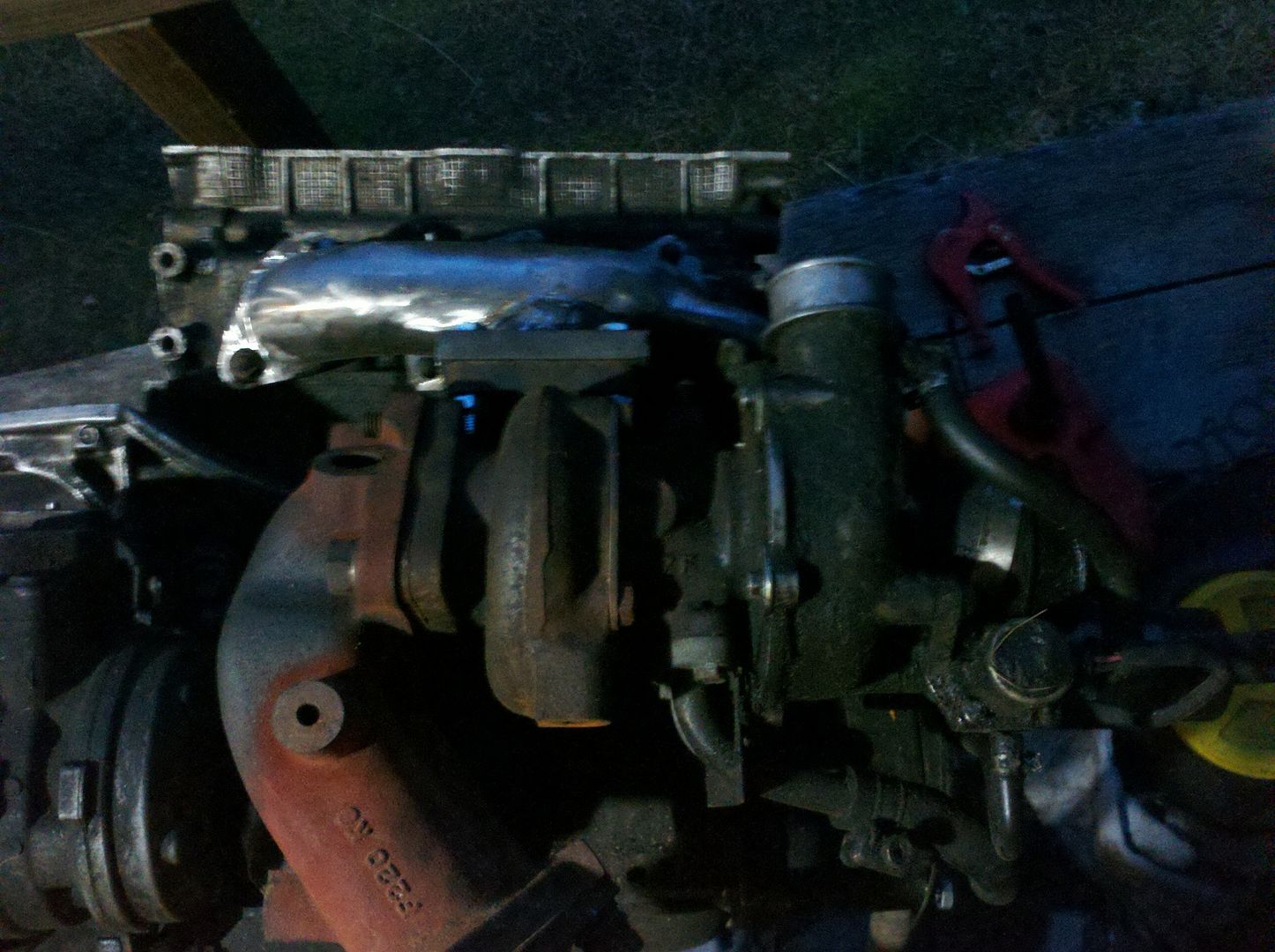

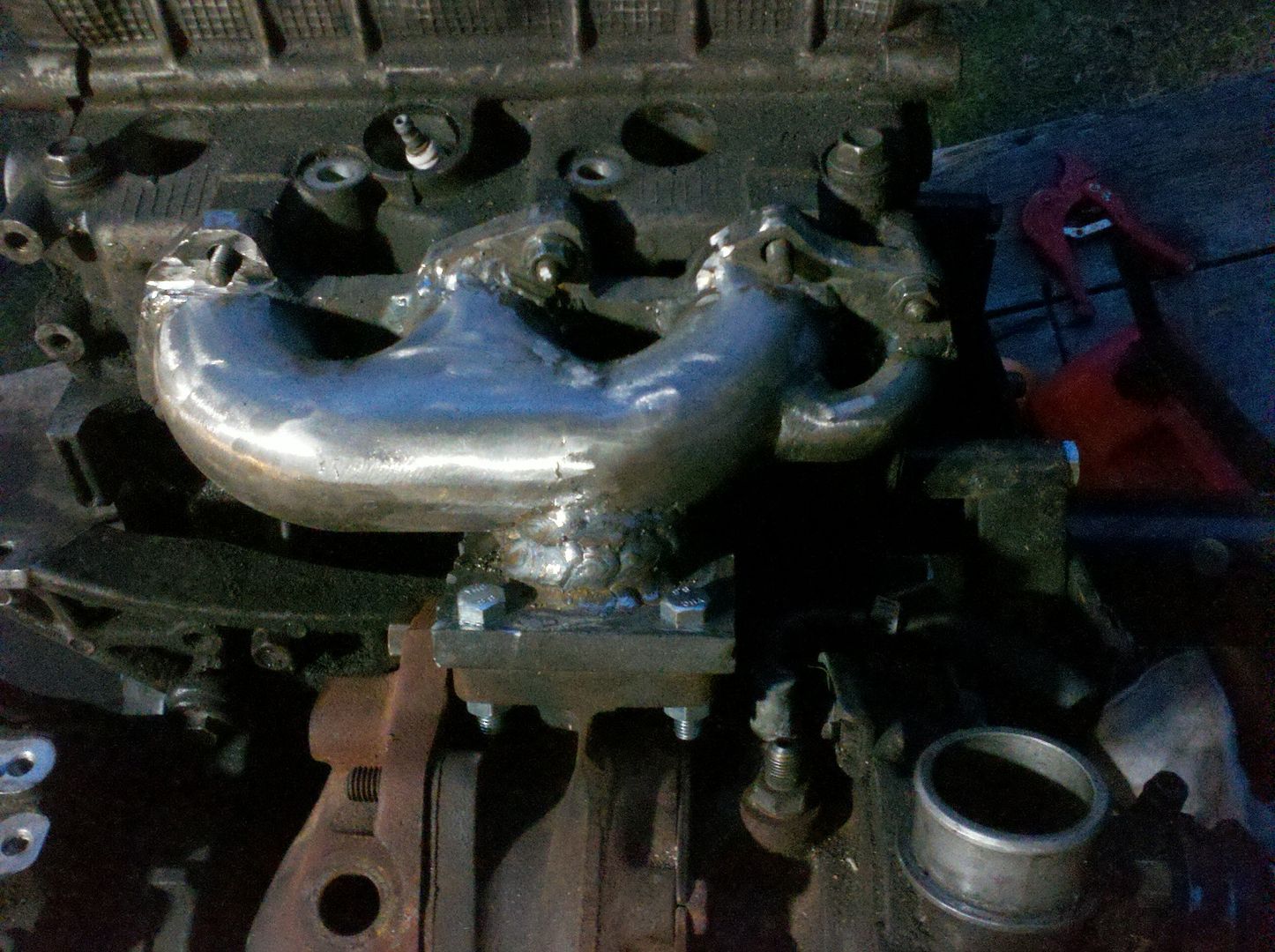

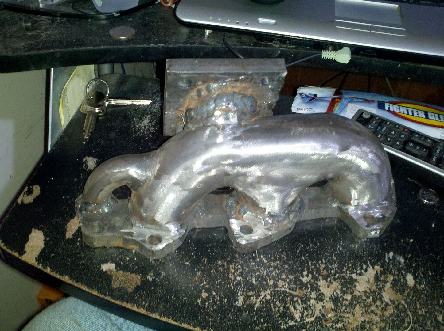

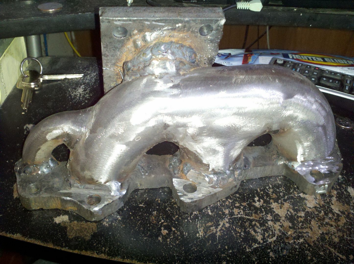

Manifold is finished.  now to iron out a few other things, pick up some oil feed and drain tubing, and I should be set and ready to start bolting stuff on!  it will all have to be done over the course of a weekend, as the car is my daily driver.  if all else fails, I have an suv to drive, it's just a thirsty machine!
Thinking about doing a heat shield to cover the manifold and turbo all up, and keep temps down.
« Last Edit: January 16, 2012, 07:33:03 PM by jeremy_nash »

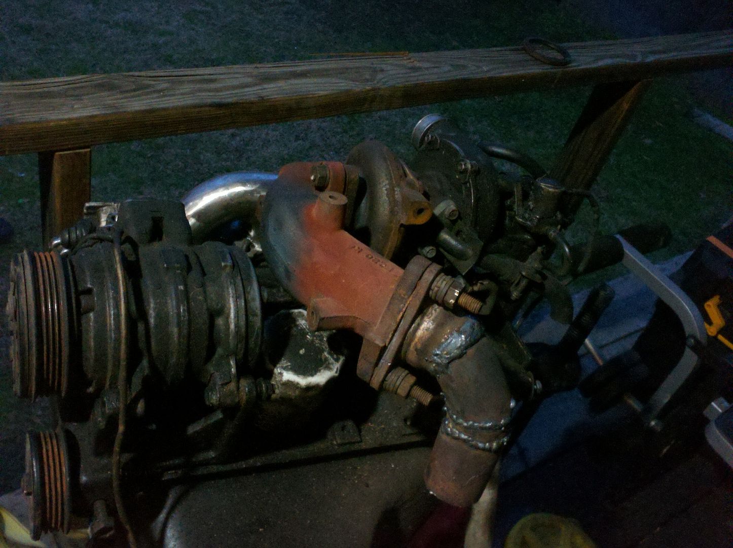

« Reply #21 on: January 16, 2012, 07:29:47 PM »

never plan on changing the oil?  :P
jeremy_nash
  • Posts: 129
Re: 1995 geo metro build log NSFW
« Reply #25 on: January 22, 2012, 12:00:15 AM »
I know some dumbasses that change the filter and not the oil.  I'm going the other way, change the oil and not the filter.
oil filter off a 90's Toyota corolla will fit it and is 1/2 inch shorter than stock filter.  with stock filter it's got 3/4 inch clearance to downpipe
« Last Edit: January 23, 2012, 08:37:31 AM by jeremy_nash »

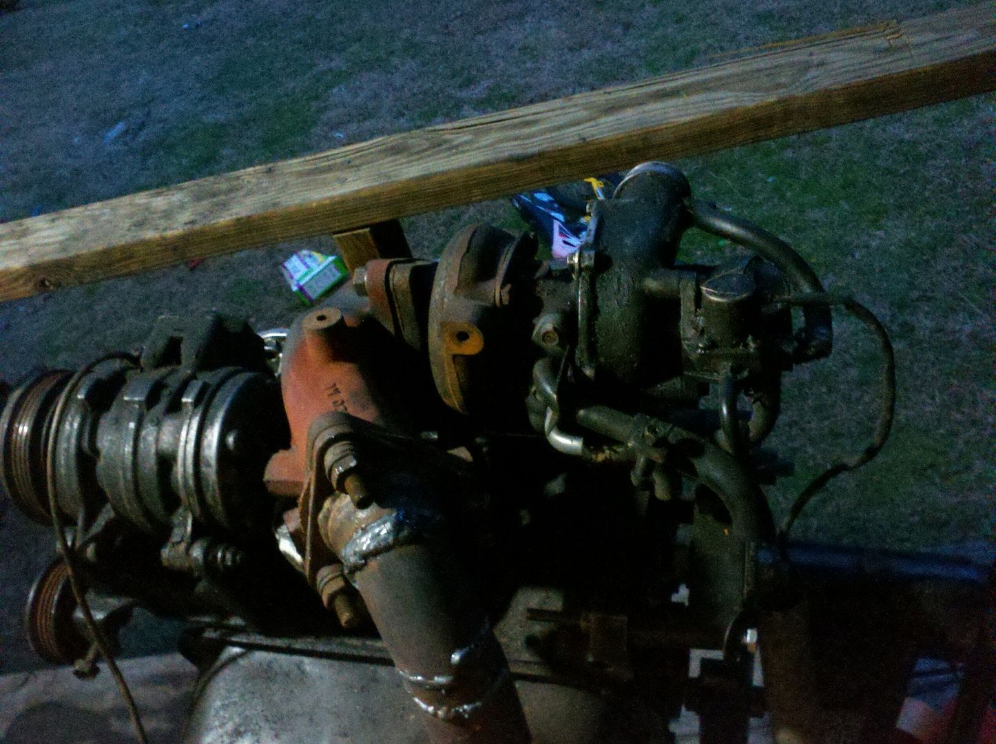

started bolting shit on, nothing fit, ac condensor in the way, moved it in front of the core support. then the regular radiator was in the way, said fuck it and took manifold back off.  bought an outlet flange from weir, but it's just serving duty as a paperweight on my desk. :-X
