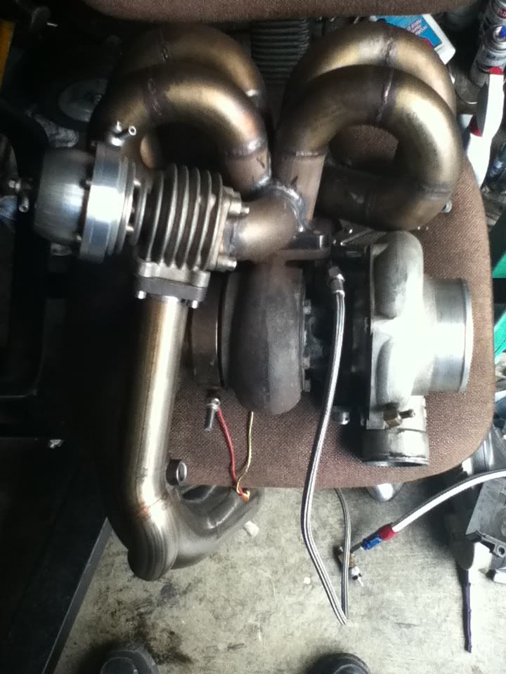

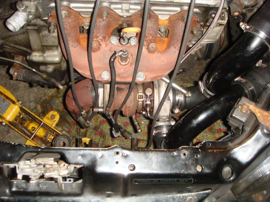

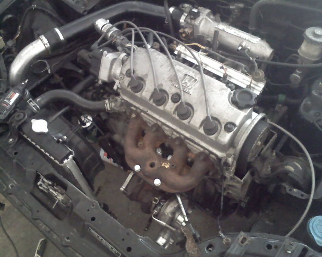

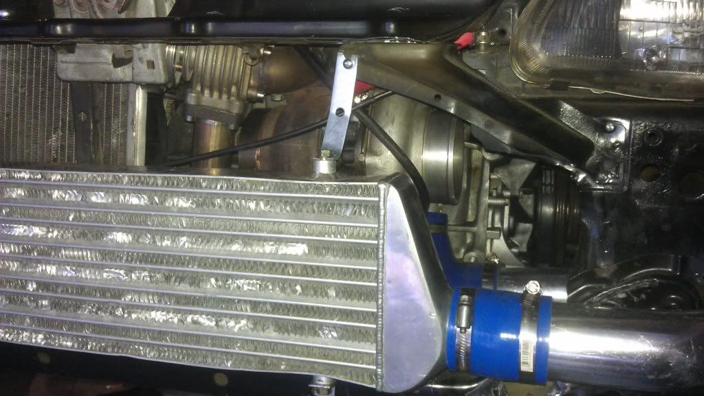

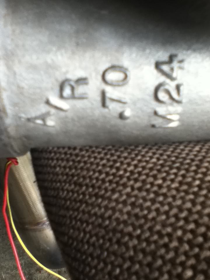

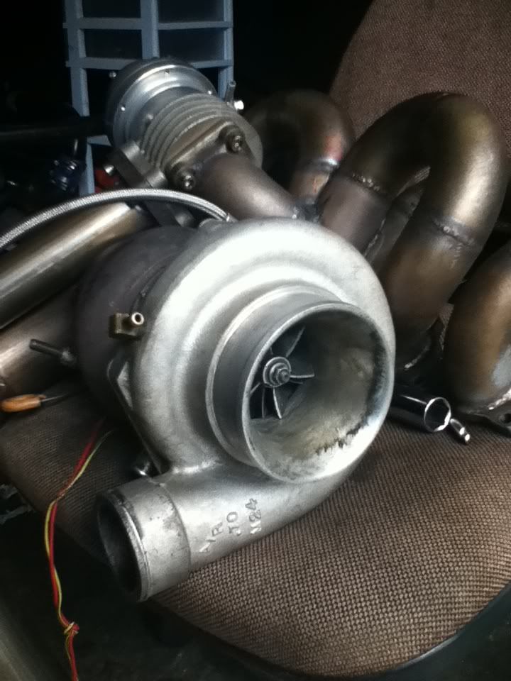

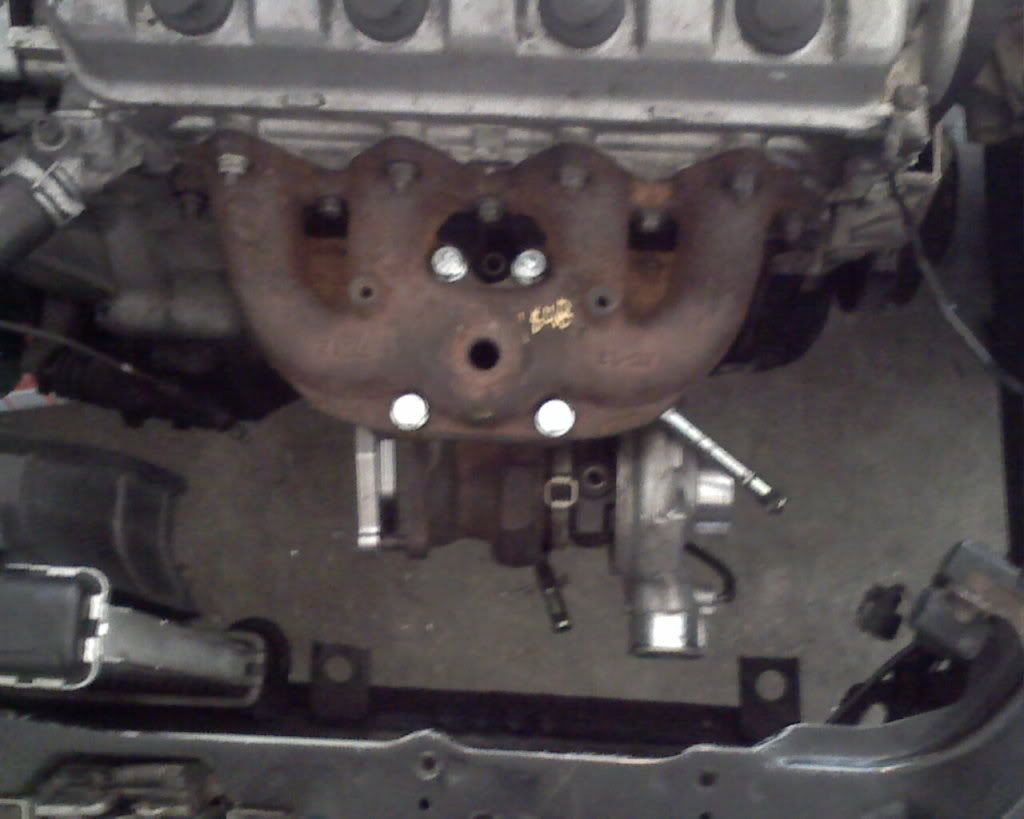

As some of you may remember, i posted this build a few months ago before rhmt lost some data. Thought i might share it agian from beginning to start. I started off with a single cam vtec. d16z6 i got for a good deal. Always always wanted to do a hmt setup and then years later i find RHMT so i thought fuck it im gonna slap some shit together and see what happens. enjoy.
OH AND YES I DID MAKE A NEW INTRO THREAD.  8)
I WANTED TO BE BOOSTED ON THE CHEAP CHEAP.
PIECED TOGETHER THE KIT FOR LESS THAN 3OO.OO
D16z6 w/ 80xxxx miles
B16 throttle body
HF manifold
BMR turbo adapter plate

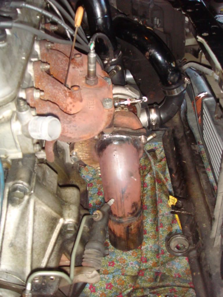

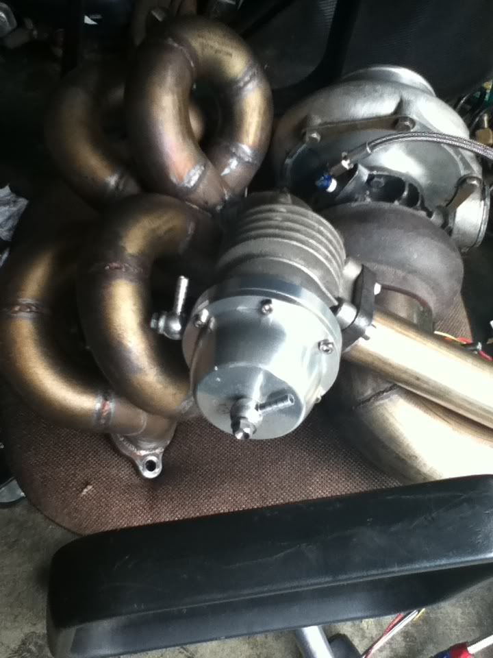

little dinker TD04L wrx turbo
egay ching chong intercooler

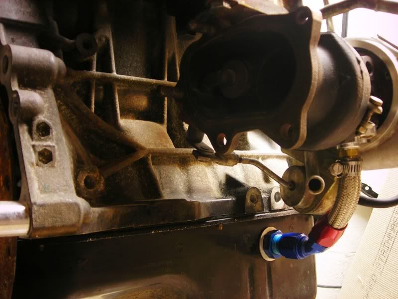

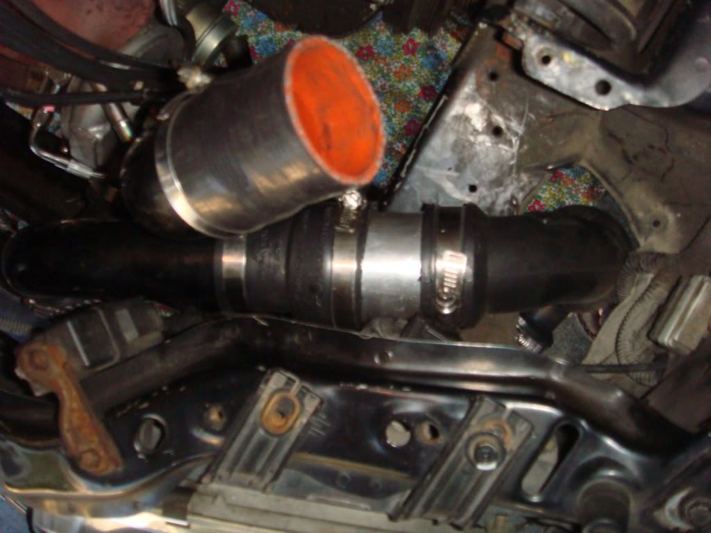

egay oil line
craigslist auto meter boost gauge
misubishi DSM 450cc injectors w/ resistor box

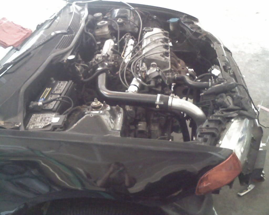

HSK SSQV bov

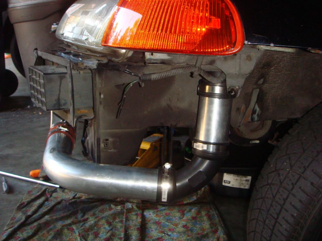

home made turbo piping

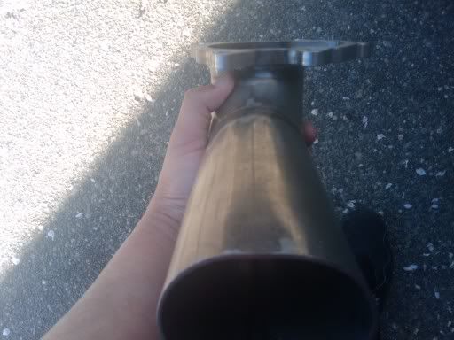

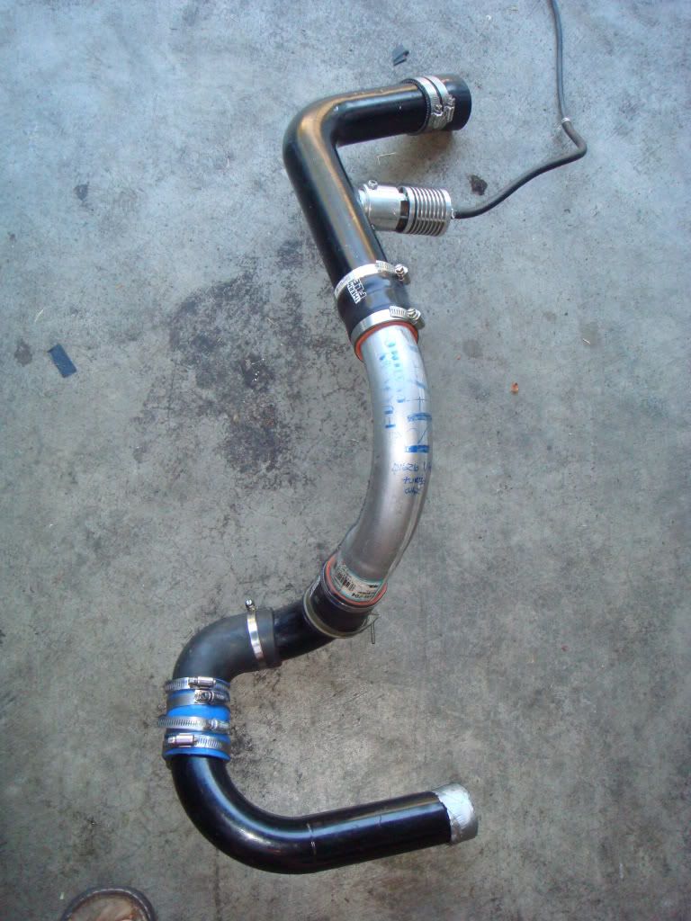

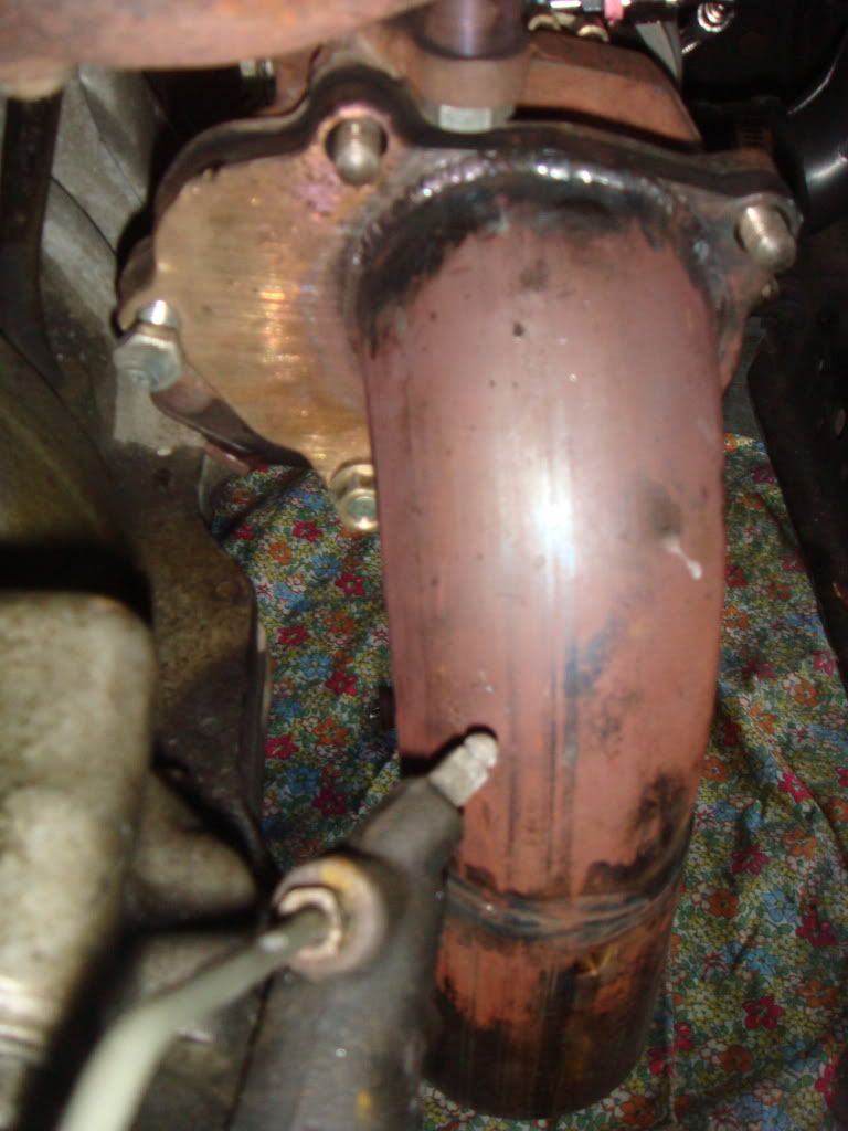

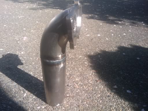

2in charge pipe

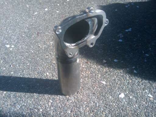

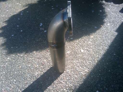

3in downpipe
chipped & socketed p28 ecu

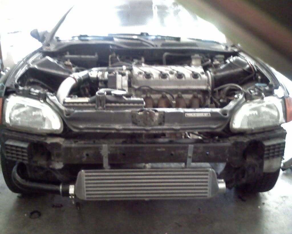

intec racing basemap
my 1993 eg si
my small ass turbo tdo4l off of a wrx
lowes rubber fittings lol
My pos charge pipe
down pipe pictures
weak ass videos. really short clips..
http://youtu.be/ylJ3RSmOV04
http://youtu.be/StpxVt6NTYA

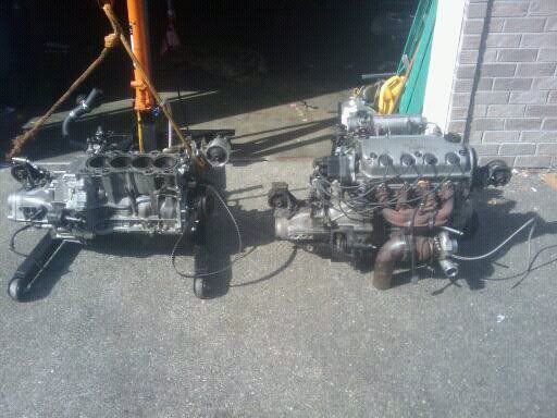

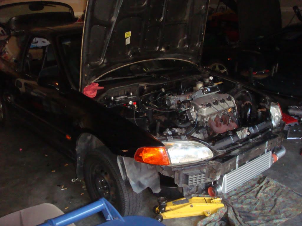

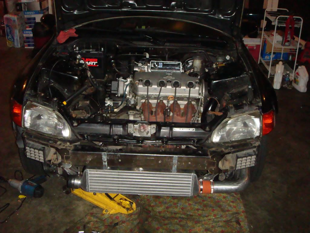

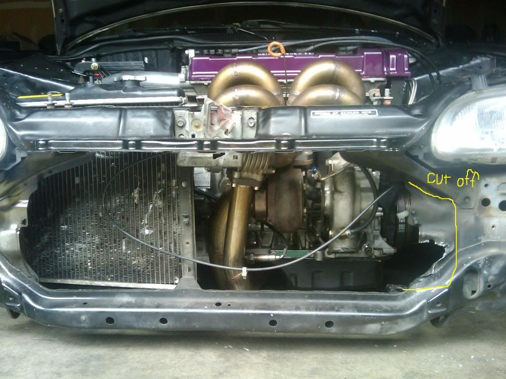

About 6 months after i sold the single v turbo i took my stock b20z out of integra and stuck it in the hatch. B20 block, GSR tranny. Needed a head so i asked around and finally found one. Pretty much after that, i bought crower 403's, dual valve springs and tit. retainers, skank2 cam gears, thermo intake manifold gasket, blox intake manifold,67mm STR tb,1000cc precision injectors, HKS bov and other random shit. just picked up an intercooler and piping the other day. mocked everything up and now its pretty much ready to go.

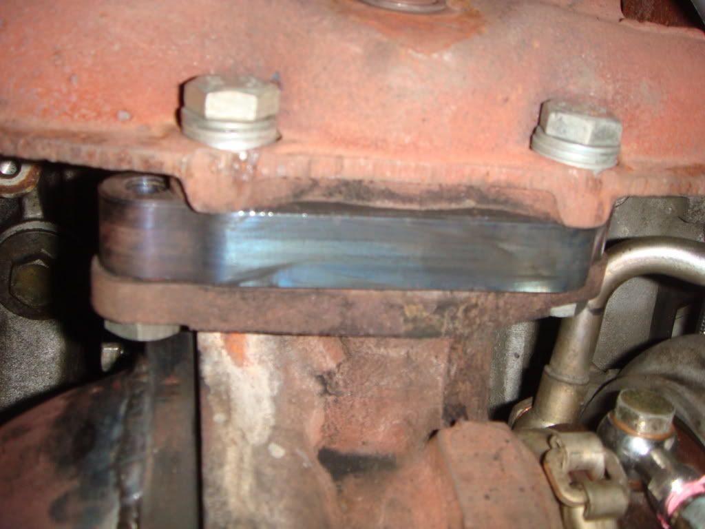

Thermo gasket
Didn’t fit
hard to see the extended studs but its there.

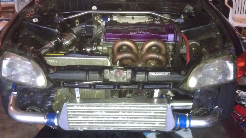

Old setup vs new
 :noel: " i support single moms "
exhaust
intake
pretty much done with the new setup. i have new pictures as soon as it stops snowing. still need a fuel pump, catch can,tap my oil pan and little other misc shittt. let me know what you guys think....

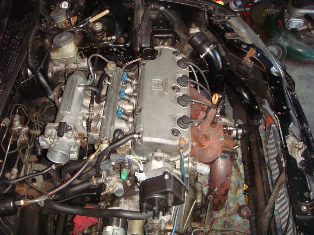

My goal is 350whp built head stock block. I just hope i dont have too much lag?... kinda scared of my stock b20 rod bolts snapping but that was my mistake to not have the block beef up before i through it together. I should have gotten a smaller turbo but watever. fuck it. lol  :noel:
Im havin mixed emotions on the walbro 255. alot of people are saying ill be fine and others are saying i need to get one.
http://www.hondatuningmagazine.com/features/0206ht_honda_fuel_systems/index.html
^ says i dont need a fuel pump, i know i shouldn't believe everything i read but what do you guys honestly think? Do i really need a fuel pump? even with my 1000s?

so get a walbro 255lph fuel pump and rewire like this?
http://www.raktron.com/fuel/rewire1.html
« Last Edit: January 19, 2012, 07:29:27 PM by 92_eg_c1 »
Re: 92_eg_c1's build thread
« Reply #8 on: January 19, 2012, 07:39:39 PM »
yep, i have used that write up before too...
you can try the stock pump, but its a waste of time. if i remember right JR (EM1 w/H22) made 250whp and maxed out a DOHC pump. should get more from it if you rewire it (did that to the del sol), basically overclocks it giving it a full 14v...
DasPoop
  • Posts: 1761
« Reply #9 on: January 19, 2012, 08:22:20 PM »
only thing i would change about that write up is leave the relay inside the car. As far as the pump its hit or miss. some pumps will flow enough for 300hp some shit out early. what sort of fuel pressure are you going to run?

you guys see my ghetto red oil feed line? LLOLL

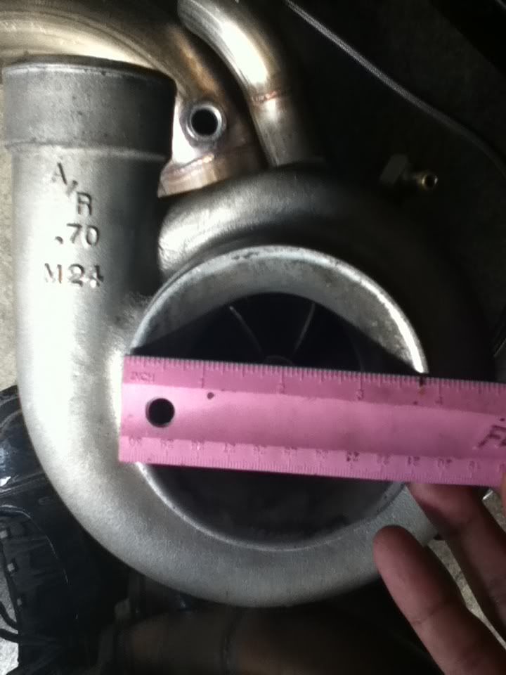

I feel like this is a really stupid question to ask but whatever... I already know my turbo is to big for my setup but is there any way possible to make my turbo spool a little sooner?
« Reply #27 on: January 30, 2012, 05:22:42 AM »
nos
« Reply #28 on: January 30, 2012, 08:05:04 AM »
Nos
Two step
Brake boosting
Have a huge compressor blow into a medium size compressor  :noel:

What about with tuning? Is there anything my tuner can do?
