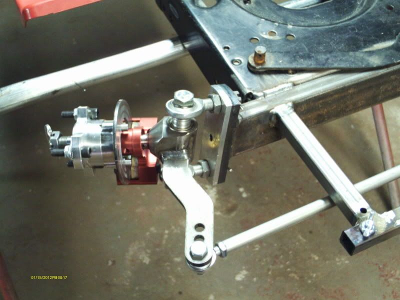

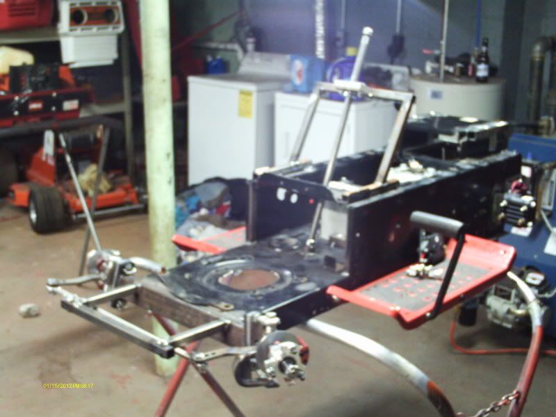

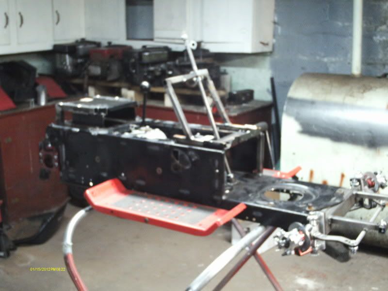

new b/p build. 97 mtd chassis  too much bs to list.   just know ive got a vanguard that will make 50hp on gas going in it.   front and rear brakes the whole shebang.

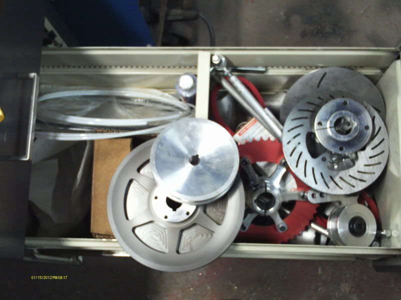

i dig those little disks
Re: fakdblamtd
« Reply #9 on: January 19, 2012, 08:45:55 PM »
hotrex
  • Posts: 13021
Re: fakdblamtd
« Reply #10 on: January 19, 2012, 08:52:57 PM »

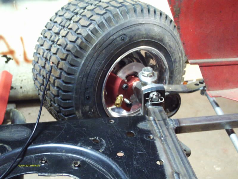

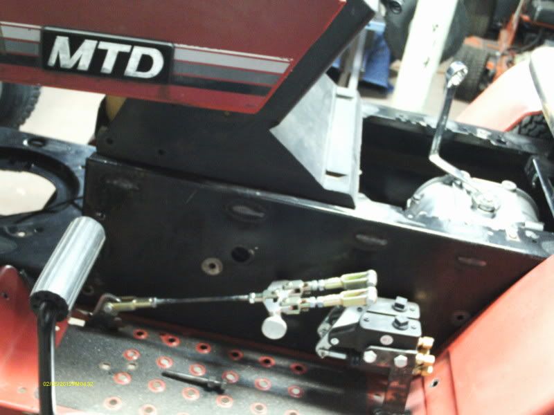

10 inch rear rotor with 2 piston caliper.  single piston front calipers with 3.5 inch rotors.  twin mcp 3/4 master cyls with  remote adj brake bias

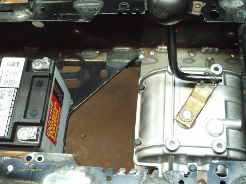

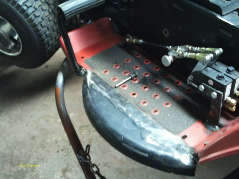

small amount of work today, got the dual master cyls mounted along with brake pedal finished and brake bias added.
hotrex
  • Posts: 13021
Re: fakdblamtd
« Reply #27 on: February 05, 2012, 06:48:27 PM »

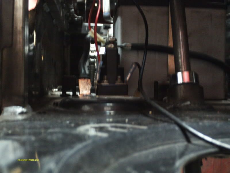

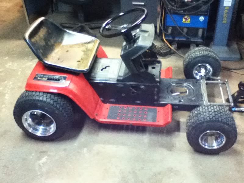

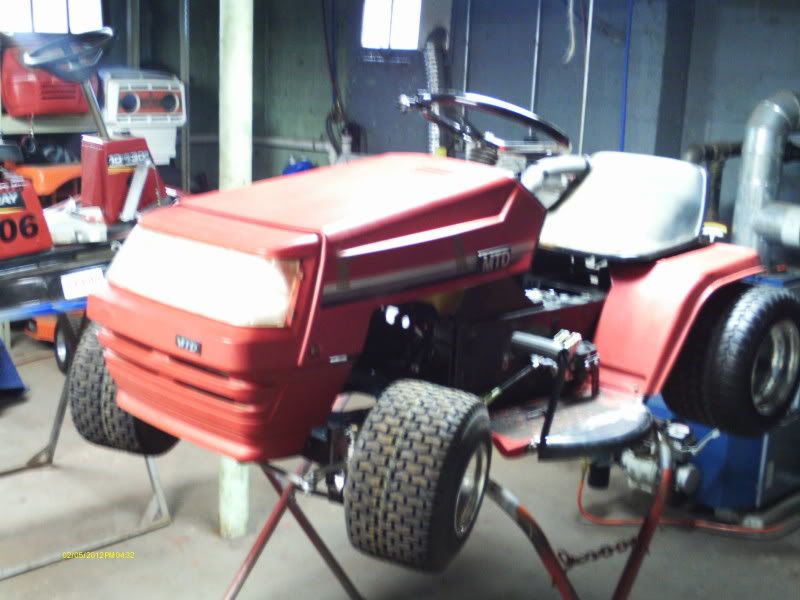

rolling chassis is done and wired.  small odds and ends left.  finish work.   think the rig came out well.  now sitting back and waiting for the magic from ron at Ace race engines to arrive in the mail...  common big hp.   yee haw!
heres the complete roller
brake bias master cyls and shot of my rad shifter

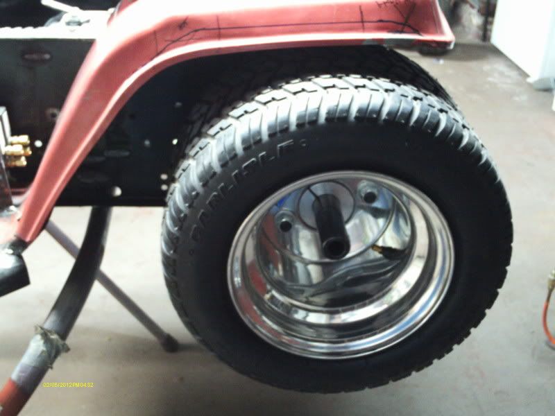

turf pros i just scored off of drew burton.

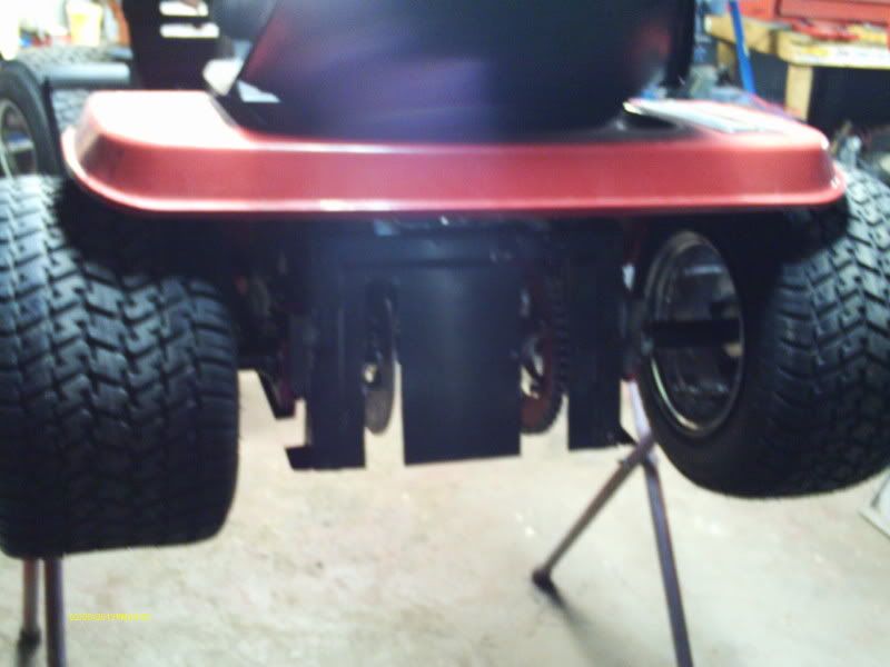

shot of the rear end with turf pros and notice the rear caliper and rotor have been moved inboard to leave room for tire selection ect.

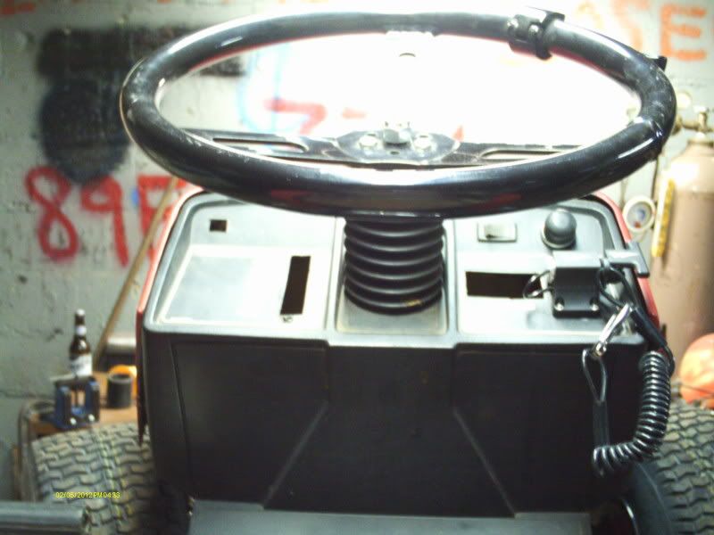

dash minus digatron
ec brakes tucked in the new douglas 7.25s and cheng shin meat
all wired up minus digatron

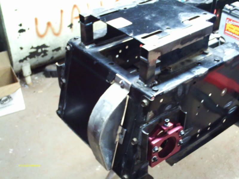

deck halves on...
