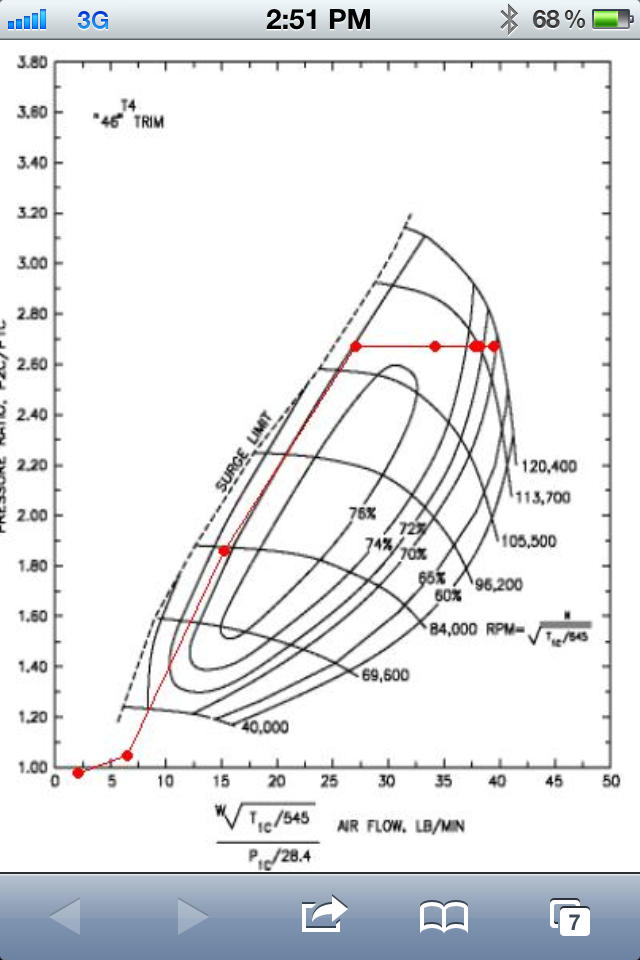

I believe I hit all the estimate numbers correctly and conservatively on the turbo calculator.
400hp map: (I can dream on this 45 trim, but it is theoretically possible)
I am interested on a few opinions.  I have tuned many "B"s, but never built and owned one.

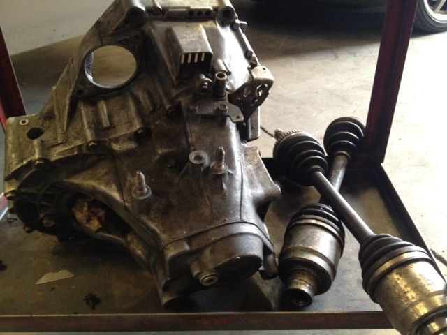

Came home from Santa Rosa today with a gsr trans and axles in trade for $180 in tuning work :)
Re: Turbo GSR buildup
« Reply #7 on: March 26, 2012, 10:56:55 AM »
That's a deal for sure

« Reply #8 on: March 26, 2012, 01:57:20 PM »
Since I've been burned on a crank and 3 heads, he cut me a deal.  I also told him if it was ok I'd bring him some $$$ on top :)

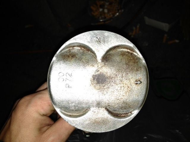

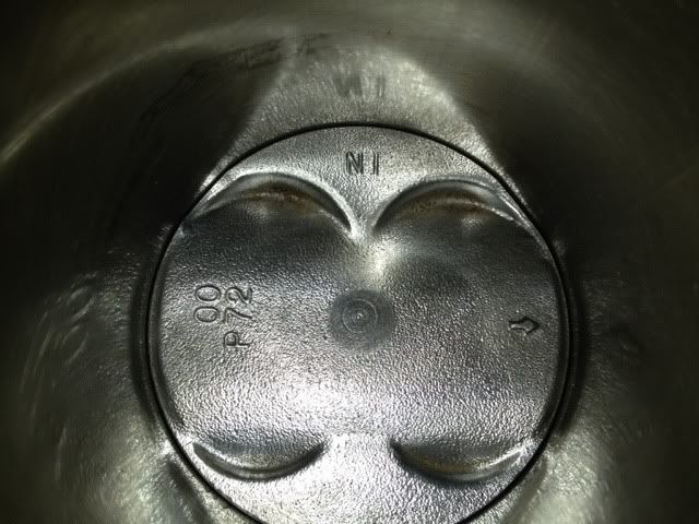

Due to unavailability of the crank; I am switching routes a little:
Ls crank/rods, and the p72-00 pistons that I have on my gsr rods.
A little compression bump;  what I am after on this build anyways.
I am trying to go for higher compression boost anyways, but when I go forged I plan to start at 11:1
I have AvGas at my disposal so anything up to 13:1 won't be a problem at all with the turbo.

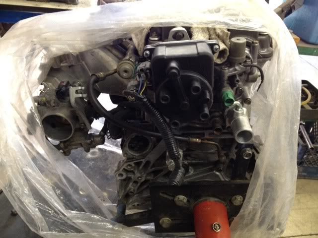

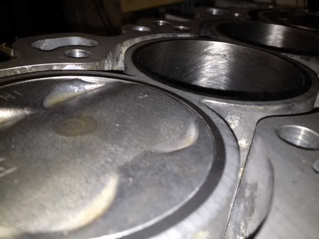

Brought home a '94 B18C1 bottom end that had failing rings.
Ordered DelSol shift linkage from the dealer.
I think the t-bracket, trans upper and front mounts, and power steering upper mount.
Block and head will hit the machine shop tomorrow most likely.

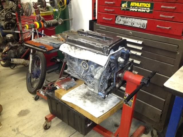

« Reply #11 on: April 19, 2012, 06:06:10 PM »

« Reply #13 on: April 20, 2012, 03:02:56 PM »

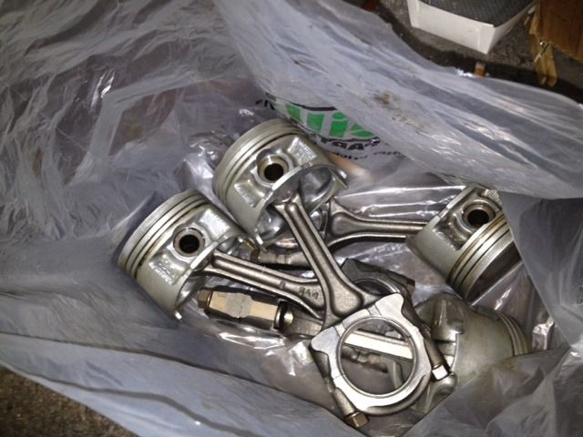

yup;  unless I can get forged rods/pistons on the RHMT cheap status...
I have JDM P72-00 pistons and rods to use if that doesnt happen....
but I would be happy for boosting a higher compression 180Hp B18C =)

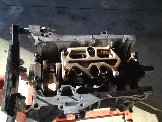

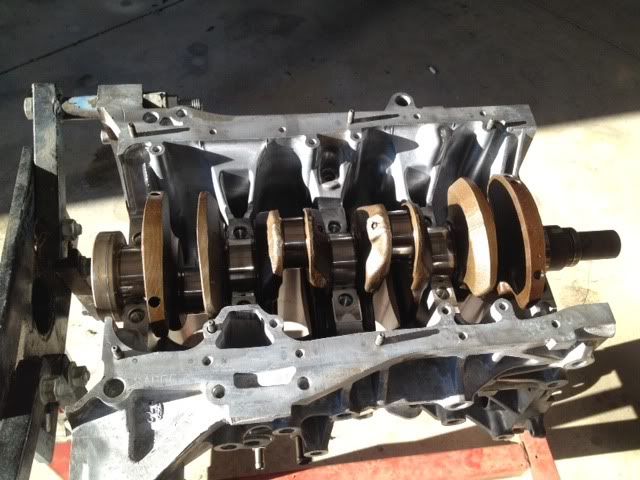

Work started.
B18c1 crank install - YouTube

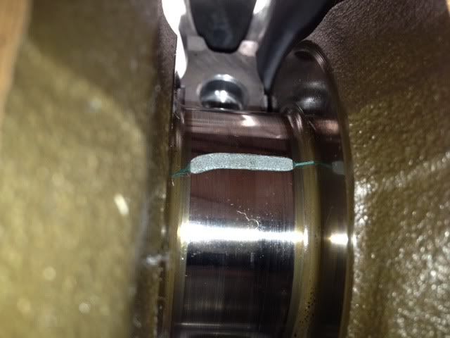

Work done for today.  Started at four by getting engine stand bolts and away I went.
All mains are at 1.5 thou, same with rods.  Couldn't ask for more.

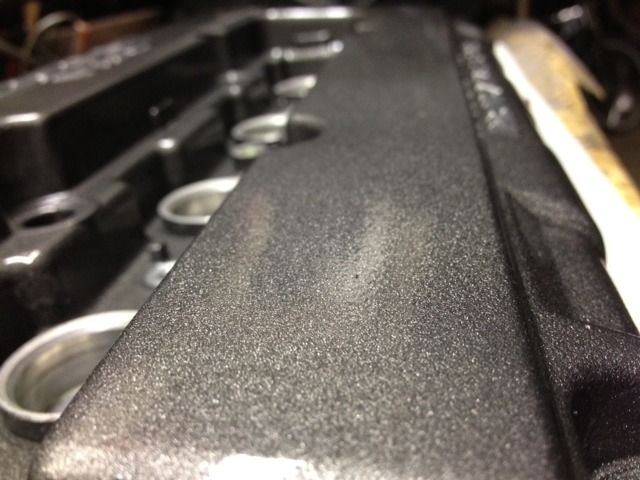

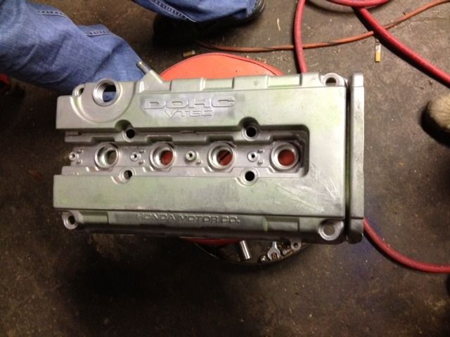

Re: Turbo GSR buildup [reppin RHMT]
« Reply #20 on: October 13, 2012, 11:03:36 PM »

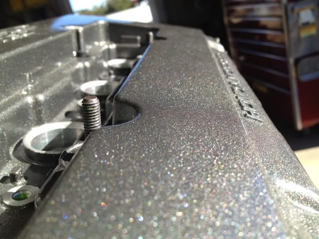

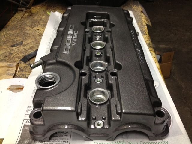

looking good. valvecover came out nicely!  :noel:
plastigauge? this is RHMT, bolt that shit down and see if it spins  O0
JaredKaragen
  • Posts: 364

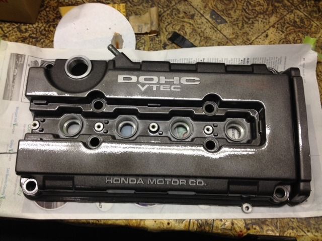

« Reply #21 on: October 14, 2012, 12:49:05 AM »
Haha... I want the internals to last... everything on the outside is easy to change...
but the VC looks godly in the sun.  Such an awesome color.
If I get up at a decent hour ill transport the rest of the engine parts to the shop and bolt the head on;  get some compression in this bitch.
Still need trans mount TOB and release fork for trans.

« Reply #23 on: October 14, 2012, 01:05:56 AM »
bah, i did the same for my B18C5 in the ITR. lol. just tq first cap to 20lbs, spin, next, spin..... keep going till final tq. if they are good parts they should be fine.
if it was in the motor to begin with (like my K24) i wouldnt even think about checking it.
The bearings I pulled out...
Holy cow...
Ive never seen such a ... patina before.  Best way to describe it.   Showed some oil breakdown scarring (excessive oil change intervals) but nothing major at all.  All journals measured to each other which was a bonus (minus the outer mains); and every single bearing came out to .0015 literally... no joke.  When I took this block in trade for a retune, his report was "it burned some oil, so I did a B20VTEC (the retune), and the B20V burned oil the same too... (stem seals)....   but it did its damage;  he let it sit outside a little... got a little wet in the jugs, but it ball honed out very nicely.  PErfect for re-ring and go.  P2W was tapering wider ad it got closer to cylinder 1...  so theres a ~.0005 or so between 1-4 cylinders... not shabby for a OEM bore.  I could re-ring again to STD if I wanted from the looks of it.

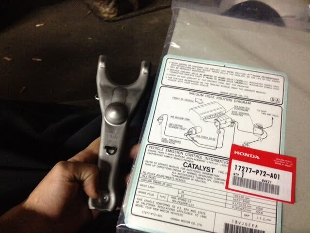

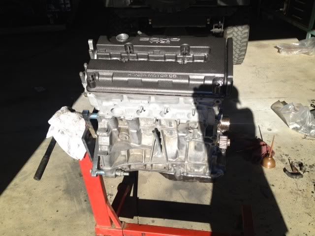

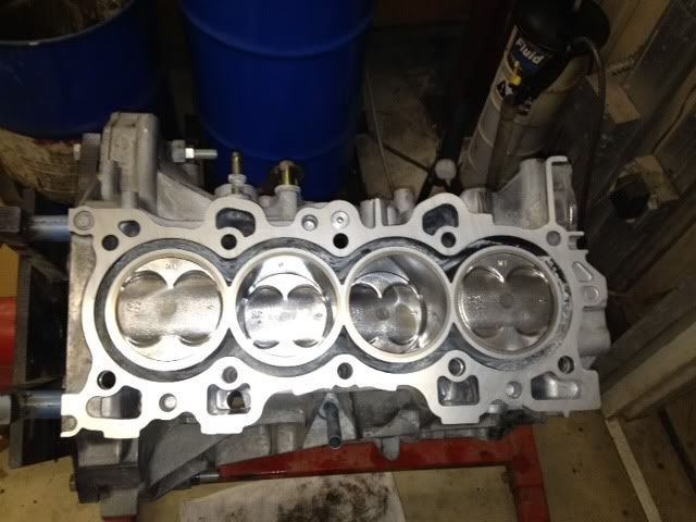

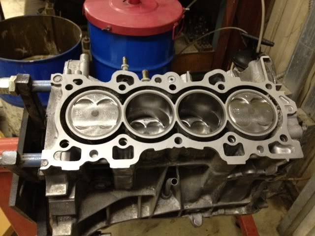

« Reply #25 on: November 05, 2012, 08:01:53 PM »
« Reply #26 on: November 05, 2012, 09:34:56 PM »
ready to drop in or what?

Acura still owes me:
Emissions label
Clutch release fork and spring
My trans mount I jewed up is totally torn...
Looking for an old tube of silly-cone I have to fill the bitch.
Otherwise; I have enough parts to install it in my car and drive it; but;
I'd rather get the correct catalyst so I have a place to screw in the oem o2 for breakin.  Theres no o2 port anywhere else.   That's another $108 away.  I can hold out.... Want this bitch to run and be right so it lasts and takes all the abuse I'll be feeding it.
But I got all the unicorn parts finally.  It's just piddly shit.  Just picked up the radiator hose and oil cooler oring kit.   Thinking of ordering coolant hoses for cooler from the dealer; do en while they are easy.    I basically haven't cheaper out other than by acquiring the actual parts for pennies.
