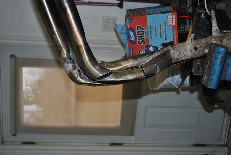

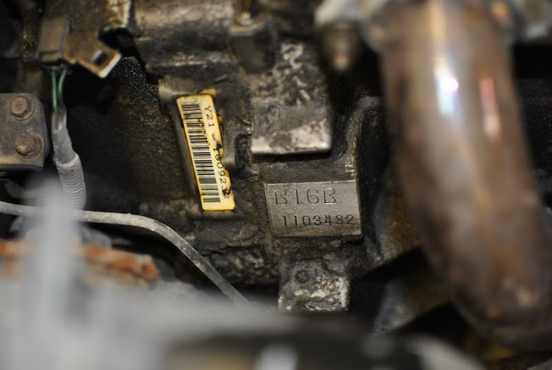

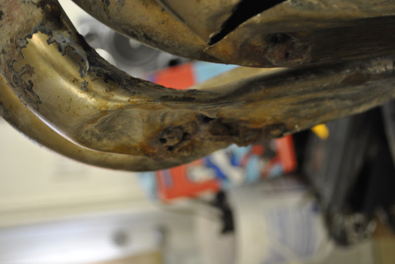

Well, seems like it's a real B16B, but with a Y21 transmission. Header is not cracked but crushed because the car is too dropped. It was to be expected at that price.
Ride is ok, bumping around because of too much drop, motor choking because of crushed header. I was able to drive 1 hour without any trouble. That a fucking must.

How do I know if the transmission is LSD or not?
From wikipedia:
Y21/Y80/S80/S4C
Found in:
JDM 96-97 Integra R(LSD)
JDM Civic R [EK9](LSD)
JDM Civic SiR [EK4, EG6]
JDM CR-X DEL SOL SIR (EG2)(optional LSD)
USDM DEL SOL VTEC (EG2)(OPTIONAL LSD)
From wikipedia:
Y21/Y80/S80/S4C
Found in:
Pull one of the CV-axles and look thru the differential, if you you see a pin then no, if no pin thin yes you have an LSD.
Or drive on deep snow with good deep tread tires.
Hit the gas and see if you are getting traction and can go straight.  :noel:
Or go to that drive way you were showing us a while back w/ lots of ice and see if you can go up it.  :noel:
Re: 1999 Integra rust free with B16B for 2500$
« Reply #39 on: March 16, 2012, 09:55:15 AM »
find a different tranny chart.
its a 92-95 B16A tranny, non-LSD

There we go
Bumper as some marks on it and seems to be pulled in the bottom of it. My hood doesn't close, I think I'll have to change the lock.

that header referb is hot  :noel:

I don't know what I liked seeing more, the amount it was smashed, the hack job the previous owner did, or the fluxcore madness that seems to have fixed it.
I only give you 8/10 because at that point you should have made it a 4-1 elephant turbo manifold.
The point is that I wanted to drive it yesterday and I did. Objective reached ;)
And honestly I prefer my ramhorn. In fact I wanted to use my ramhorn as a header but I had no extra pipes for the downpipe and couln't find the plate that would become the T3 adapter so I said fuck off and used the pipes that were supposed to be the dump pipe of the wastegate to fix the header temporary.
I still have a huge leak, but it's just the section where the cat should be that I just clamped instead of welded in case I have to remove the header. Otherwise I'll have to cut the pipe again to remove it and it's not super fun to do. I'll try to find an alternative fix.

Sweetness. I dont think I have even seen a header that smashed before lotts of speed bumps around your parts?
« Reply #59 on: March 19, 2012, 08:37:09 PM »
I don't know what happened seriously, but the oil pan was hit too.
But the car is really too low and the suspension not very good so any big bump would cause header to hit the ground...
