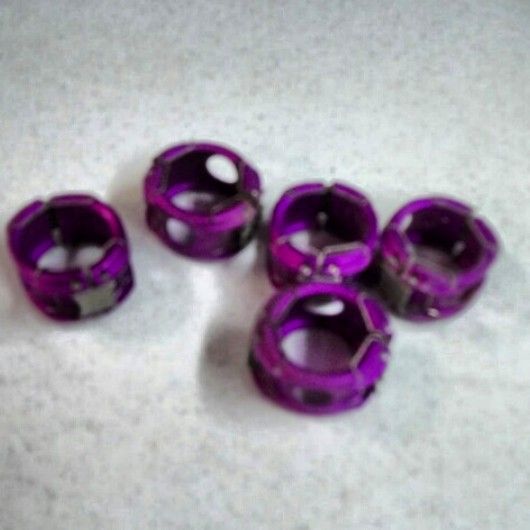

« Reply #151 on: May 24, 2013, 07:48:03 PM »

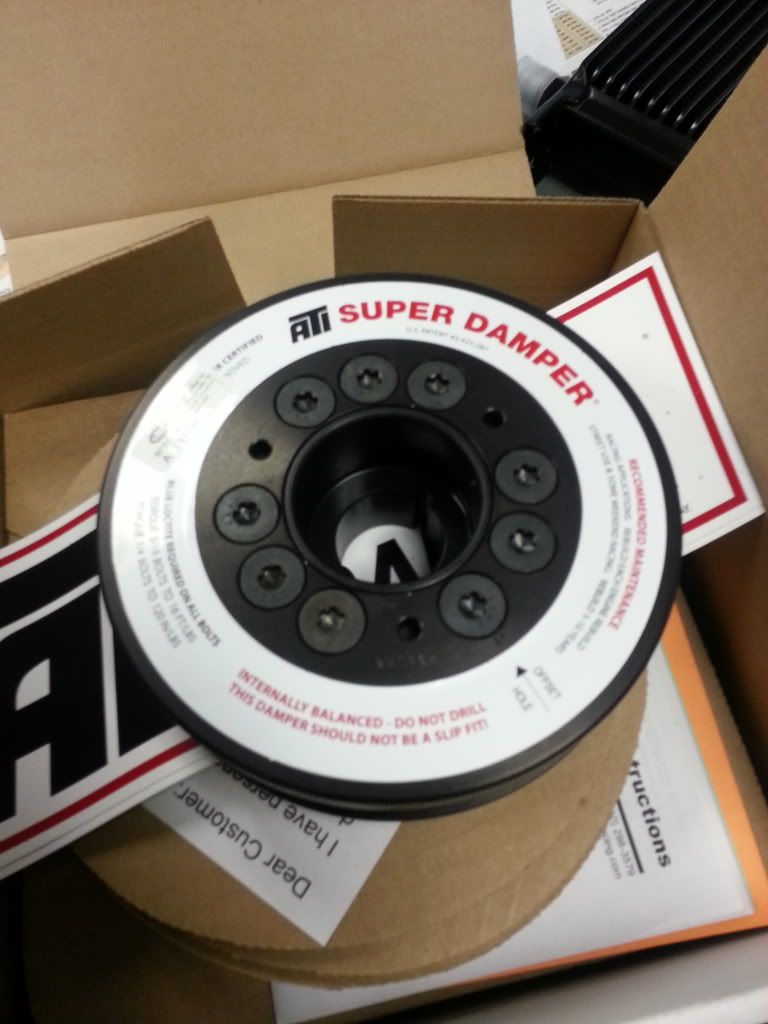

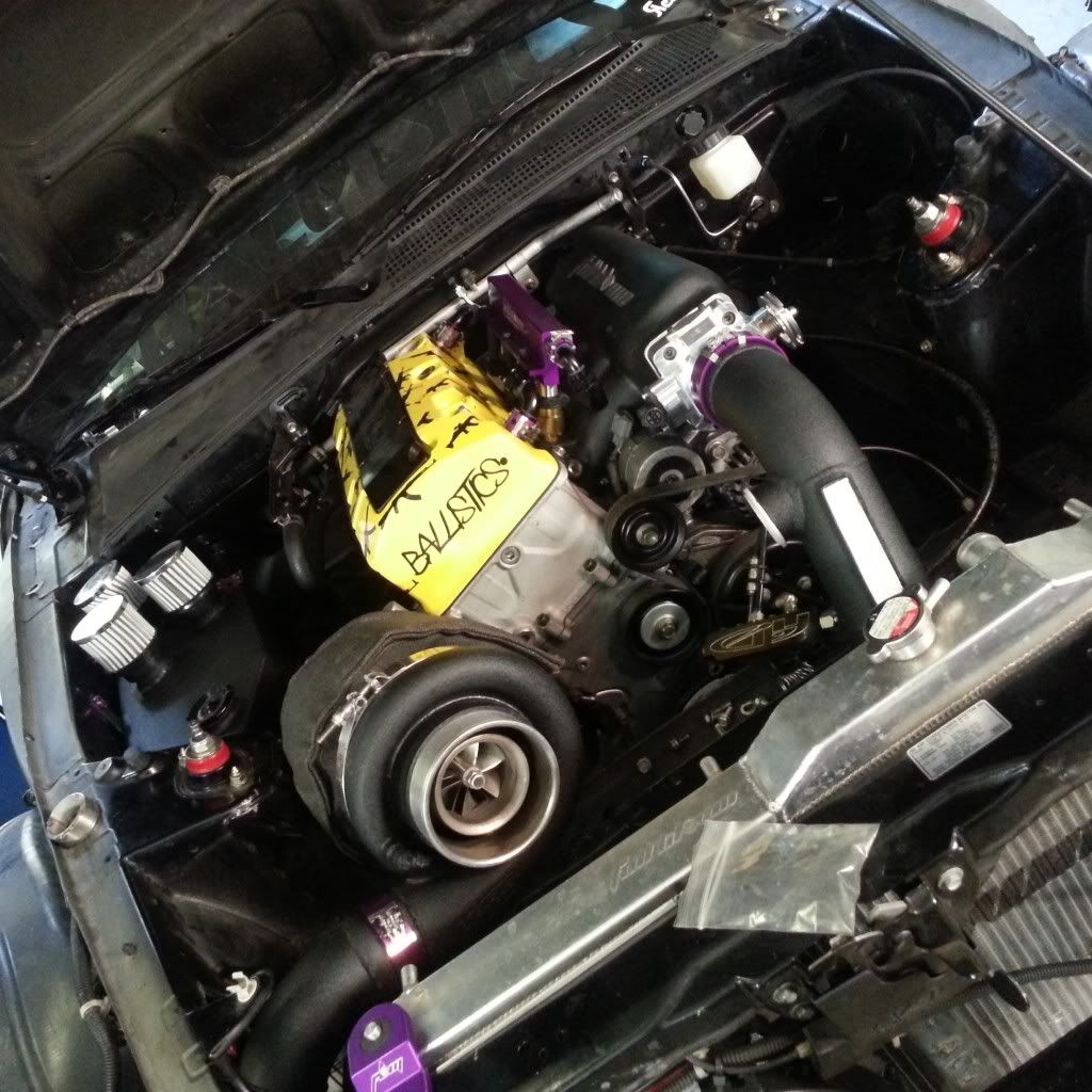

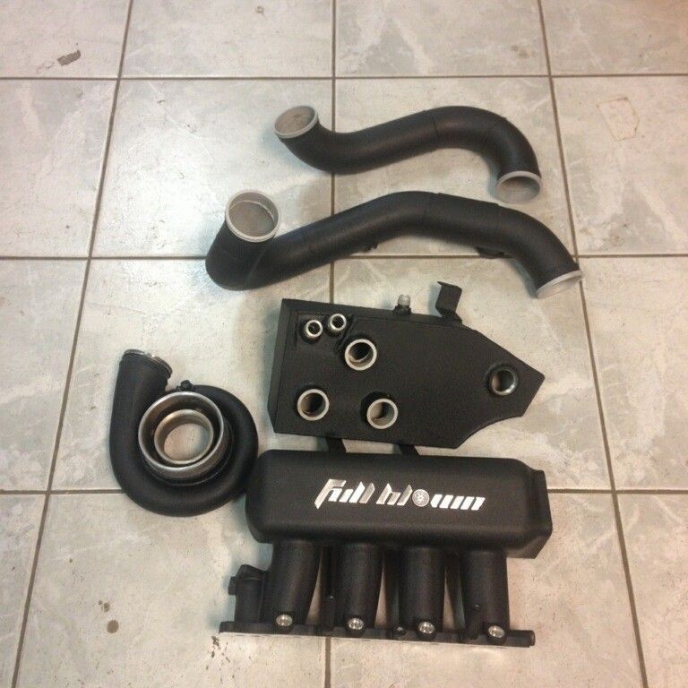

Didn't have to work today so though I'd get caught up on a couple thing also had my manifold and damper show up

« Reply #156 on: May 31, 2013, 12:15:45 AM »

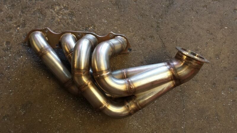

Waiting on my mounts to drop it in, got some 88a hasport coming then have to make the manifold for the 4272r bizz then every thing else is not very time consuming

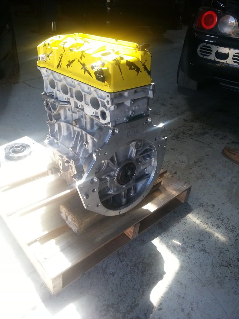

« Reply #158 on: June 02, 2013, 02:24:23 PM »

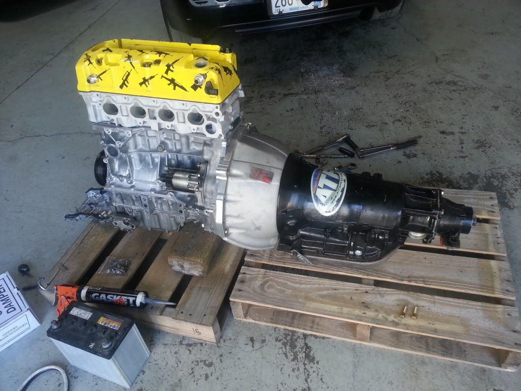

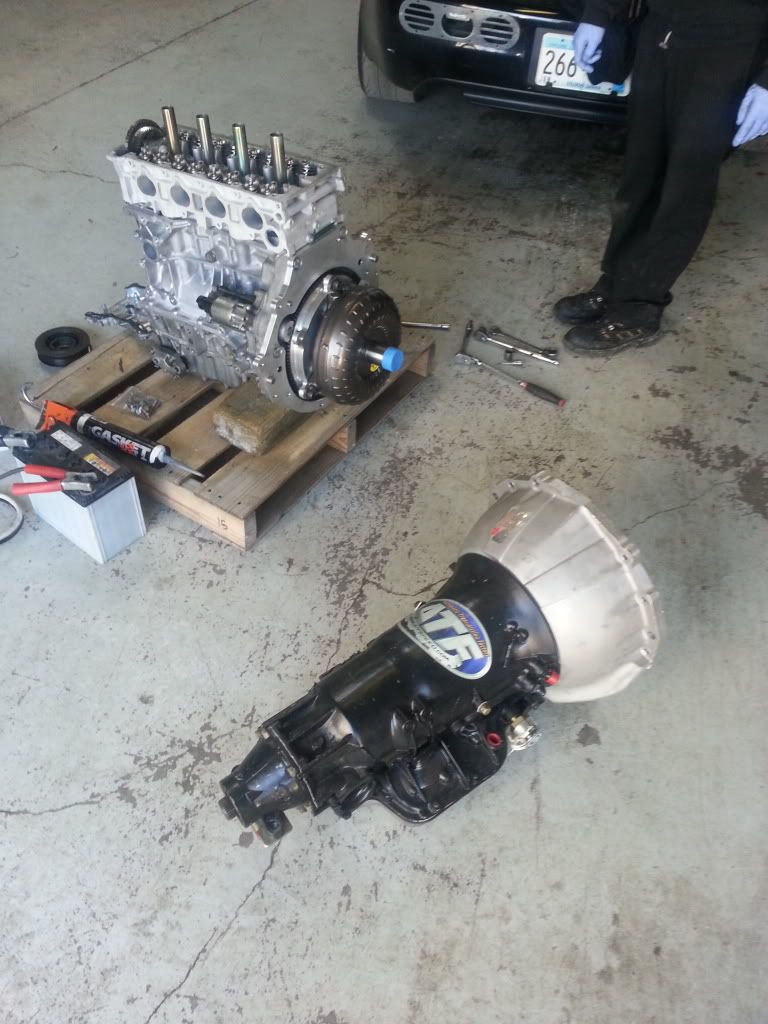

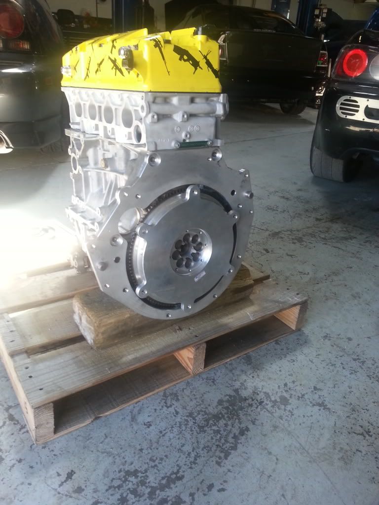

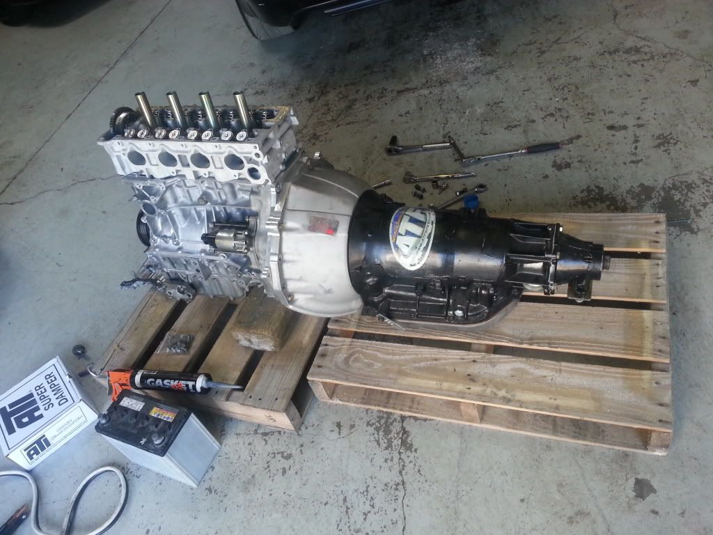

Im curious about the lack of a flexplate... The billet adapter looks sick, but was there any mention of possible issue from NOT having an actual flex plate?
hatchbone
  • Posts: 1708
Re: new drag car
« Reply #161 on: June 03, 2013, 04:59:37 PM »
High hp diesels and converted 2jz's run billet flex plates so I see no reason why I can't
Re: new drag car
« Reply #162 on: June 03, 2013, 05:48:18 PM »
Just curious...  I know why Convertered cars run them, just wondering if there were any possible downfalls of not...
Re: new drag car
« Reply #163 on: June 04, 2013, 08:39:03 AM »
Only issue with billet flexplates is that there is no flex, and the trans pump tends to push on the engine thrust bearings increasing wear substantially. In the race truck we only get a season out of the thrust bearings. We have now gone to a laminated flexplate to try out.
Re: new drag car
« Reply #164 on: June 04, 2013, 02:29:09 PM »
Thats what I was getting at... I guess if youre gonna tear it down every season, or stay on end play its cool... Sure looks pretty Jake  ;)

She comes apart every year always, these ain't no 350hp cars lol

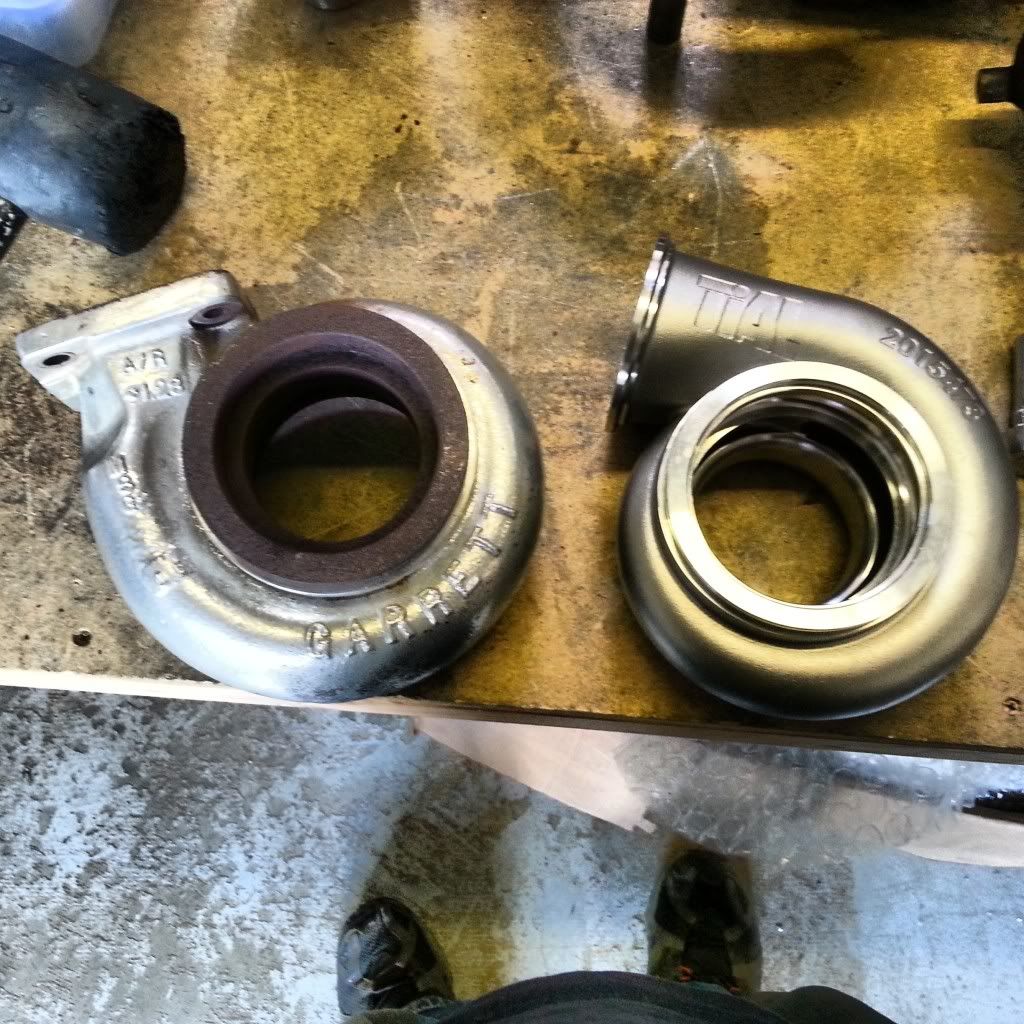

« Reply #169 on: July 12, 2013, 12:55:16 PM »

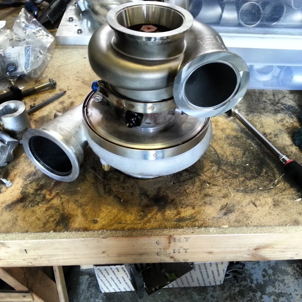

No more twin scroll?
Re: new drag car
« Reply #172 on: July 12, 2013, 02:13:19 PM »
that was last years baller. v-band is baller this year  ::)

Was no room for the gates and turbo so needed to go dingle, plus I doubt she will be running low boost setting to often so shouldn't need it for control
Re: new drag car
« Reply #174 on: July 12, 2013, 06:51:35 PM »
Not for control but for power. I made a good amount more with the twins.

Ill just add more psi if I need more power lol there literally is zero room for two with dump tubes and plumbing

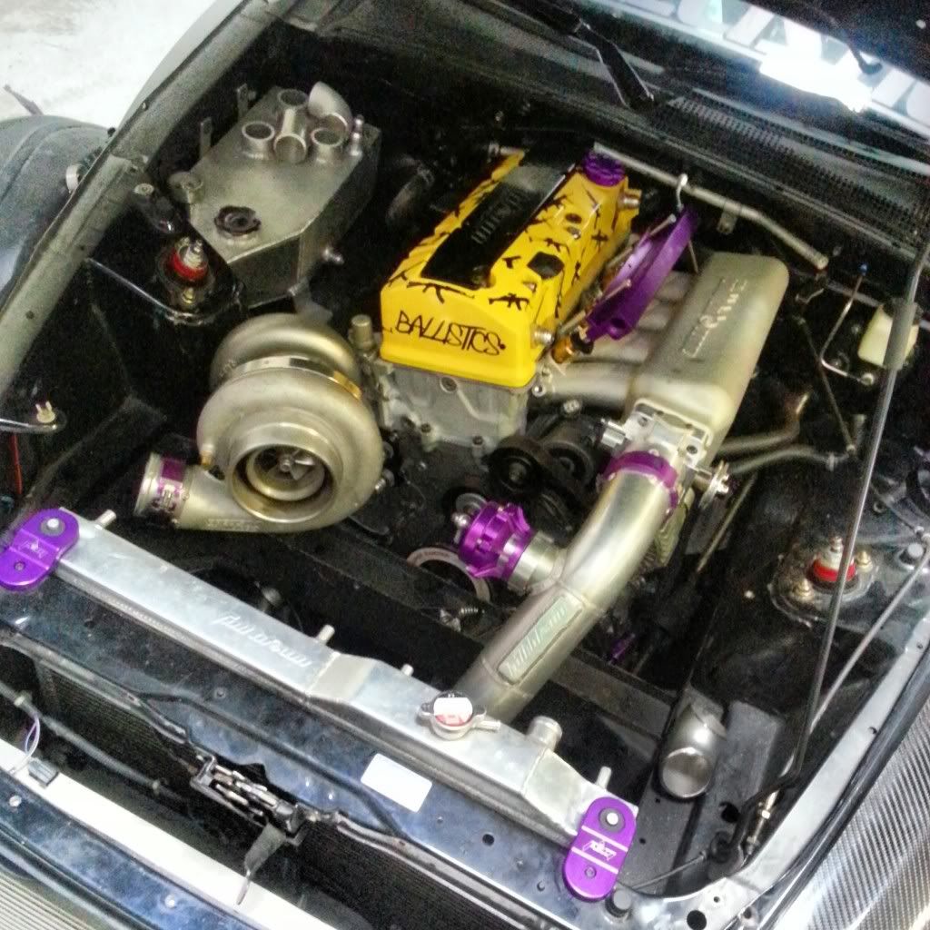

« Reply #177 on: August 08, 2013, 12:06:19 AM »
